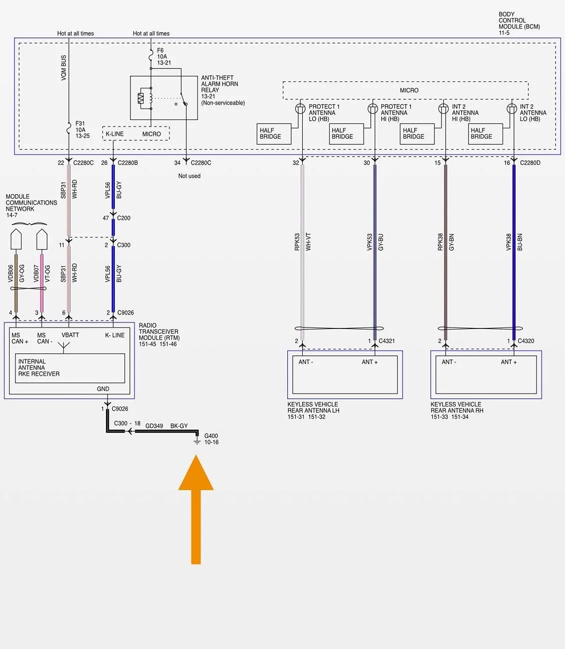

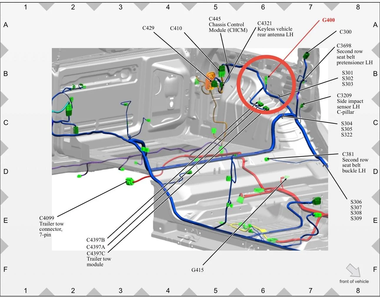

Ask them to show you where it’s sharing the same ground as the RTM.
Here is the RTM ground location:

Brian_B
Sep 14, 2023
65
8,921
15,927
Central CA
Boy if they pulled all that back replacing a BCM…
*edit* I say that but there is an antenna back there they would have checked so… I guess they get a pass
