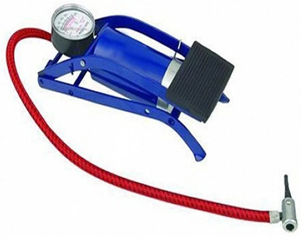

I cannot confirm or deny that most people have under inflated tires... HOWEVER it is shocking the amount of people who don't even know that you can put air into your tires. I once had a co-worker who didn't know you could put air in your tires at all... When I was explaining this to him he was in absolute shock. Mind you this was a 26 year old man.
How long before he figured out this wouldn't work??

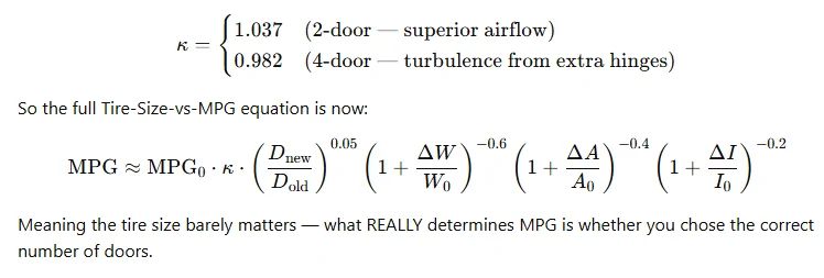

I took math in High School, back in the 80's. Spent about 30-45 minutes, and figured I should share this with the group. Here is the one thing you seem to be forgetting.
don’t forget the official Door Coefficient, which obviously impacts aerodynamic laminar flow around Broncos:
Ford Bronco New tires 1763481518225-59
Meaning the tire size barely matters — what REALLY determines MPG is whether you chose the correct number of doors.
Although I agree some people need moar.
