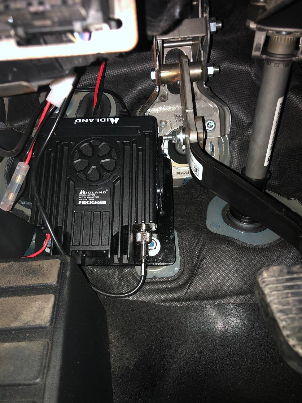

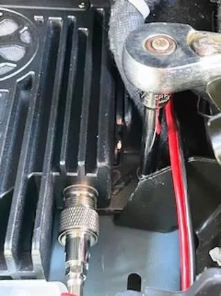

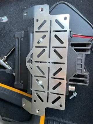

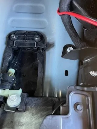

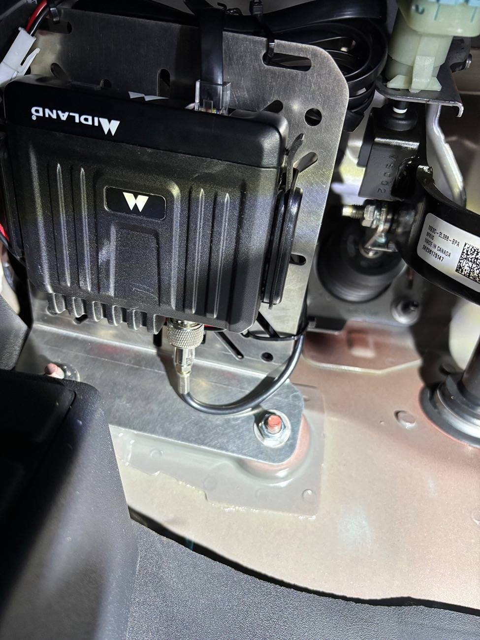

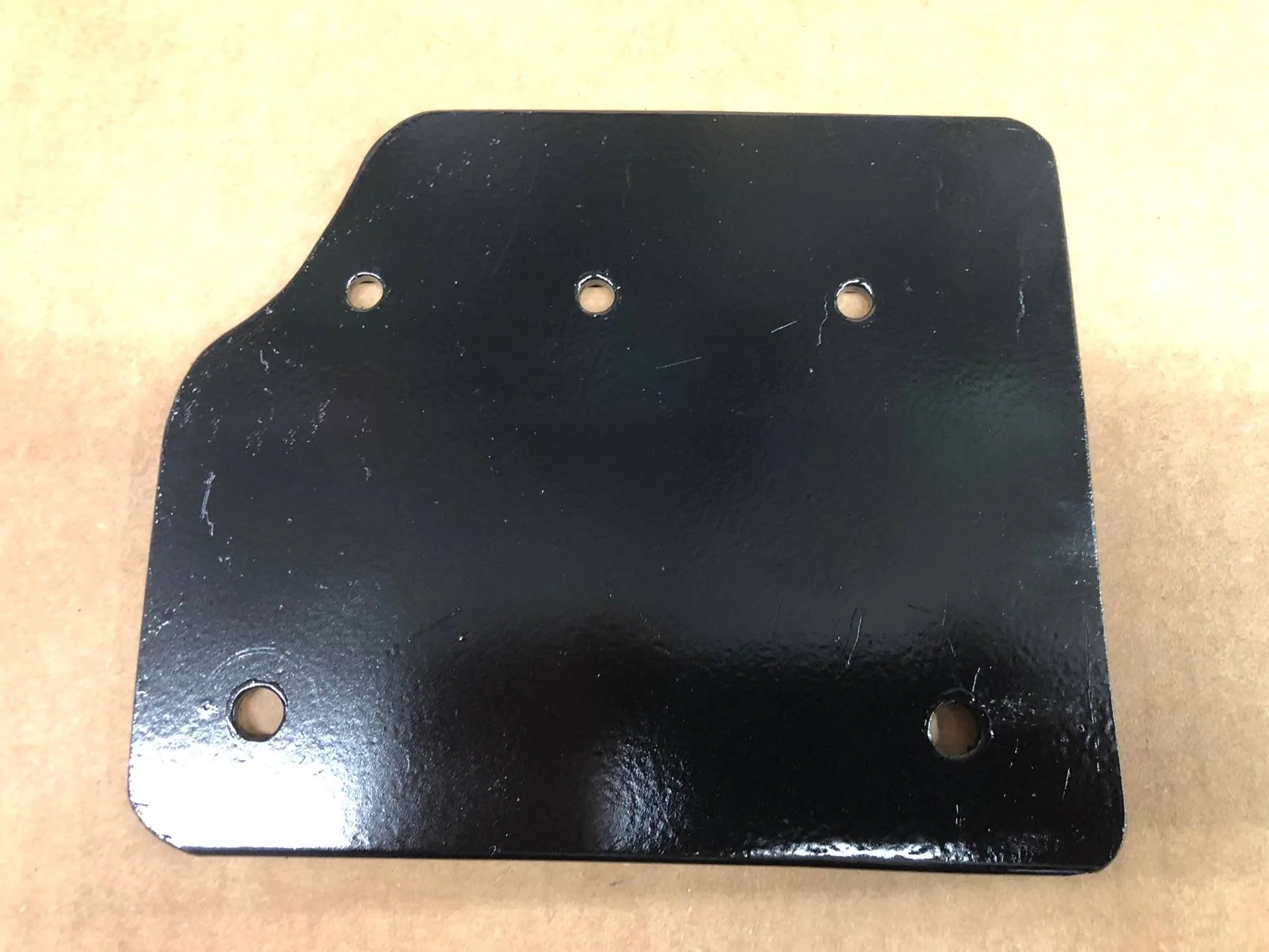

Been testing this for a bit, it’s up on the website now. @Mountains2Metal just released this footwell bracket that occupies the empty space where a clutch would normally be. I mounted my Midland MTX275 base unit but there are a number of possible uses. Plenty of room under there

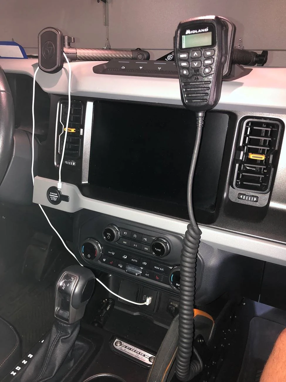

I did a stealth install in the center console behind the USB port. Lotsa room back there.

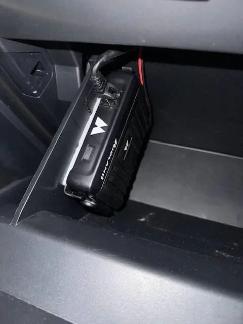

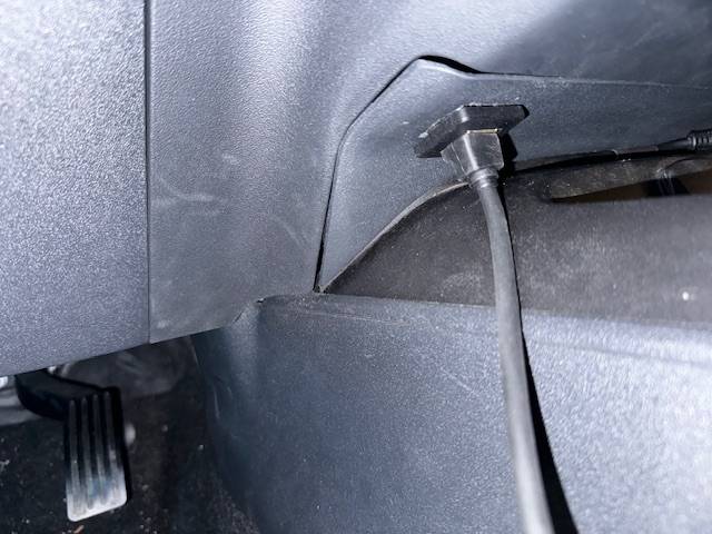

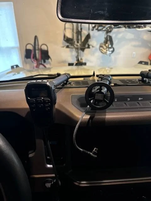

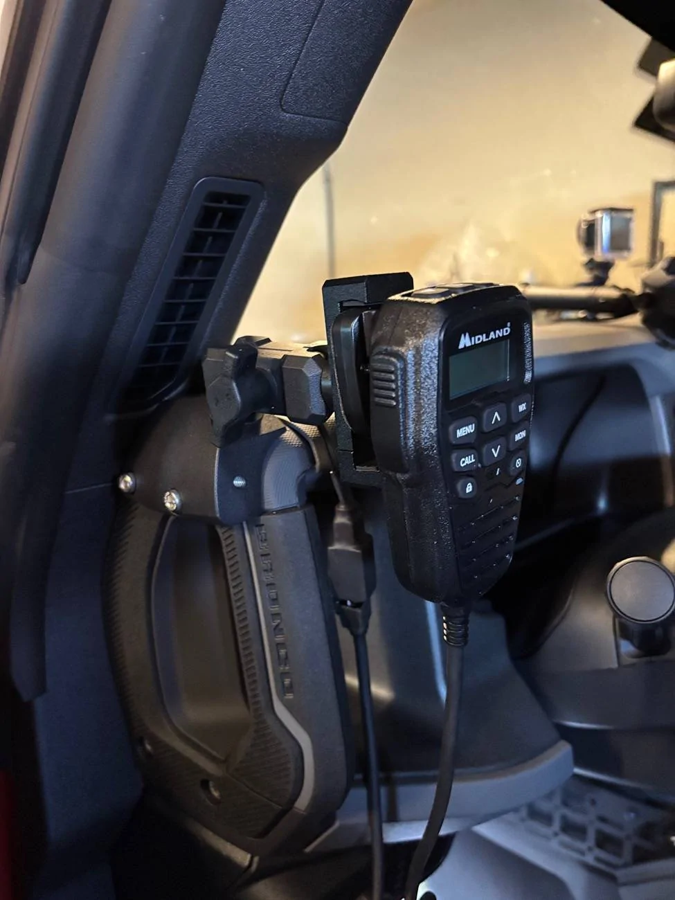

I just threw mine in the glove box but did a similar stealth install for the mic. Nice to see they now have two bracket options though.
Ford Bronco New mounting bracket available for another unused space IMG_9528

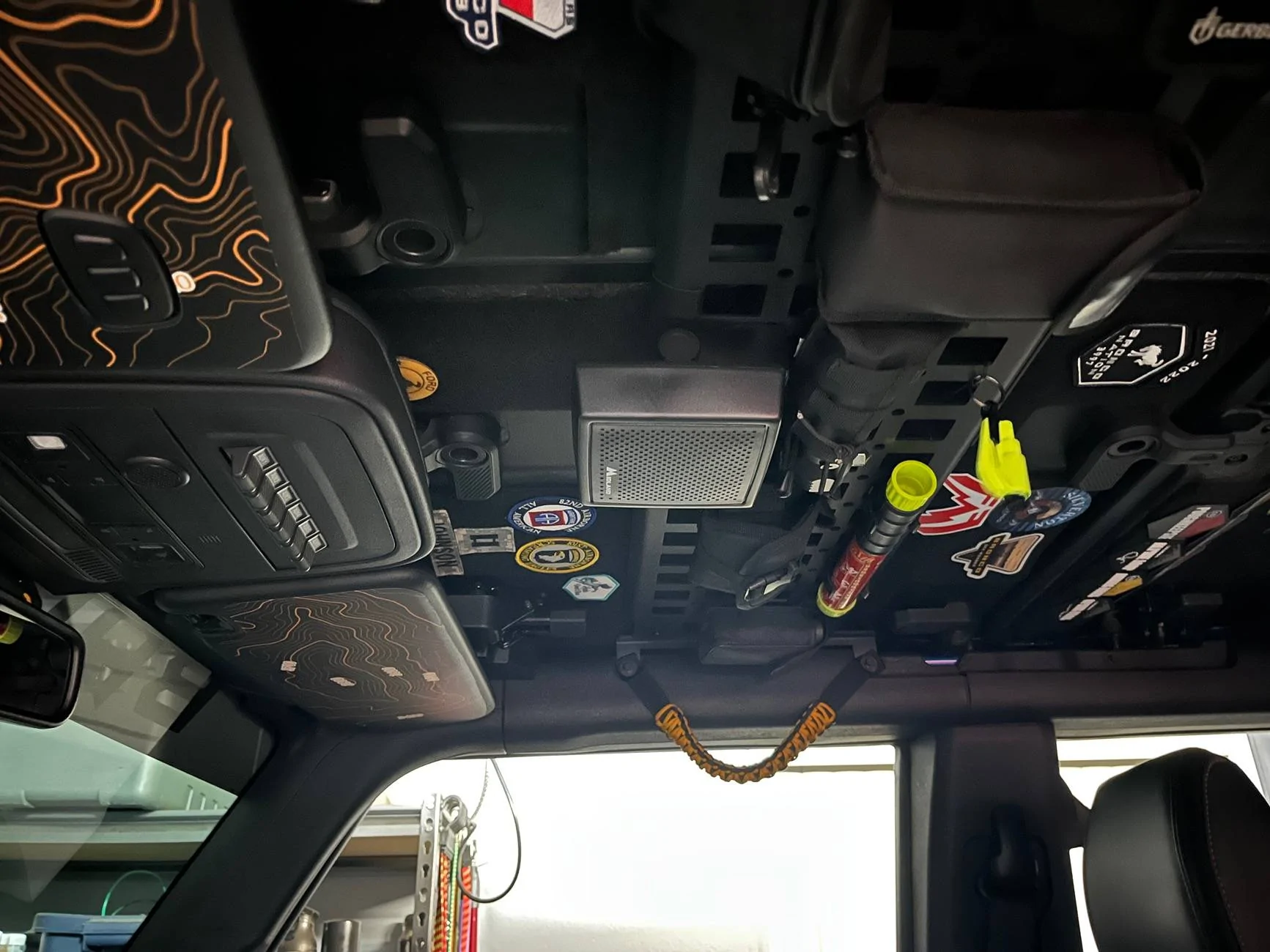

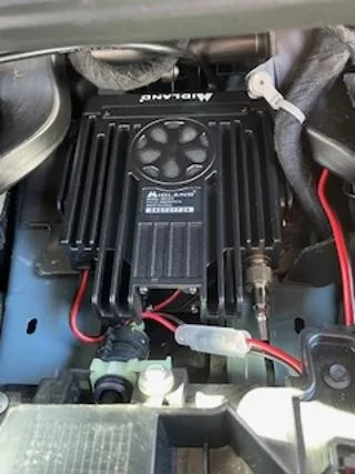

Mounted my MXT575 in the same space a couple years ago using a bracket I fabricated. Works great in that space! I also mounted an external speaker on a overhead Molly panel because it just wasn’t loud enough under the dash

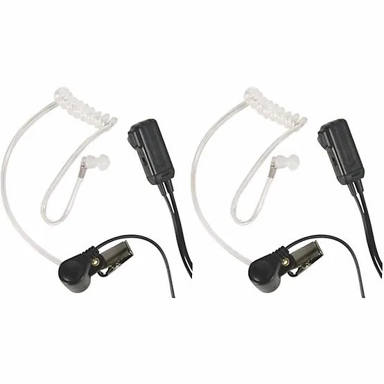

Since it's behind the plastic of the center console, the sound gets muffled a bit, you need to go into the midland menu settings and select that audio comes out of the base unit AND the mic - that way you can plug in a little earwig thing and look like a badass secret agent when you drive around.

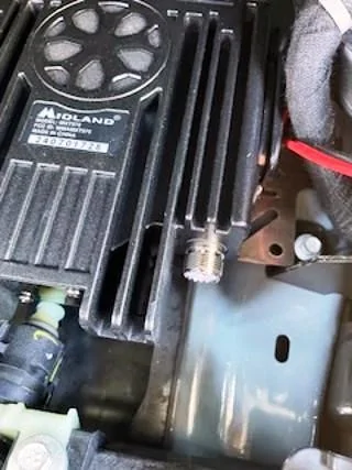

this is my installation.
Main board under the rear panel where the windows switch.
And i run external cable with female conector where the wireless charging plate.
I didn't want to drill in the dash so i print bracket instead

The Midland 575 takes a small mod, the 275 fits just fine, so it really boils down to the size

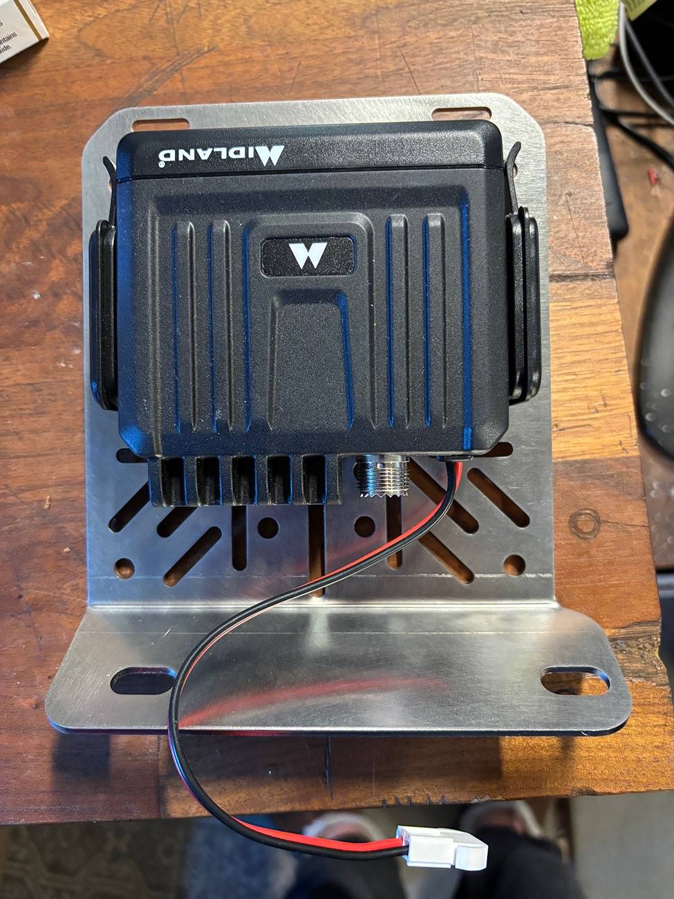

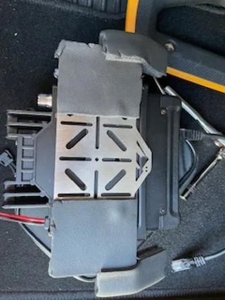

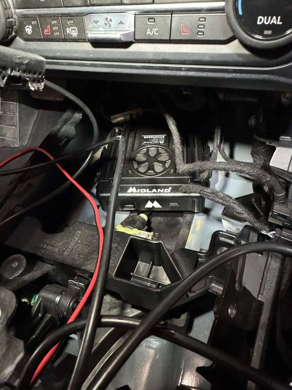

I found out that some Bronco models have less room under the console, and the 575 is about 1/3 larger than the 275. I tried without success to mount it like Draughton has shown, but the HVAC ductwork prevented it with the 575.
I ended up using the MTM bracket attached to a console bolt. I put foam under the sides of the bracket so I don't get rattles or movement. I used minimal foam to allow for air movement and can install a fan if it ends up being to confined to allow cooling.
