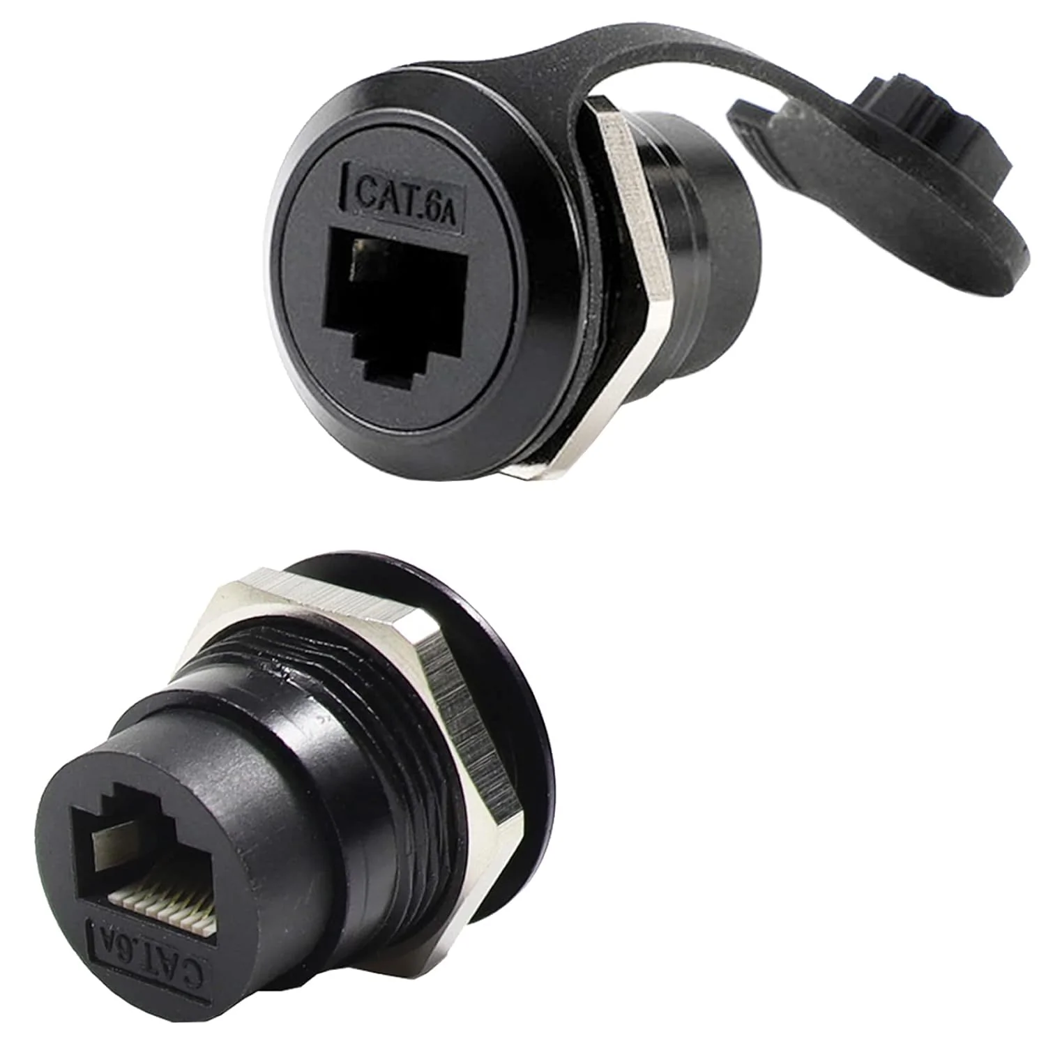

Where do you get the dash end connector for the handset? That Looks So Clean
Amazon or other electronic store has the connectors available.

I use a shielded connector Amazon
Amazon. I also got the extension cable to run from the radio to the connector at Amazon
FYI - A standard CAT6 patch cable can be used - there is nothing special or unique about the Midland cable.
