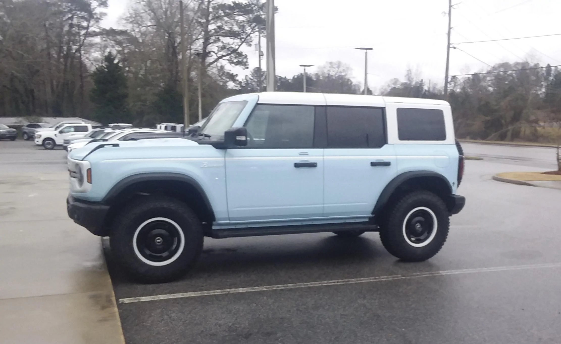

I have visited this site 6-10 times a week over the past years and never posted that much. I have enjoyed, for the most part, reading the forum just to see what everyone else does to their Broncos and I have built my first Bronco and my ”Braptor” mostly off of what I see here. I have enjoyed my Broncos, and 6g, so much that I just bought a Bronco as advertisement for my company and I’m going to do one of these Build/Rig Journals to get advice from some of you experts. I’m not going with a crazy engine swap 10” lift build but a more cosmetic and unique look that goes with the company. I’m starting with a Heritage Limited and I want to put on 37’s. Best bang for the buck on lift? Here we go……..

I really do not think that is the type of Build he is looking for.... It does happen to be on a Heritage Limited though. But Bang for Buck????? Aimed at Advertisement???? No I do not think this is the direction he would want to go.
I would suggest a 2 inch spacer bump and some wheel spacers to fit the 37s..... KEEP THOSE WHEELS! they are $700 each and you have to have a heritage limited to order them at the moment.... They will be available to every one but at that price...
I even had a Policeman pull me over to ask where I got the wheels... No he did not use lights, he just asked me to pull over while next to me at a stop light.... Seriously....

I would go with the ready lift.... Once you replace the knuckles you are stuck with that... The 2 inch difference is a lot but the the ready lift is reversable someday down the road.... or allows you to go a whole different direction someday... the Superlift you are committing for life.... The 3 inch ready lift will get you on 37s and will definitely stand out. You will want wheel spacers . I don't know as if you would even need the clearance kit if you are not taking it off road.

Hey Joe, what spacers specifically do you recommend? You are correct in your statement above that it will be only for show and won’t even see the rain. I do love the limited wheels but I actually like the white wheels that came on the non-limited version better as they have more of a “throw back” look and will help me achieve my desired look. Our company is a sun screen and sun after care company so it will make its way to some surf and beach events all over the country for promotions. I envision a retro look with bad—s look and surf boards on top. You know, think “lifestyle” brand. Thanks in advance. I was torn between using Bronco or one of my Jeeps but the Heritage was the clear choice after I saw one in person.

To be honest I do not run Wheel spacers so I have not researched any of the offerings.... I have heard there are a couple out there that are pretty good though. Since I take mine off road I do not like the extra leverage on the wheel bearings.... And I am trying to narrow my rig... I am on portals so I am already too wide... I have run them in the past on other rigs. Sometimes it is just necessary for the clearance. If you are changing the wheels I would go with a different back space as opposed to spacers, but that is me trying to simplify things.

Awesome feedback. I located and purchased some of the factory “non-limited” white wheels so it’s closer to the throw back look. Unless I go with the Black Rhino white wheels, these will be the ones I use.
