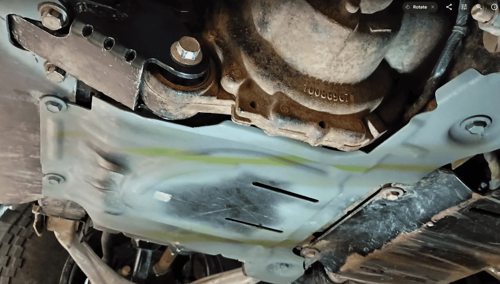

That's a nice looking part....But.... what about the other 2 mounts??? the rear need dropped also or your axle is only dropping about have of whatever your front mount drop is. because the axle is halfway in between the front and rear mount...
I go into more detail in the video. (skip to 13:38)

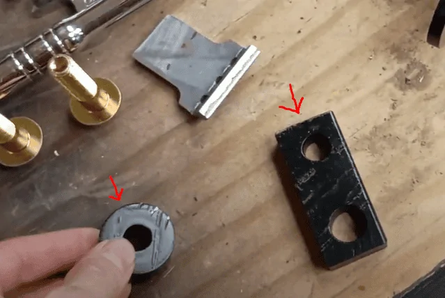

The other two mounts were handled with these parts:
Ford Bronco Homemade Diff Drop for 6G Bronco 1709383952871
I didnt actually lower the rear mount like you did. Instead, I extended it forward, this allowed me to get more rotation out of the diff, and handle the right side with a simple spacer. Seems like the easiest way to go about it for a drop in the area of an inch. If you want to go lower, you need to do more. Also, shifting the diff forward removes a bit of unnecessary CV angle just from having the diff positioned slightly rearward of the wheel center, but thats probably negligible.
It was all done up in CAD. Half inch (12.7mm) forward shift. 4° rotation, 12.6mm on the right spacer (accidentally said 16mm in the video), and 32.9mm drop on the front bracket to achieve an axle center drop of 20mm. And because the front mount sits considerably higher than the bottom of the diff (stock) you can do more drop there (with rotation) with no penalty to net ground clearance over the centerline drop of 20mm.

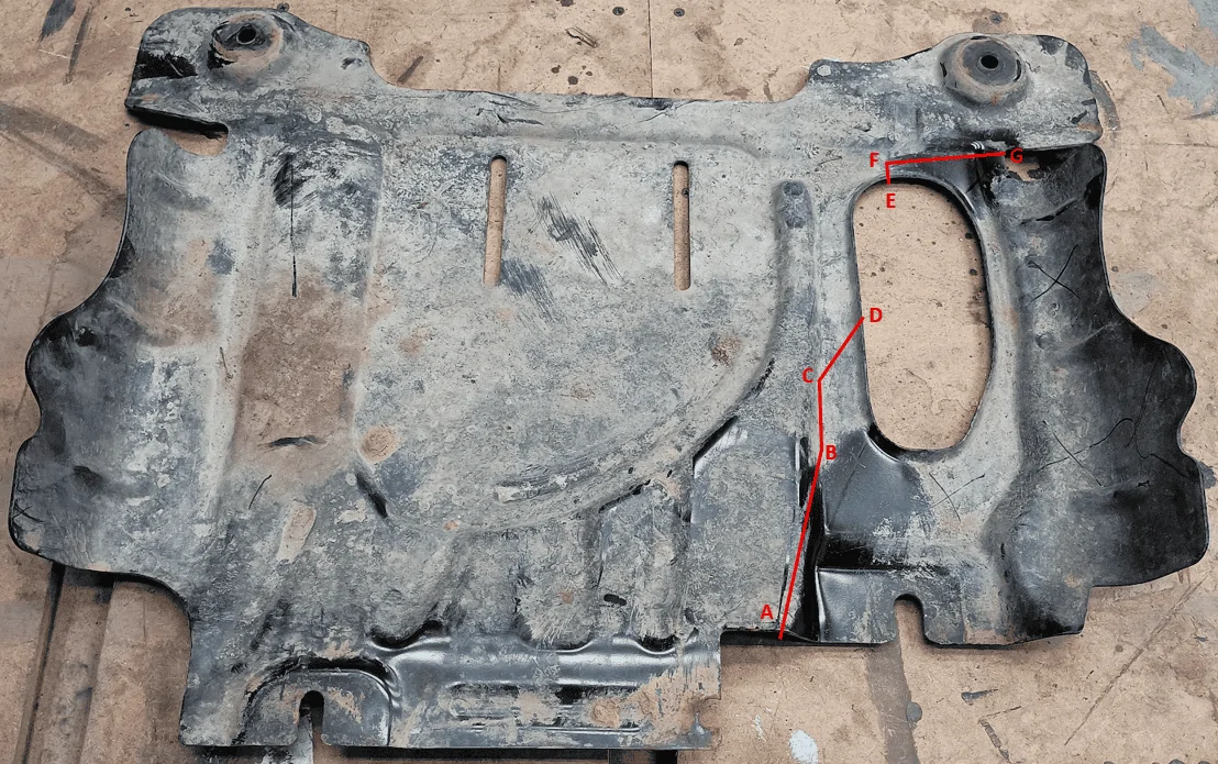

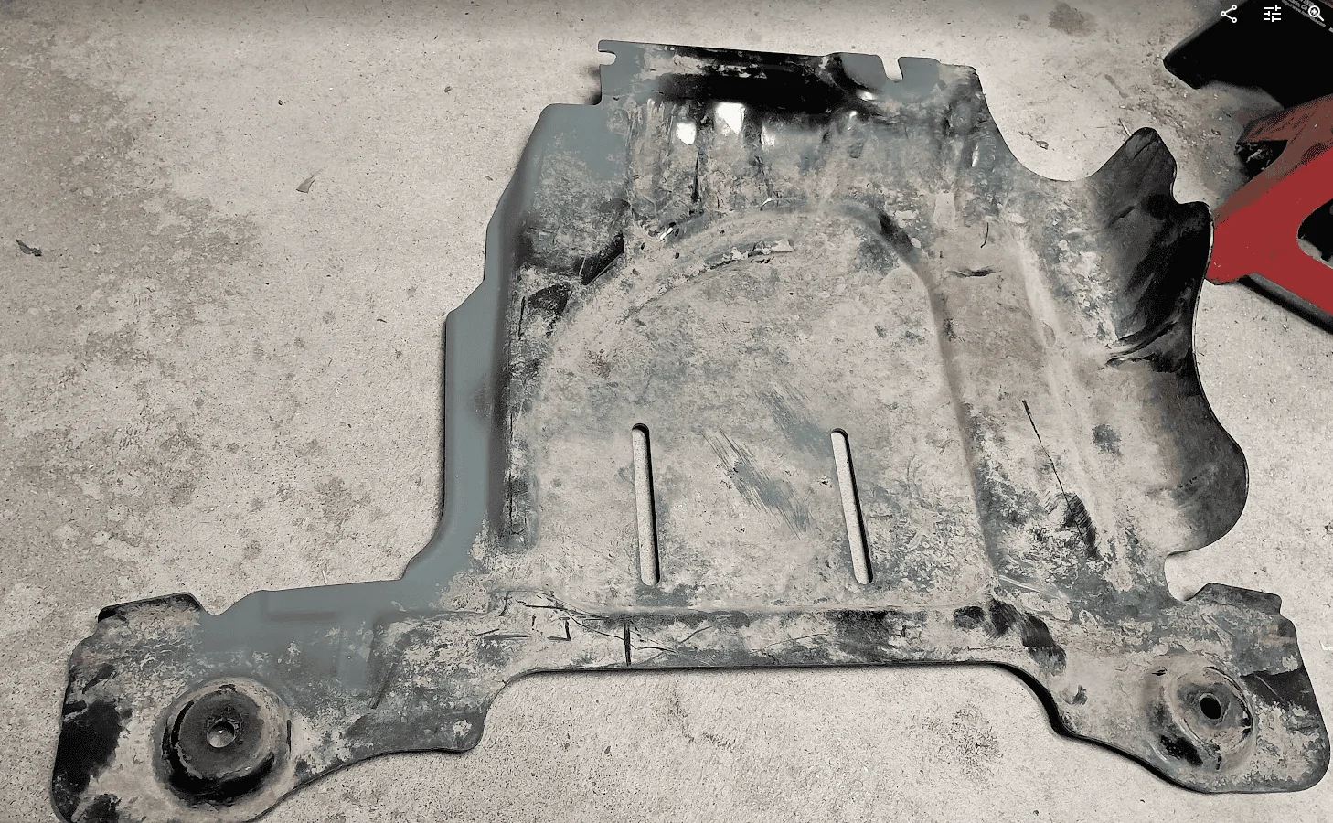

Here are more details on the skid plate.
For those interesting in more details, don't hesitate to PM me. I'm working on a kit, but if you want to try it yourself, I can give you the measurements.
Ford Bronco Homemade Diff Drop for 6G Bronco 1709587687915
I just used a cutoff wheel, starting point "A" is roughly at the crease between the two forward driver side mounts. Cut a straight line to the bottom of that same crease, where it levels off with the bottom of the skid "B", roughly in line with where the start of the original differential clearance hole starts. Cut straight back to "C" along the lower crease for about 1-1.5". Cut from "C" to "D" at a 45° angle to the diff clearance hole.
Begin the next cut "E" on the passenger side of the centerline of the diff clearance hole, about an inch inboard of the passenger side of the clearance hole. Cut back to "F" about 0.5", then cut towards the knotch in the skidplate on the drivers side "G".
Remember to cut conservatively as little as possible. Its relatively easy to hold the skid up in place (with a couple bolts in) to check fitment. Remove as little as possible to save as much strength as possible.
