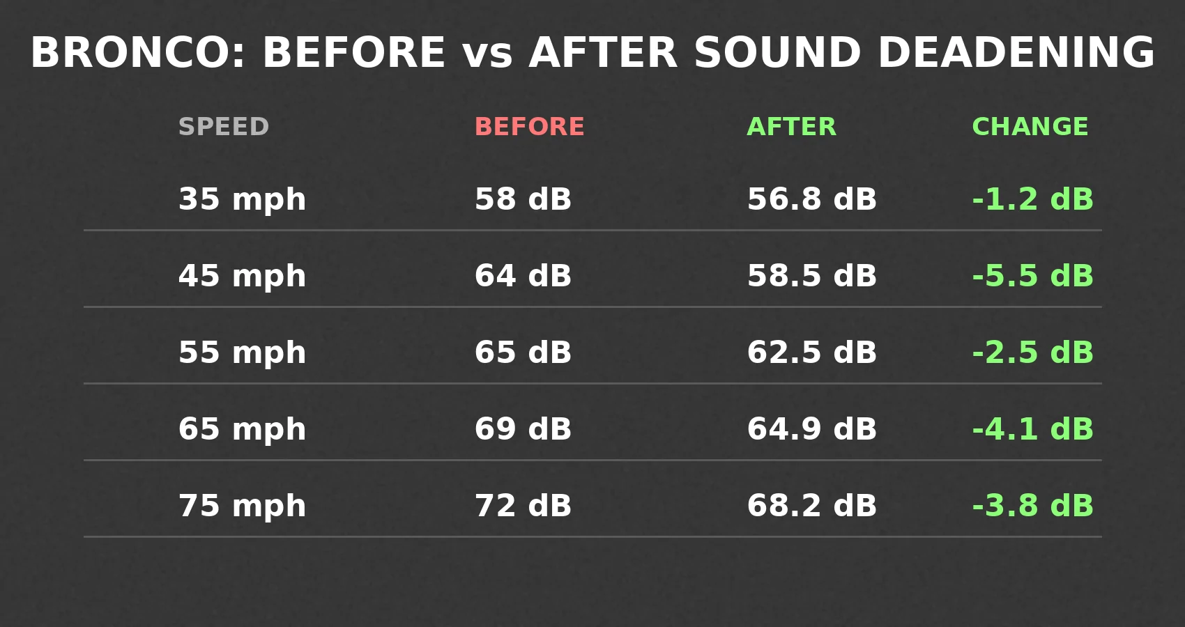

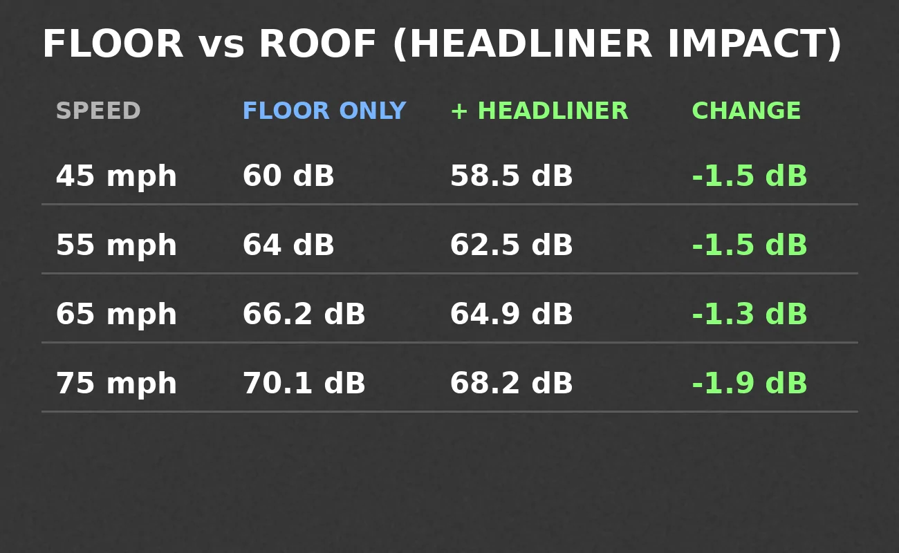

I used a closed cell foam over the fiberglass roof then you can either buy the stock headliner from ford and stick it over using spray adhesive or buy the textured closed cell foam liner from turn offroad and cover the thin foam. The idea is you want to create panels that trap the noise and absorb them once inside he cabin. That’s what the closed cell foams do and using multiple kinds really helps.
Honestly with all that work you only drop cabin noise 1 DB. Not a lot but the noise you hear is not from the roof. It’s misleading because the noise is actually coming in from bottom along the frame and once inside acts like a ping pong ball bouncing and resonating and well your fiberglass acts like an amazing speaker box. Right by your ears
all that said. Under the rear passenger seat is a bad spot. Mat and thinsulate that. You don’t need to remove the seats but it’s easier. THere is another cross member in rear cargo area under our storage box. Remove that and there is a thin metal brace that tings big time.
Under the foot areas of all seats has thin metal that reverbs where the drain plugs are. Mat those. If you can thinsulate there too. It will build up carpet slightly. Slide thinsulate between carpet and firewall also mat that spot. Mat the cargo areas behind the plastic panels. You don’t have to get 100 percent coverages but I did the entire cargo area , floor and behind panels.
Next is the outer skin of doors and fender well behind tires on front 2 tires firewall. Mat those and ad thinsulate behind the fender Liner and over the mat behind the door panels.

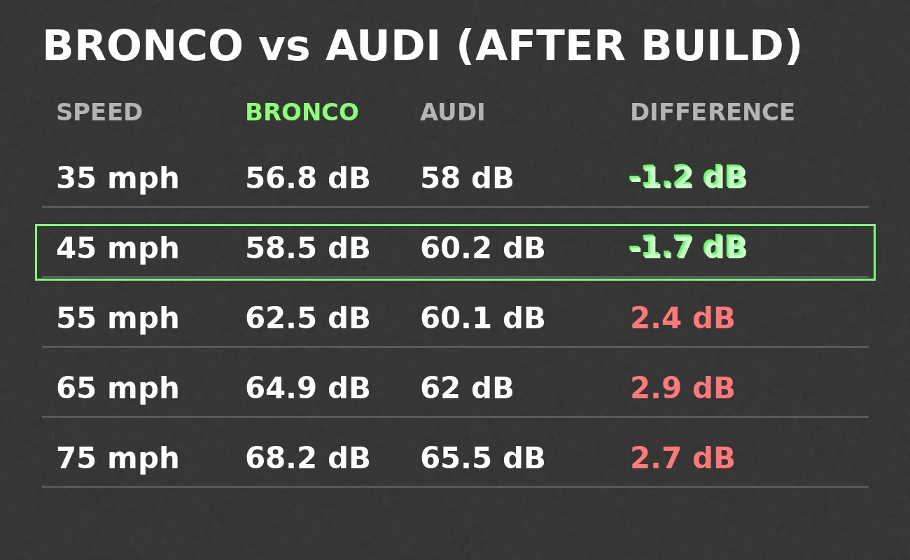

keep in mind, I did manage to have the bronco quieter then an Audi q7 by a lot up to 55 mph… amazing? But after that you have to remember you are driving a BRICK 🧱 and you will lose the battle to 85 mph as aerodynamics is something that was never designed into the bronco and never should either 😂
the very surprising thing I did was added mat to my full skids on the inside. That was probably one of he biggest frequency change of road noise I did. Also used neoprene washers on the skid bolts. It keeps the sound from traveling across the frame and creates an absorbing effect
I really just need to get the video out 😂.
the floor expect 2-3 db drop , doors another 2-3 and roof 1 db. But all together a very quiet bronco 😎
Your bronco might be quieter than mine as well. I have the icon upper control arm with the heim joints and those dudes add a ton of road noise and I’m on portals as well. Those don’t actually add noise but it pushes the tires out of the wheel well and that does add turbulence and noise.
hope all this helps
