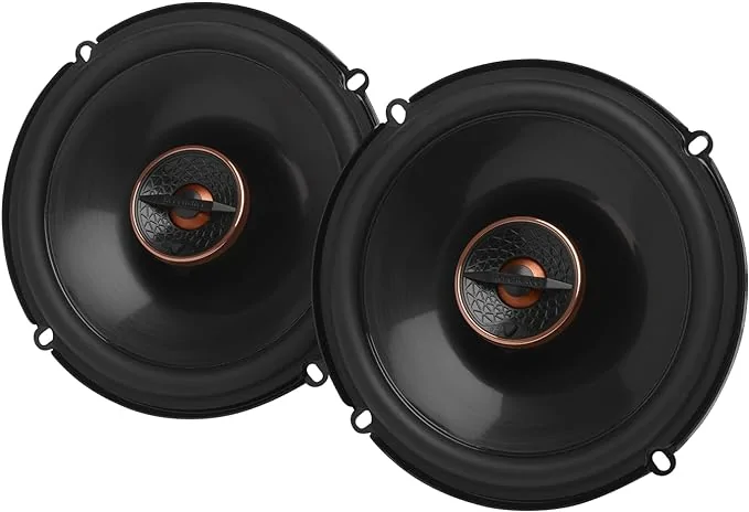

I just completed my installation of the Mabeth 6.5" pods with Infinity REF607F Reference Series 6.5" Extreme-Performance coaxial Speakers. This was with the premium Bang & Olufsen system. I added sound deadening material to the pods. During the installation I left one of the original 4" pods installed to compare with the new 6.5" coax speakers. I have to admit I wasn't really impressed overall. I stubbornly believed and wanted it to sound way better than the stock rear speakers. The stock 4" speakers gave a very neutral and balanced sound. My new speakers do that too but with a little more bass and a little more treble (which is what I suppose you would want in an upgrade). It's only been a day or so and I'm still experimenting with tone and balance settings.
I guess we haven't found a way to unlock the B&O amplifier settings for the rear channel????
edit: There is a lot more bass now coming from the rear of the cabin. For me it's almost too much, so I had to lower the bass setting. Someone else mentioned the sound is a little "muddy". That is a good term to describe it. I don't blame the speakers at all. I think it's the amplifier settings but no way to prove it short of replacing the amp. I don't want to give the impression it sounds bad. Overall it's still a very good premium sound system.
