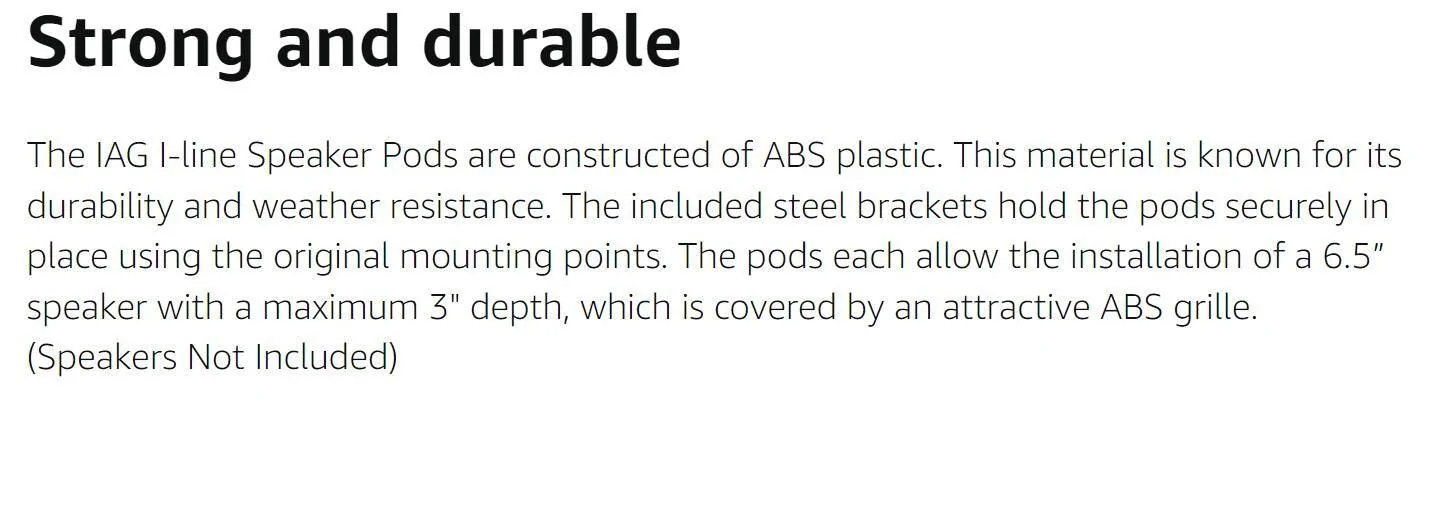

if someone made rear pods that were deeper to accept a 6.5” sub, I’d consider that too but haven’t found any that are deep.
Yeah but I don't think those door pockets are any deeper than the rear pods. The Mabett/IAG ones are 3" depth, not sure on SSV. And then there's like what @zuke linked, which are - whatever they come with.
From
https://www.amazon.com/IAG-I-Line-Speaker-Bronco-Raptor/dp/B0BXYQL48Z
(I think they are almost identical to the Mabett ones)
Ford Bronco Front door speaker pod thoughts 1735675819465-64
