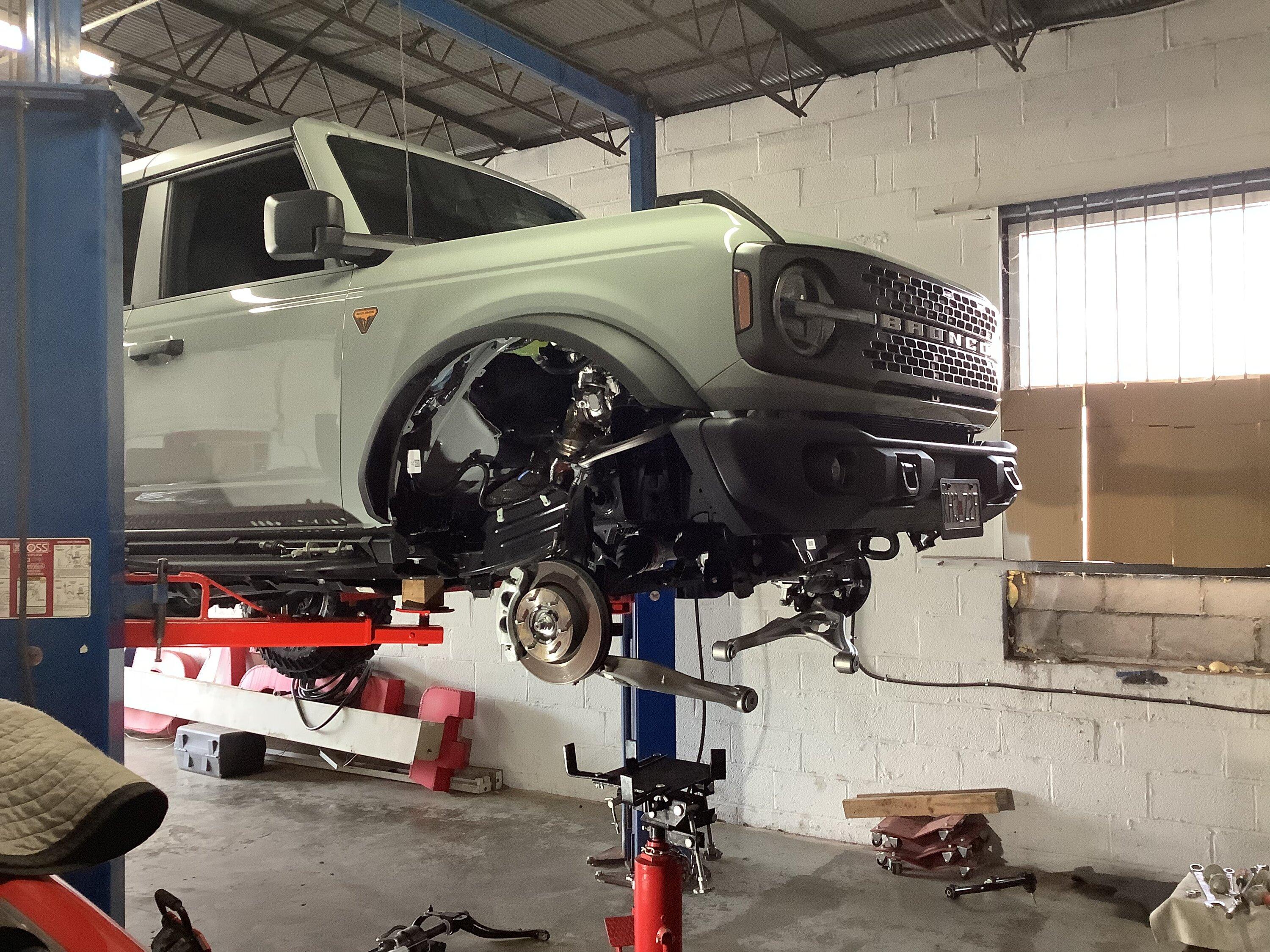

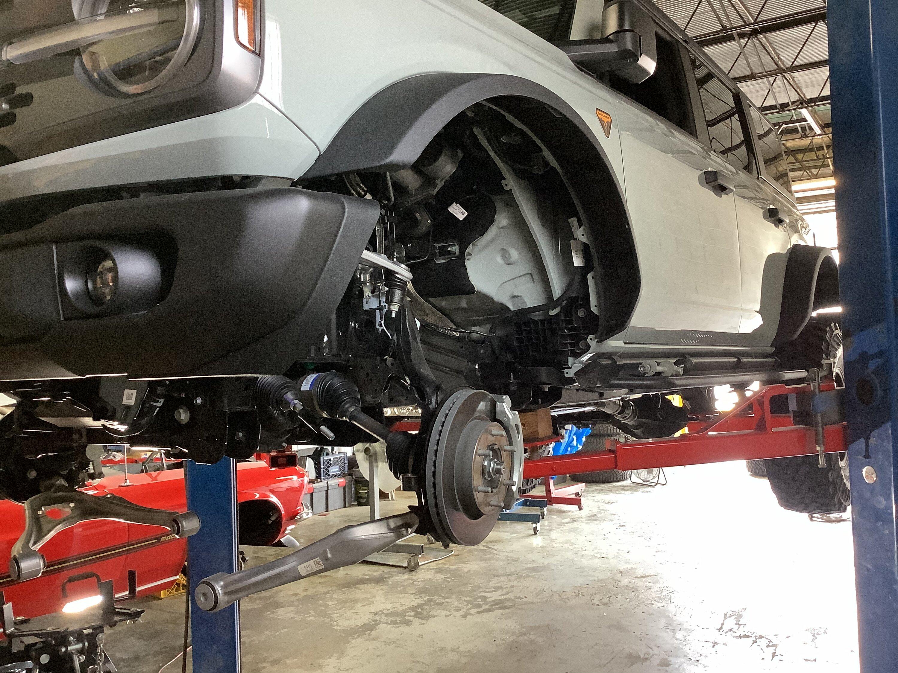

You can do an awful lot with a good suspension system. We are going to 37s today as soon as our freight shipment of metal gets here. We ran our ADS kit and the stock sas wheels and tires for a bit though. If you can only afford one right now, I’d do suspension first. We are still running our stock rack so I opted to run the stock tie rods as a disable link. We will be going to a 74 Weld rack and pinion and will install our icon tie rods we keep as spares at that time. As others have mentioned a tailgate reinforcement is recommended with a 37 on there. There is a lot to think about before going with 37s if it is anything more than a mall crawler. Just my $0.02 .
To recap, the things you need to highly consider if running 37s offroad are:
Clearance. You will need a lift
Tie rods. They need to be stronger
Rack and Pinion. It needs to upgraded or replaced as it’s not strong enough.
Tail Gate reinforcement. They tend to buckle with the added weight of 37s when off-roading
Honorable mention is front CVs. Not a bad idea to go with something stronger here as well as I’ve seen some break. This is not as common as other things though

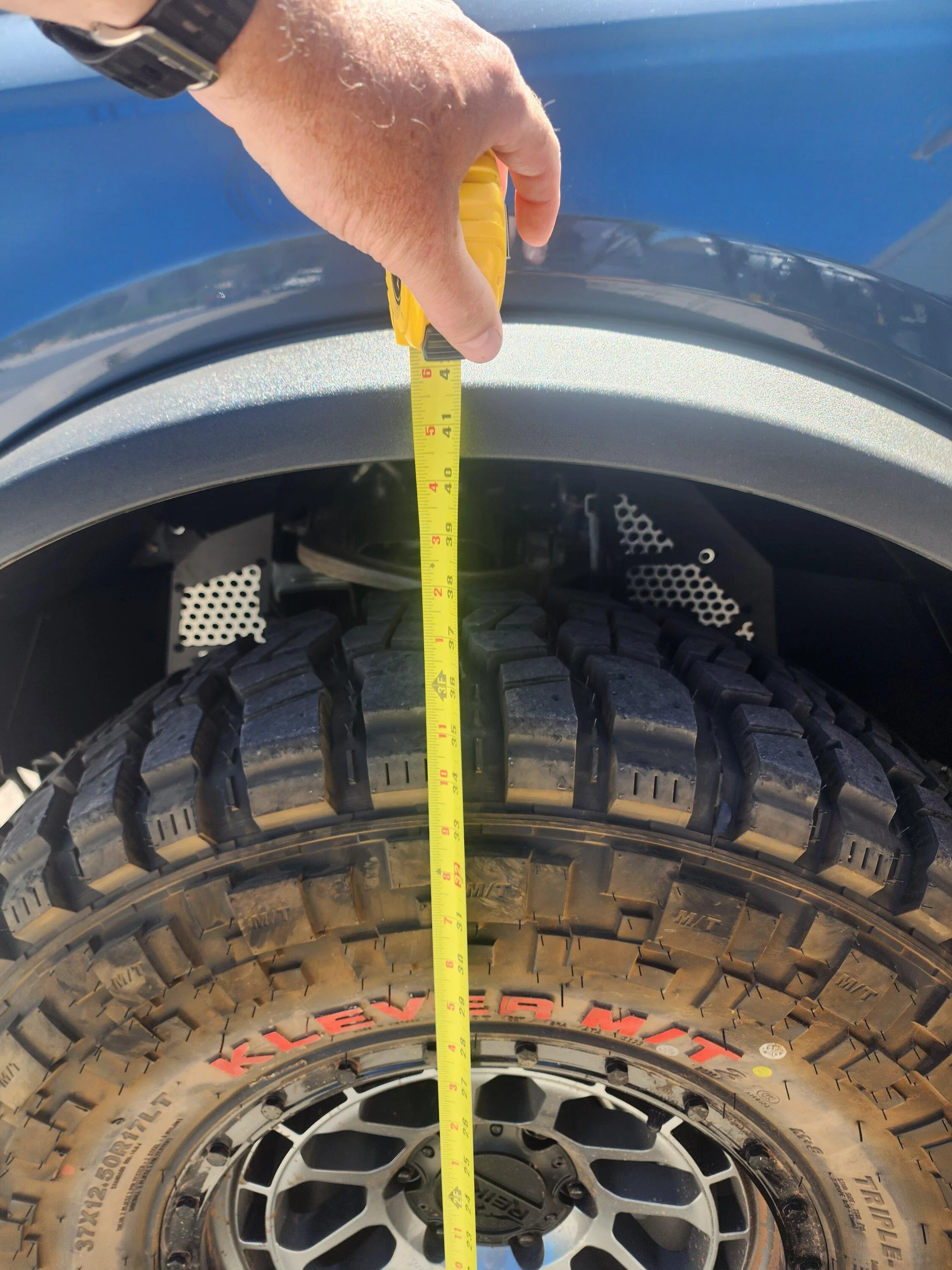

So I had the intention of 37's and yet keep the center of gravity as low as I could.
I read every forum and took a stab at it and was mostly successful but did fall short.
0 offset wheels 8.5x17
37x12.5 Kenda Klever MT/2 - (Awesome tire by the way)
JKS tire clearance, (and a sawzall)
DV8 replacement fender wells all around
1.5 perch coller ( HOSS 3.0) Front ONLY -Foutz
Front hidden winch w/ mod bumper - was causing some sag on the OE front end
NO lift on the rear
Spare tire reinforcment
No body lift
no top hat.
(Rear lower metal cloak control arm on order)
Currently has some 'poke'
Ground clearance under that hidden winch is much better
It does have very minor front rub on the fenderwell - I strongly believe wheel spacers will clear it,
Rear with zero lift, it is 'clearancing' (bending up) the back fenderwell area. I think height is needed, wheel spacers may make a difference.
I did lift the rear wheel with a forklift and didn't impact anything before lifting a second tire.

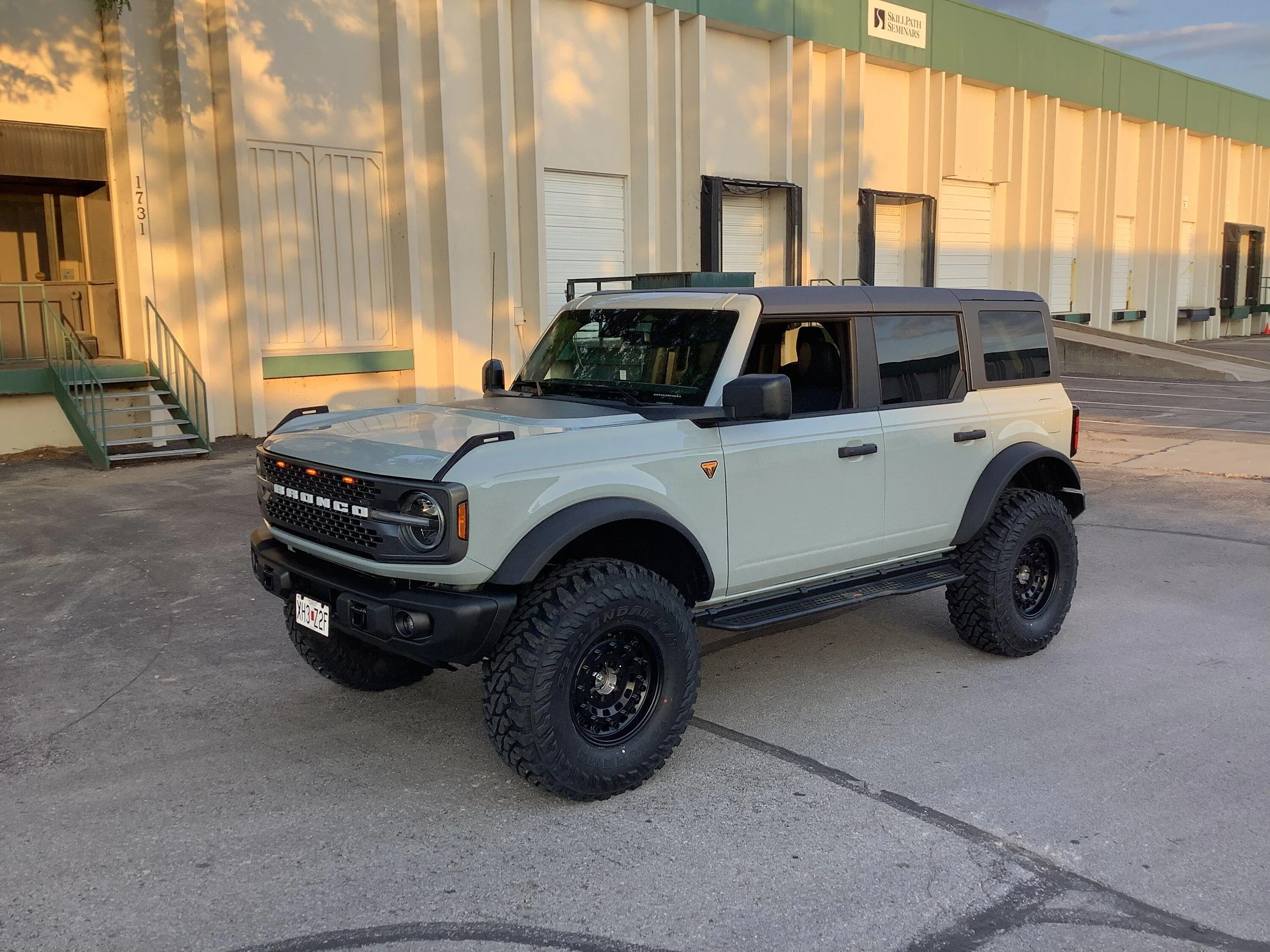

Ford Bronco Need advice 37's and Lift! front wheel -37-1.5perch-o-offset
As it stands last weekend:
Ford Bronco Need advice 37's and Lift! 20230708_113713

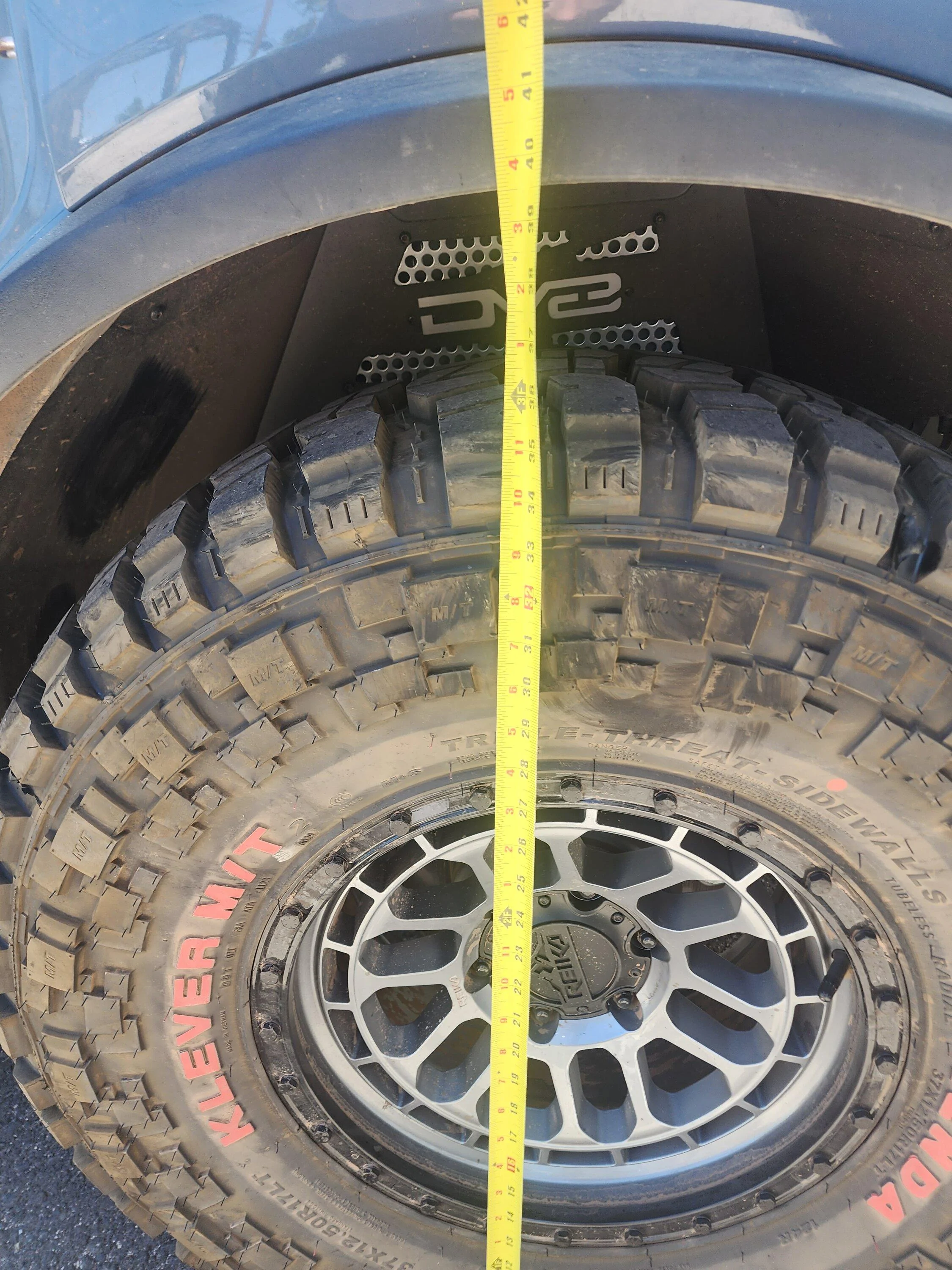

This is the rear: You can see a little rub there 9it is monir so wheel spacers should take care of that spot, but some of the rear fender liner is bent) :
Ford Bronco Need advice 37's and Lift! back-wheel-zero lift-zero offset

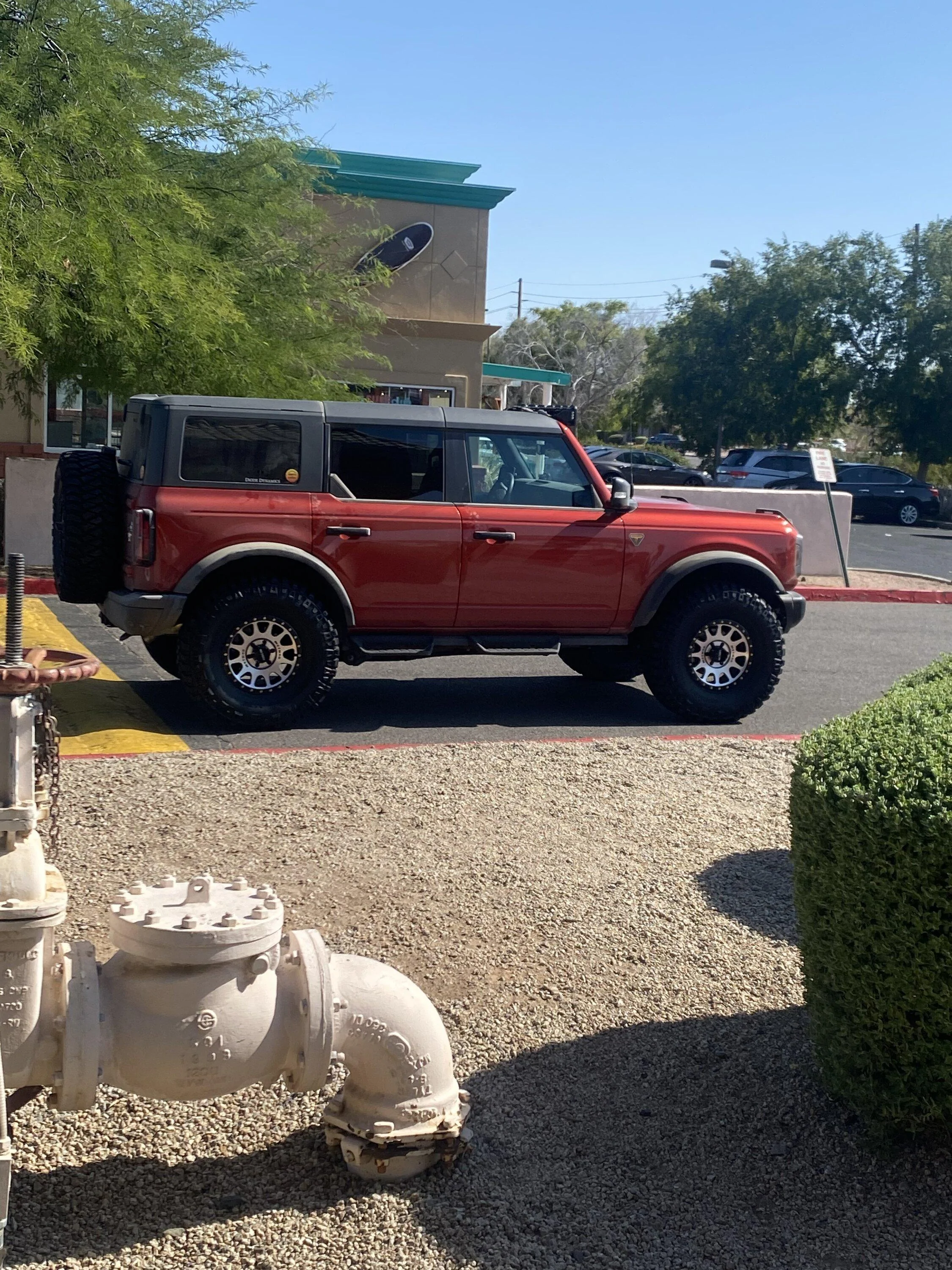

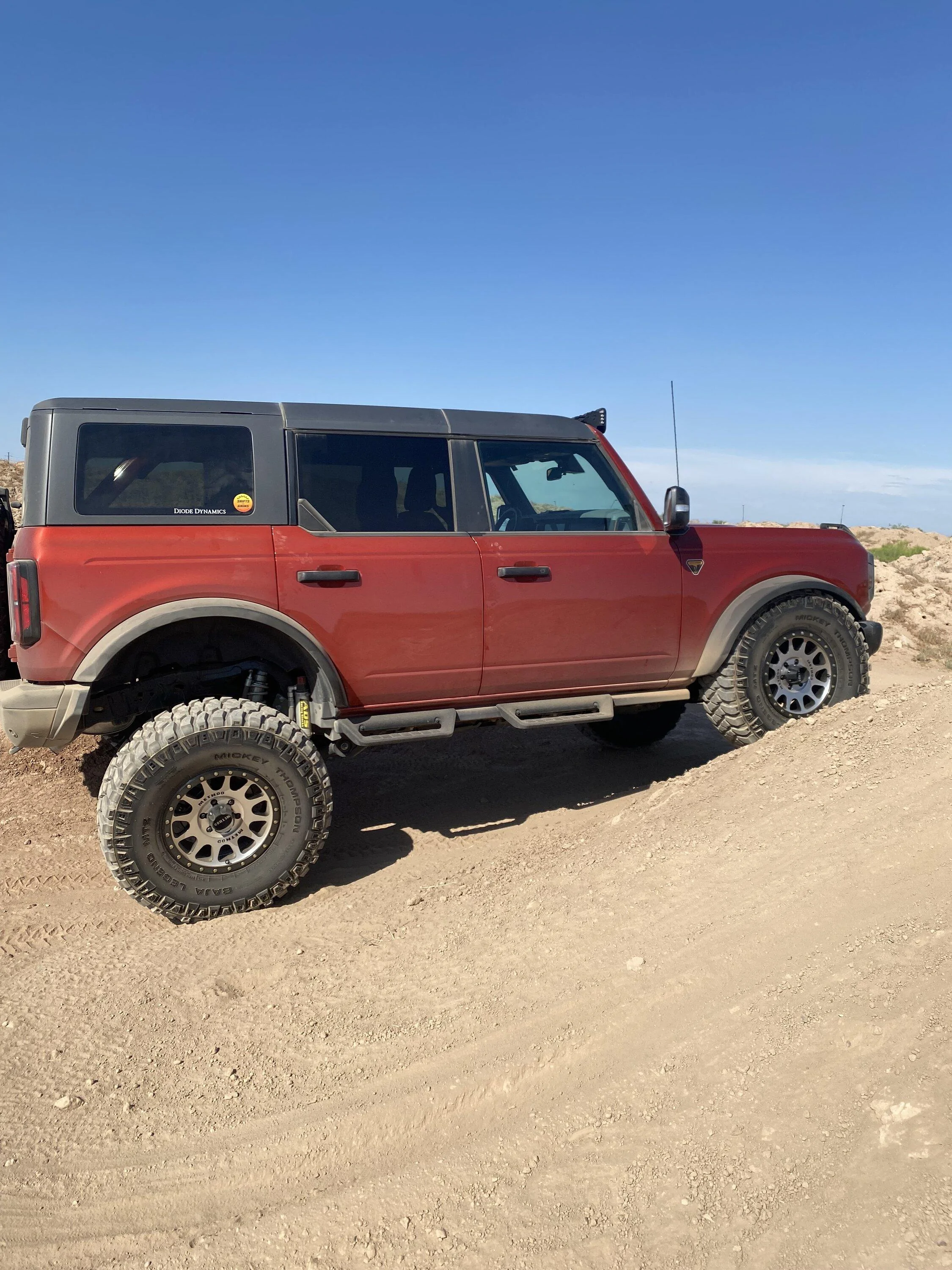

We got the wrong wheels. Wrong color and offset but the new ones are coming. Here is ours with the ADS Suspension kit and 37s. Wheels are method 305. These are 25 offset and supposed to zero. We also ordered Titanium and these are machined finish. New wheels will be in soon and we will run these until the new ones arrive. Oh it’s squatting because the 5 Sasquatch wheels and tires are in the back. I’ll get better photos tomorrow
Ford Bronco Need advice 37's and Lift! FC2B29F0-1420-40DE-993A-8602A3F2CE96

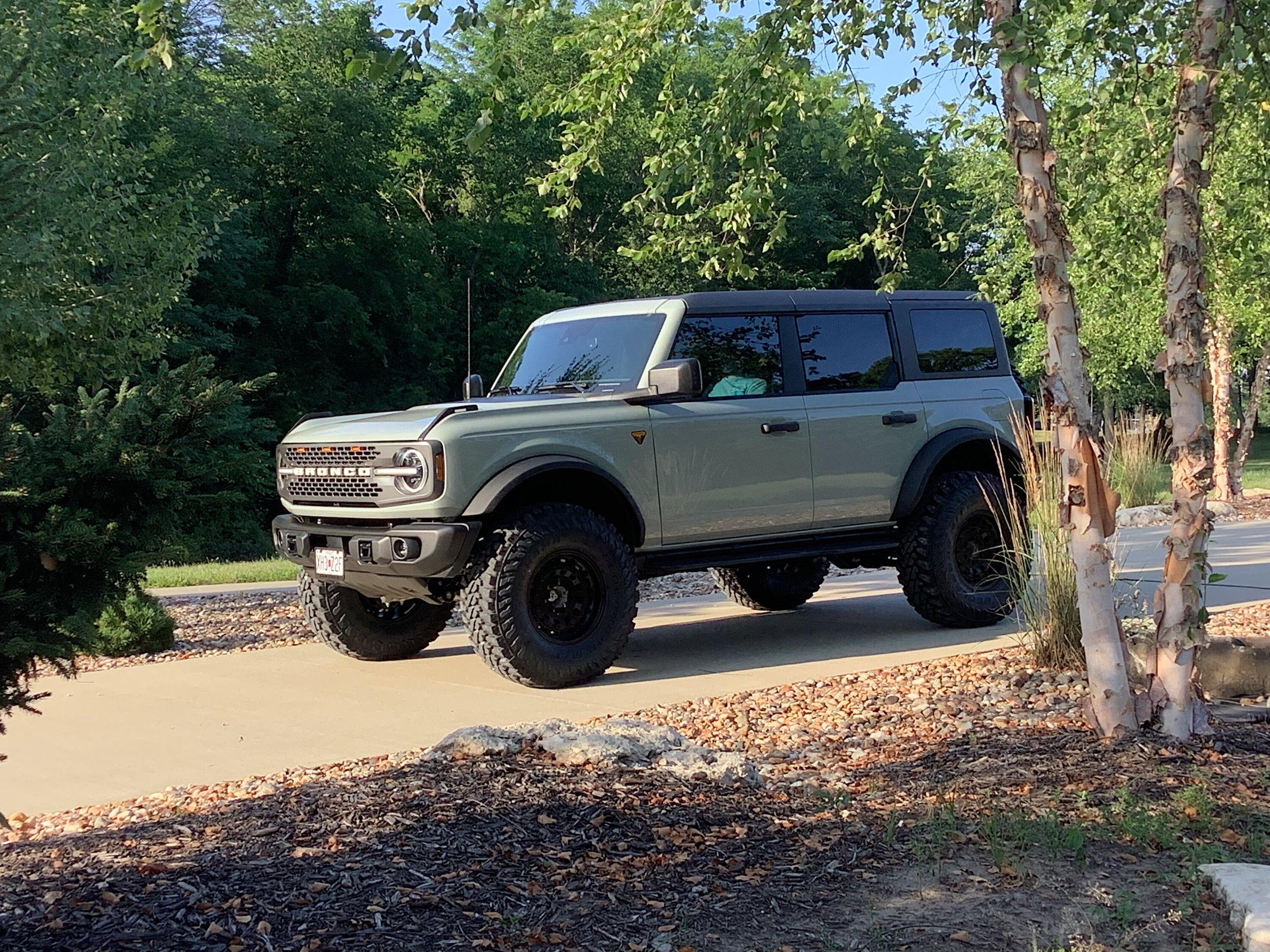

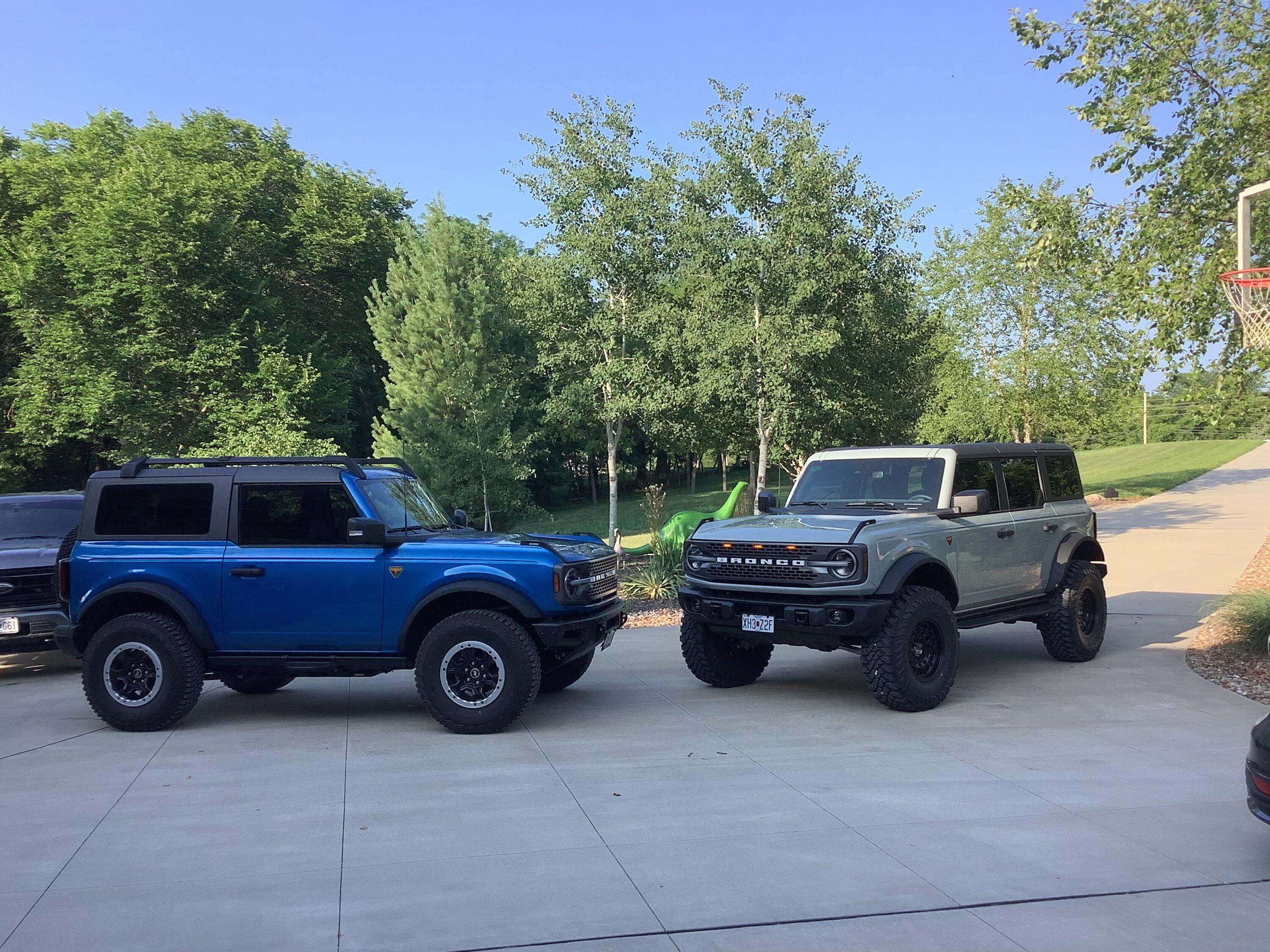

My wife’s blue and my cactus gray Bronco’s! Love the look with 37”s! Bronco looks so mean lifted on 37”!

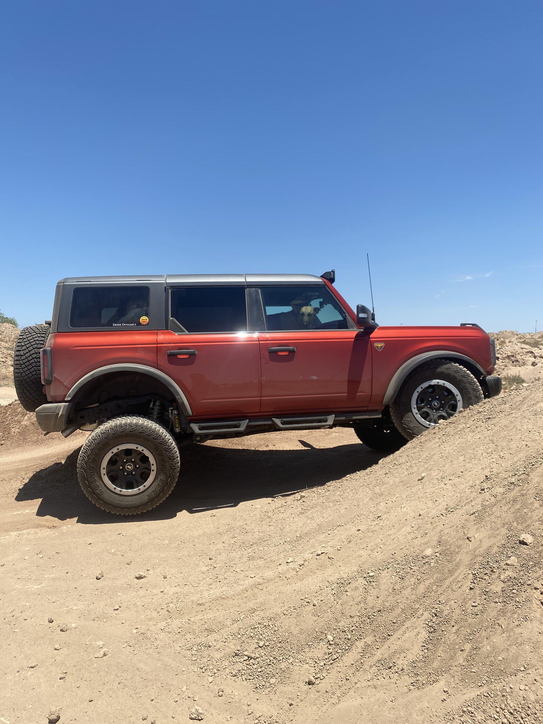

I agree that they look great on 37s. The tires stay on the ground a bit longer too. Went to my test spot to see how much preload I need to put in the front coilovers (keep in mind I won't make any adjustments until the correct wheels come in) and noticed my rear tire stayed on the ground with 37s where it lifted with the factory Sasquatch wheels and tires. I was able to change directions and get that back tire off of the ground though. The flex of the ADS kit is simply amazing. It rides like a dream too.
Ford Bronco Need advice 37's and Lift! IMG_5389
