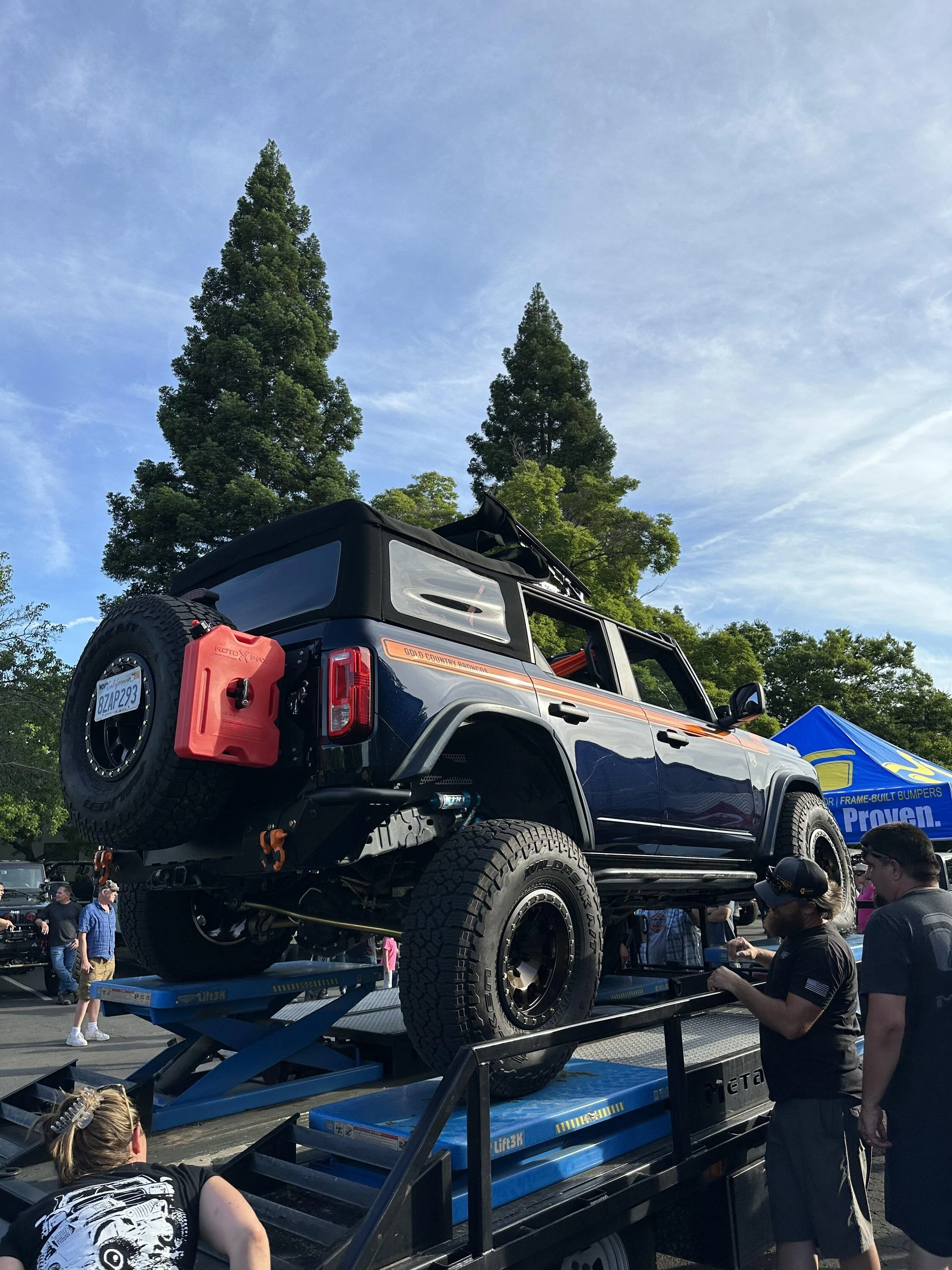

Going back to this video I made, there a lot more un-answered questions that I’m going to dive into shortly with a post as well as video going into fitting 37’s and the different issues you may run into depending on your budget, goals and setups. I’m lucky enough to be around several dozen broncos modified in different ways and for difference purposes and have been slowly studying the different brands, issues and builds coming out. We also hit trails with them constantly. I don’t have time to answer all your questions atm and a true answer would require a massive amount of typing. Which is why I am working on a huge thread that I will continually edit that goes into all sorts of topics.
That being said, I’m always down if you wanna chat to walk you through my experiences (I come from the Jeep world, am a trail guide on the rubicon for the Jamboree every year and do lots of wheeling in my Bronco on every type of terrain)
If you wanna chat, shoot me a DM and I’ll give ya my number and I’ll walk you through it all.
I’m not affiliated with any company. I just love to test stuff and try it out and compare the results for learning.

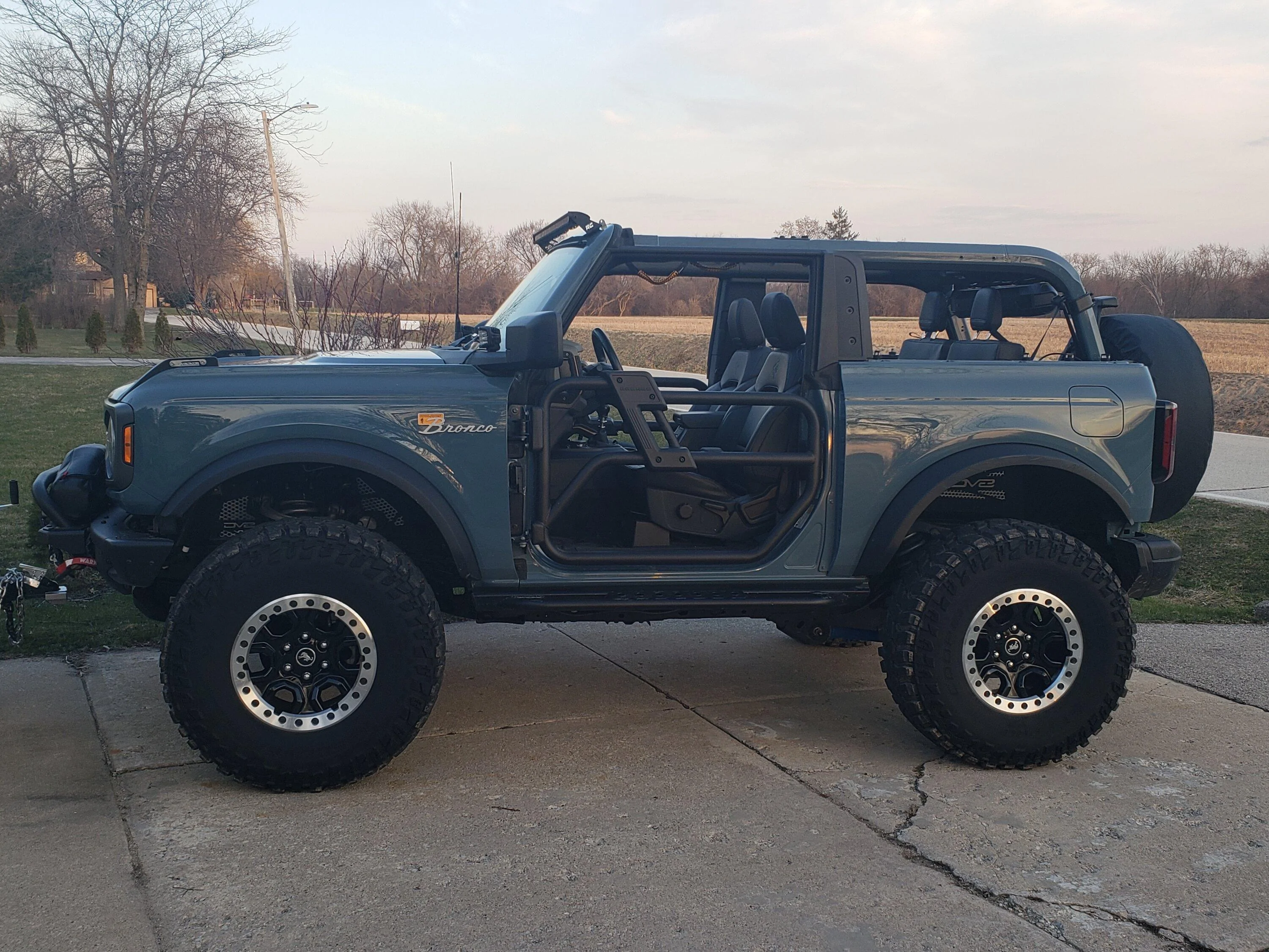

I have a bit of experience in this area, so here is my $.02. More important than suspension lift is fender and frame clearance. Stock Sasquatch suspension handles 37s and beyond NO PROBLEM! 1st off at a minimum you gotta do some frame trimming in the crash bar/front body mount area to get full turning radius. JKS big tire kit is an excellent solution...you can get enough clearance w/a sawzall and some zip ties if you wana stay cheap...but it's a much cleaner look and frees up TONS of room. KO2s tend to run small, so they should require the absolute minimum to fit cleanly (don't get me wrong, they are a GREAT tire! I have owned many sets of KO2). For fender clearance I use body lift. Some people object to it, but for me it's a tradition. Small body lift+JKS big tire kit will fit any 37 on the market w/full articulation from stock suspension...no need to even touch it! Now, on to your "tie rod" question...here there are many options as well. Hoss 3.0 tie rods will fit the stock rack, and are 2mm thicker. Icons are 4mm thicker, however, that leads to the stock rack being the "weak link" (although we have seen cases of stock rack failure w/stock tie rods). Hoss 3.0 rack swap is a common mod now. Ford part # NB3Z-3504-M. You would need it programmed, and there's a guy in TX who does them drop shipped. The racks frequently go on backorder, so if you want one don't hesitate. I use 1.5" spacers simply to widen the stance...to me it just looks right, but not required...no different from going to 0 offset wheels, just a whole lot cheaper. Dont buy cheap chinese ones tho...hub centric from a known good manufacturer. All told the answer is yes you can fit 37x12.5 KO2s on a sasquatch without ANY suspension lift at all, but that doesn't mean it wont take a little work to get full steering/articulation...however these mods will "future proof" your rig when you decide to go bigger

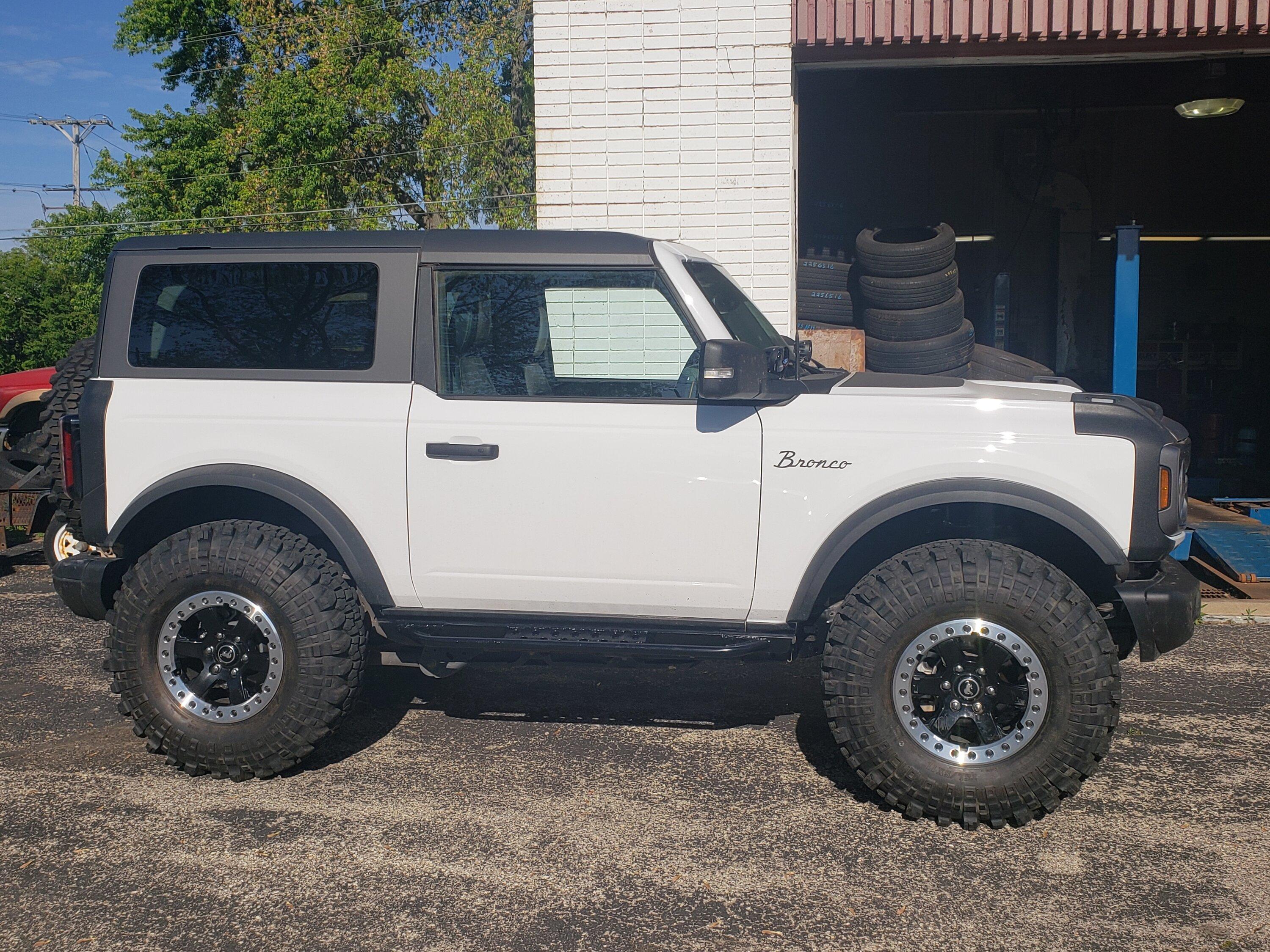

@Bmadda is 100% correct. Just get the Jks max tire kit, 1.5” body lift and don’t touch the suspension. Rides great, full articulation, doesn’t mess with geometry, and is waaaaay cheaper than other options. Regarding steering, get the bushing for driver side and some tie rods or splints Unless ya plan on going crazy off-road
