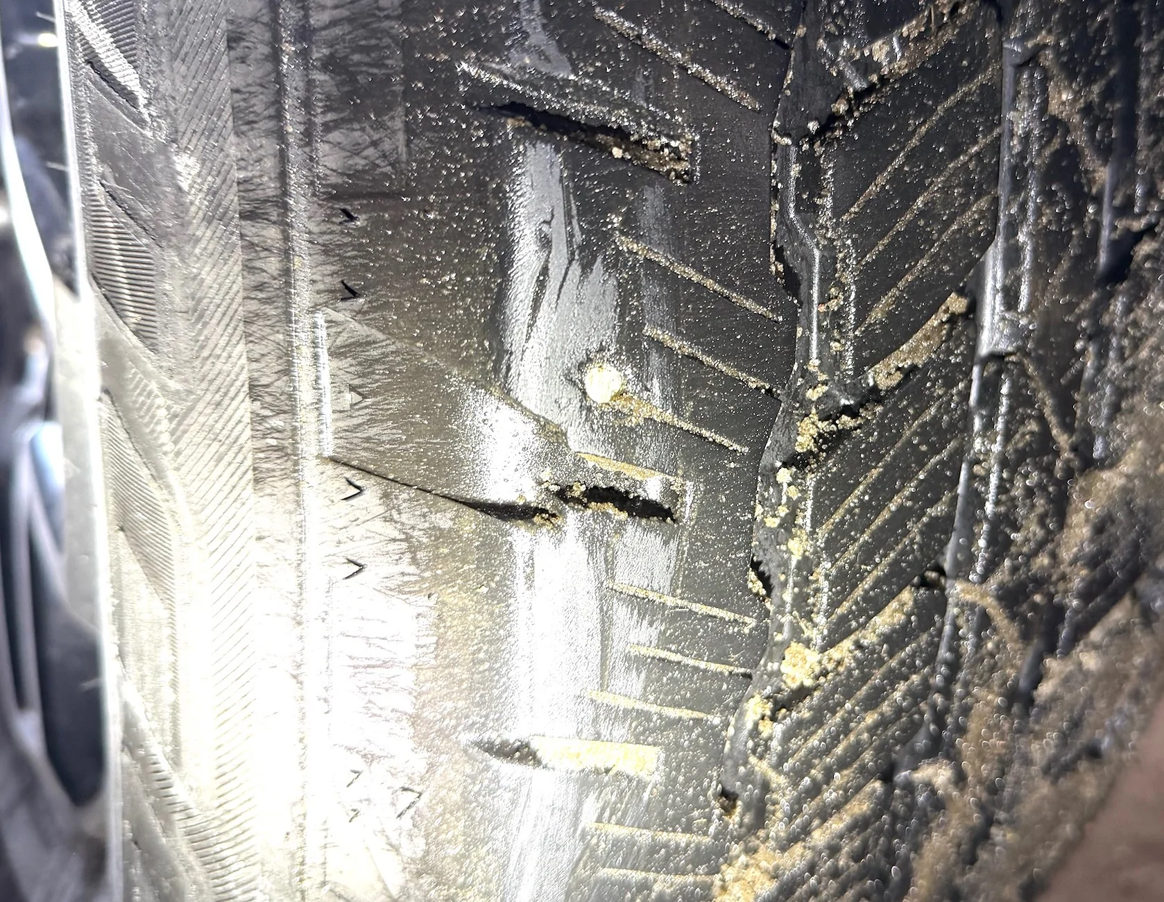

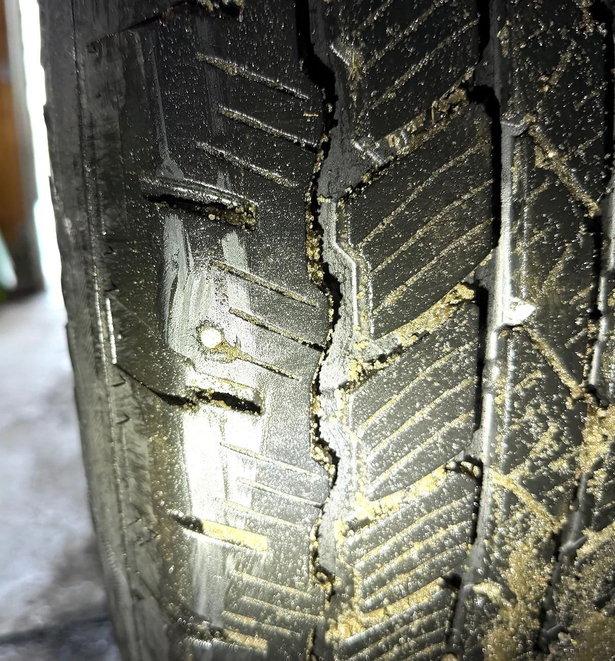

2024 4d OBX with the stock non-sasquatch tires (255/70R18 I think). Got a nail in the front right about 1/2" in (at best) from the outer edge of the tread. 20k miles.
Auto shop is wary about a patch holding given its location, especially if taken anywhere off city streets, being within 1" of the edge.
Treads on the 4 tires are between 8 and 9 32nds. My unused spare is 10/32. From what I understand, risk of replacing just the one tire is the difference in tread can damage the differential in 4wd mode when the tires are different - potentially voiding warranty as well?
Money no object the answer is to replace all 5 tires... but oof, that's a very large unlucky expense. I've got an appointment with a tire tech on Tuesday to get their opinion. This might be more of a post asking for help in accepting the reality of the replacement but... do you think I've got any other options than a full out replace?

I would patch that one. I got a nail similar to that spot in one of mine with just 700 miles on it. It's got over 20,000 now and going strong
Looking at this (practically new tires), and the nail location - I'd patch. If you only do 4-tire rotations then move this to the spare, but patches are pretty robust and I'd have no problem running it either.
Difference in tread I've always heard is <=3/32, and you are fine there. Bronco 4WD is a lot more robust and forgiving than some AWD vehicles out there.

Agree, plug & inside patch, keep rollin'....

That's not a terrible spot. Simply ream and plug it.....easy peasy.
I just plugged a Goodyear Territory MT on my 2-door HE, go figure my low mileage Bronco. So long as it's not on the side wall.

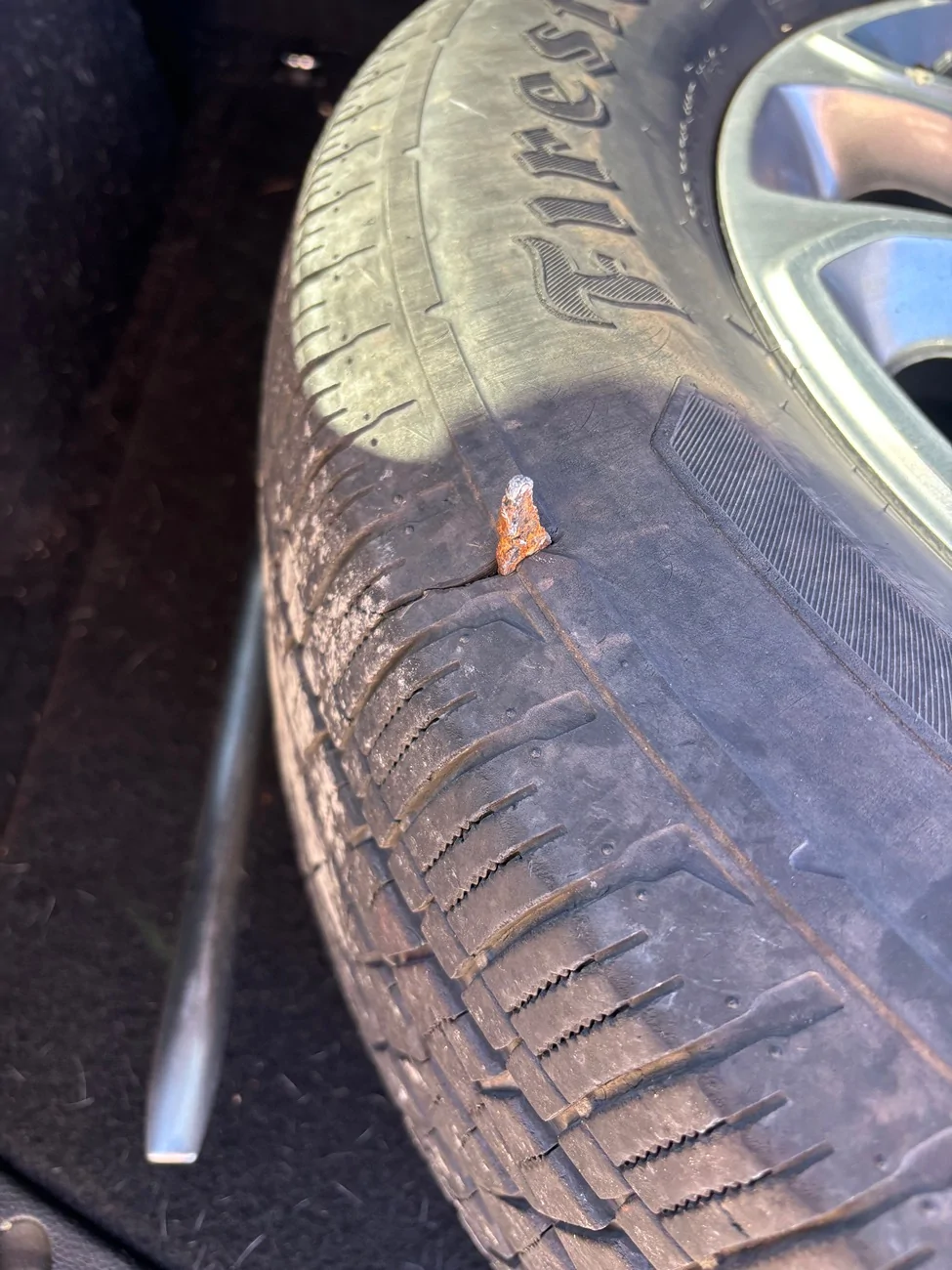

Plug it yourself and move on with your life like it never happened. Shop probably won't patch it, too close to sidewall.
