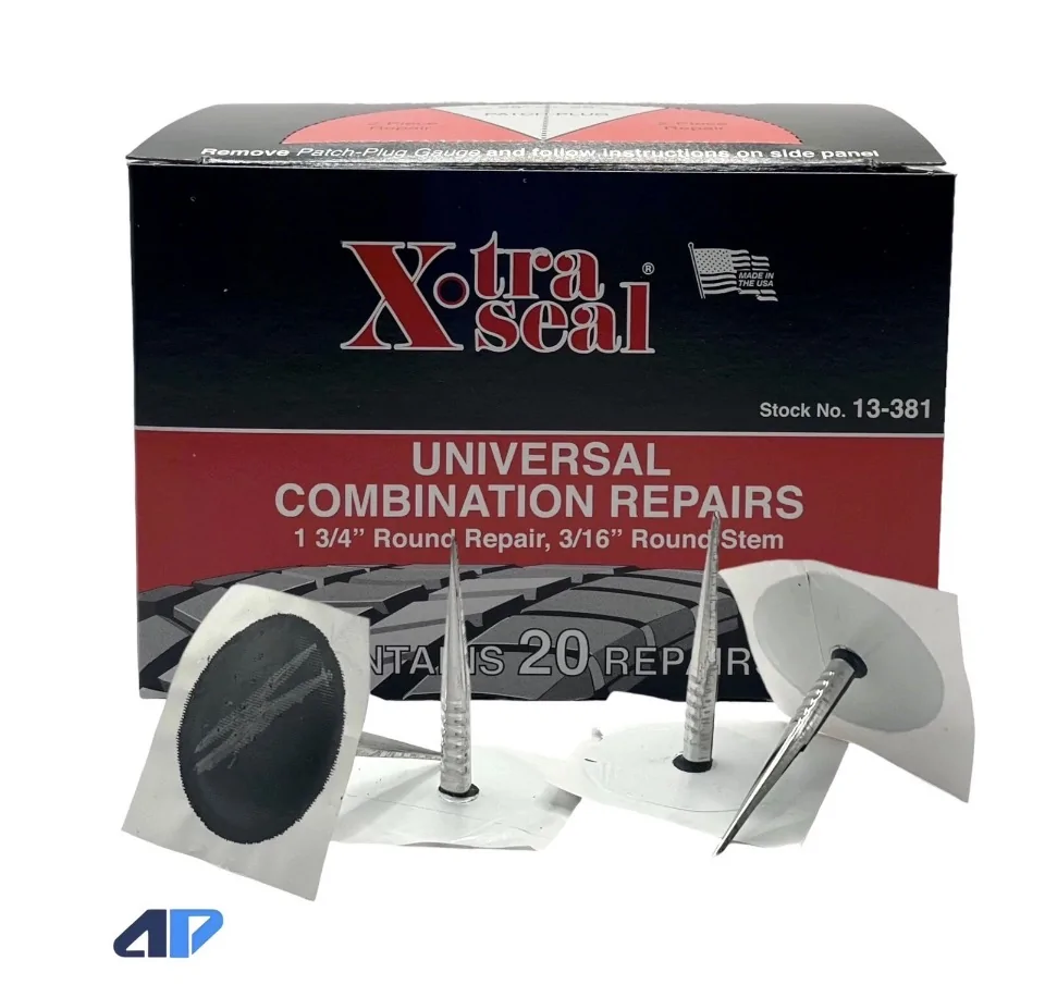

For about $4 you can get this and do it yourself. I'm hearing all good things about these:
