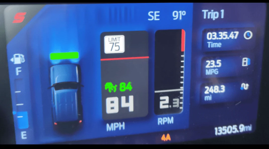

Ford Bronco MPG-what am I doing wrong? Screenshot_20240405-054529
That’s a 2.7 running in sport mode using 4A (4.27 gears) with adaptive cruise control and an average speed of over 70 mph (including a rest stop).

I would expect better mileage in a non-sasquatch Bronco OBX.
Bravo taking the pic while driving at 80+MPH!
