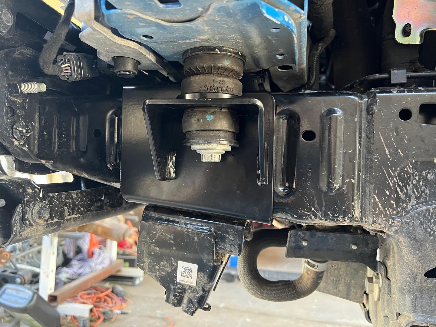

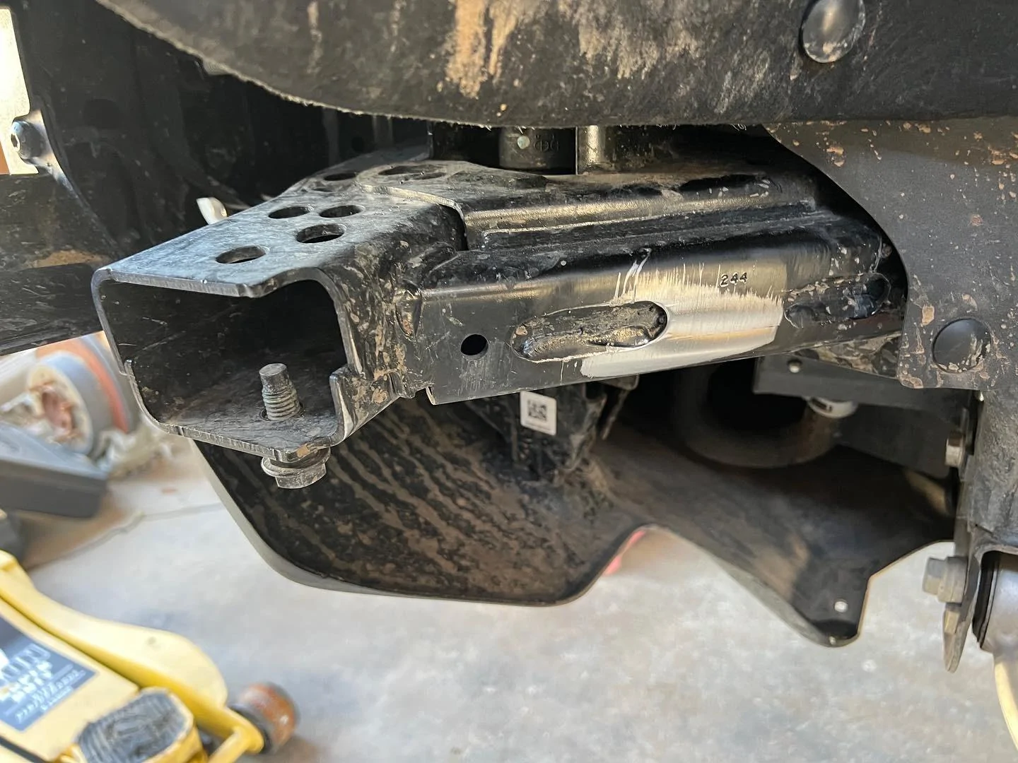

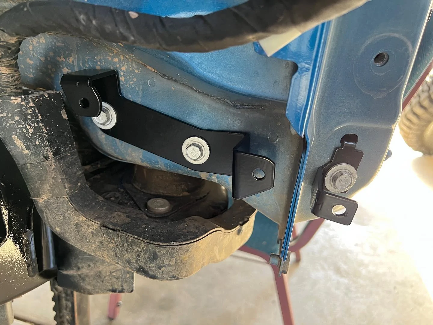

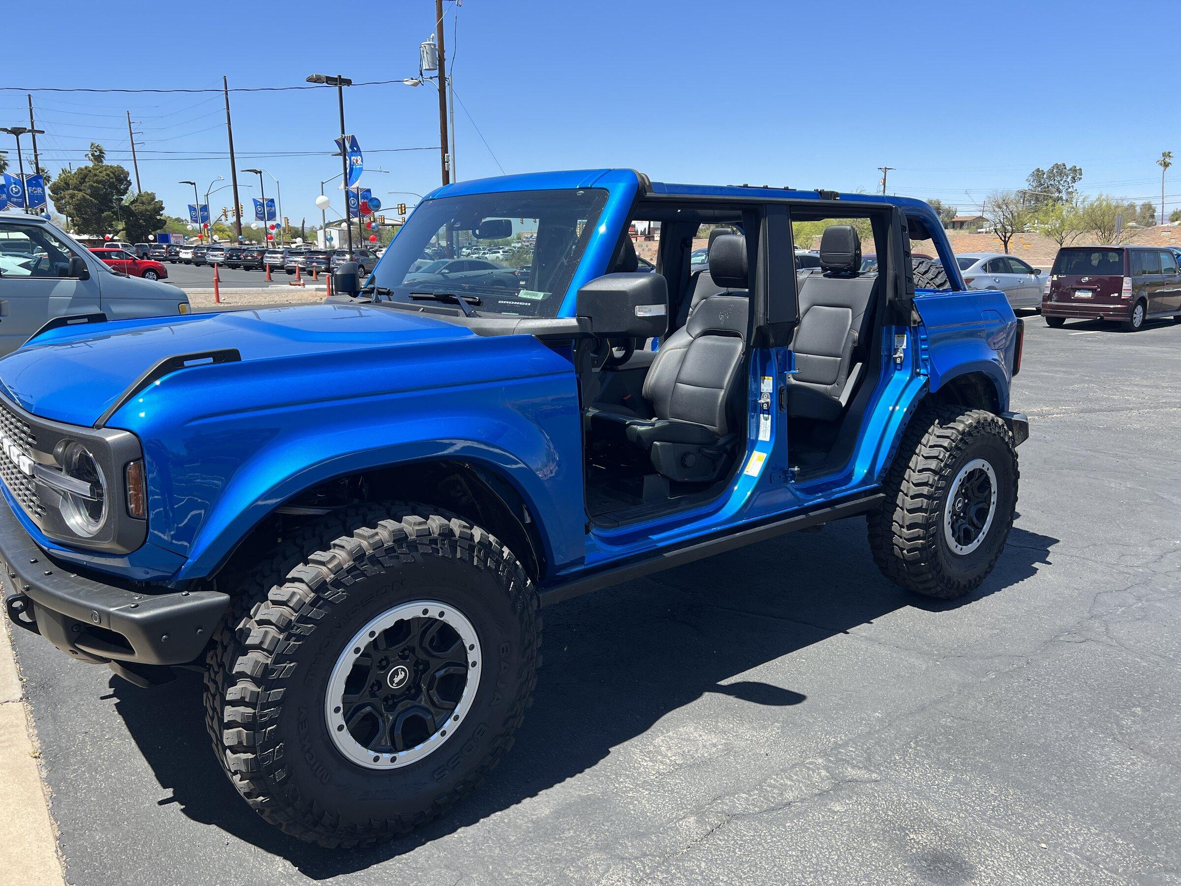

no lift is about as minimum as you can get. Lift does not create clearance. that being said lift does other things like improving brakeover, approach and departure angles.
here is mine. 37x12.5r17 mickey Thompson Baja Boss MT's which are about as true 37's as you can get. I had rubbing on the front crashbar mount so I used the Big tire clearance kit and now am good to go.
have you tested on trails for clearance during flex and such ? looks good.

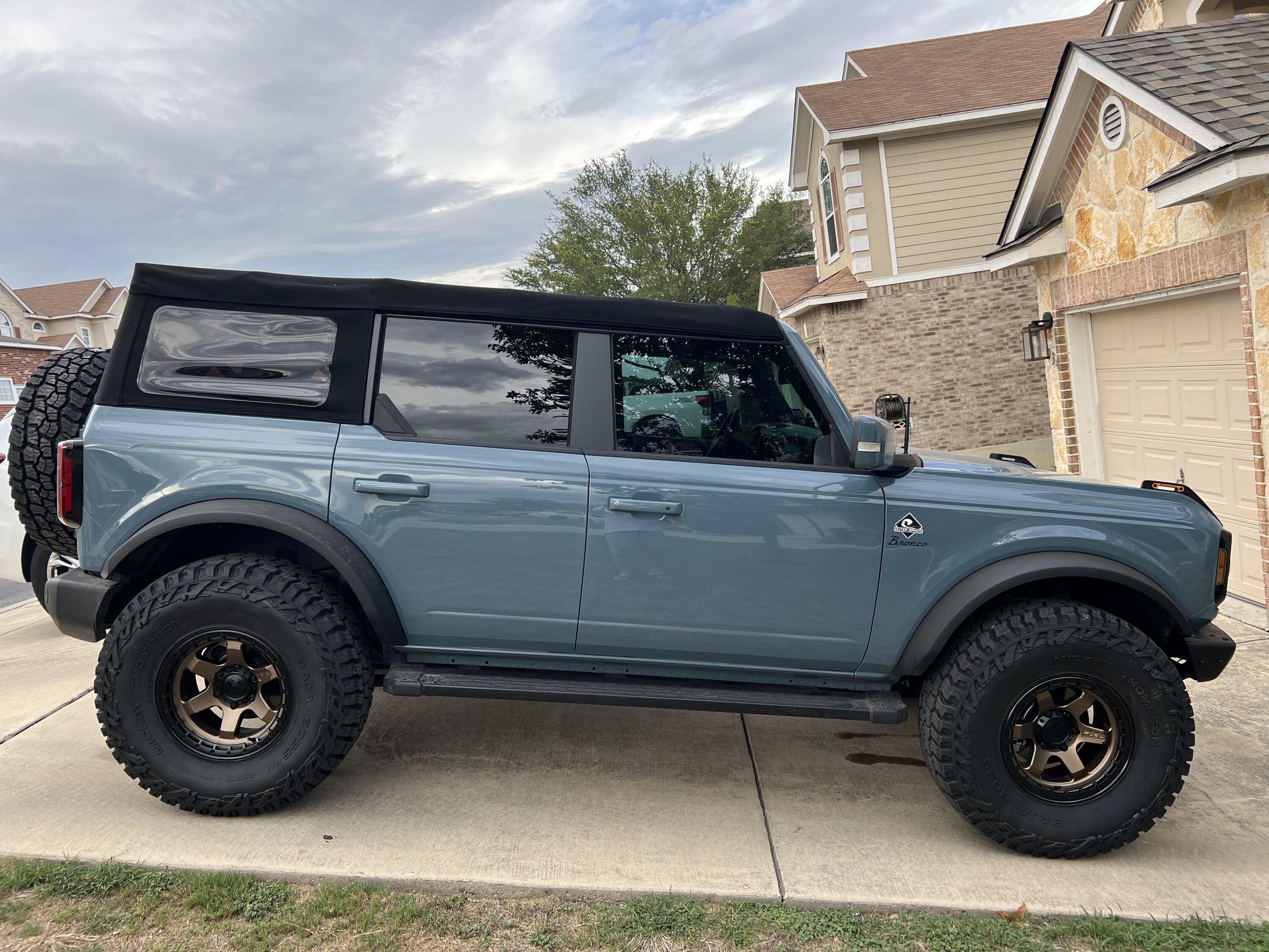

I have the same tires just put on, the Mickey Thompsons Baja Boss, but I went with the A/T's for less road noise as I don't do a lot of "hard off-roading". I did do a 2" Zone Lift to adjust the stance. The only time I get slight rubbing is full lock reverse out of my driveway. I thought with the Sasquatch the crash bars were deleted, so I don't think I'm rubbing on those since mine is Sasquatch. I looked at seems to have plenty of clearance, but haven't really done a full test to view.

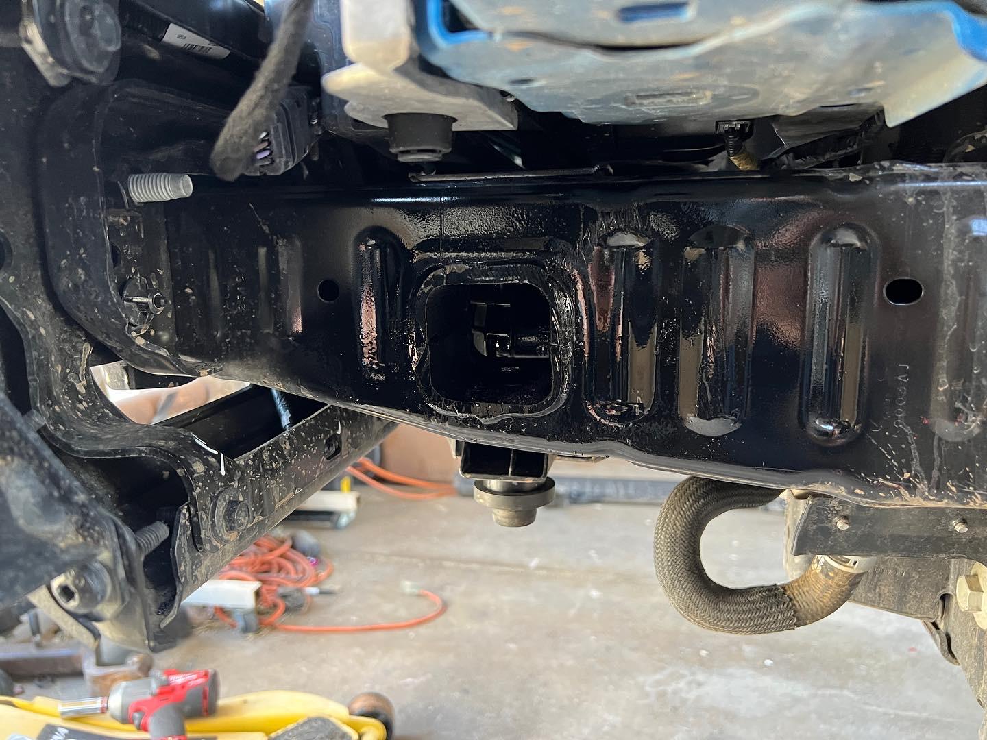

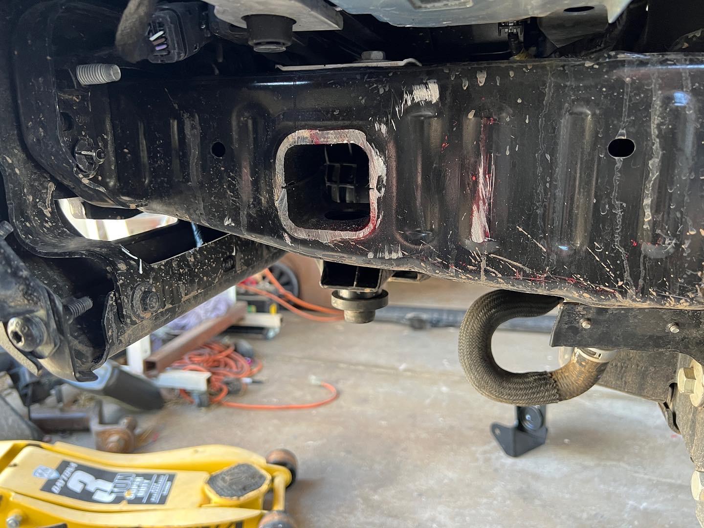

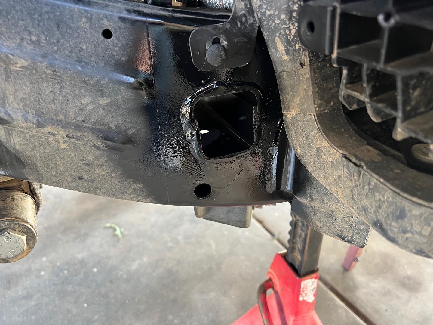

You'll need to remove the parts the interfere, that's more important than a lift for running big tires.
Ford Bronco Minimum lift for 37’s? 2022OBXAfterLift

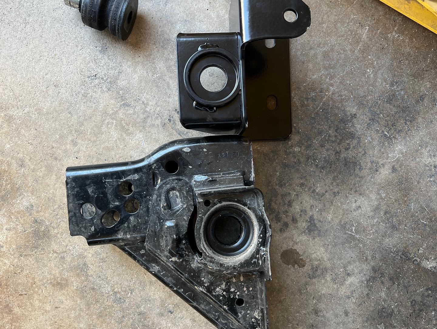

Looks awesome!! I removed the mount the crash-bars go into. If you’ve heard it rub a couple of times just look around the paint rubs off pretty quick and you will see.
Ah got it, will check for that then, thanks for feedback! Is removing the mount for crash-bars pretty simple? I think I saw in a thread you can use a reciprocating saw to remove them?
