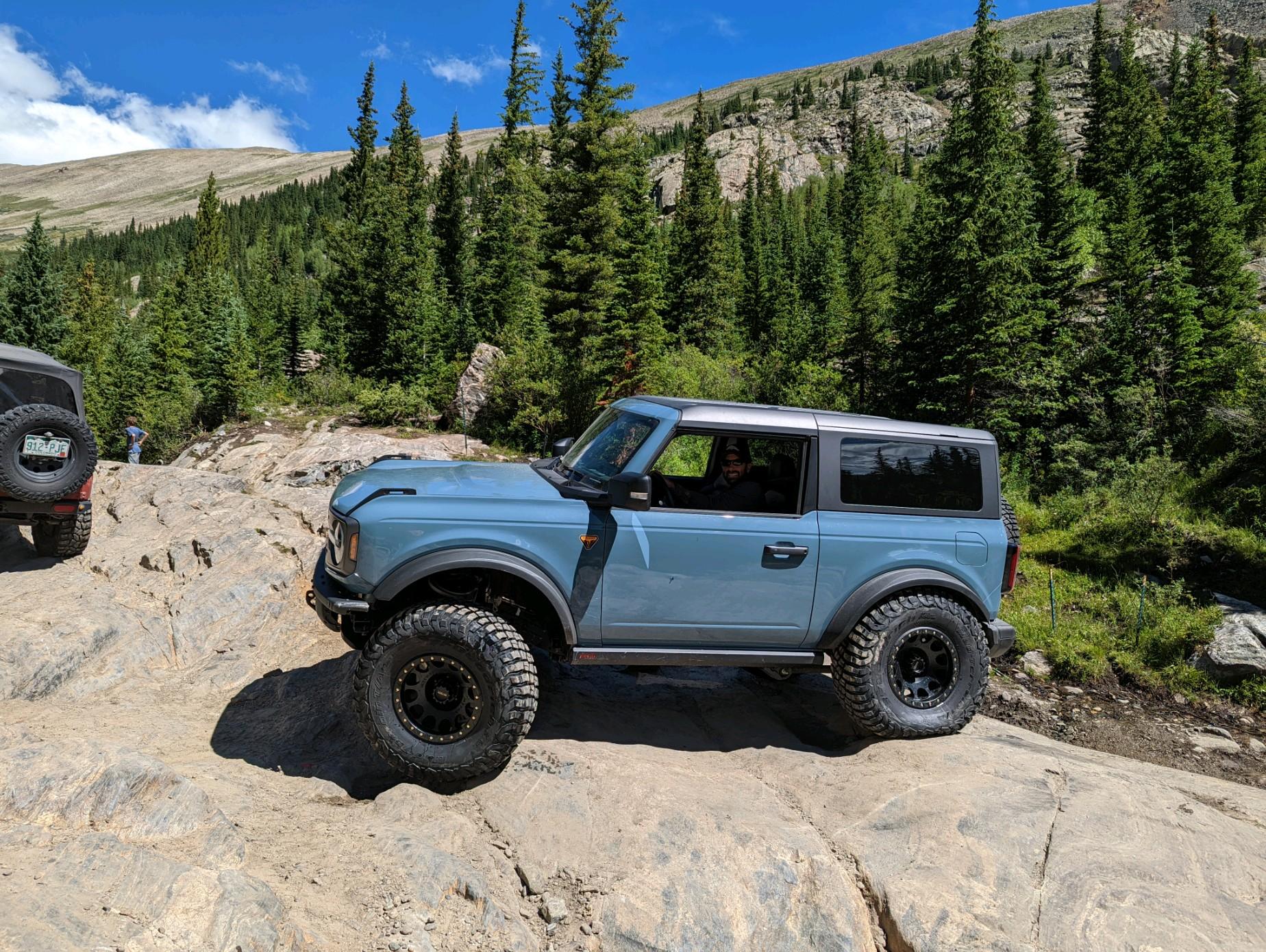

I did all these things on mine, and the last thing I had to do was remove the plastic fillers between the rear of the wheelhouse, and inside of front fender/firewall (the black plastic things that look like milk crates). Dunno what those are called, they just bolt on w/3 bolts. Now I'm golden, other than my wheelhouse got torn up good in the experimentation process. I have 2" of body lift and 1.4" borne spacers. No suspension other than a 1" level to even out the rake from the winch. And ya. I have wheeled it!

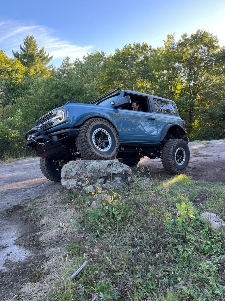

37 km3s. No lift, removed the big plastic blocks, took the ends off the modular bumper…..wheels are -38mm offset so didn’t have to do anything with the crash bar/body mounts. I’ve wheeled it quite a bit and it will rub the flares at full flex but hasn’t been a big deal. I have fiberglass fenders coming so that should eliminate that.
