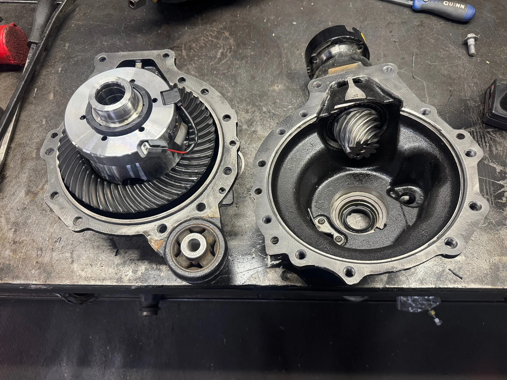

They claimed I fried the unit because I didn't use their harness that they sell separately which is nothing special. I wired it just fine using an OEM pigtail, but they wouldn't help at all. I believe my supplier actually had to buy the unit from Dana as they don't have any part of the warranty. BUUUTT, I just happen to own a full blown differential shop and can easily replace this. If I didn't have access to a full shop with differential knowledge, this would have been a terrible experience.

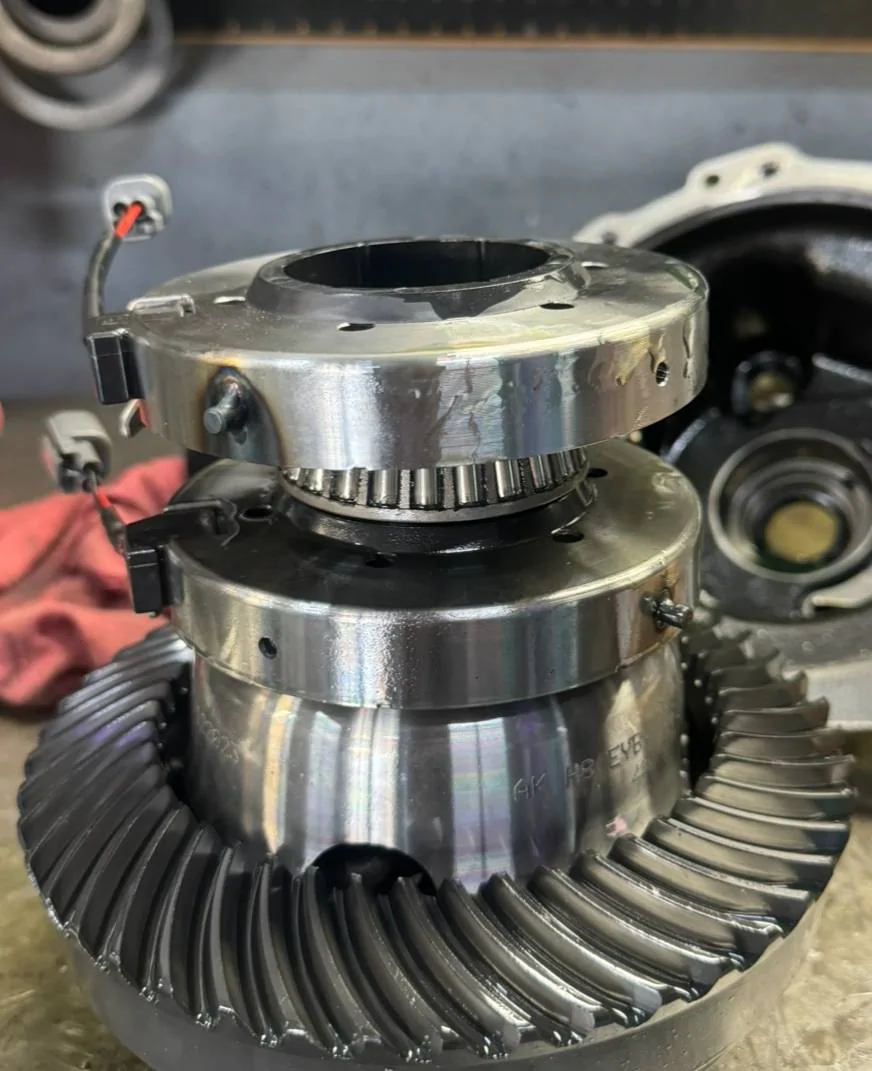

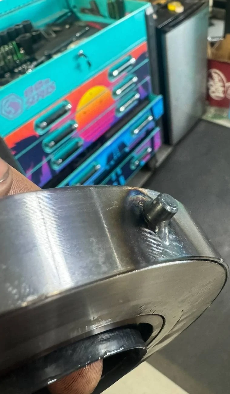

Well, to add to the frustration, this magnet came with the pin welded into the wrong spot.. had to machine a pin and weld it into the correct spot.
I noticed the P/N you had was for the rear end coil (10102021).
The m210 coil p/n is 10137577 according to this. Looks like the only difference is the location of the pin... and the fact that I can't find any place that sells it.

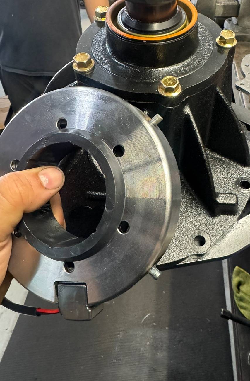

I had one where I didn’t get the little plastic shim ring on the back of the coil, and that will cause them to blow for some reason.
I wonder if that's what's happening?? I remember reading your post about that now, I didn't check to see if that came on the new unit.

Just found a picture where you can see that area, looks like it may be missing…

Yeah very silly that it doesn’t come pre-installed on a replacement part, and very easy to miss

Just Wanted to update this. Broke A CV axle on the trail Saturday and since I had to tear it down for that, I decided to dive back in and replace the locker magnet AGAIN. This Time I made sure the isolator shim from the original was installed and made sure I put + to red coil wire. And She finally works!
