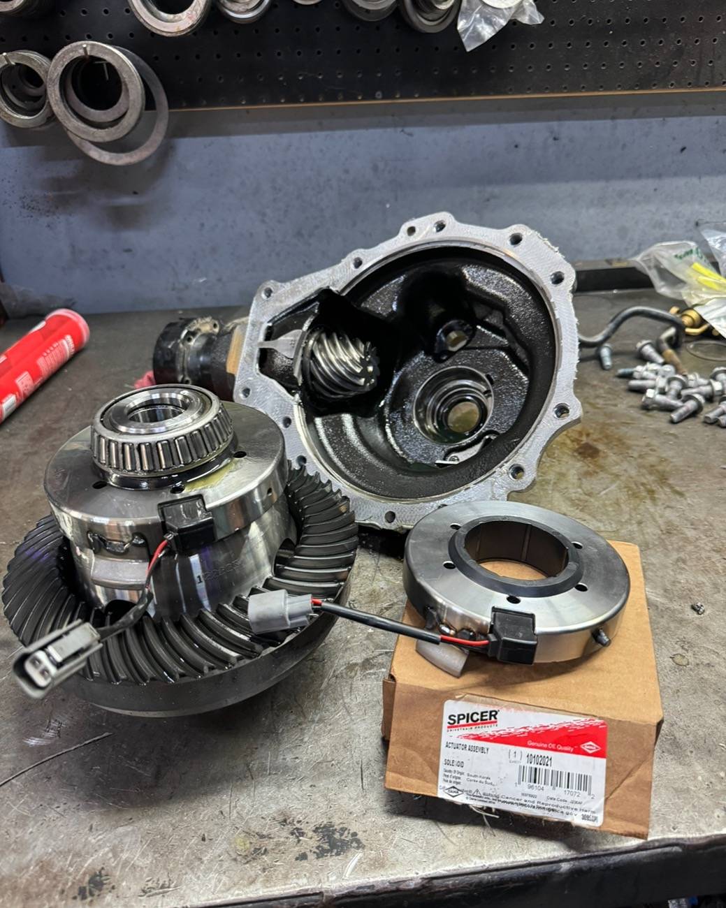

Got it to work intermittently in the shop again and thought maybe it would function under load. Took it on one of the hardest trails in Ca and the new front differential did great. But every time I needed the locker it popped a fuse lol. Still made it all the way to the lake without it luckily.
some pics
Ford Bronco M210 Locker Blowing Fuses IMG_2094
Ford Bronco M210 Locker Blowing Fuses IMG_2093
Ford Bronco M210 Locker Blowing Fuses IMG_2096
Ford Bronco M210 Locker Blowing Fuses IMG_2113
Ford Bronco M210 Locker Blowing Fuses IMG_1813
coffeetwitch
Aug 21, 2022
71
46
kansas city
bronco
youve got a bad coil, or more likely a damaged harness in the fdu. im doing the same thing to my bronco this week and just checked. rear 3.7 ohm, front 3.7 ohm.

Well, months later after being denied warranty from Ford, my supplier was finally able to get a new magnet from Dana/Spicer. Old one ohms 0-0.1 new one ohms 3.7-3.9.
