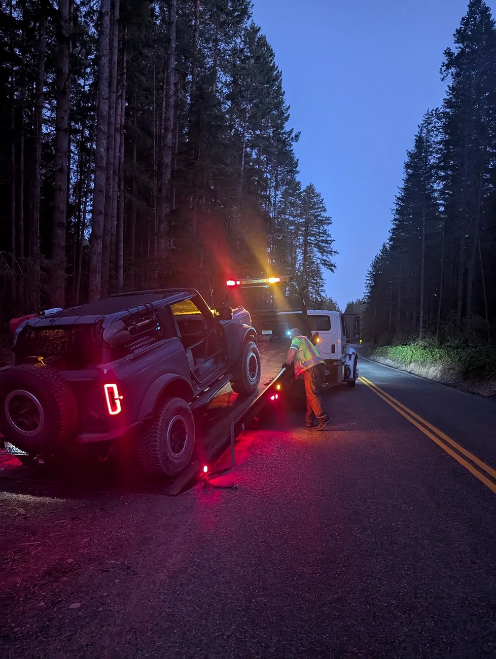

Confirmed LPFP failure. Being covered by the PT warranty. Interesting the recall affects a single day of production of Super Duty trucks at the Ohio plant. Might that suggest it's an issue with a certain supplier? I wonder if Ohio had maybe transferred pumps from another plant to cover a pump shortage. It's a lot of affected vehicles, I got to think they resolved the issue in pretty short order once they knew of the problem rather than take a fix it later approach. When it died, temps were mid-80's and I had about 3/4 tank on the gage. I wouldn't call that "hot" or "low fuel level".
I'd love to have some shred of confidence this new pump won't suffer an untimely demize, even though the first one did make it to 22,630 miles. If it had died 30 minutes earlier, we would have been on trails that would have made recovery "challenging" at best. 30 minutes later, we could have been on the Tacoma Narrows Bridge, old Galloping Gertie's replacement(s). Good Lord that would have been a complete snafu if we died on the up grade of the East bound approach. We very well could have made the 11:00 news. If we survived the incident, the Found On Road Dead jokes from my "friends" would have been insufferable.

That's about when mine went out (around 23K). It certainly threw codes after the fact, but I don't believe there was anything before hand. When it happened, it happened quick with about 10 seconds of for warning with mucho sputtering and complete loss of power.
I agree it is completely ridiculous there is no "fix" for the recall yet. Somehow they were/are building vehicles that are outside the recall but they can't fix the vehicles within it? Come on Ford! I would think the have had to identify the root cause to bracket the affected vehicles. I wonder, has anyone had TWO LP fuel pumps go out on them?

@Snowdogyyz and @Wildsnak, they say high ambient temps and low fuel levels aggravate the LP fuel pump issues, but mine failed at about 85F and about 1/2 tank. I would not call that excessively hot, or low fuel. Ive had the performance tune for awhile now, but some of your issues might be the stock fuelling/shifting schedule, which was less than perfect. I did not notice any kind of symptoms that might suggest the pump was going south until we were cruising at about 45 mph and it just started dieing. We got to the side of the road quickly, it sputtered for about 5 seconds and died completely. It would crank and try to fire off, but that was about it. Solution?
