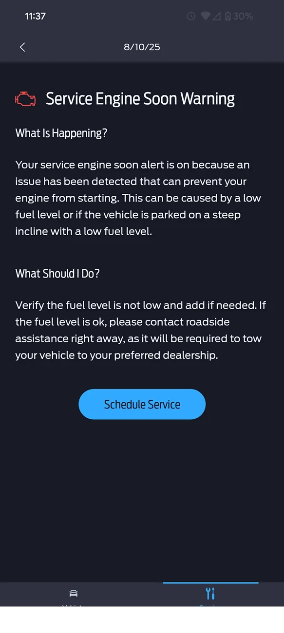

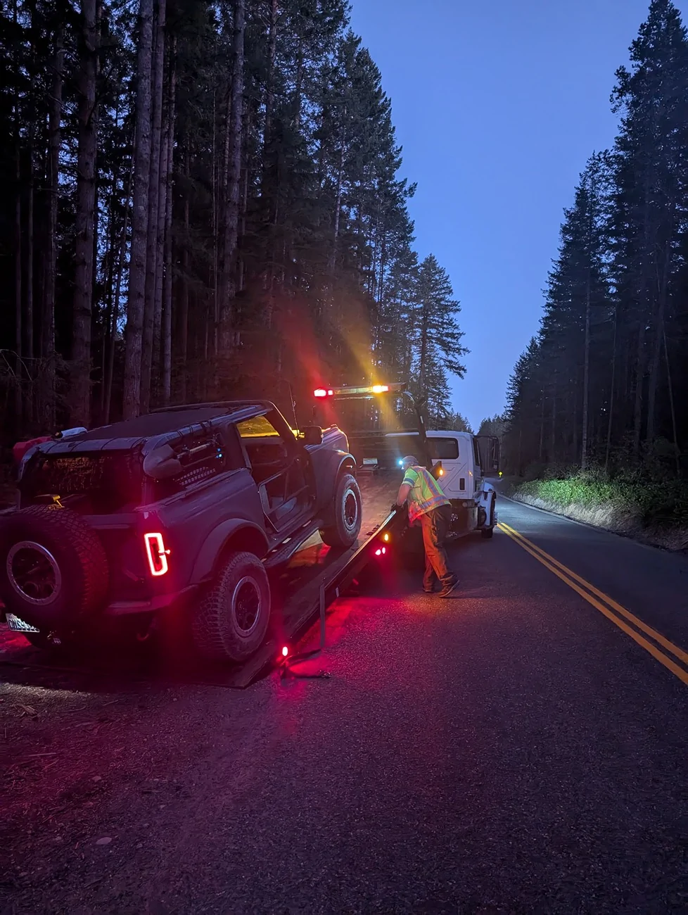

So, had just got off the trails today in our '22 WT (built 12/21) to head home and the check engine light comes on and she lost power. Got off the road and she died....Found On Road Dead. Auto start was disabled, but dash said "manual restart required". She would crank with gusto, but only sputter a bit and weakly fire. As soon as the starter motor quit, she'd die. Cell service was limited where we were at, so the app was not helpful. After a frustrating bout with AAA, we found our own tow truck company and got it hauled home 4 hours later.
Got it off the truck, and I'll be damned if it didn't start after a longer than normal crank session, but she died as soon as she got in the garage. The exhaust had a very odd smell to it, like old varnished gas would have. It's not old gas and it ran fine for the first half of the tank.
Now we are home, the app is giving the information below about low fuel level, but it's got more than a half tank. It actually started on a slight up hill grade, then died in the flat garage.
@Ducati1098, would you suspect this could be the LP fuel pump? I do have the recall notice. I just didn't want to take it to a dealer and have it sit for weeks because there is no resolution to the recall. Do you think they'd prioritize me with an inoperable vehicle?
It was a bummer conclusion to a great day on the trails, but it would have been FAR WORSE if it had happened an hour earlier! That tow truck wasn't making it up Door Bender, and I sure as heck wasn't pushing it!

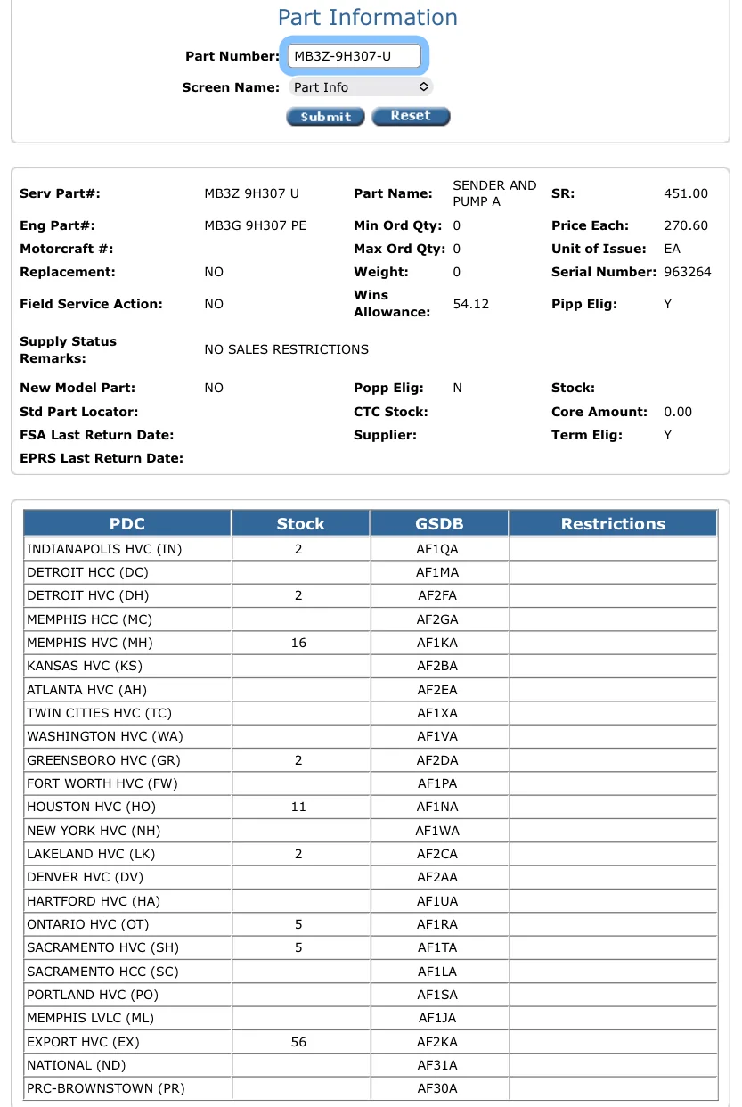

Sure sounds like fuel pump is a possibility. Hard to say for sure without diagnosis.
If it is the pump, and as far as prioritizing the repair, I looked up the current 2dr fuel pump and Ford still shows plenty of stock right now. There’s nothing to suggest a stop sale on the current part or anything like that.
Obviously we don’t know what the exact recall repair is yet, but any dealership should still be able to order the most current part number and have it replaced pretty quickly. It won’t close the recall or anything and that will still likely need to be done when it’s released, but it will get you back on the road if that’s the cause.
