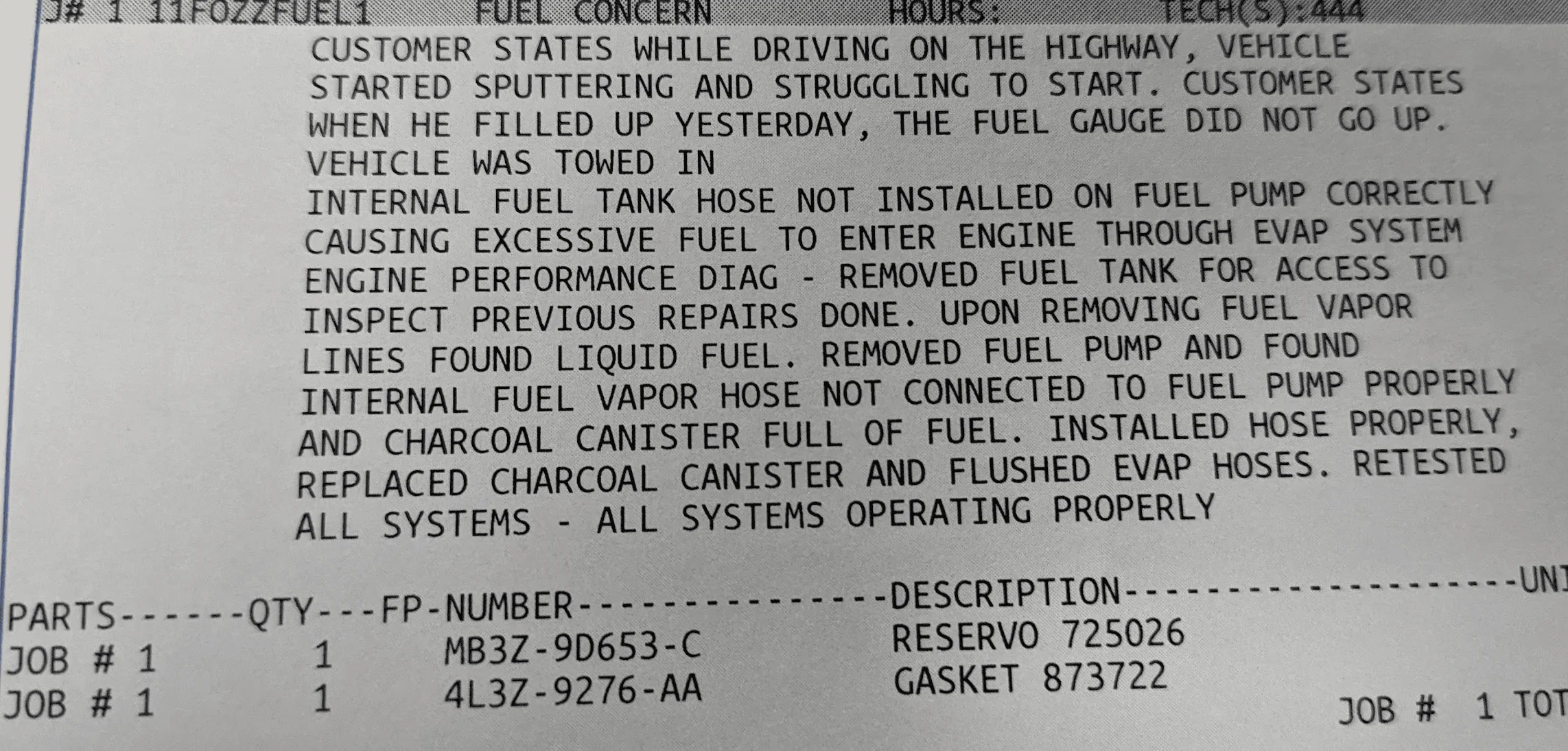

@bgautrea , glad you finally got a tech with the skills & determination to look into it until he found what was going on, vice what seemed to be techs just firing the parts cannon at it previously.
