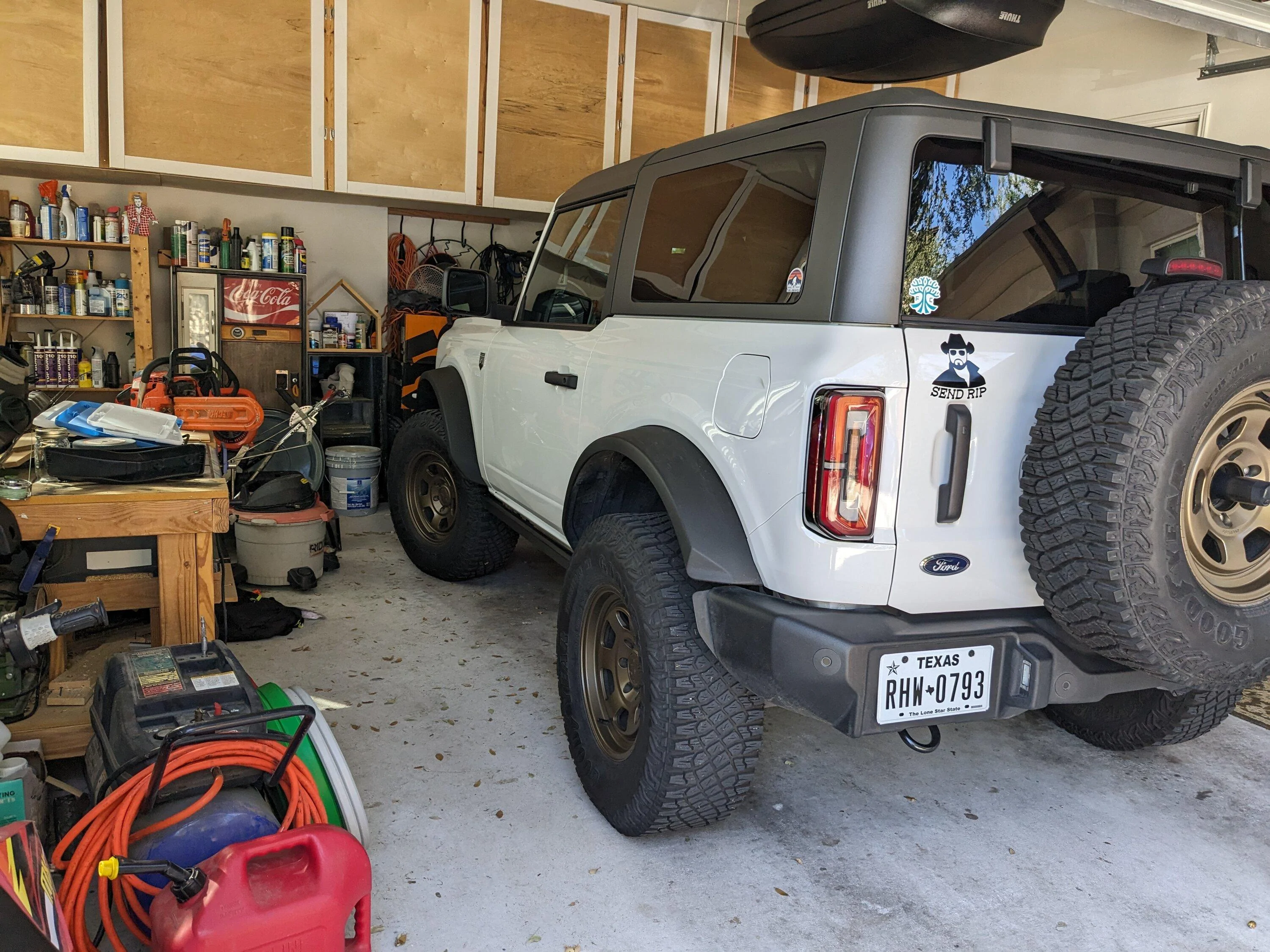

Finally. Picked Lil Sebastian up on Friday afternoon and it's back in the stable.
