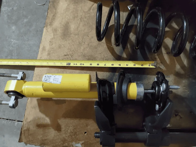

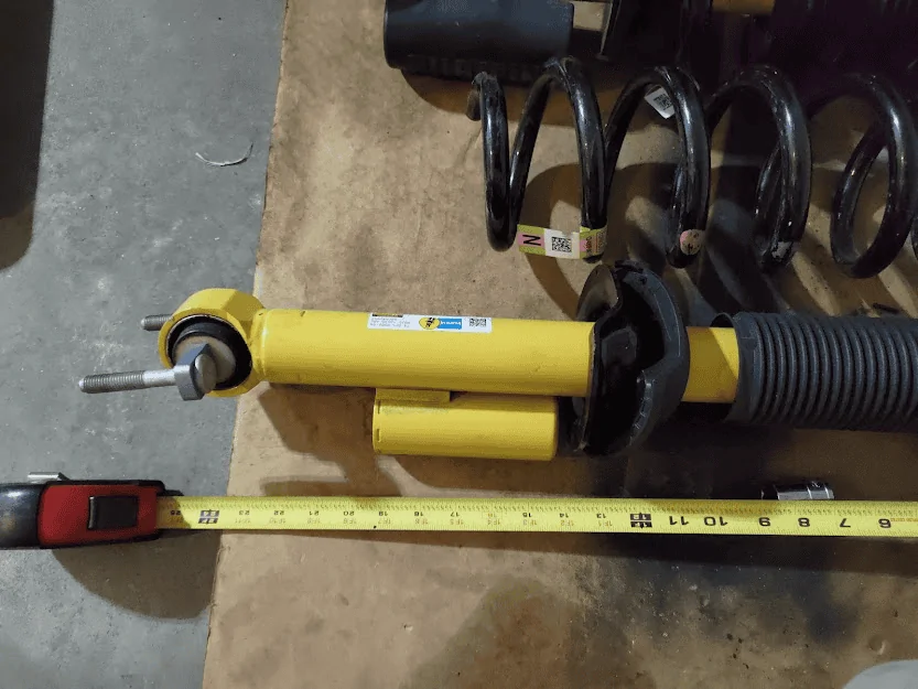

This post will be where I track all the measurements I am going to take with both the Sasquatch and Badlands Bilstein's. (I have both now in my possession.)
Badlands Shock/Spring Measurements:
You can see in the images, the preload in the front shock is a lot more than the rear. (Edit: whoops, typo) There is barely any preload on the rear shock.
Both:
Internal ESCV stop begins engaging 2" from bottom of stroke. It is not jarring, just engages and gradually increases pressure until bottom of stroke. You can compress it with your body weight so this isn't really a traditional "bump stop" imo, kinda neat.
On the top end you can't really tell there is an ESCV valve in there, just like the top one I suspect it just changes the shock damper rate when dynamically moving.
Top bump stop, there is another forum thread, but it's 3.5" (Front) 4" (Rear) rubber/plastic for reference.
Ford Bronco Low CG, max articulation, and biggest tire size without interference? 1673229146280

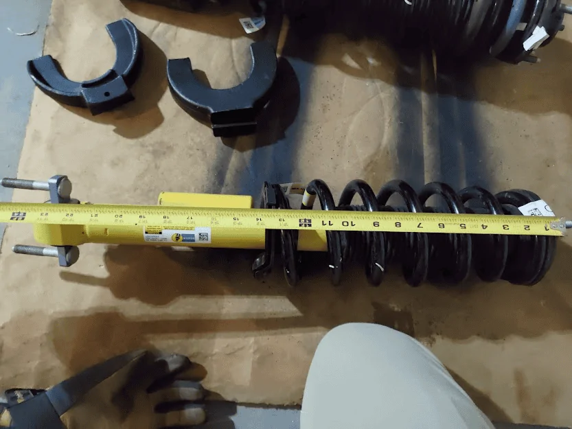

Front:
Total Coilover length from top plate not bolts: 23"
Preloaded Spring Length: 14"
Ford Bronco Low CG, max articulation, and biggest tire size without interference? 1673228871146
Un-loaded spring length: 17"
Ford Bronco Low CG, max articulation, and biggest tire size without interference? 1673229181268

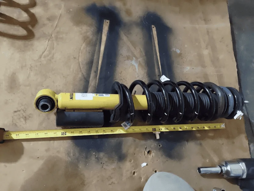

Rear:
Total Coilover length from top plate not bolts: 26"
Preloaded Spring Length: 18"
Ford Bronco Low CG, max articulation, and biggest tire size without interference? 1673229338399
Un-loaded spring length: 20"

I was able to get the front suspension on today, 1.25" perch collars and bump stops that have been trimmed an inch. Ride height at the front fender is level with back end sasquatch at 39.5". This ended up being perfect as I am level with the sasquatch rear end with a badlands shocks.
I attempted the back but without a lift I am going to have to get some help. 27mm bolt is no joke when you can't get a lever under the car to break it loose.
Rear shock will have the 1.25" perch collars and a half inch spacer on the top to accommodate the difference plus get me a tad bit of lift. Rear is at and angle so a static 1.25 needs a tad more to get to correct height I think.
Ok so the rear badlands shock with a 1.25" perch and a 1/2" top spacer is now back to the high riser shock that comes with the sasquatch.
I will be testing the squish and clearance this weekend, but I don't think it's going to be an issue, looking back at some photos I think the stock bump stops and travel were entirely overkill on fords part (As others have noticed as well.)
At this time I am going to end this, I have other mods I'd like to make to my truck and others have measured the sasquatch suspension in the main bilstein thread.
