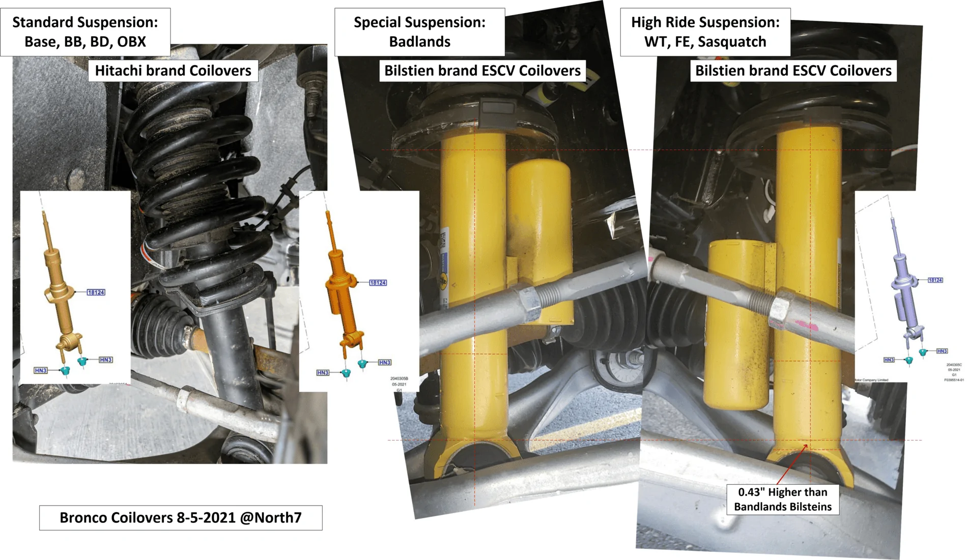

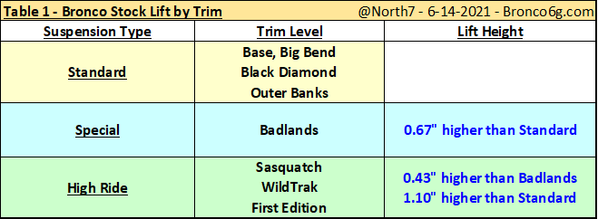

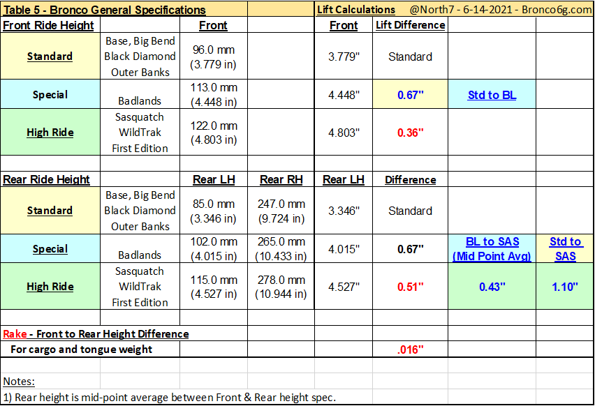

Sasquatch vs Badlands Articulation (Update 1/2/2022)
While the Bilstein coilover's are 0.43" taller on the Sasquatch vs the Badlands, they also have a 0.4" Bump stop vs the Badlands, limiting articulation, so the larger 35" tires don't top out on the fender well. Therefore, Sasquatch with 35" tires has Less articulation, not more."​
Or are you just talking about the shocks themselves?
The dimensions are theoretical calculations based on the Ford publications (see Table 5 below). These are the total suspension/trim height differences, but shown as dimensions on the coilover assemblies for simplicity.
Now that we have the Ford General Specifications document, Bilstein Coilover Information and Ford Part Number information we can finally get a clear and complete picture on what the stock Bronco lift dimensions are and what is possible to lift each trim level.
Ford Bronco Low CG, max articulation, and biggest tire size without interference? 1623675007580-

All the Bronco Bilstein shocks are the same length 6100, 5100 and SAS. Switching between them only changes ride height not total travel.

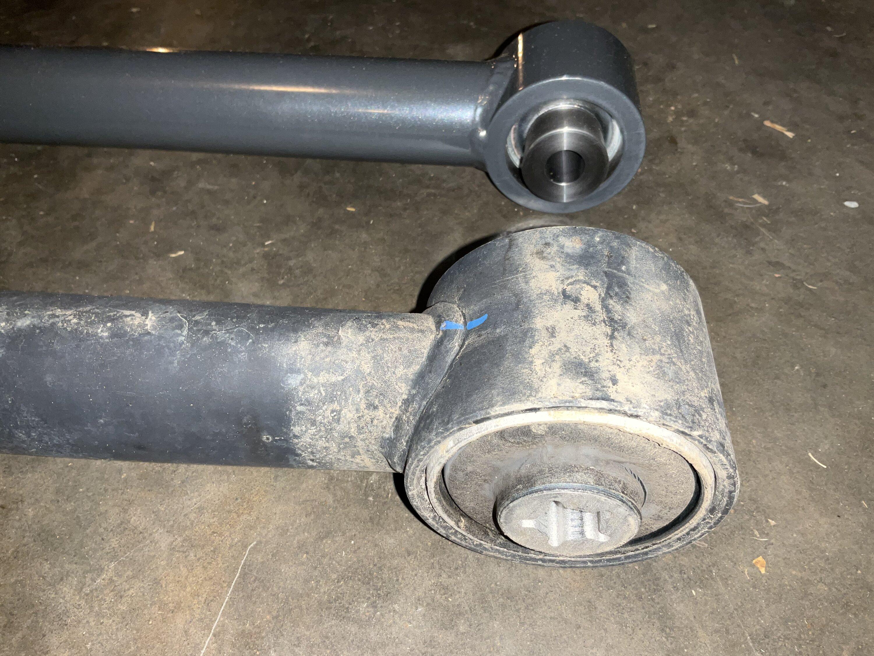

I mean like chopping the brackets off the frame. The Broncbuster broncos have them chopped up pretty good to fit the big meats they are running.
We know 35’s fit on the regular badlands but require wheel spacers.
I’m also convinced in my mind that the stock rear control arms limit movement so that is where I’m going to go next.
Yeah, the rear sucks. That was my first upgrade and well worth the expense. I'd lift a rear tire going over anything. After about a month or so old, the rubber bushings in my trailing arms were already hard and cracked.

I think the shock length in the rear is more of a limiting factor than factory control arms binding up. Factory bushing are pretty soft they flex decent I think for the amount of droop the shock allows.
So the rear trailing arms and rear track bar use hard rubber bushings that have very little movement. I easily got more movement out of my rear axle by replacing them, while retaining the Bilsteins. Now that I've gone to the Icons I've gained a few more inches of usable travel, but the rear suspension is too tight as is. There are real gains to be had by upgrading those joints, and now there are quite a few to choose from.
The rear is what I was referring too, at least with the Sasquatch struts I don’t think the factory arms would limit any droop.
Which Icons did you go with I’ve been looking into longer struts this week. I don’t want to over extend the front but the rear I want as much as I can get. I plan to make my own arms with some 7075 and metal cloak duraflex joints.
