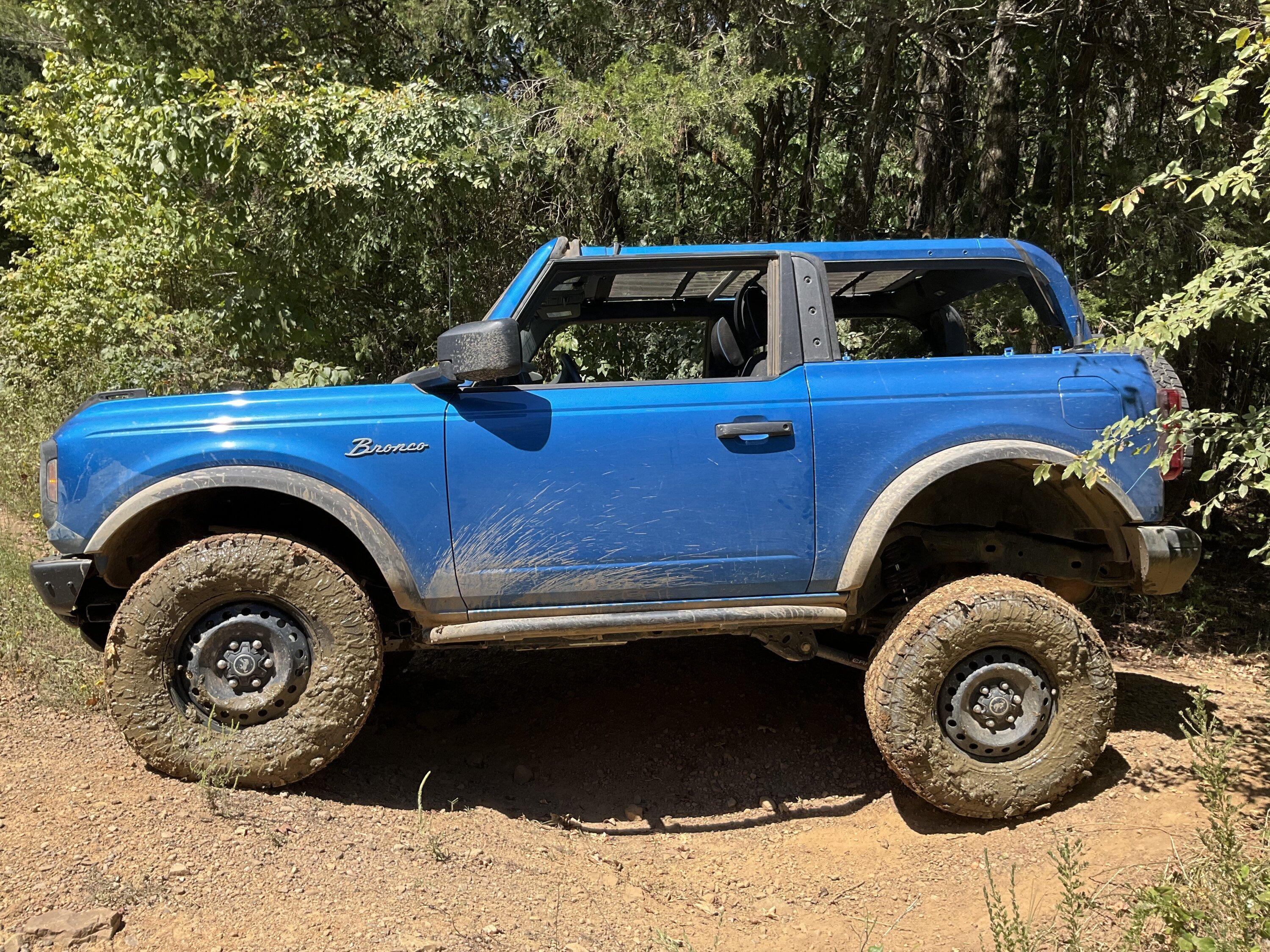

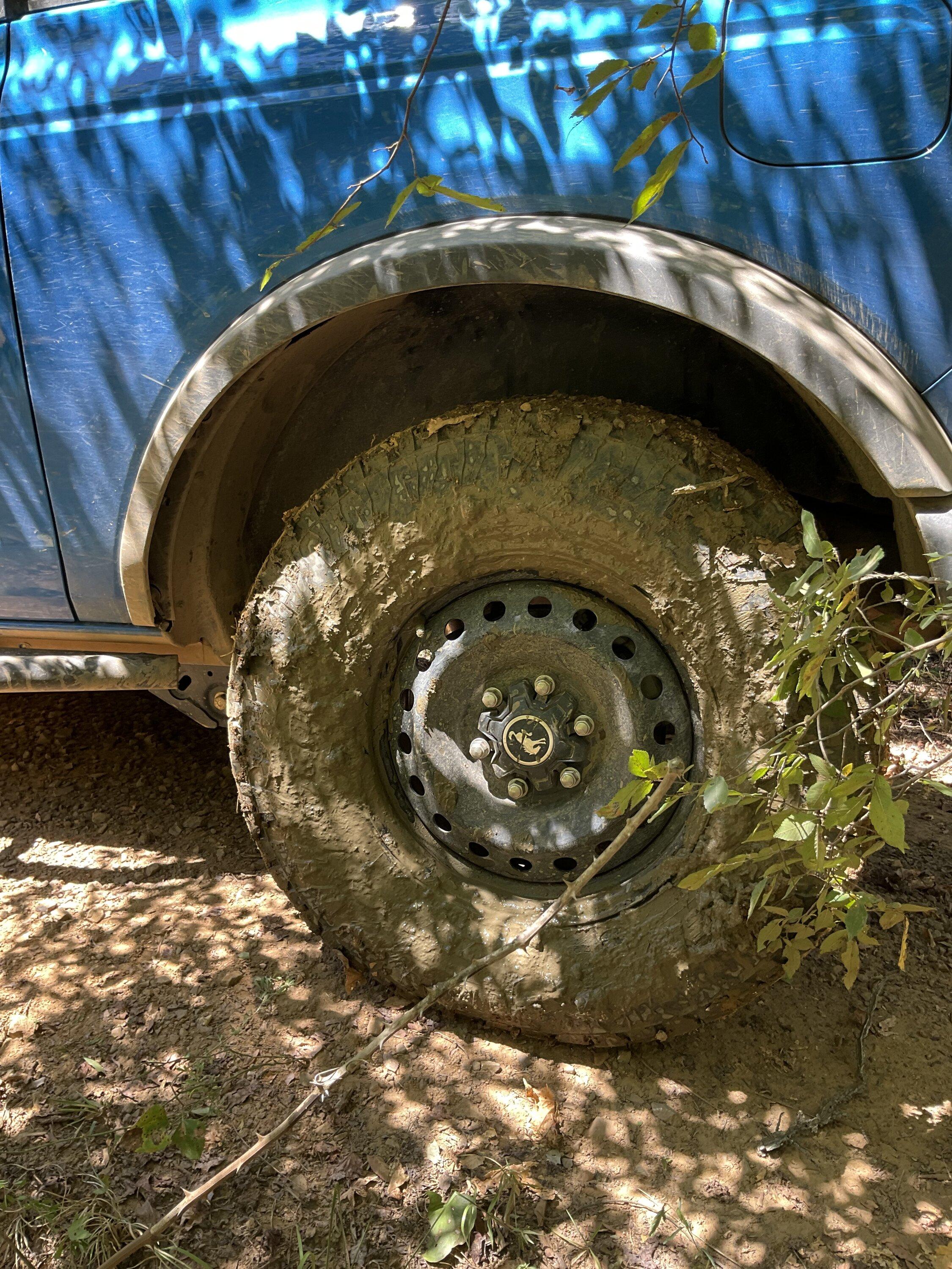

So far, but I've only had them on for one month and have done two short off road trips. I've got a trip to Montana coming up next month, so I'll have a better idea after that. I'm really happy with the rear, but still have work to do up front to fully utilize them. I have the factory full time sway bar and it is far too tight for the amount of lift I have. There is very little articulation up front. If I can get out next week I'm going to remove the sway bar and see if that cures things. Future plans are for a Rockjock sway bar if they ever make one for the Bronco, otherwise manual disconnects.
Rear stuff and droop with a tight front. I think maybe a little more stuff if the front was looser.

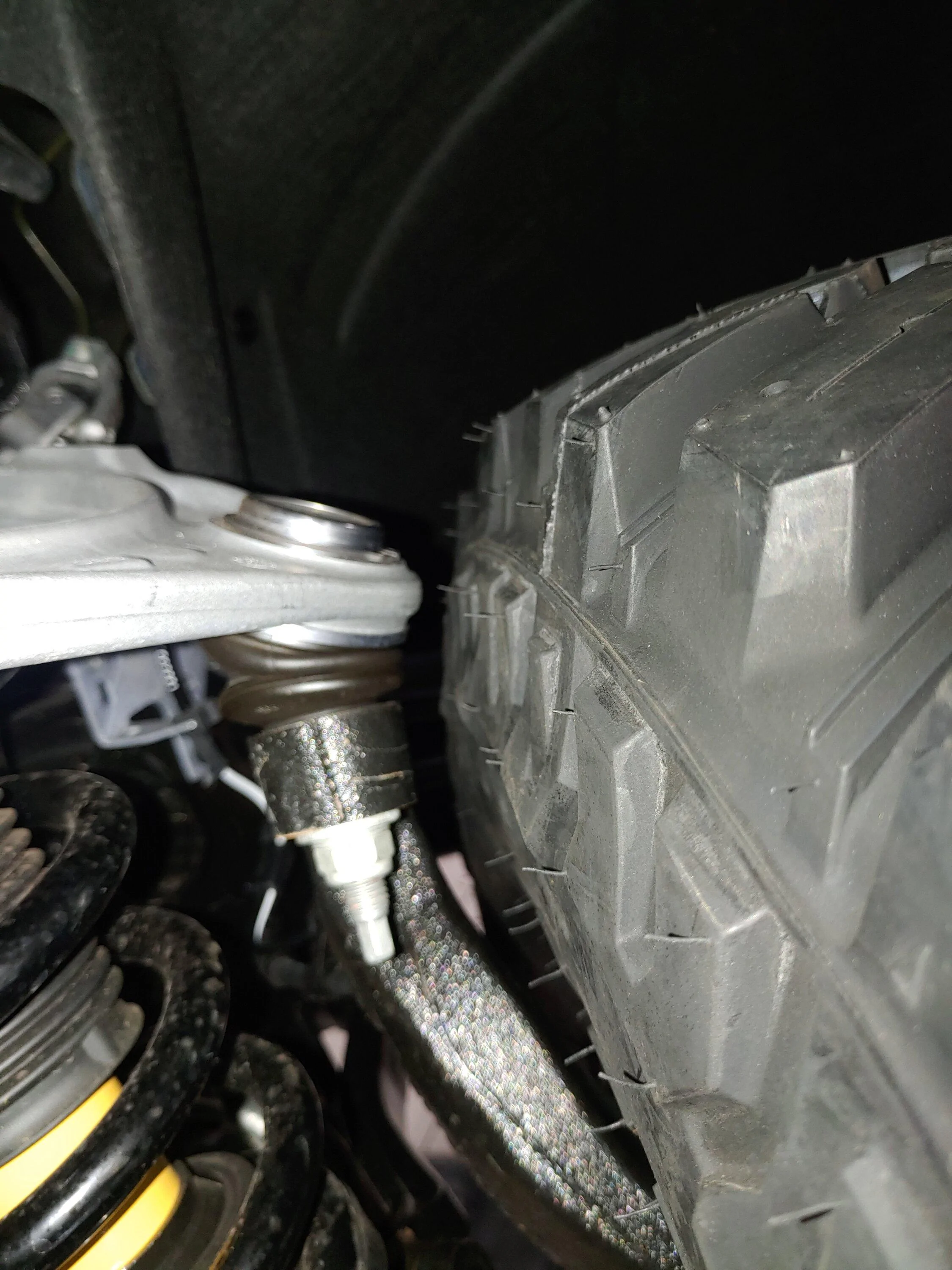

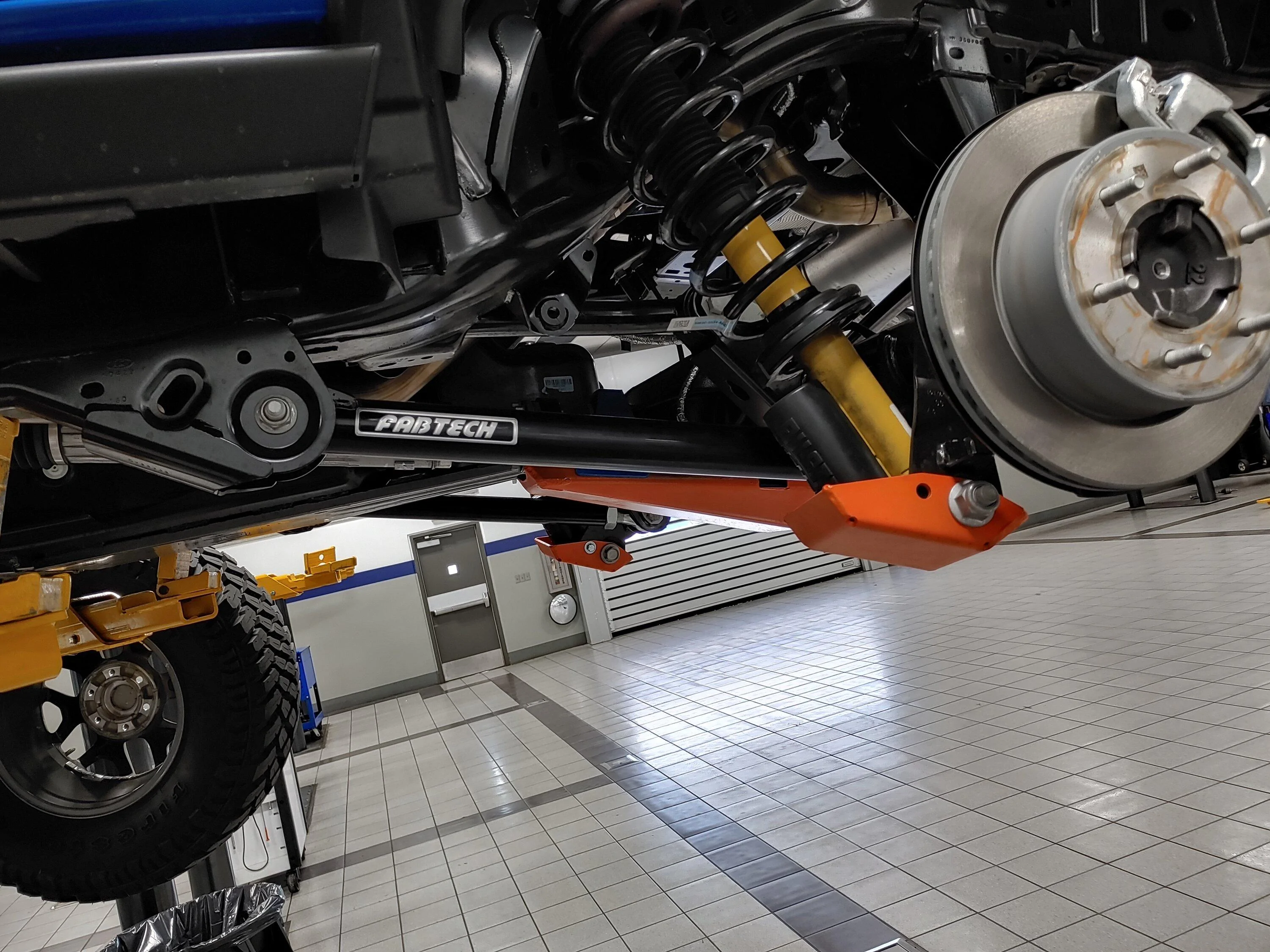

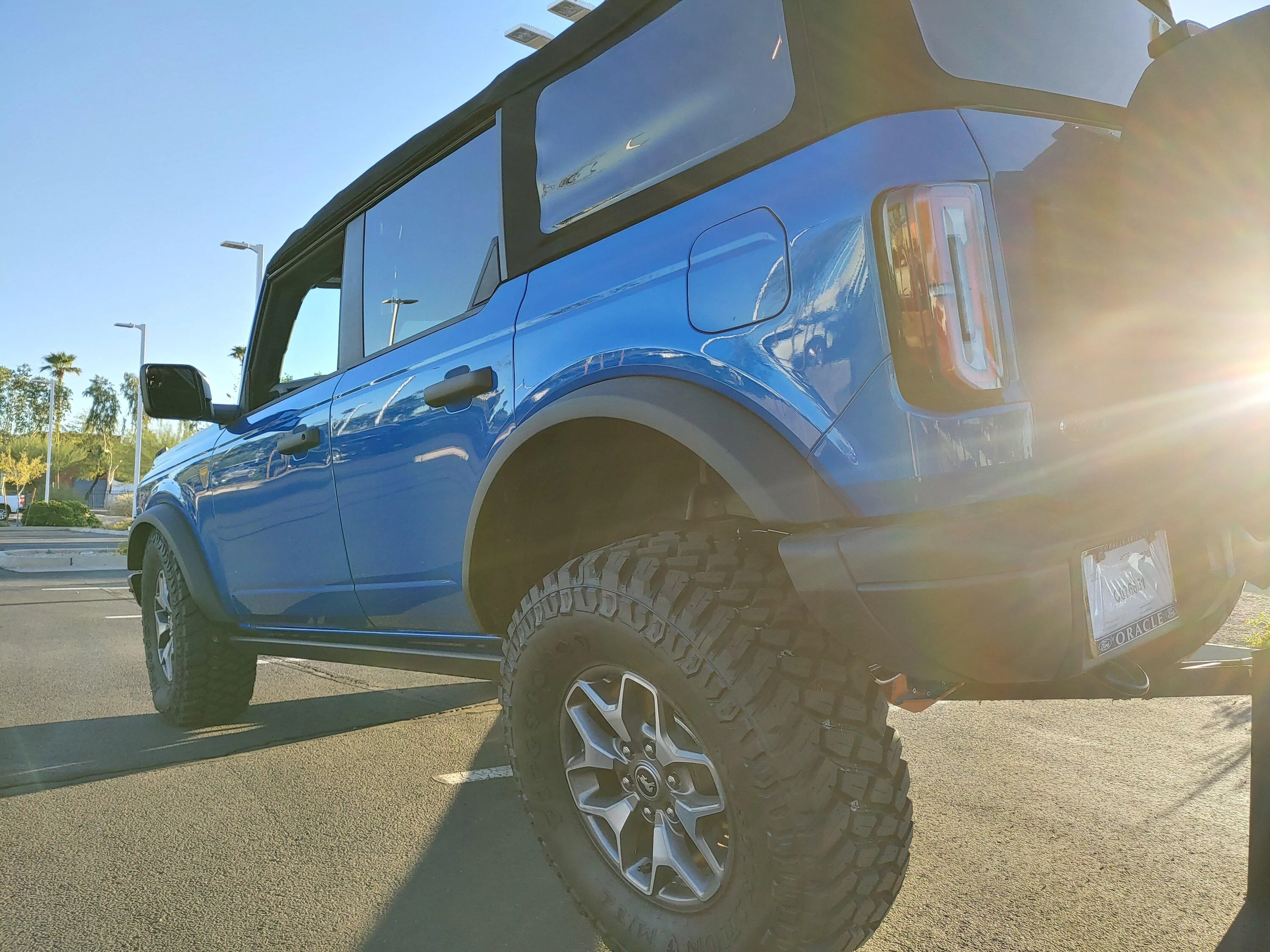

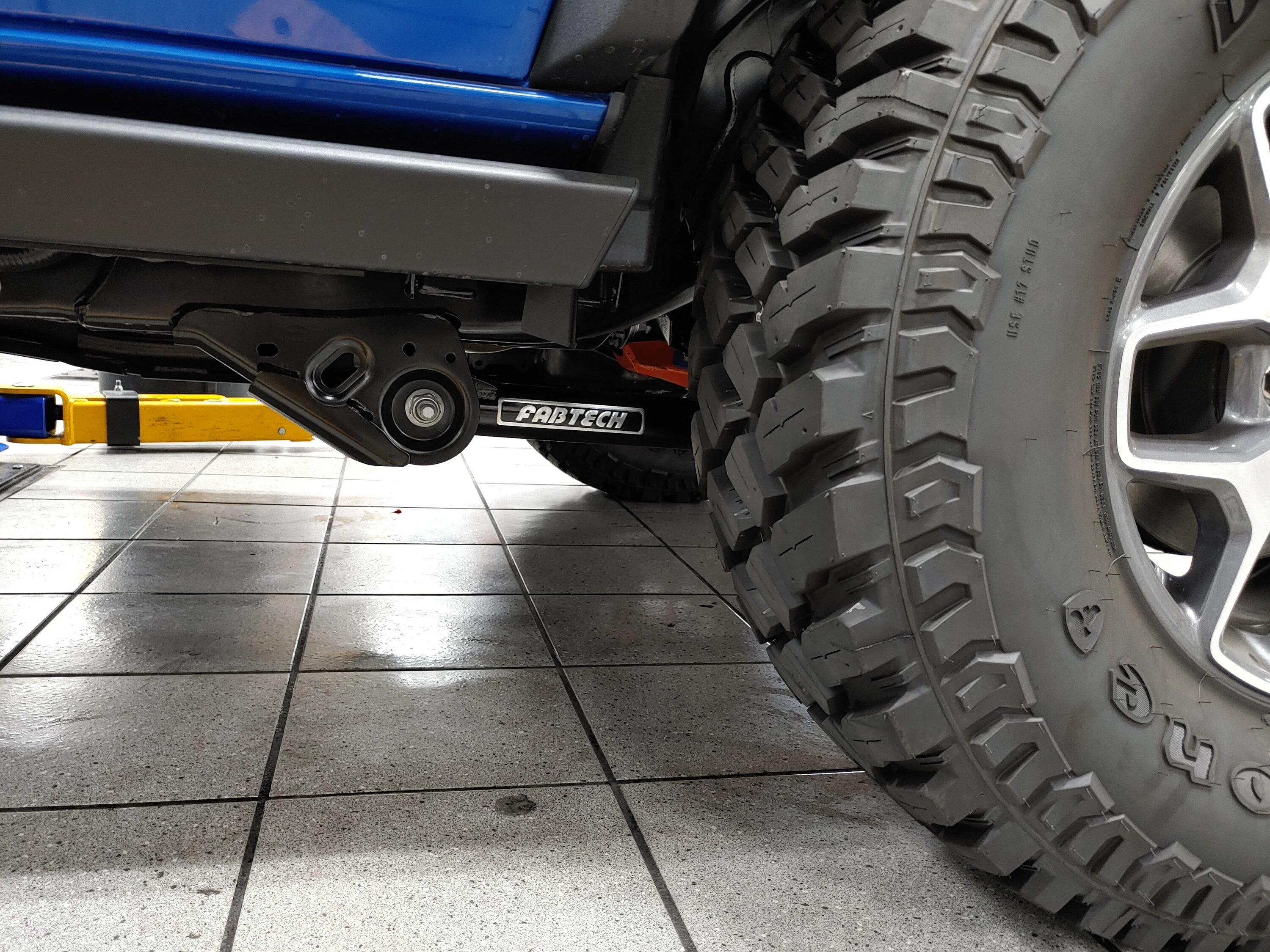

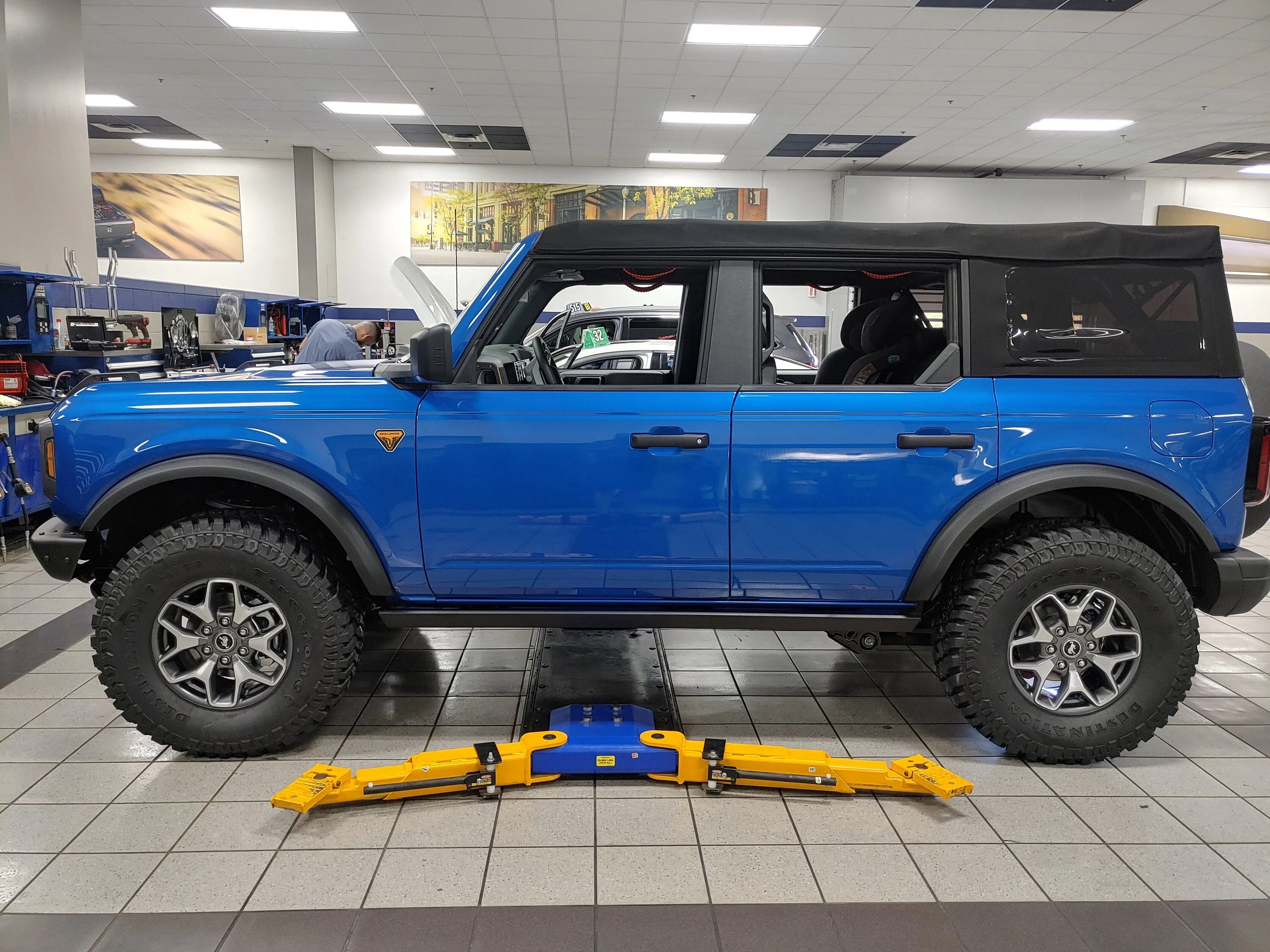

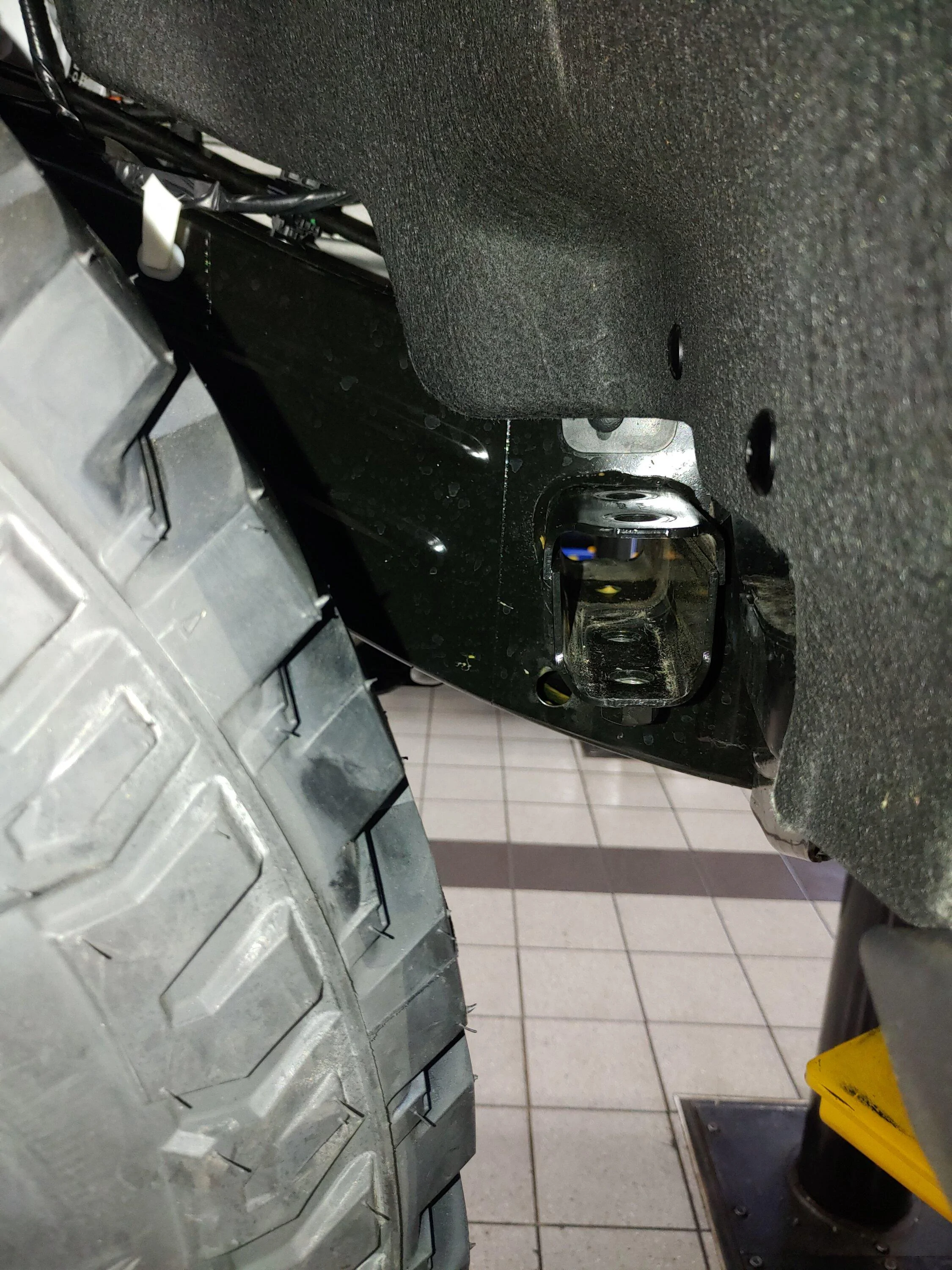

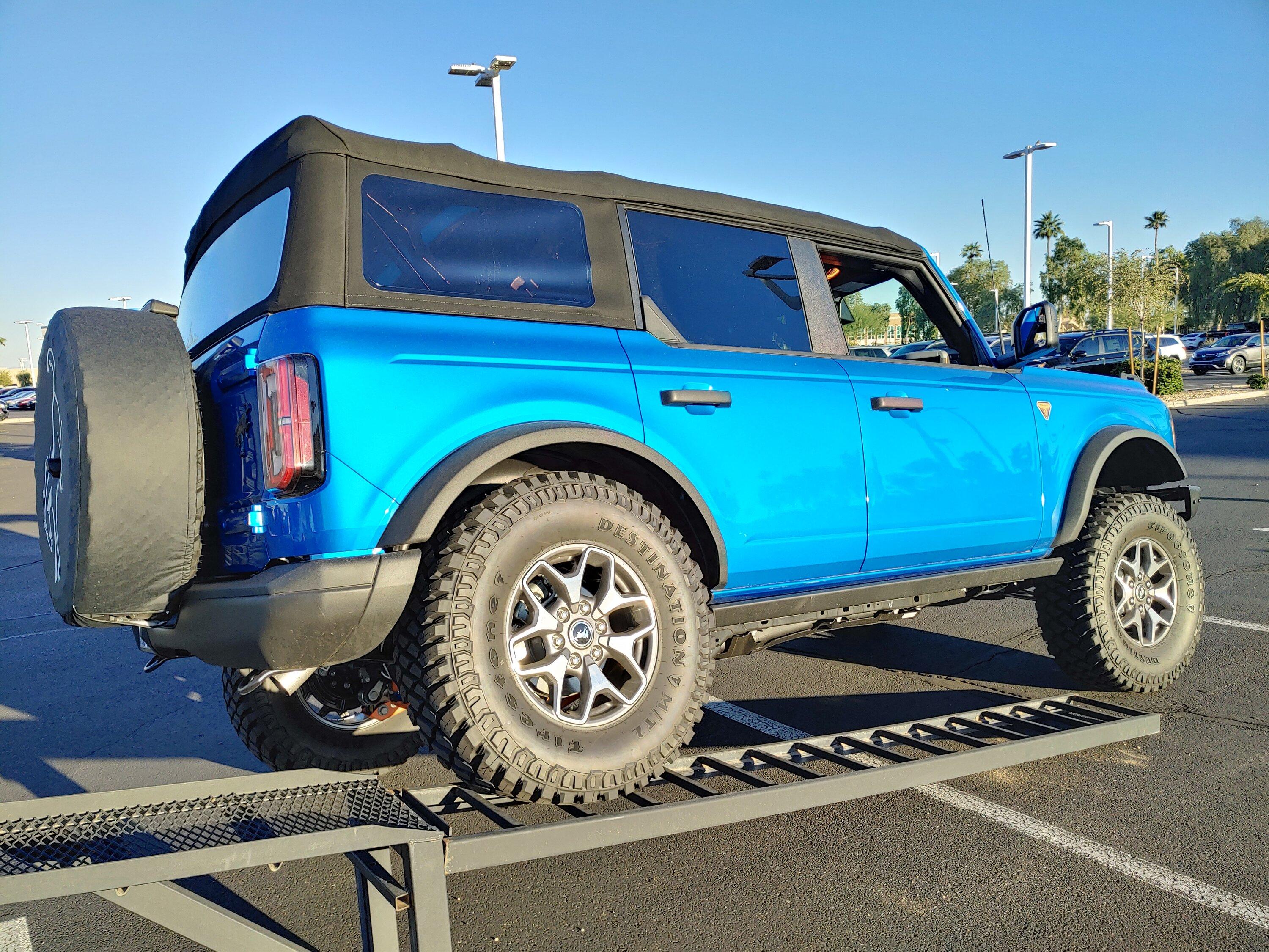

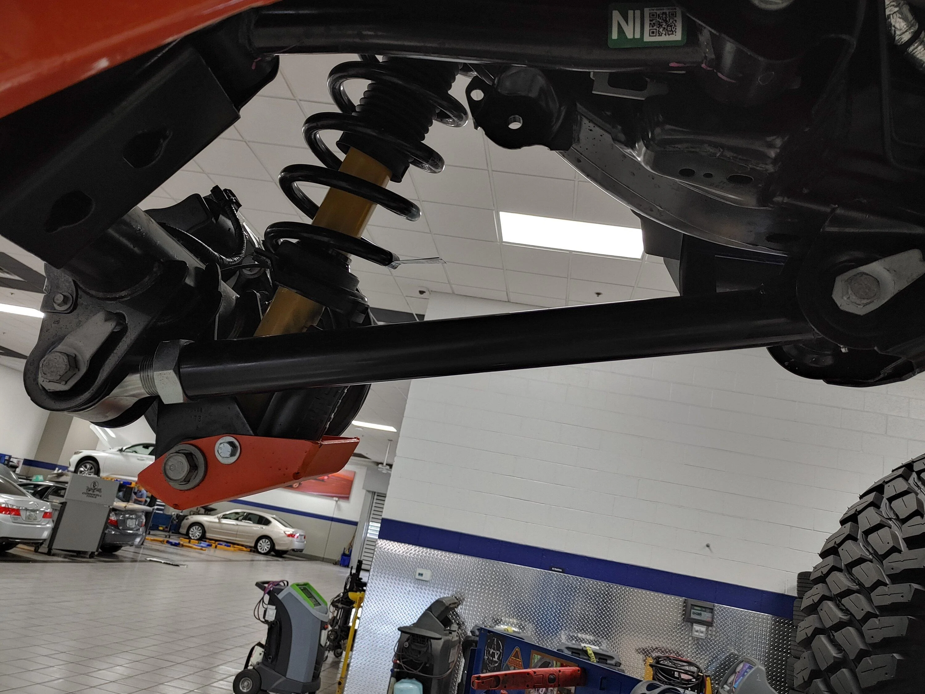

Got my Badlands last month. Got the 35's(34.5") on, removed the crash bars. No rubs at full lock. Haven't had a chance to stuff the tires up yet. Also swapped the rear trailing arms out for the Fabtech arms. GM at work gave me permission to set up the old car ramps and play around with them. Hopefully today I'll have some time at work to mess around.
Here's some shots of my rig, tire clearance and trailing arms.
Ford Bronco Low CG, max articulation, and biggest tire size without interference? 20221102_153736_HDR
Ford Bronco Low CG, max articulation, and biggest tire size without interference? 20221013_153005_HDR
Ford Bronco Low CG, max articulation, and biggest tire size without interference? 20221013_101112
Ford Bronco Low CG, max articulation, and biggest tire size without interference? 20221102_153748_HDR
Ford Bronco Low CG, max articulation, and biggest tire size without interference? 20221013_101103
Ford Bronco Low CG, max articulation, and biggest tire size without interference? 20221019_173234~2
Ford Bronco Low CG, max articulation, and biggest tire size without interference? 20221102_165224_HDR

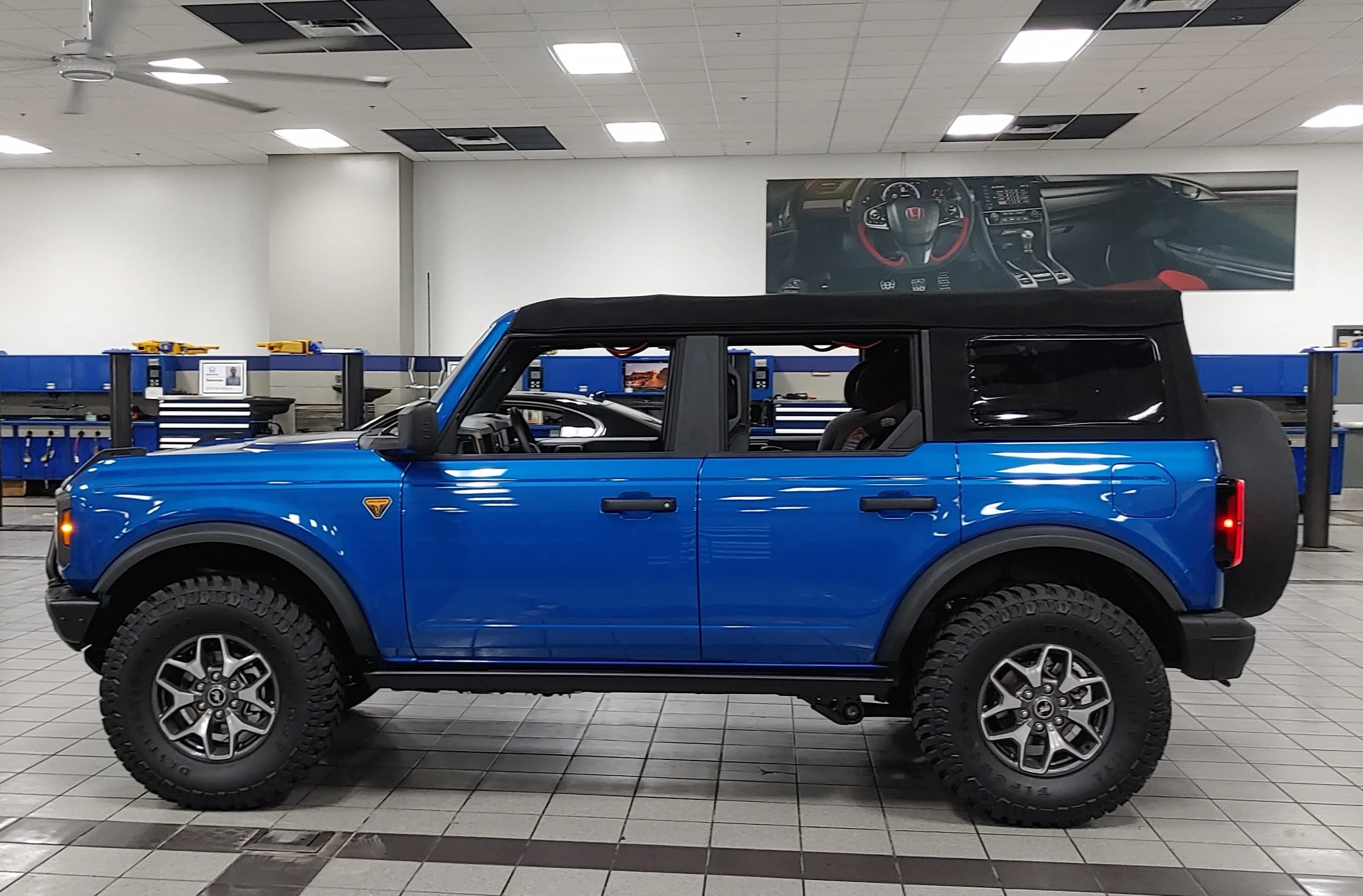

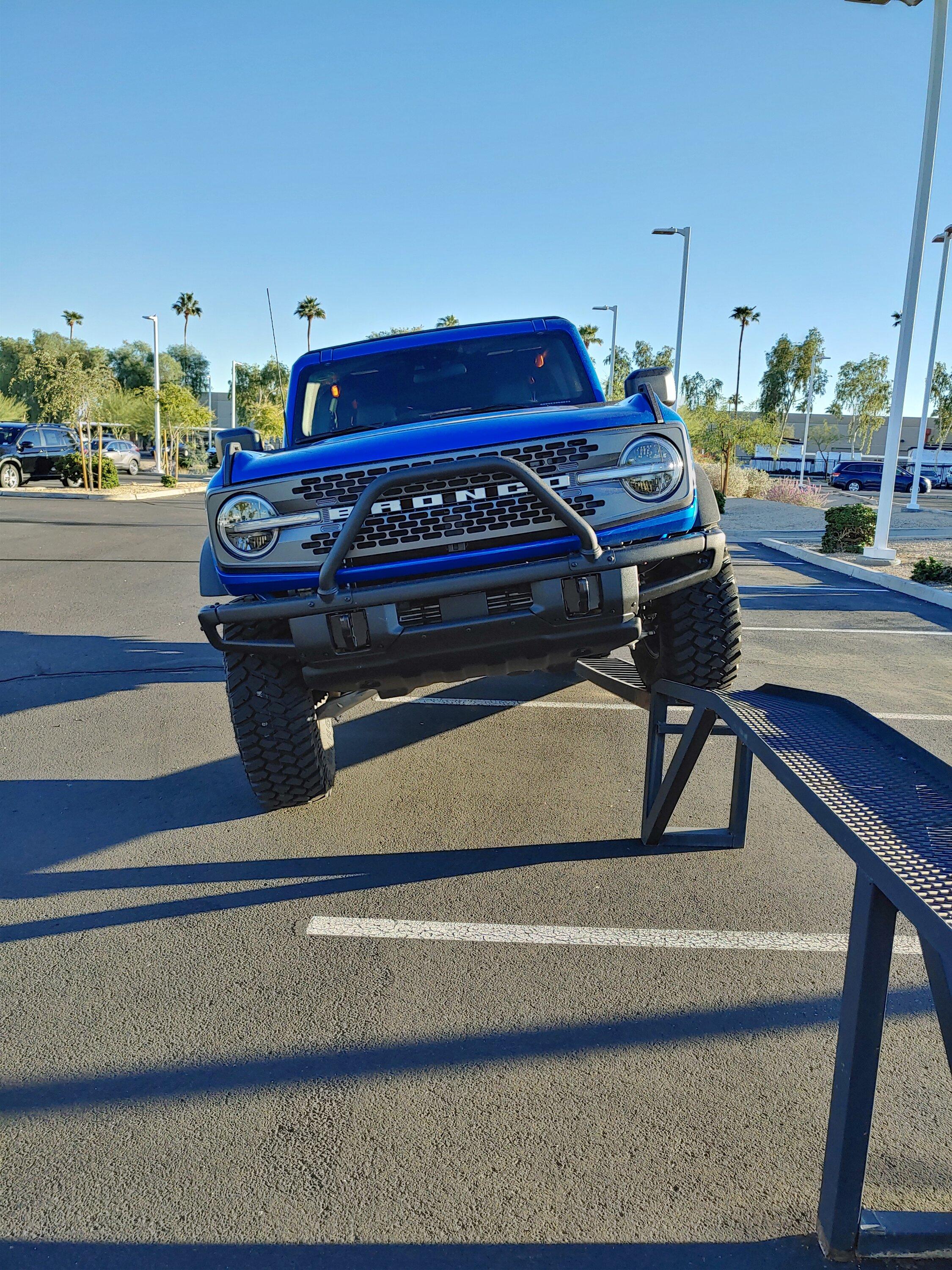

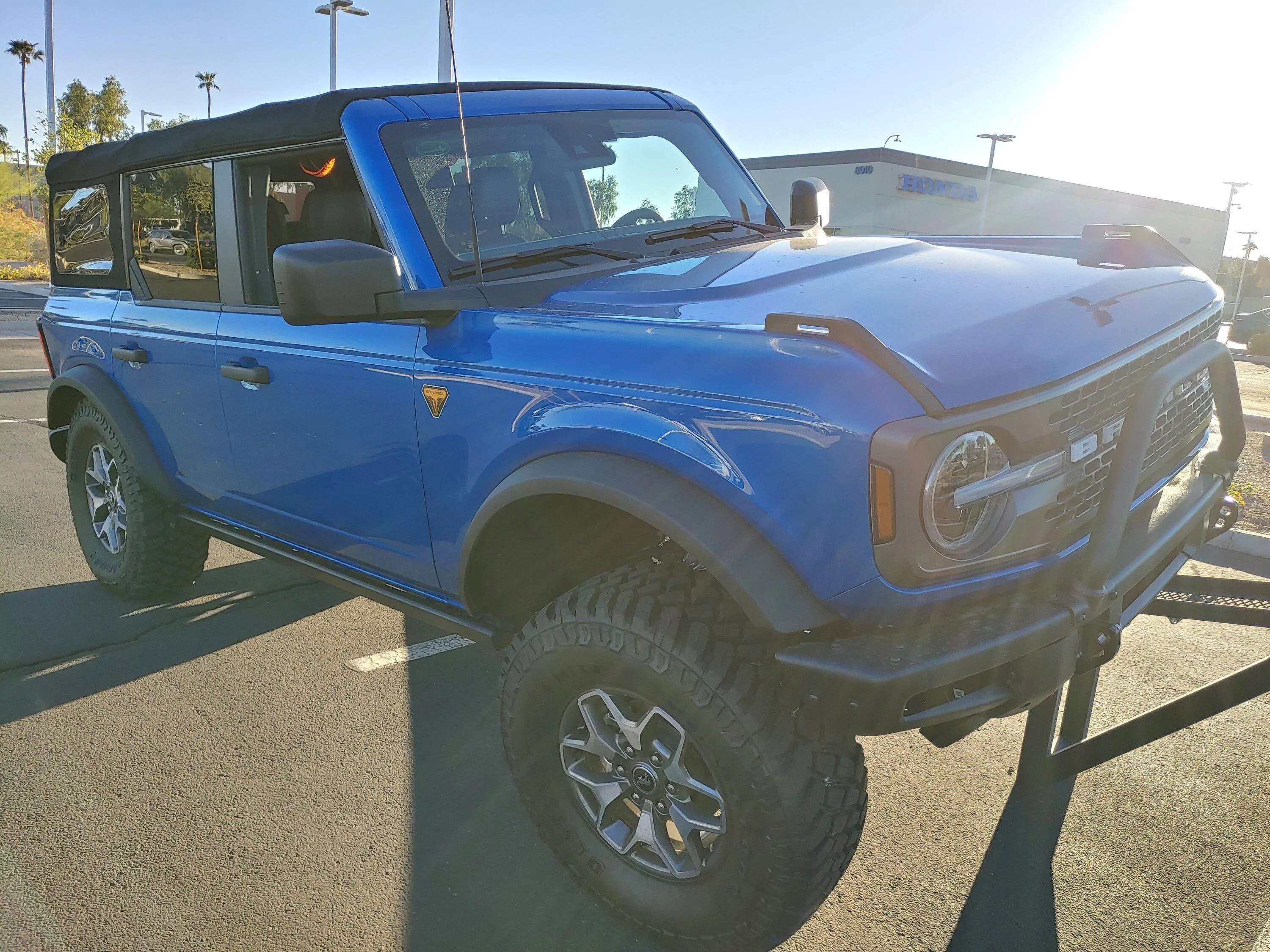

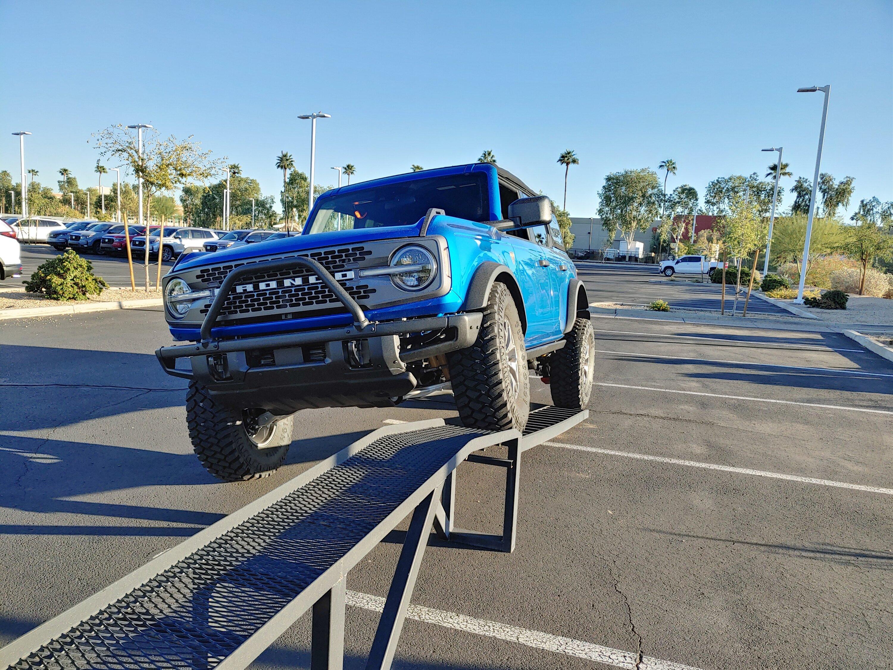

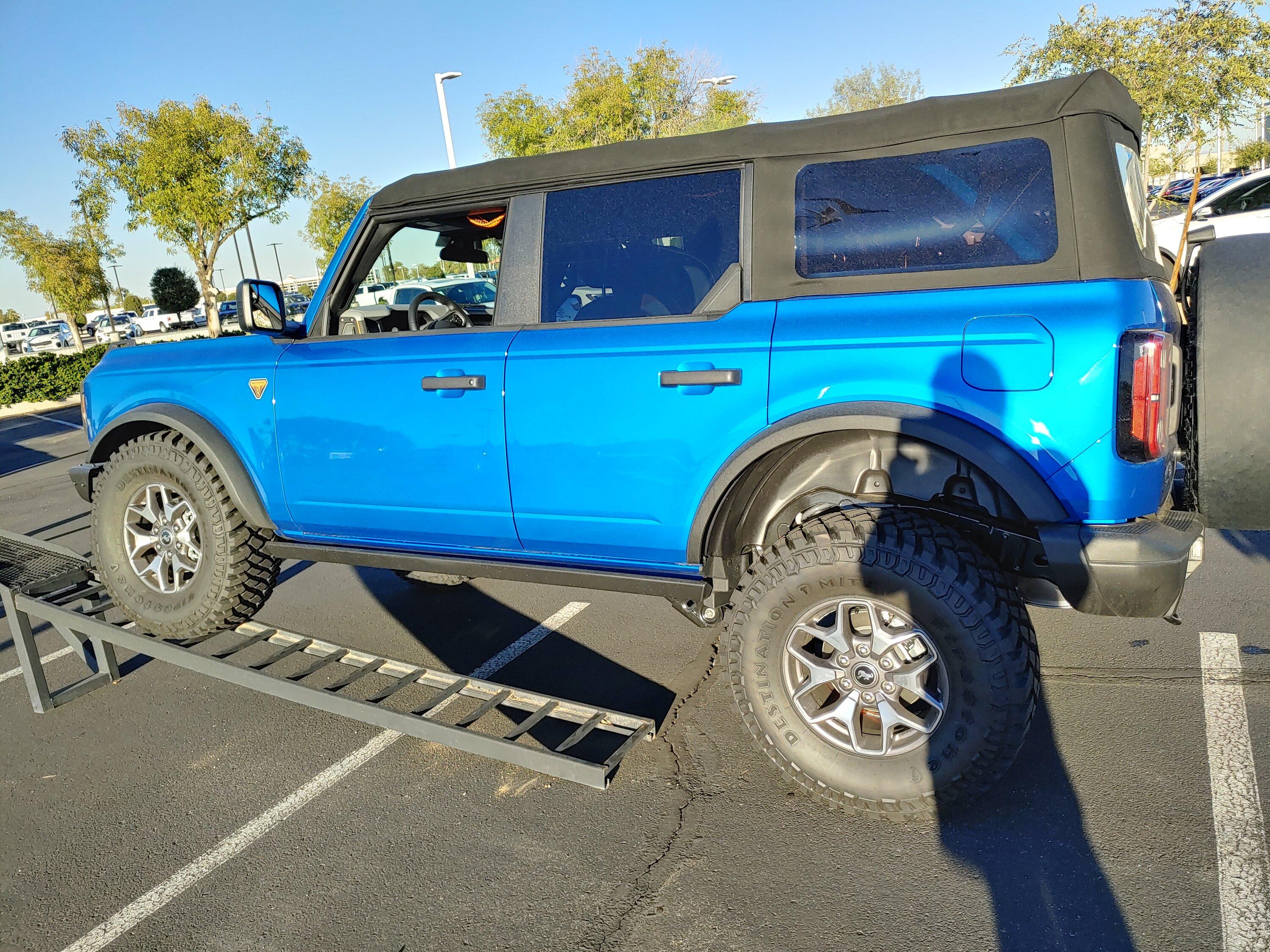

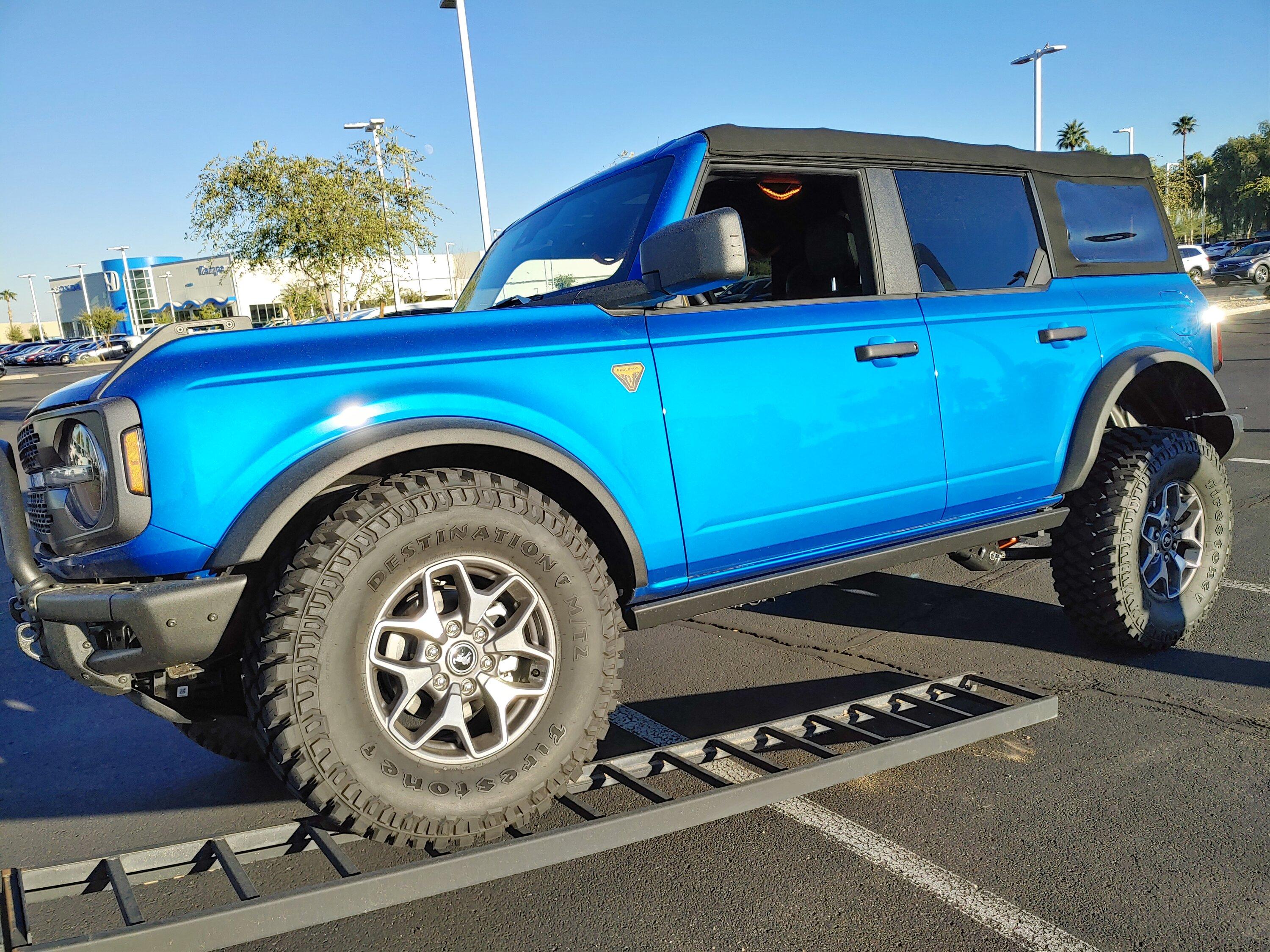

Busted out the ramp today.
Ford Bronco Low CG, max articulation, and biggest tire size without interference? 20221104_163235_HDR
Ford Bronco Low CG, max articulation, and biggest tire size without interference? 20221104_163244_HDR
Ford Bronco Low CG, max articulation, and biggest tire size without interference? 20221104_163224_HDR
Ford Bronco Low CG, max articulation, and biggest tire size without interference? 20221104_162957_HDR
Ford Bronco Low CG, max articulation, and biggest tire size without interference? 20221104_163007_HDR
Ford Bronco Low CG, max articulation, and biggest tire size without interference? 20221104_164101_HDR
Ford Bronco Low CG, max articulation, and biggest tire size without interference? 20221104_164125_HDR
