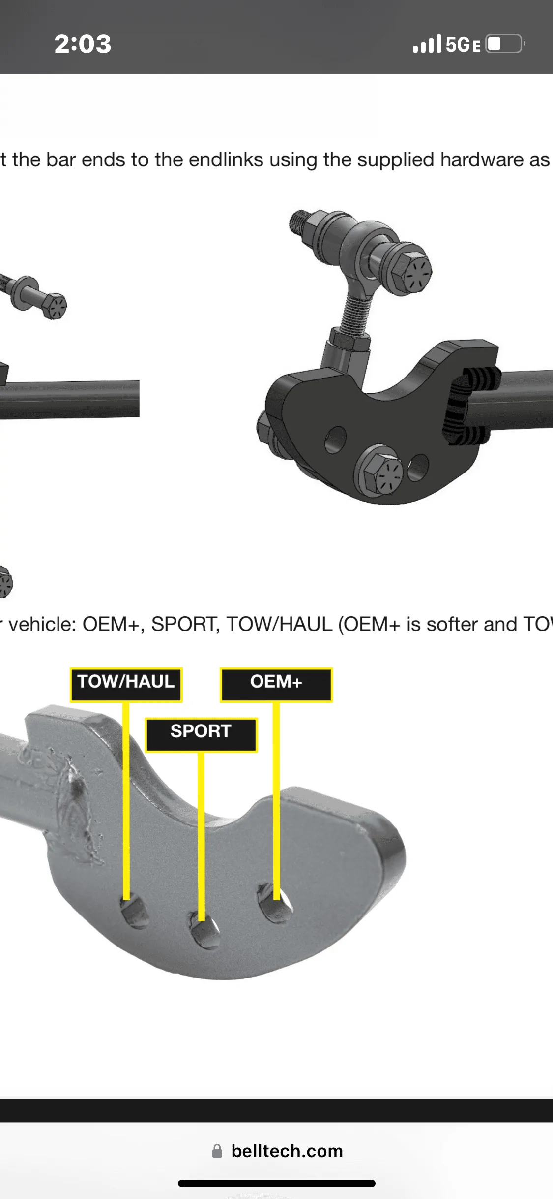

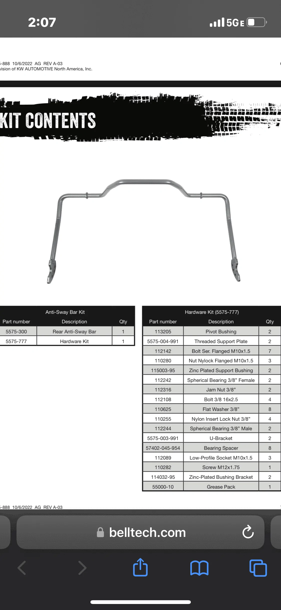

The Belltech rear sway bar is very light, only 7/8” diameter and from pic it has >24” moment arm to apply leverage on main torsion section. I would not think it would limit articulation by much. It has 3 settings, essentially bolt locations for end links that will change effective moment arm. Shortest hole location will provide highest stiffness. I question whether such minor adjustments in already long moment arm do much. I am curious how this sway bar feels on the road. Especially with heavily loaded rig. Hopefully someone who has one will add some more context. Not cheap for a simple bar, almost $500.

So the rear sway bar was much greater moment arm, and unlike the front, the ends of the bar will bend and also provide some flexibility. Flexibility will increase as a function of moment arm to the third power. So it is possible that the three link locations will provide some different flexibilities.
Just example not actual numbers. if closest link hole produces 24” moment arm and farthest 26”, then flexibility will increase by (26/24)^3 or 27%. Probably enough to maybe feel the difference when loaded.
