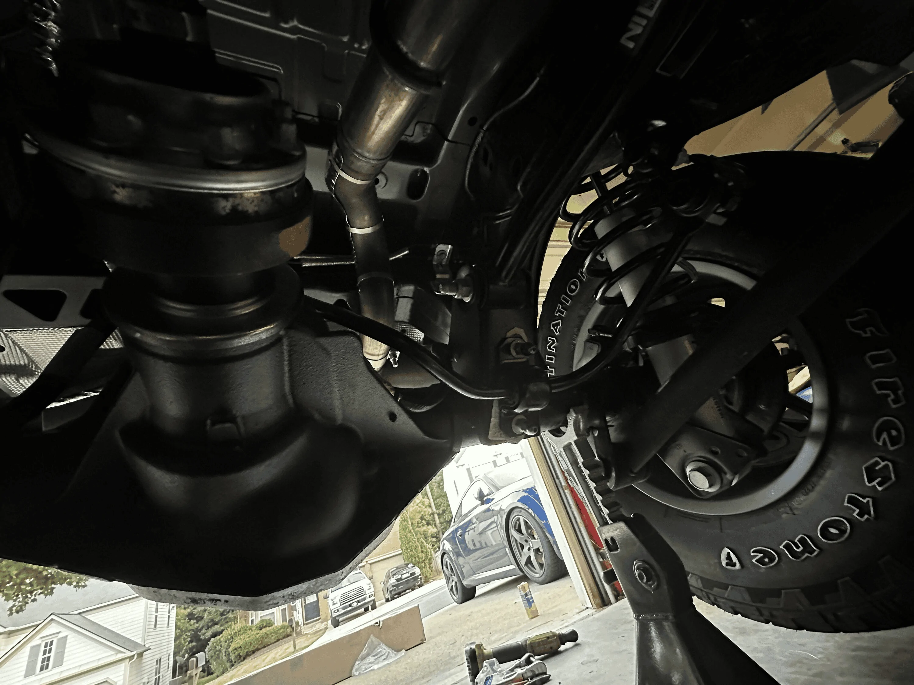

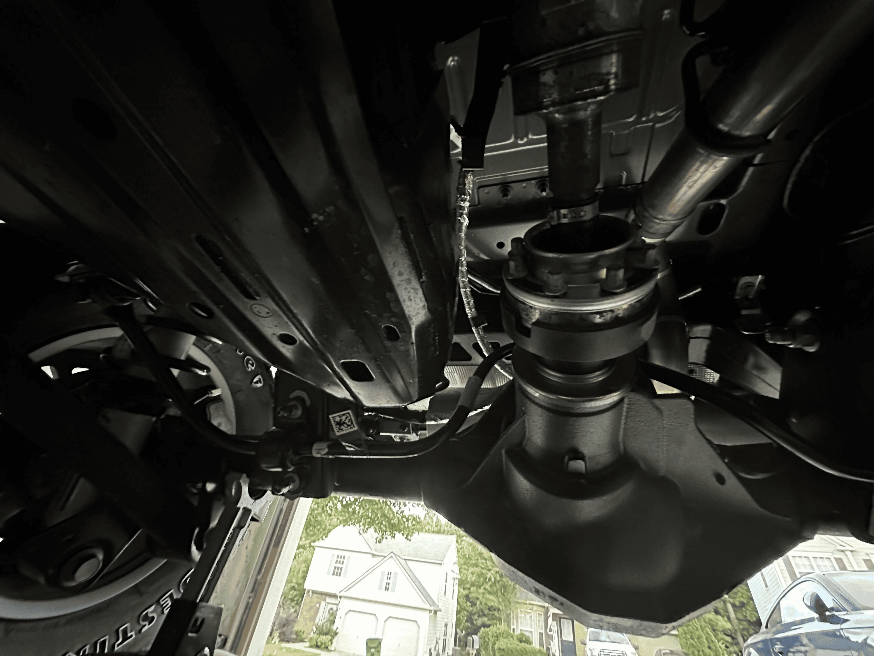

Ahh if that is the case, then the OP just needs to add the rear sway bar and the problem is fixed. Let me edit this post in a minute with the part numbers.
But OP needs to visually check and check that he has the mounts to accept a sway, early Broncos did not.
Part NumberPart NamePriceQuantityTotal
NB3Z-5A772-AStabilizer Bar$100.421$100.42
NB3Z-5C486-BStabilizer Link$59.122$118.24
W712045-S439Stabilizer Clamp Bolt Plate$3.054$12.20
W712334-S440Upper Mount Nut$0.564$2.24
W721710-S450Stabilizer Clamp Nut$4.274$17.08
W712503-S440Stabilizer Link Nut$6.714$26.84
I ordered from Levittown Ford. I know Ruxer is good too. The Honey plugin gives me 50% off shipping at Levittown.
EDIT: If the OP does not have the mounts, the Belltech sway bar works.
Thanks for this. Is there any user feedback on adding the rear sway to a 2 door? I did a quick search of the forum but didn’t find much.
Edit: this is a good thread for info https://www.bronco6g.com/forum/threads/rear-sway-bar.53649/
