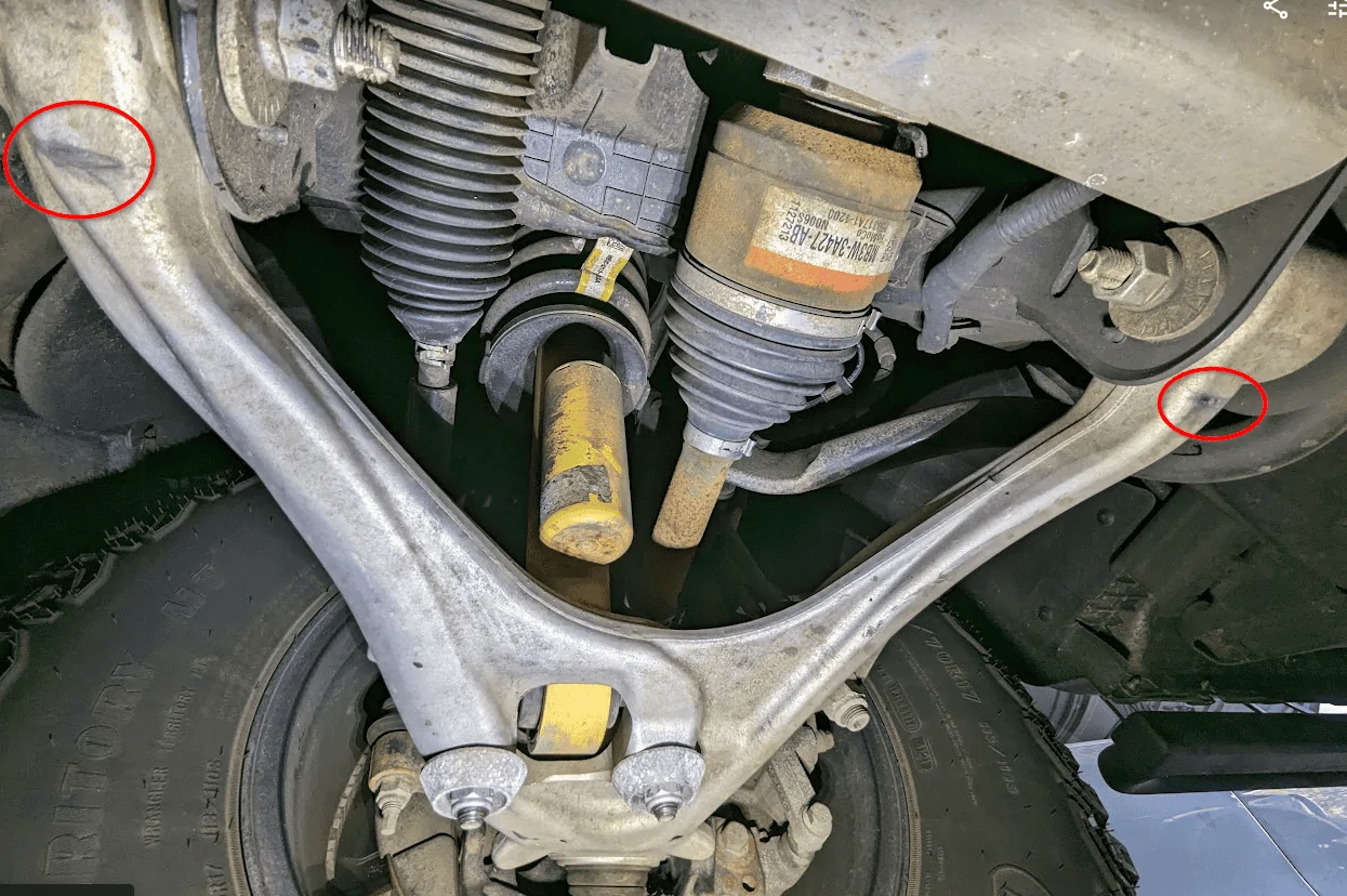

So, I took the LCA skid plates off again, and will leave them off this time. But, I did take a picture underneath. There are wear marks on the bottom of the LCA's where the skid plates were touching. See the highlighted areas in the picture. Maybe this is where the creaking is coming from? Just a thought, because I put enough rubber on those top skid mounts to make sure they weren't touching metal to metal at all. And, they still creaked.

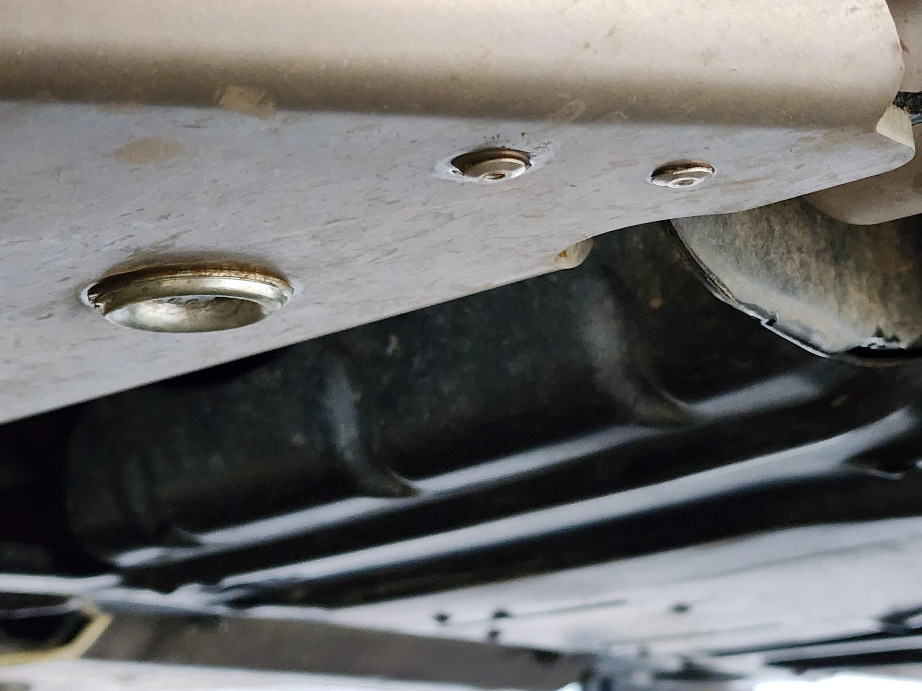

I've been following this thread for the past few months. My left LCA skid plate has also been creaking. It's so loud, it's embarrassing. ASFIR sent me rubber gaskets for the bracket bolts after I emailed them. I've removed and re-tourqued the skid plate four times and the creaking keeps coming back. I give up. I removed them and will buy the new Metalcloak ones when they're available. Good luck👍🏾

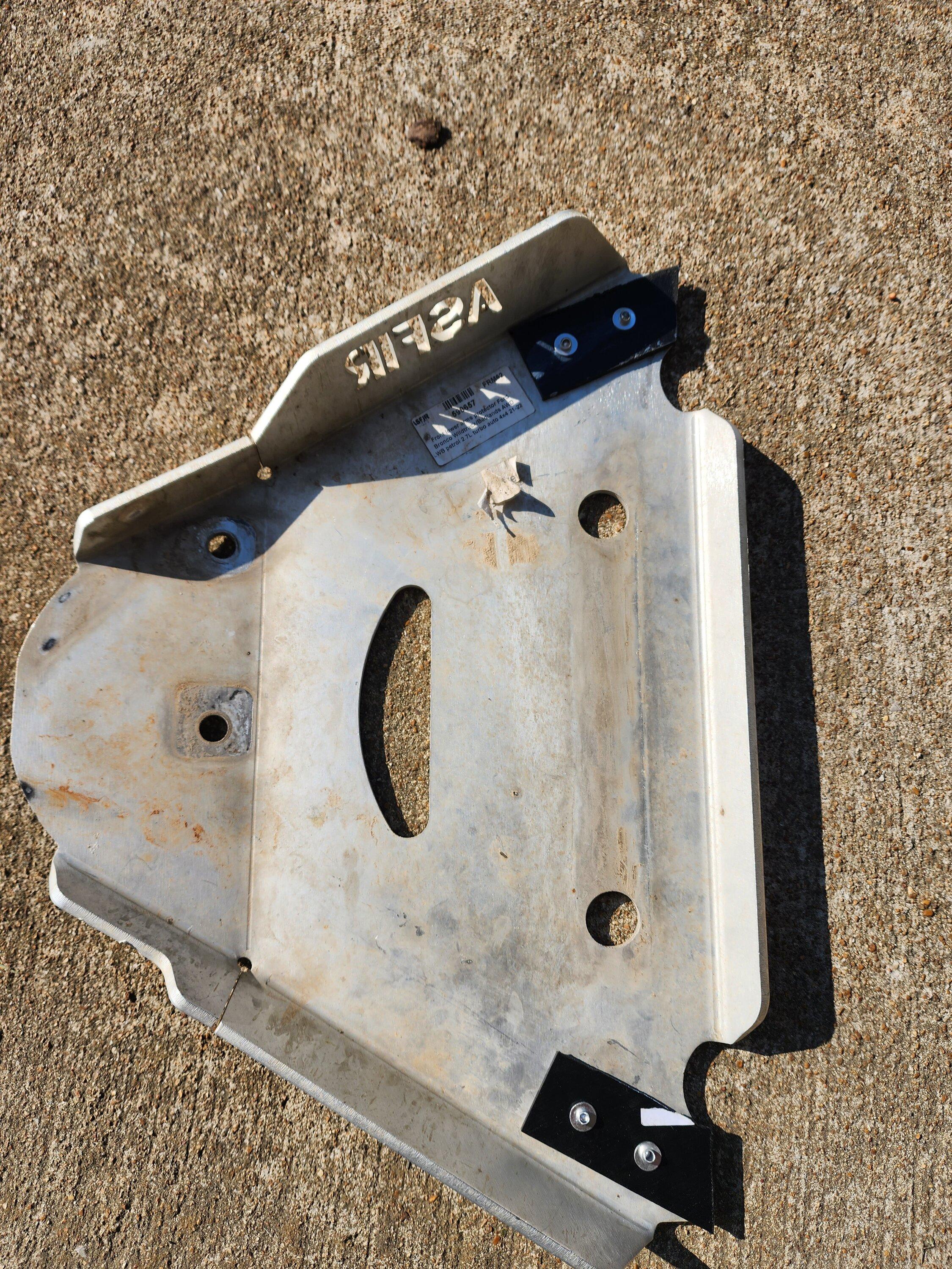

I took mine off today after contemplating you picture a bit. I too had rub marks there and a little in the front. I decided to buy a thin hdpe Sheet and riveted it on the skid where it would make contact with those areas. It wasn't much of an ordeal besides getting the right size rivet. You can drill through that aluminum like nothing. I'll check in after a few Weeks with status.

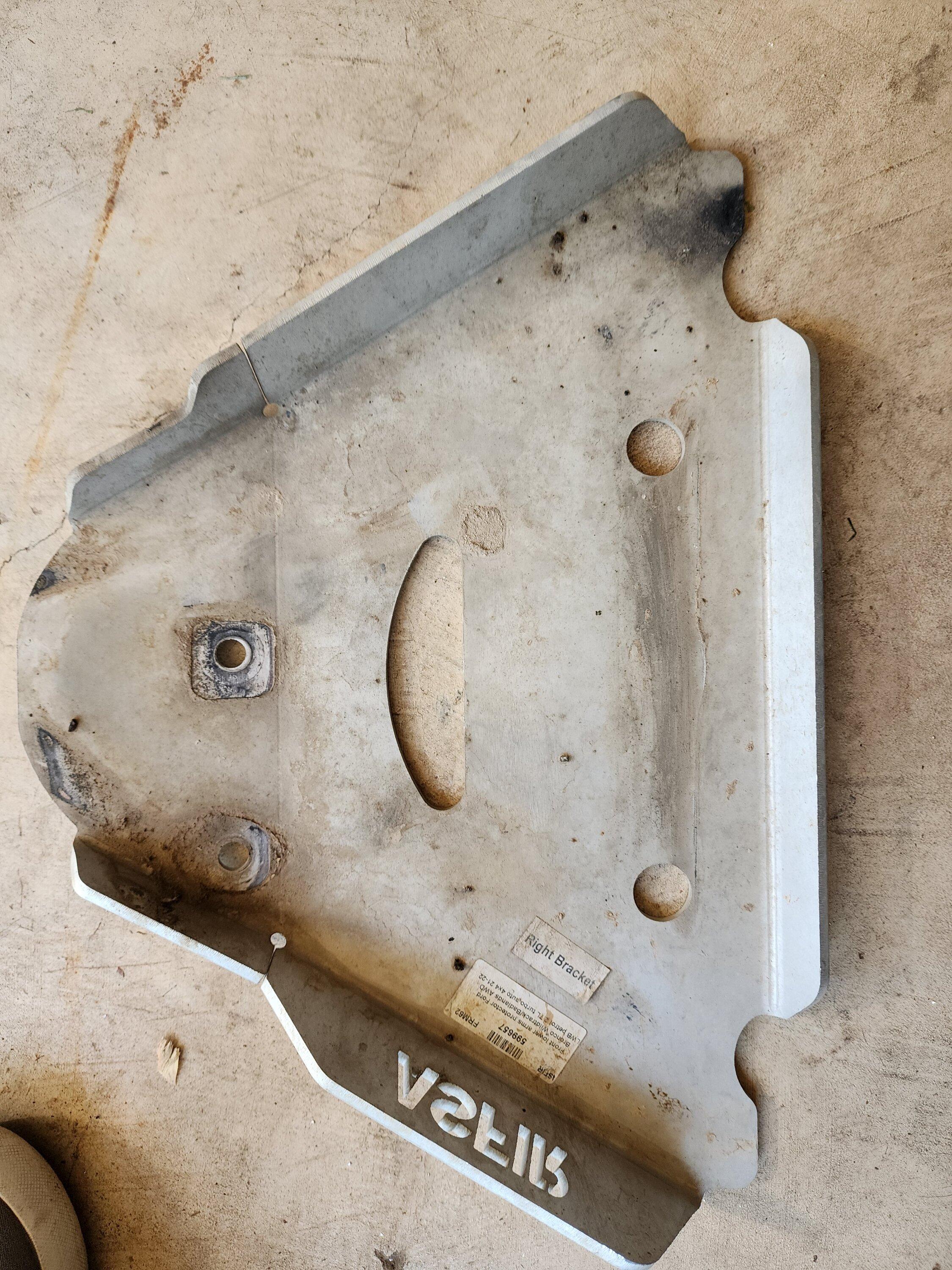

Contact point appears to be much closer to the edge, see dark areas, from what I saw after install the rivets aren't touching.

Checking in after many months and a few offroad trips. The polyethylene solved my creaking issue. I can't recall hearing it once since I installed. This was the material I used that I cut in pieces shaped as you see in the picture using a cutting tool. Just make sure you get the correct length rivet.
