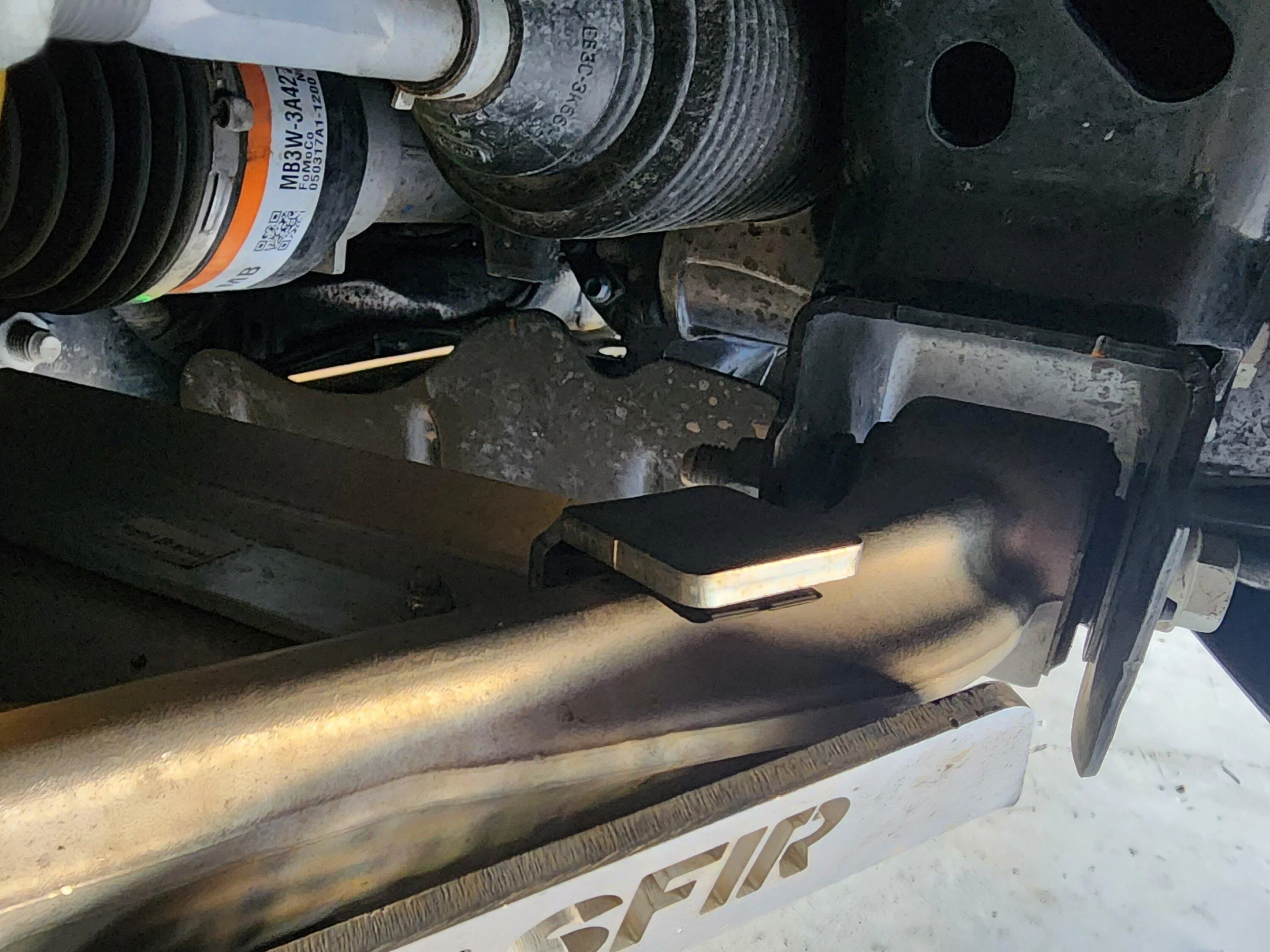

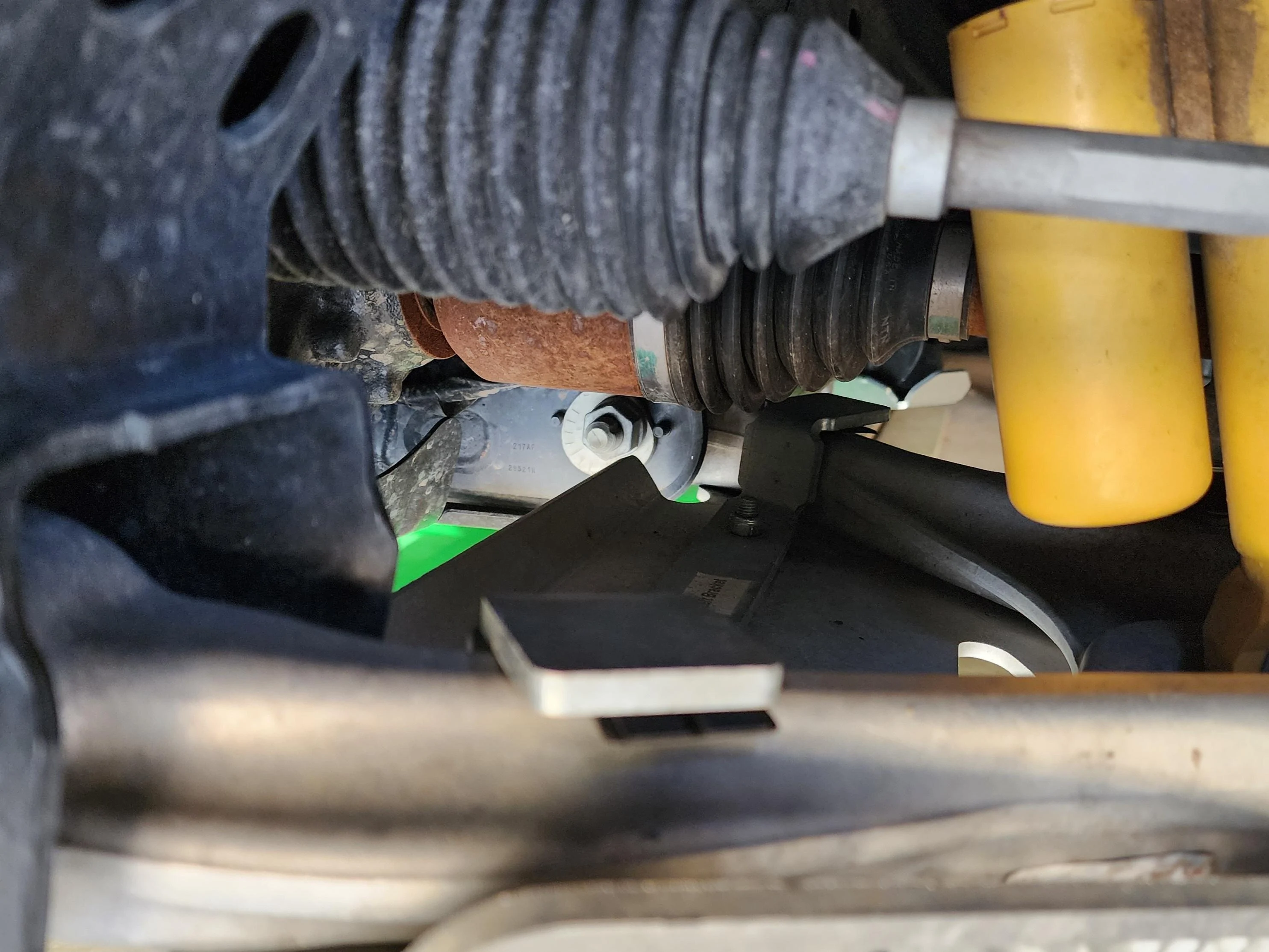

@ASFIR 4x4 So my creaking noises came back again. I again loosened only the clamping bolts of the skid near the engine and did some slow speed maneuvers and turning in my driveway. No sound at all. It's def not the shock nuts. It's tough to say why there is some binding when those are tightened but there definitely is. So I was thinking what could I try to allow some movement of that clamping piece? I came across these rubber wedges at my local Menards. They are almost the exact size of the clamping bar. I wedged them in above the A arm and under the clamp that ASFIR provides with the larger side of the wedge towards the center of the A Arm. After tightening things down I hear nothing. It seems that rubber will allow everything to move the little bit it needs to. They are cheap enough if they wear through or fall out I can add them back. I'm 500 miles in right now so will let you all know. Also, you can barely see them given their size. I'll take a picture when the weather cooperates.

Cool idea. Can you please post pictures of the rubber wedges installed? Do they stay in place and not move? Do you have to retighten the clamping bolts occasionally as these wedges wear, compress, or move?
So far they haven't moved, the one was off center from the get go, not tons of miles yet but it's still quiet
Ford Bronco LCA Skid Plate Creaking 20230417_135356
Ford Bronco LCA Skid Plate Creaking 20230417_135411
