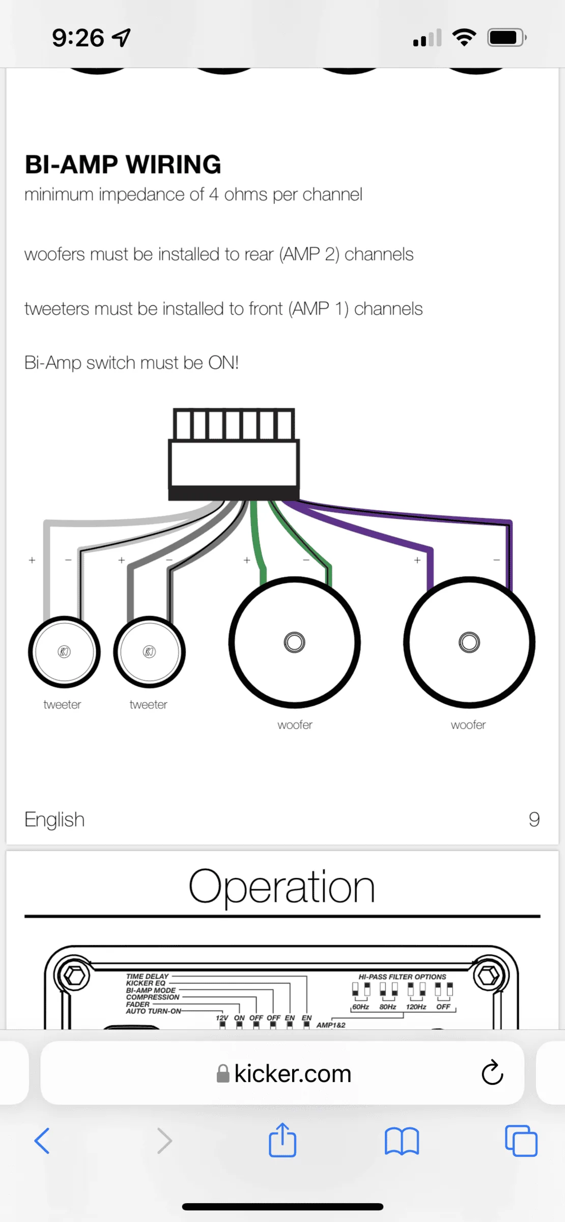

Are you powering all 6 speakers with the Kicker KEY? If so I don't think the DSP will work correctly. In order for the DSP to work correctly, you would need to bi-amp the fronts. If you are running all 6 speakers with 4 channels, there will be a compromise. The DSP works by automatically adjusting the crossover and time delay to each speaker. When the front stage is wired in parallel, the amp is trying to adjust time delay and the crossover points to 2 different speakers on a single channel at the same time. Someone correct me if I am wrong, but I don't think this is possible which is why it sounded better with it turned off.
You might be right but when I spoke with crutchfield I did ask this. They insisted the key had plenty of power to run both speakers up front on one channel. I suppose though maybe there would be an issue with dsp in this case maybe I’ll ask crutchfield again.
Only issue when you biamp the fronts you don’t get much sound out of the rear speakers. I went through this on my old car but I’ll try this evening using the biamp setting and see what happens. I’m pretty content on how it sounds now with it off.

I do think it has enough power for all 6 speakers. I'm just saying I don't believe the DSP works correctly if you are powering 6 speakers through 4 channels. If you are wanting to increase volume in the rear speakers, this is the way to go but with DSP off as you did. (y)

So in bi amp mode it will only amplify the fronts correct?
Yes. Bi-amp mode is specifically for powering a front stage, such as a component set. You do need to run a wire directly from the Kicker KEY to the tweeter or kickpanel 6.5"s in this case though.

Correct me if I’m wrong but I don’t think bi amp mode would work with the plug n play harness?
Yes you can. You just need to contact Joe at Plugnplay and ask him for this specific setup.
The return harness from the amp will include an extra set of wires to separate the front stage. You will run this directly to either the dash/tweeter or kick speakers. It depends on how its wired but plugnplay would tell you how to set it up.
