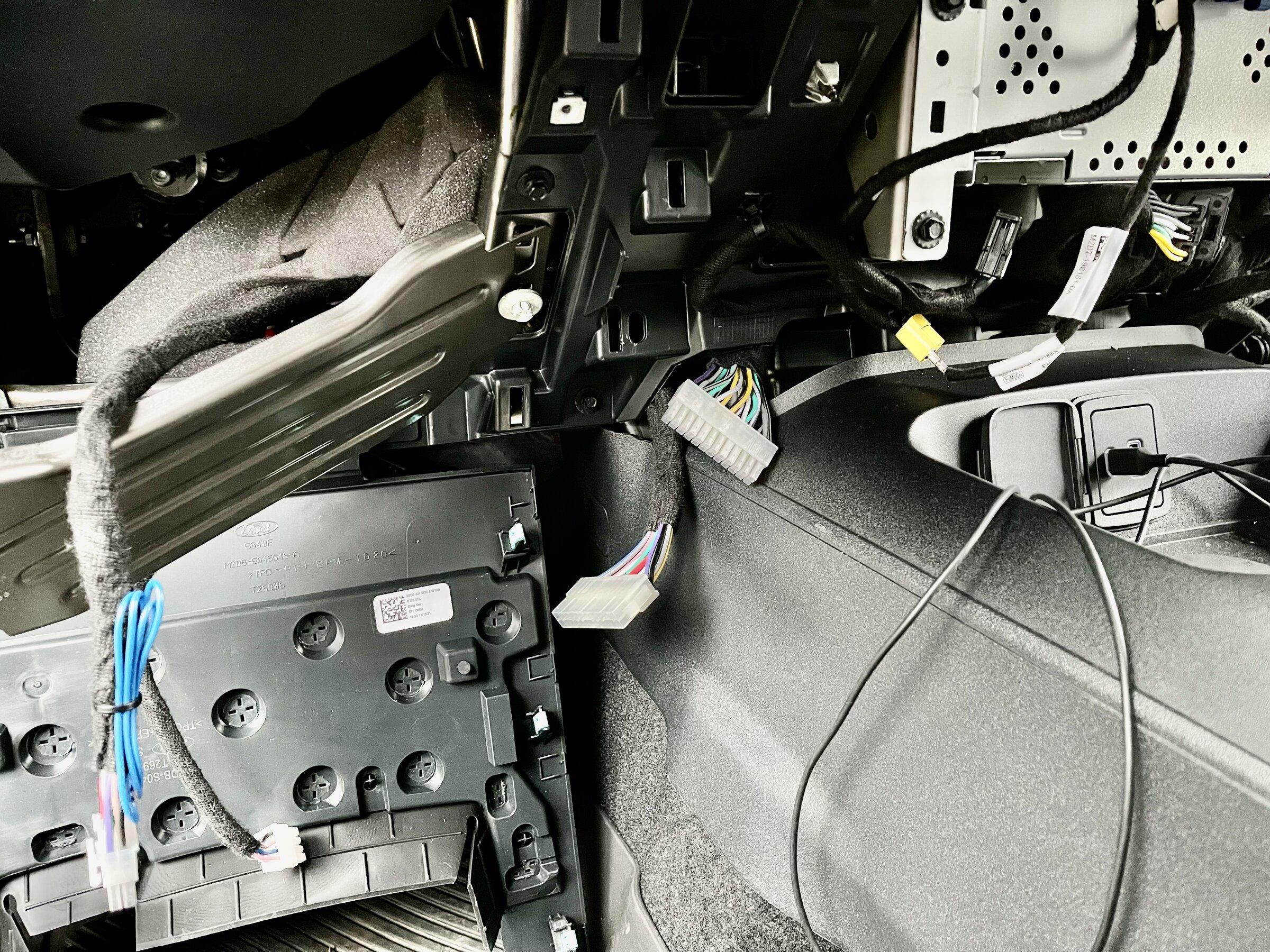

Once you set it up to your likings you won’t need to mess with it. The panel under the steering wheel is on a hinge it drops down and there’s a metal plate. Remove that plate and just lay the amp behind where it was then close up the panel just don’t completely close it so you can open it back up easily to make your changes. All you’ll need is a small flat head screw driver to adjust gains and flip the dip switches. Once your get the settings and gains set then mount it to the plate, I used Velcro with sticky tape on one side that I already had. You could even use zip ties if you wanted. This isn’t the greatest pic but it shows that there’s plenty of wire to get the amp under the steering wheel.
