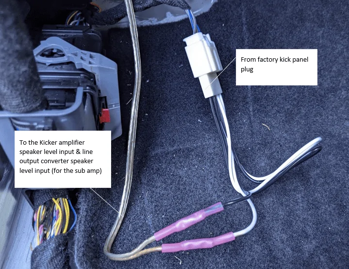

I actually did not purchase a harness. I used the Metra plug for the kick panels to feed both the Kicker amp input and an AudioControl line output converter for the sub amp. I did this on both sides for left and right.
For the output from the amplifier, I just ran new wires to the dash speakers and kick panels. Running wires is really easy in these vehicles.

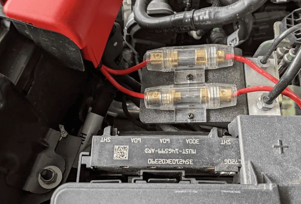

Finally, I ran a dedicated power and ground to both amplifiers (and line output converter).

Correct - I just used the signal from each kick panel (left and right)

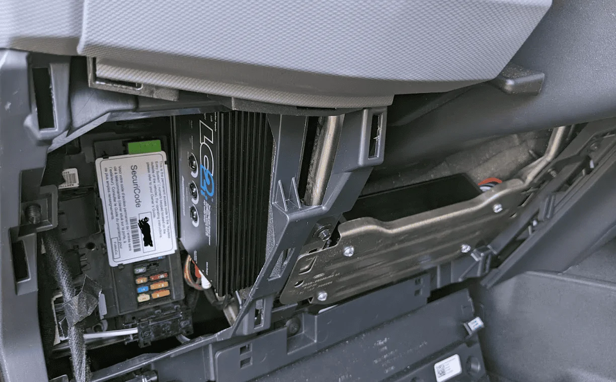

The two power cables I routed to the Kicker Key amp and the sub amp. Where one power wire is connected to the Kicker harness for power, I also tied in another, smaller-gauge wire to feed the lc2. I did the same for the ground. The lc2 just doesn't require that much amperage. It actually worked out well because I used 10awg heat-shrinking butt connectors (because of the 10awg power wire running to the battery). One side of the connector has the larger wire from the battery; the other side of the connector has both the power wire from the key harness and the extra power wire to feed the lc2. I did the same for the ground and tied it to a suitable ground point under the dash.

I actually used the lc2's signal sense feature, so the remote wire on the lc2 is out to turn on the sub amp.
