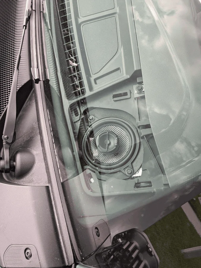

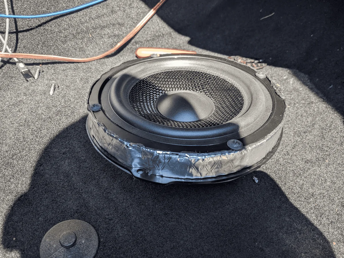

To be fair, I ran my Kicker amplifier a little differently than most: I wired it for bi-amp mode and replaced both the dash speakers and the kick panel speakers. I went with Focal for the dash and Dayton Audio for the kick panels (Dayton Audio had very similar specs with the Focals at a bargain-basement price of $60 for the pair).
Putting the amp in bi-amp mode adds additional crossovers for the dash and kick panel speakers in addition to the dip switches to add an extra crossover. So, I ended up with the following crossover points:
Focal 4" 2-way dash speakers: Only play above 320hz
Dayton Audio 6.5" kick panel speakers: Only play between 120hz and 640hz
10" Infinity subwoofer: Only plays below 120hz
Rear stock speakers: I have no idea but can't really hear them anyway
To add bass you have to move air, and small speakers are just not capable of moving enough air. So yes, adding any type of sub will certainly help. My single 10 is enough to fill out the sound and allow me to feel the bass drum kicks again, and the kick panels have good mid-bass.
