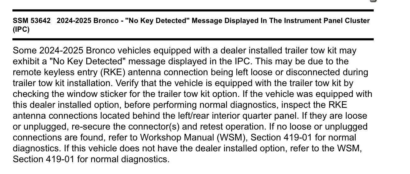

So mine '24 Badlands has an issue I think I posted here earlier but to clarify, sometimes the front doors don't work when I approach and just pull on the handle, the back doors NEVER work with touching the handle and the tailgate absolutely doesn't work and sometime doesn't work with the fob. I always approach the truck with the fob in my hand. then when I do get in the dash tells me there's no key.
Ducati1098
9,995
23,244
Midwest
The back doors aren’t supposed to work. They don’t have the touch sensors. Only the front doors and tailgate.
If you’ve had anything installed in the rear, like tow package or anything else, I would check the 2 antennas in the back and make sure they’re plugged in. Very common issue.
Actually mine (Sasquatch) does have a touch sensor and if I hold the fob up to it, it works. Same with the ignition. If I place the fob under the dash directly under the starter button the engine starts, otherwise, crickets.
