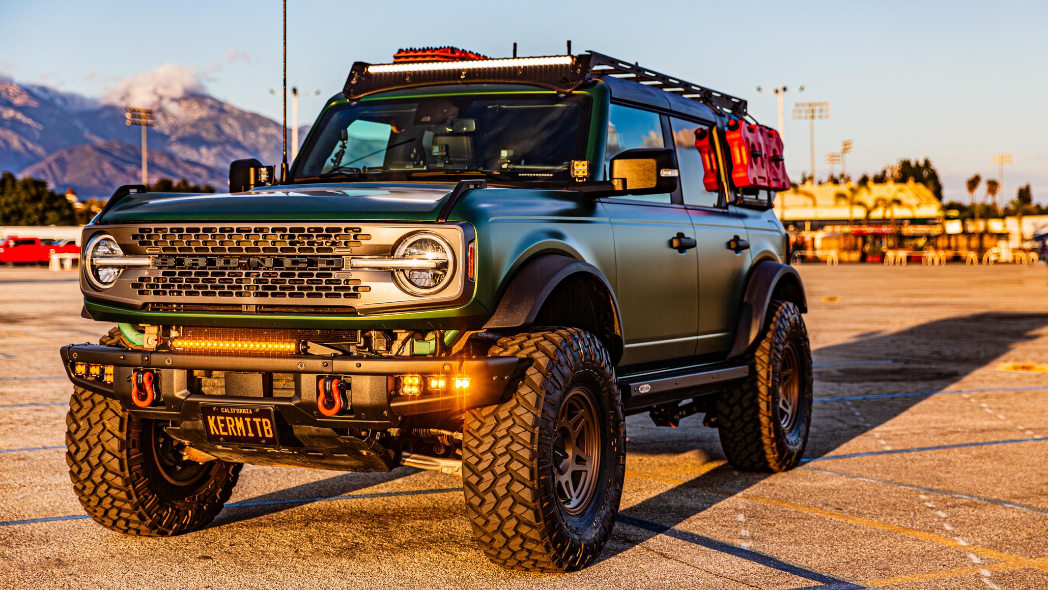

These are 37" Nitto Trail Grapplers which is all pretty much all I need for now at least and things get super heavy past that. We re-geared to 4.88. Warning to those upgrading front axle to Dana 44 Ultimate. That comes in a variety of gearings but choose wisely. The rear Dana 60 has fewer choices and jumps from 4.88 to 5.29!
You mean 5.38s not 5.29
Excellent build, I have the ultimate 60 and Ultimate FDU 44 as well. great choices.
the U60 only added about 110lbs to my little 2dr...

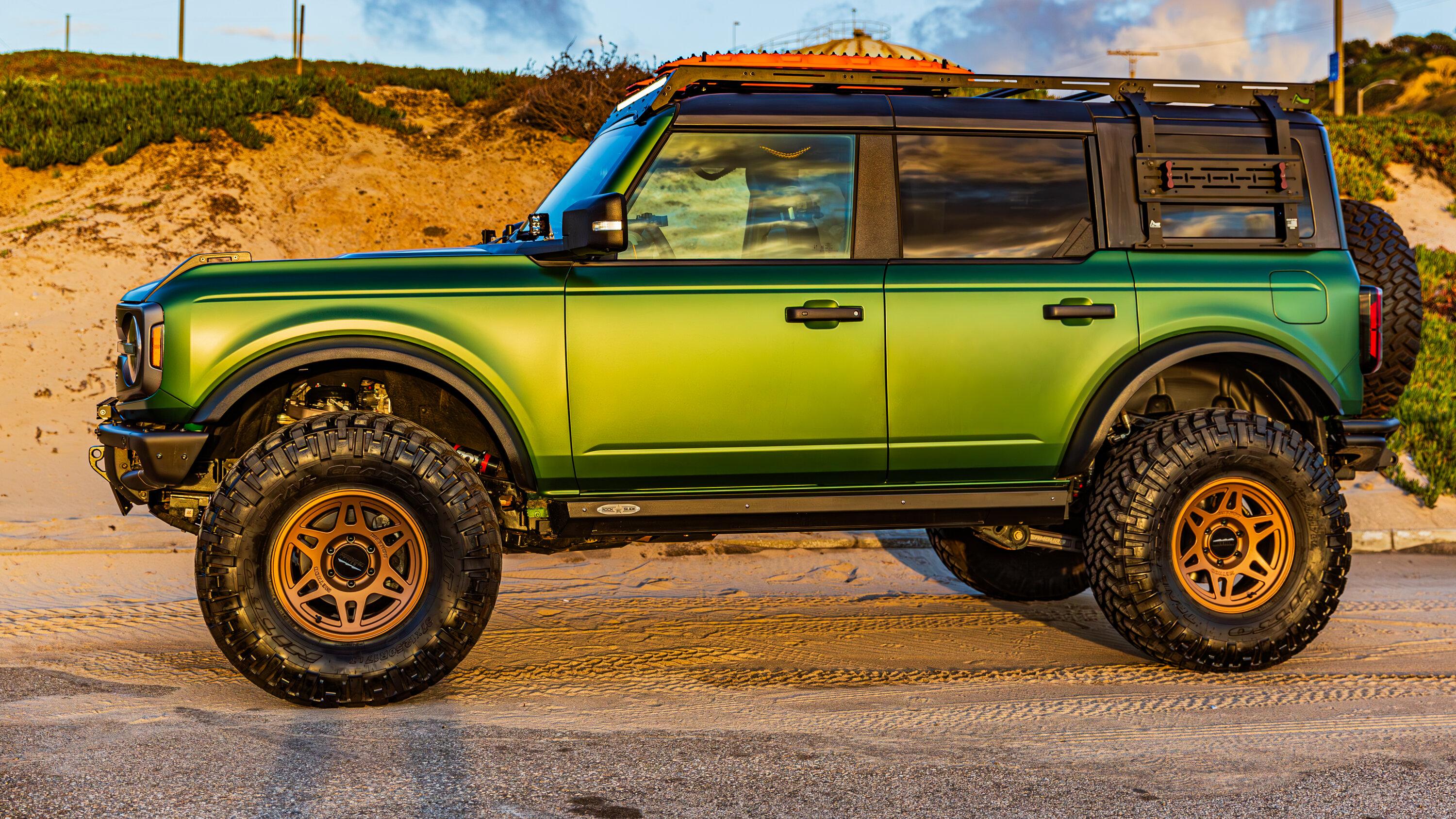

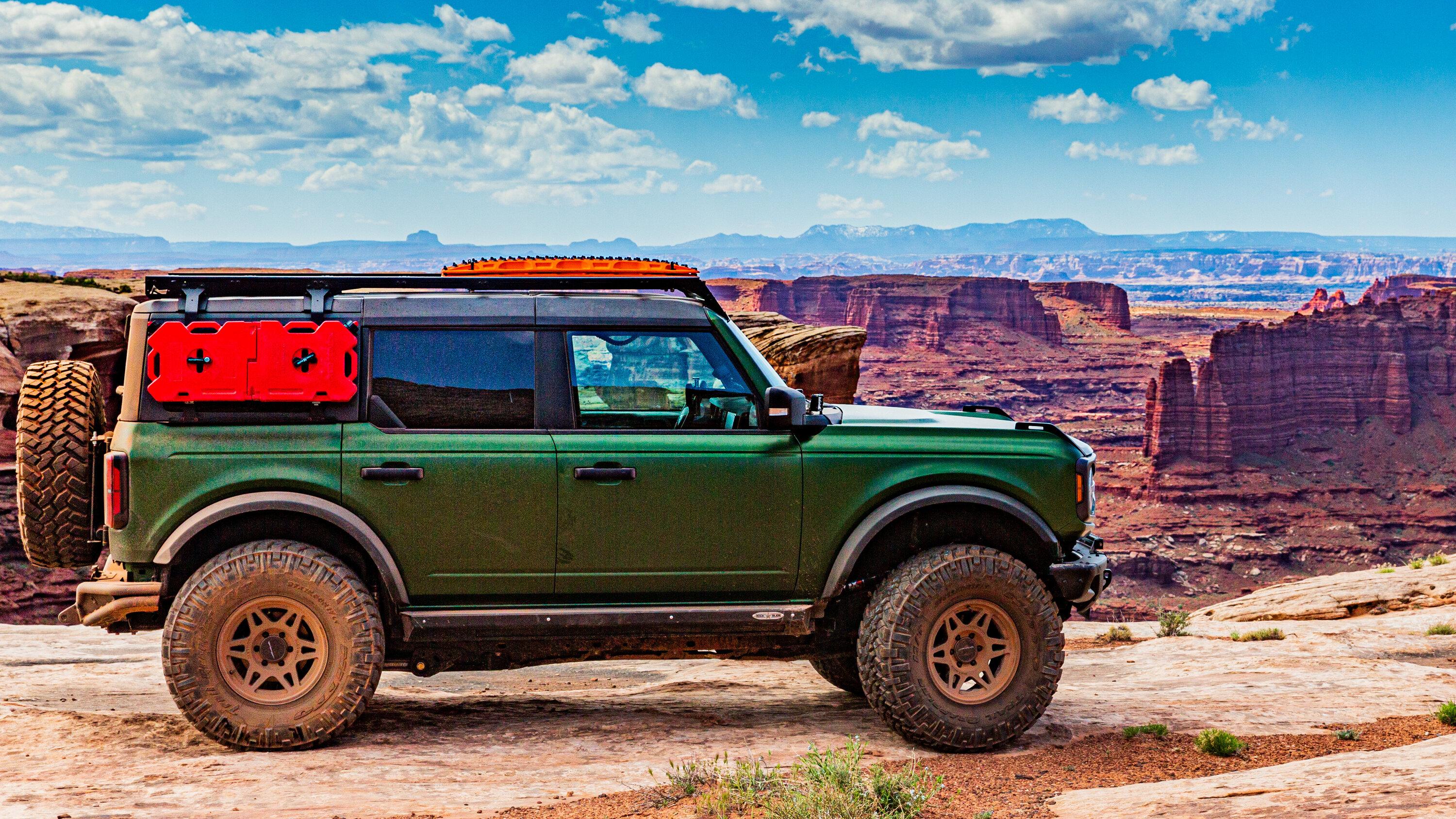

Did you add a body lift? what size?
Great eye!
As a stop-gap measure for our 37", we used the BroncBuster 3" body lift kit first on the stock Bilstein shocks and then with the Fox 2.5 which were under sprung for our weight. They served their purpose but it was a wee bit scary on off-camber stuff. It is also why I've refrained from posting until now - I didn't love the look.
The before w/ 3" body lift and droopy rear and then after with no body lift really shows how preferable it is to have properly calibrated coil-overs.
