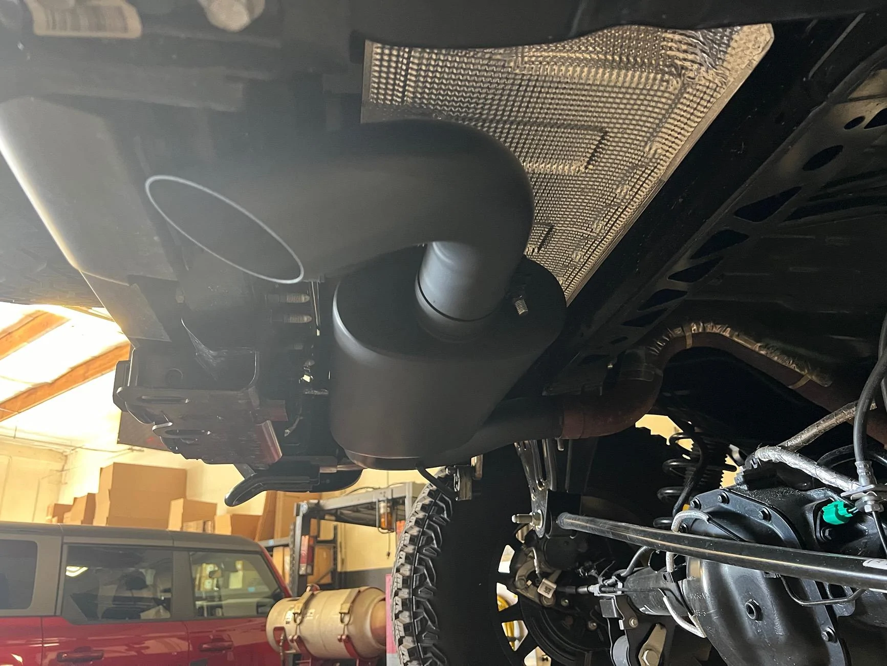

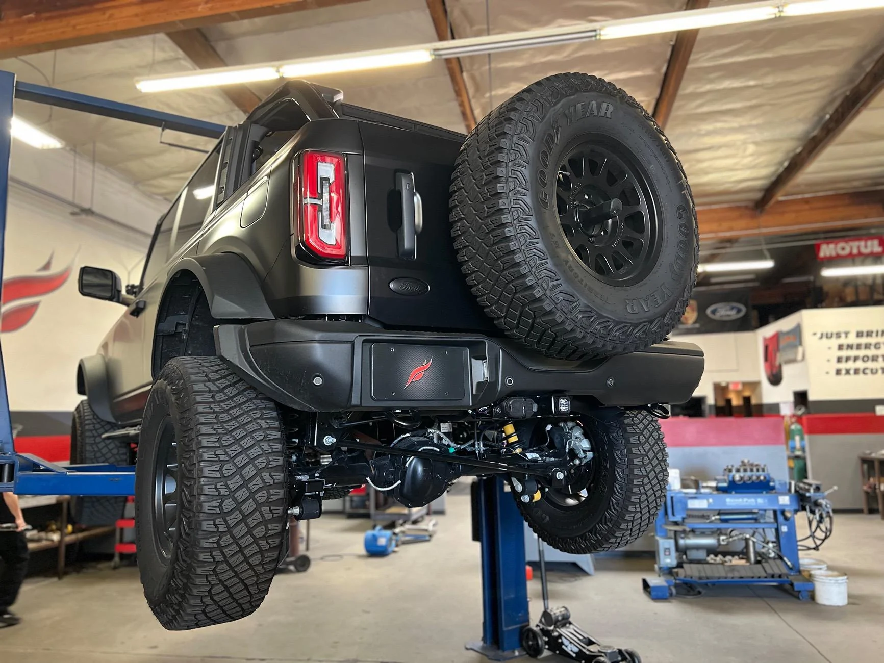

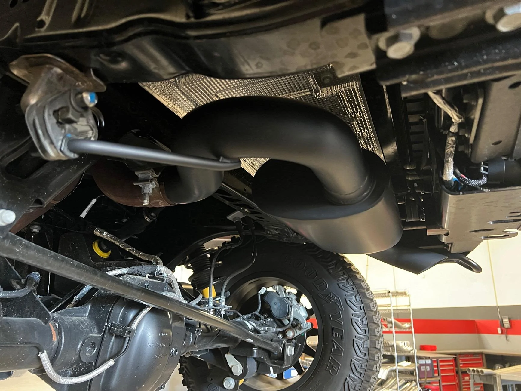

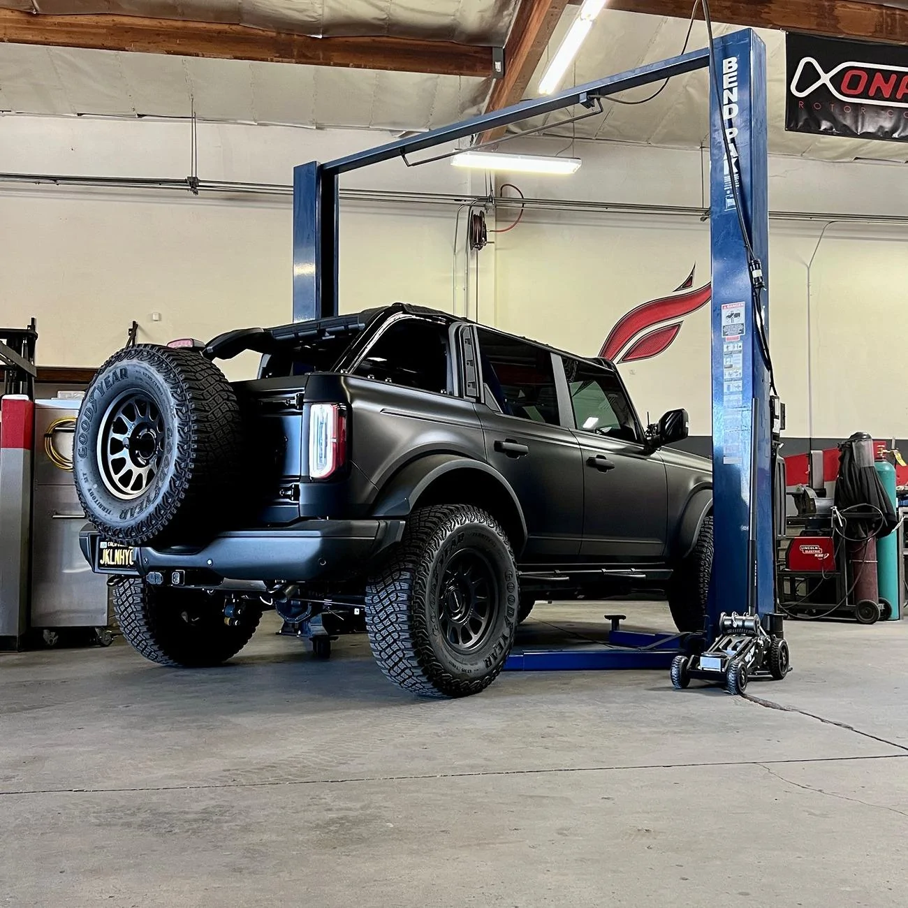

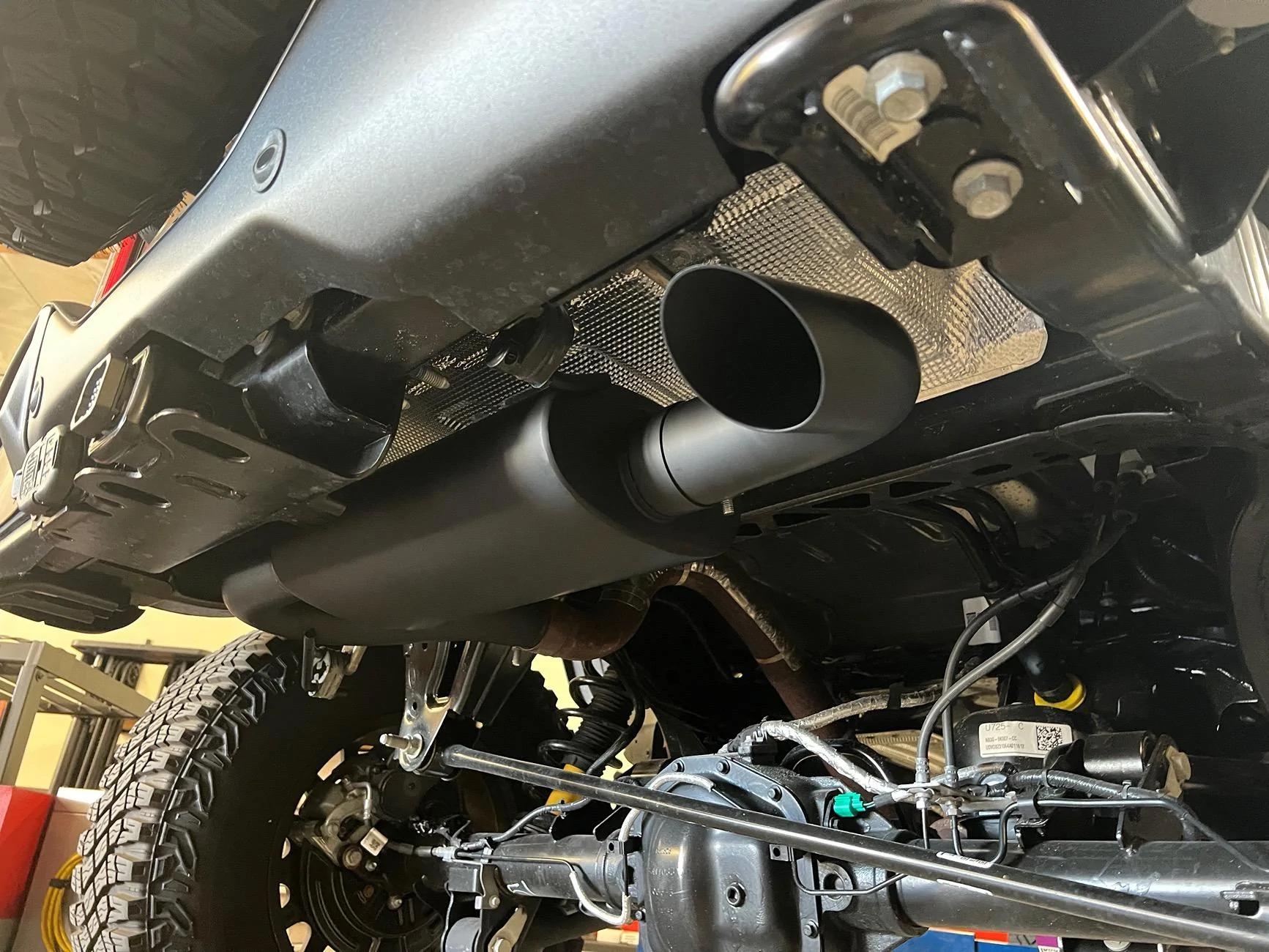

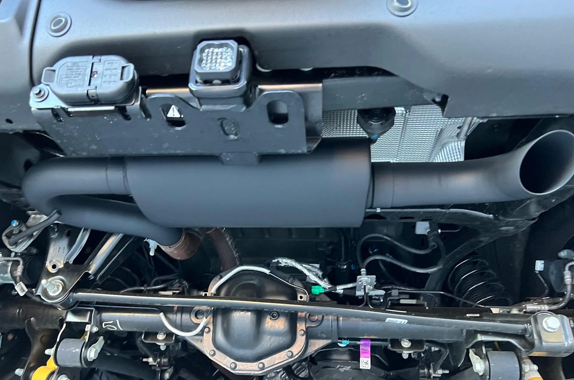

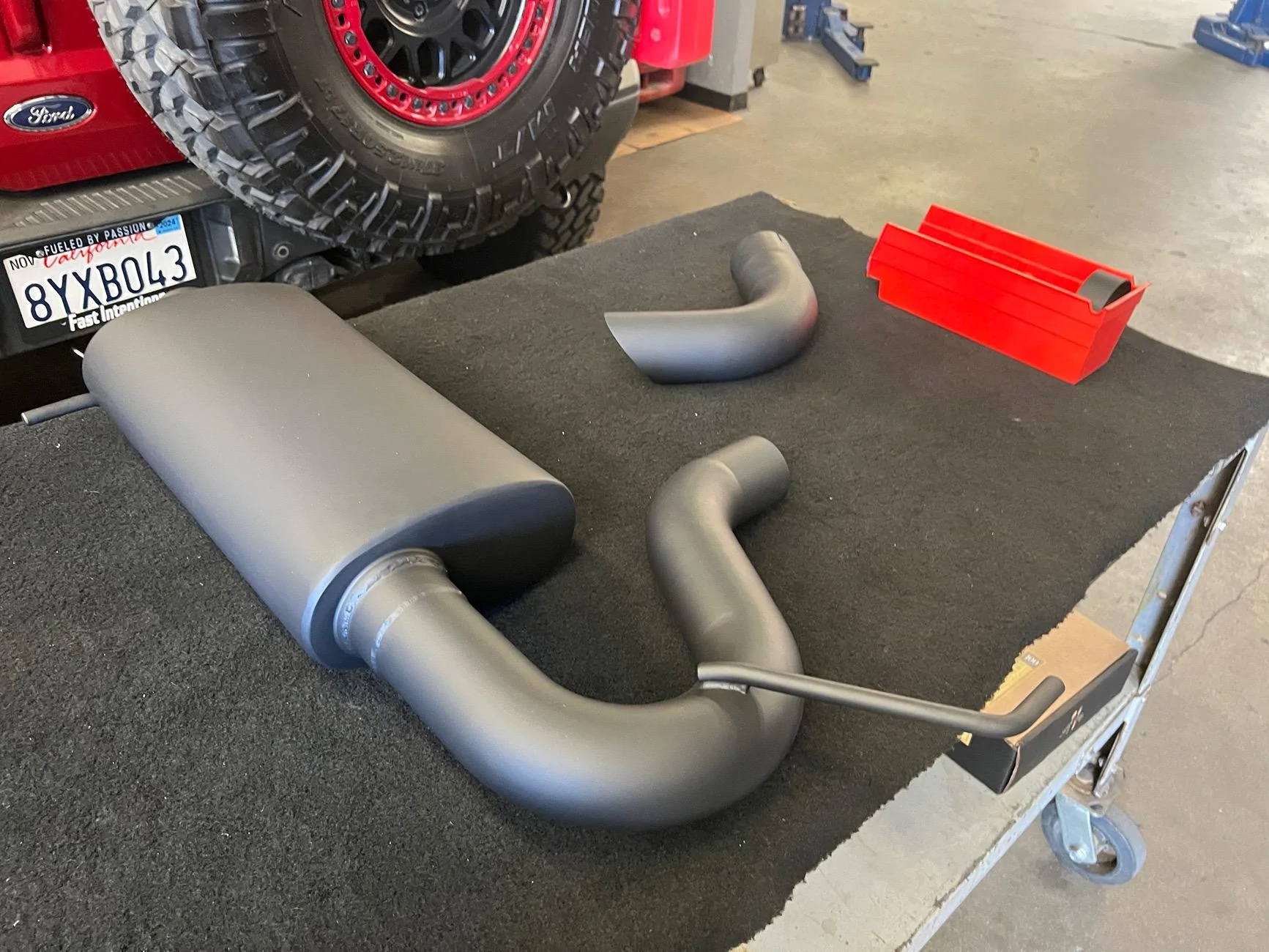

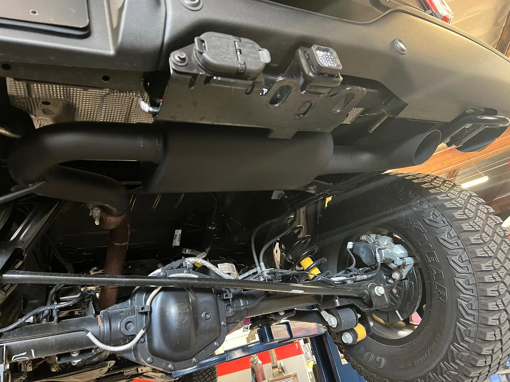

Got my @Fast Intentions Inc. exhaust installed. Went with the ceramic black coating to match the rest of the rig's theme. It looks and sounds great. A nice deep tone with a bit of rumble, but not obnoxious at all (in my opinion).
Big thank you to Kevin at FI for his knowledge sharing and to his team for the install. They were super quick and professional. Highly recommend them!

Thanks for sharing your review and we appreciate your business. I'm glad to hear that you're enjoying the exhaust.
Your truck looked great in our shop the other day. Looks really menacing all blacked out.

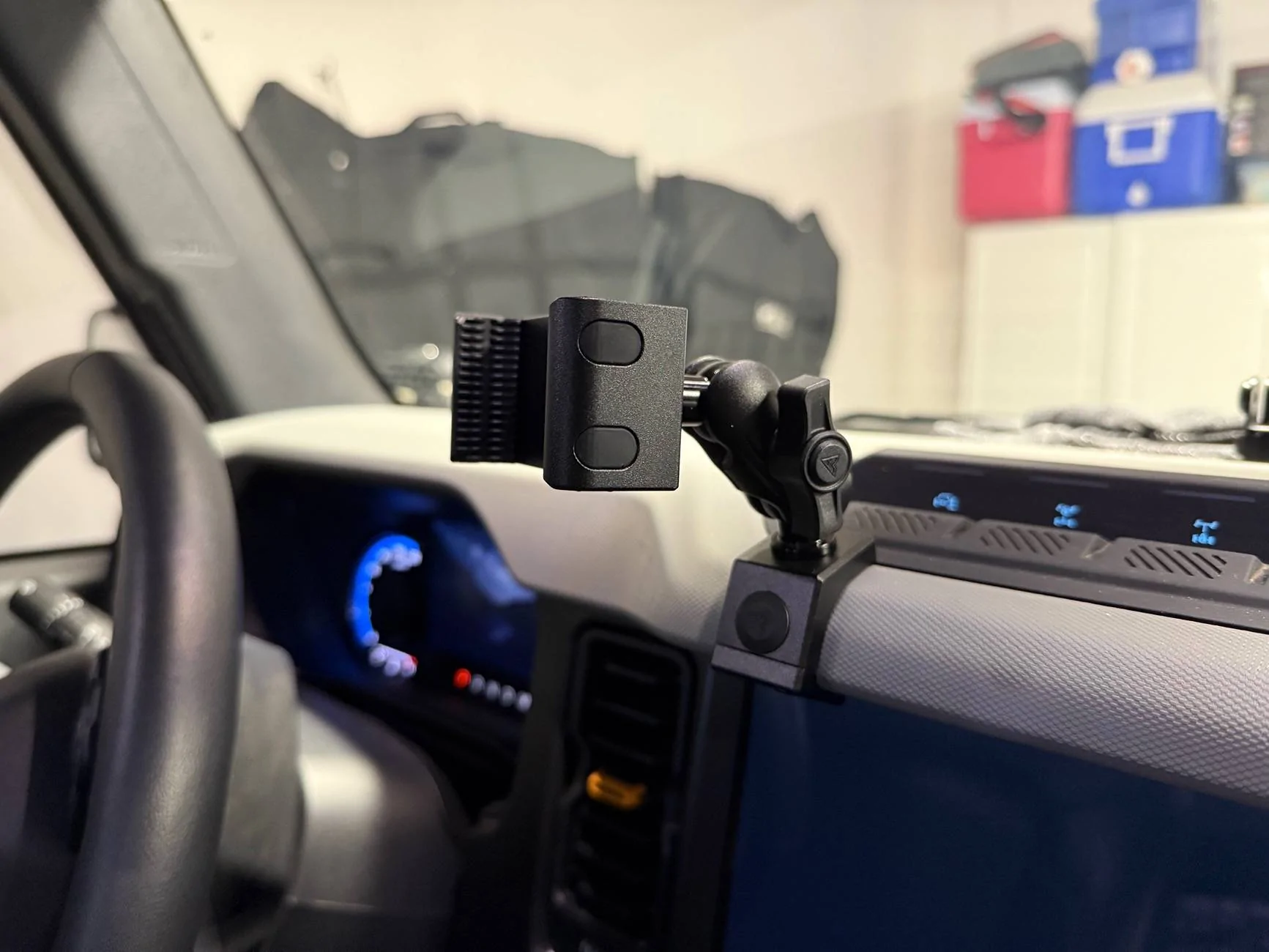

1. Added the Tackform springload phone mount. I considered some the other options that involved a rail type mount and/or drilling holes into the dash. In the end, I convinced myself this was sufficient for my needs. It Is very sturdy and no issues when off-roading. I also added a small GoPro mount at the OEM mounting point. In the future I may consider Tackform’s grab handle iPad mount.

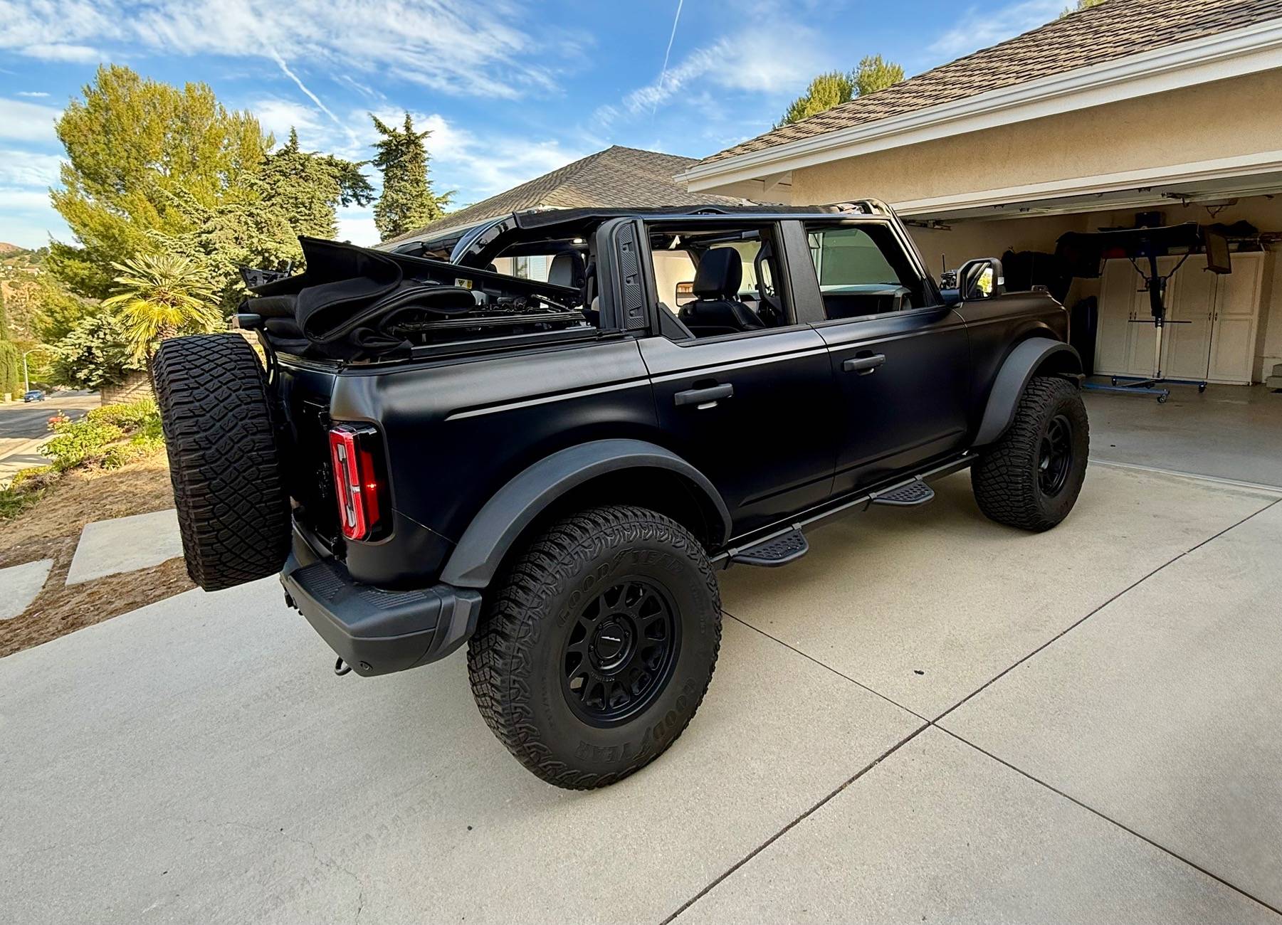

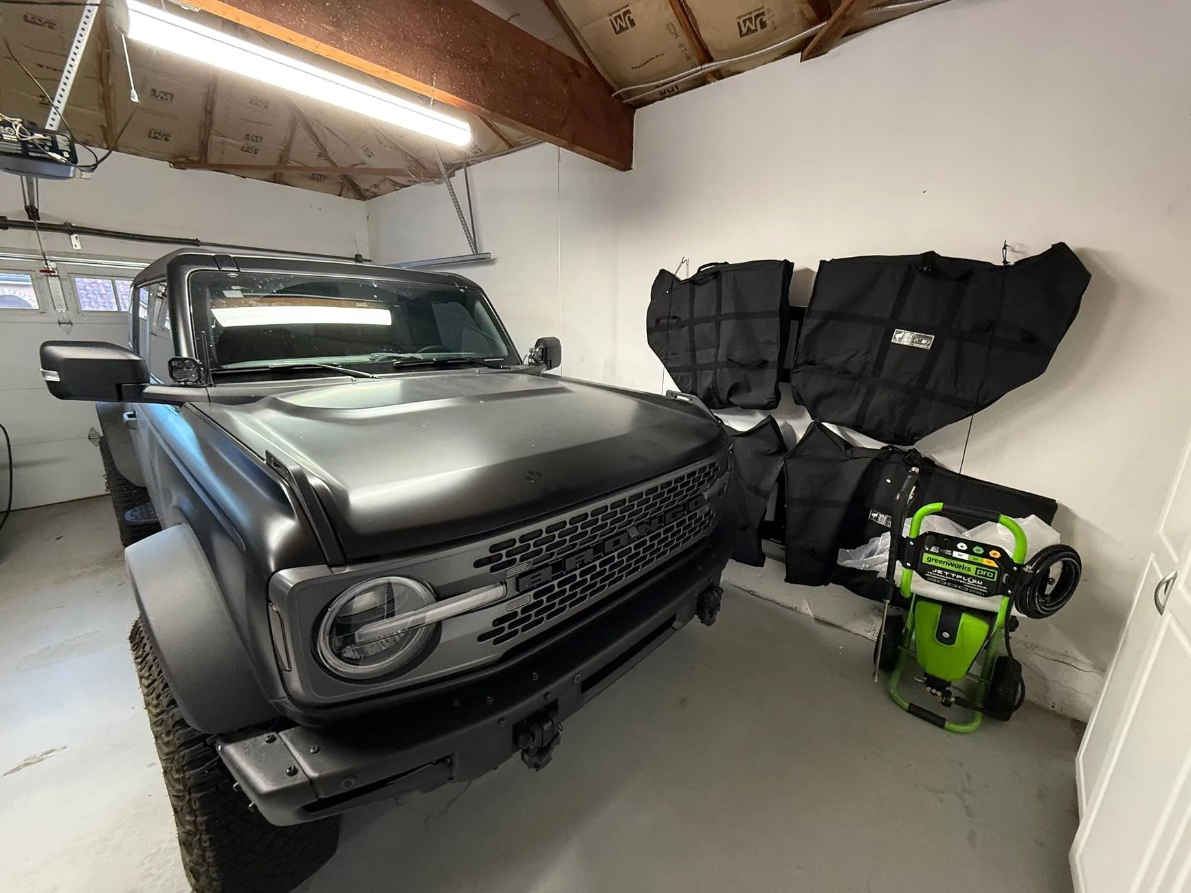

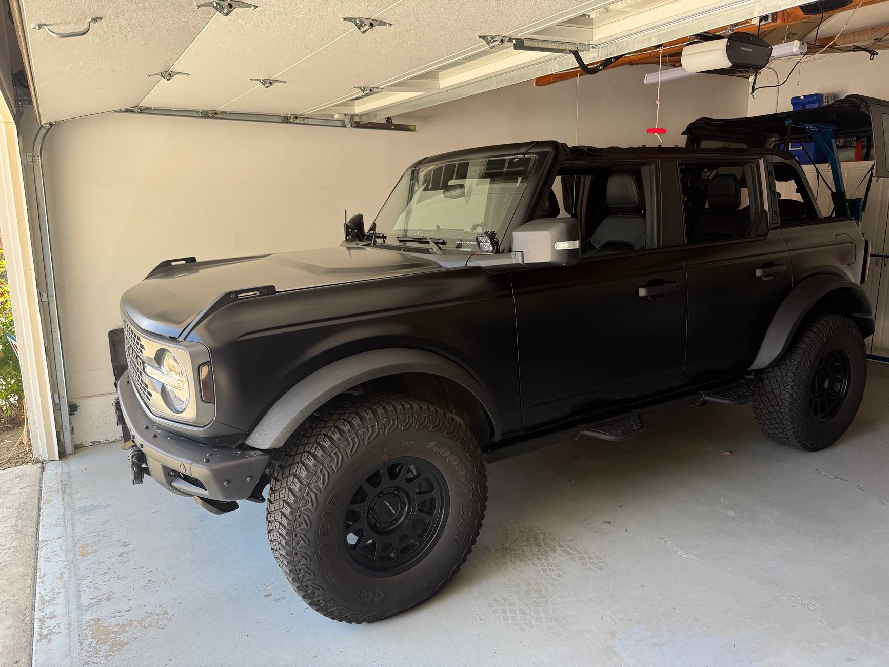

Spent the past couple of days getting her ready for the official start of summer. First, a good wash to get rid of most of the mud and sand from the last couple of trips.
Then, on to removing the hardtop and swapping in the soft top. I’m calling this project an 85% success. For some reason, we could not get one of the soft top bolts to line up on the left side. Probably means I need to adjust the receiving brackets a bit more, but after a couple of hours of fighting with it (and a few deep scratches on the roll bar), I gave up. Hoping the two bolts on the left side will be secure enough for now. Oddly, the soft top seems to work fine - opens, closes and latches relatively easily (even with my JTops hard top version in the way).

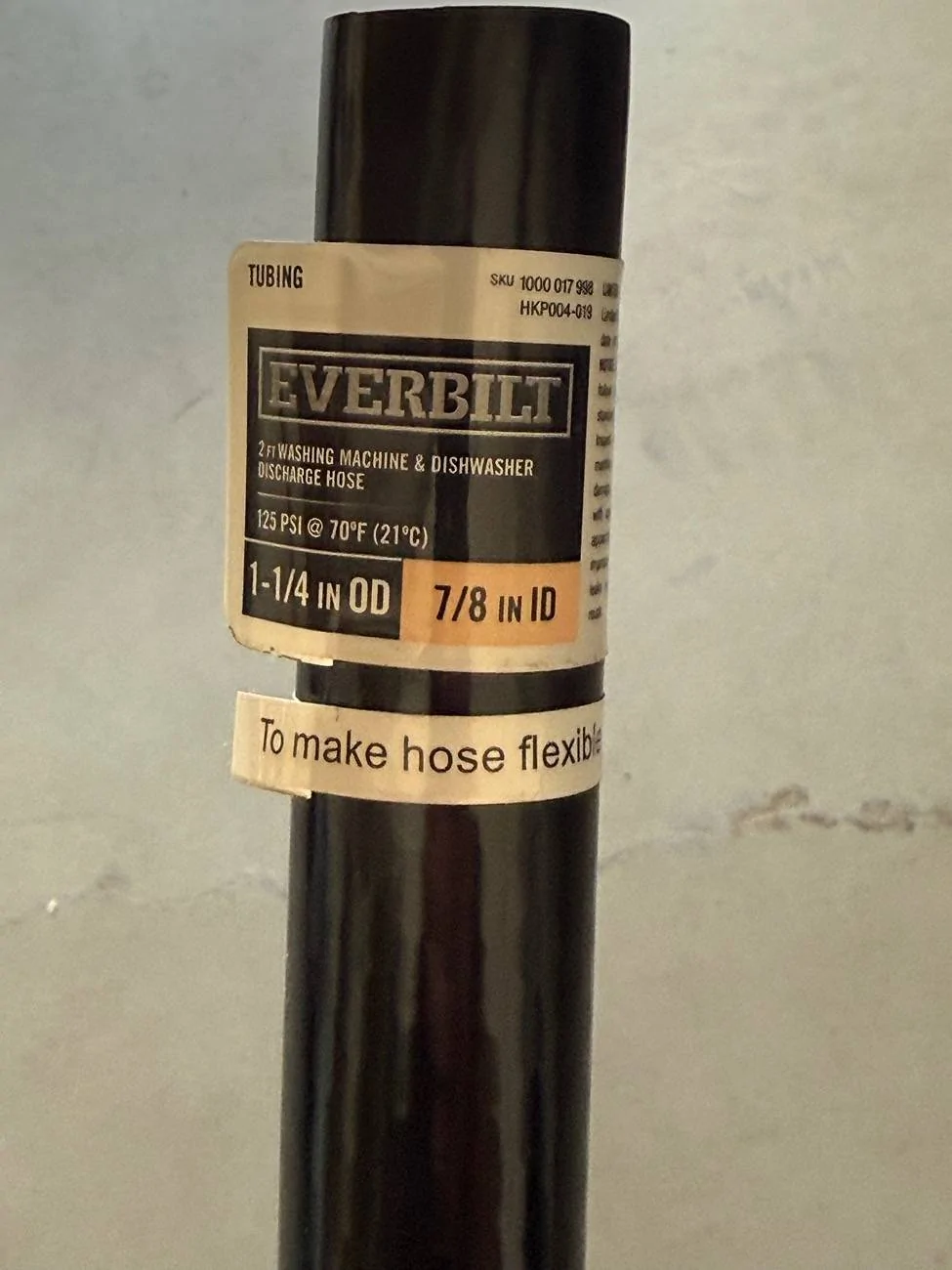

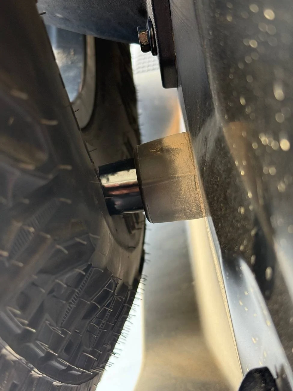

Added the extension for the spare tire bumper. Kudos to the forum member who suggested using the standard dishwasher drain hose. Picked it up from Home Depot for $8 and cut it to size. For my 0 offset wheels, that was approximately 7/8” past the end of the existing Sasquatch stops.

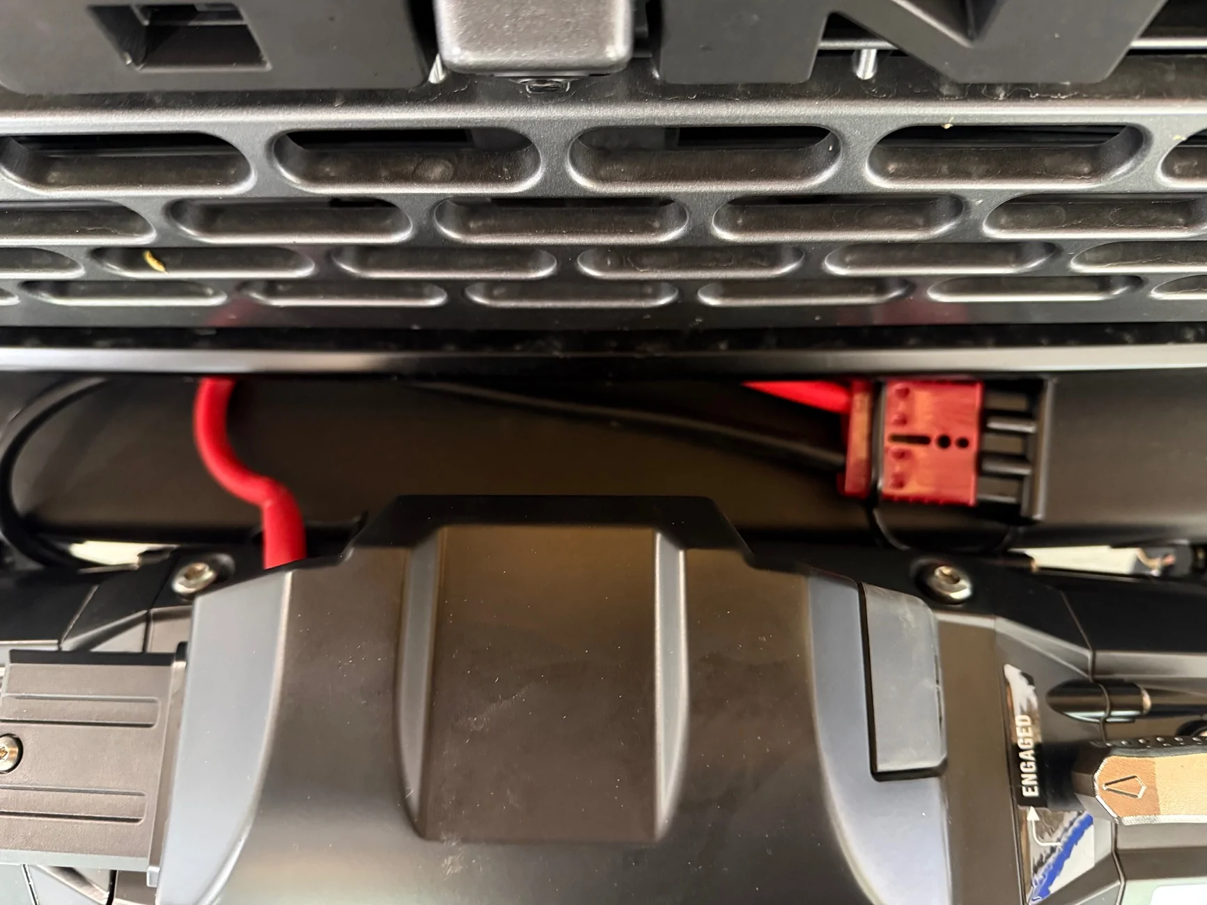

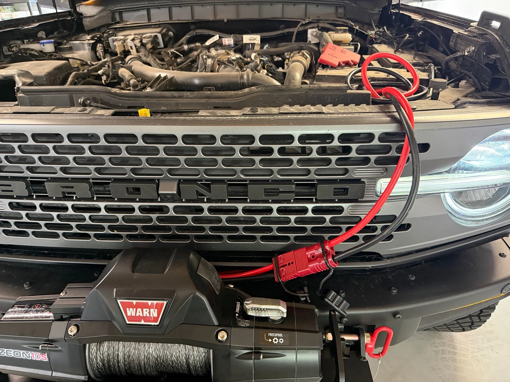

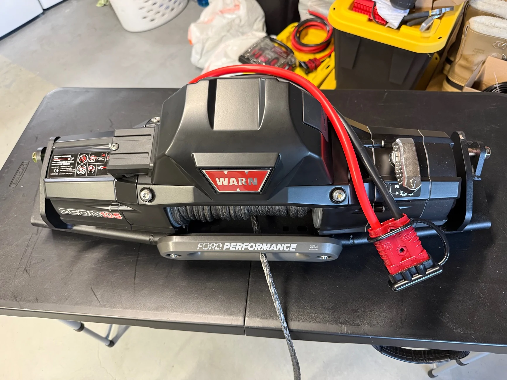

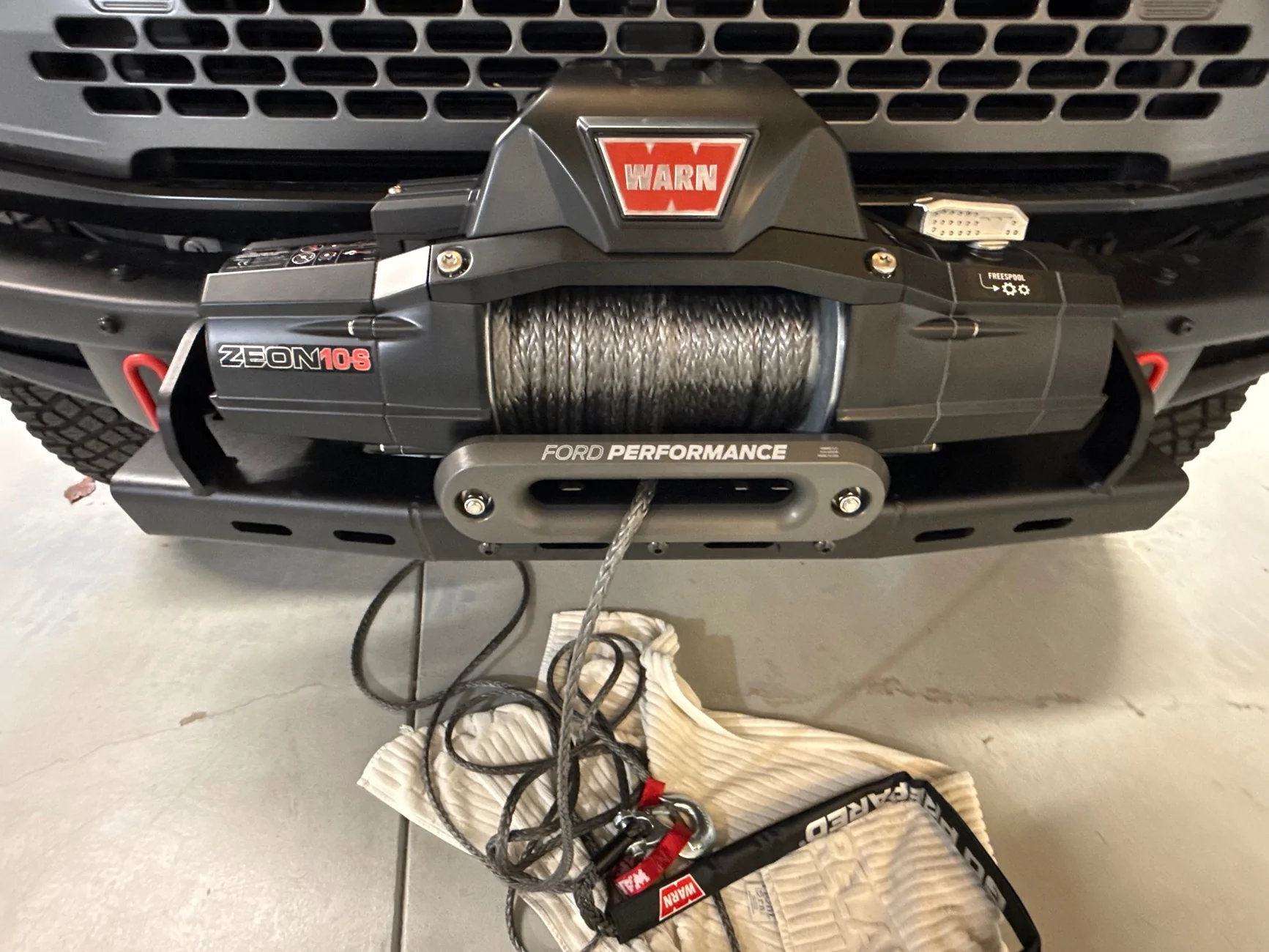

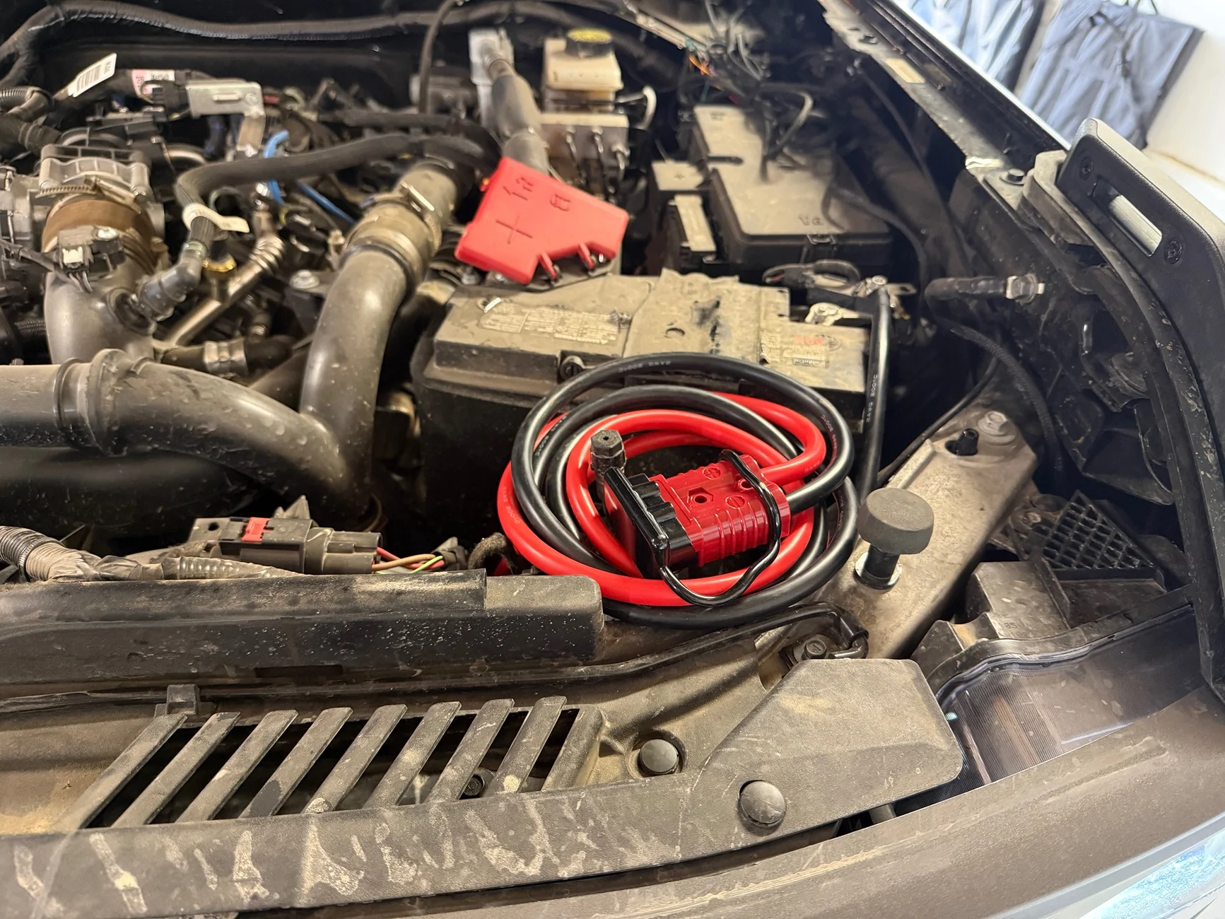

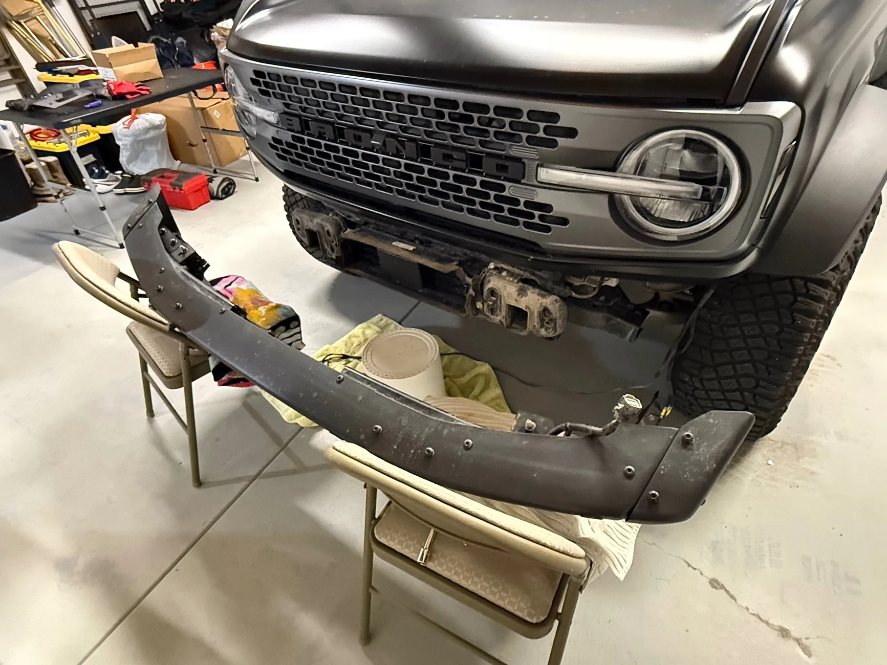

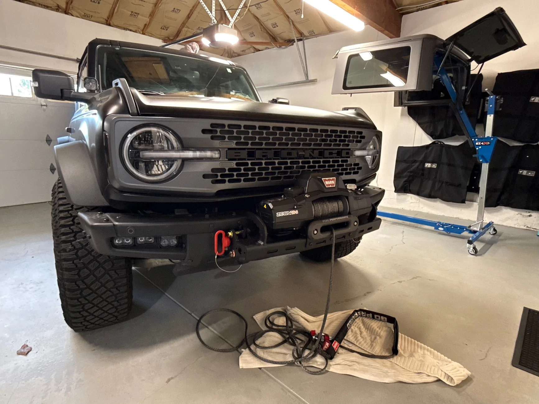

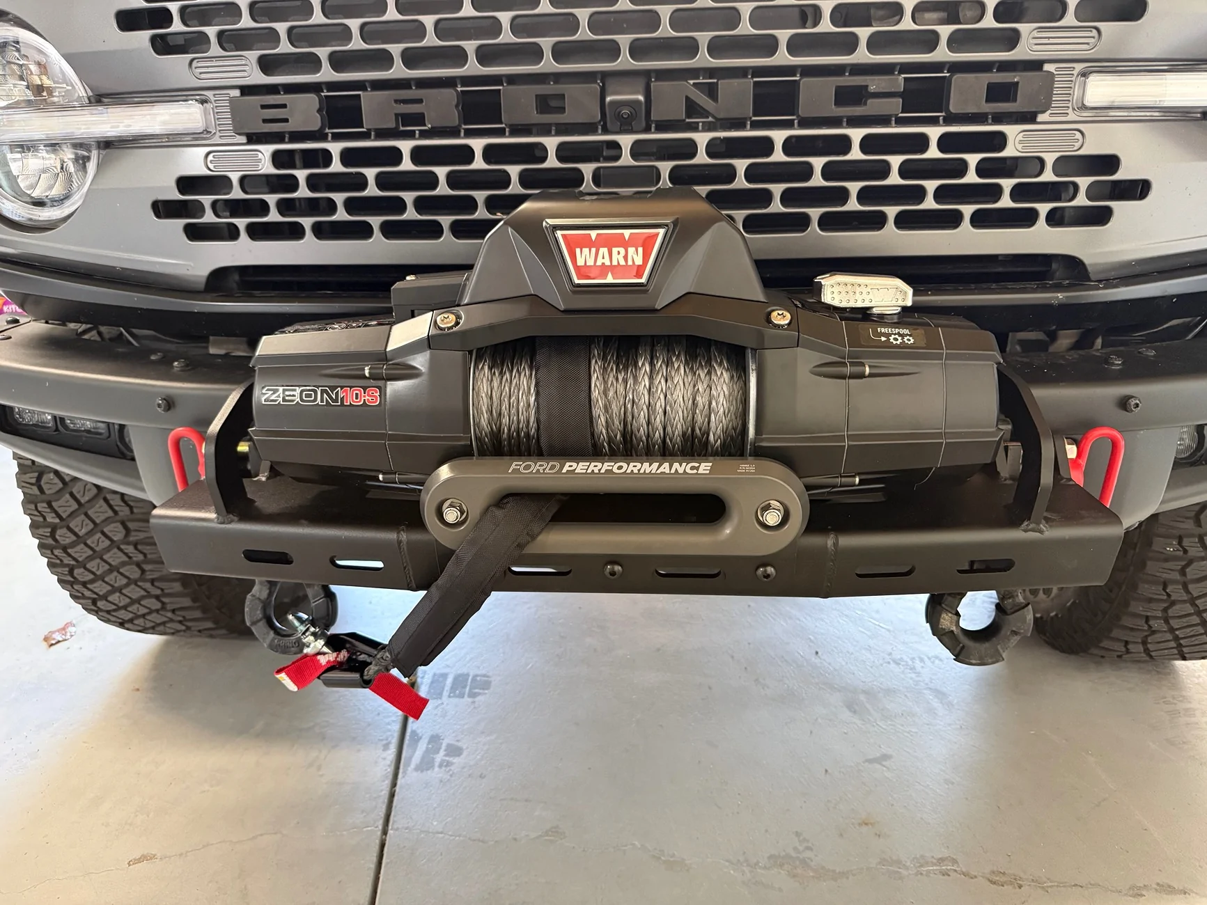

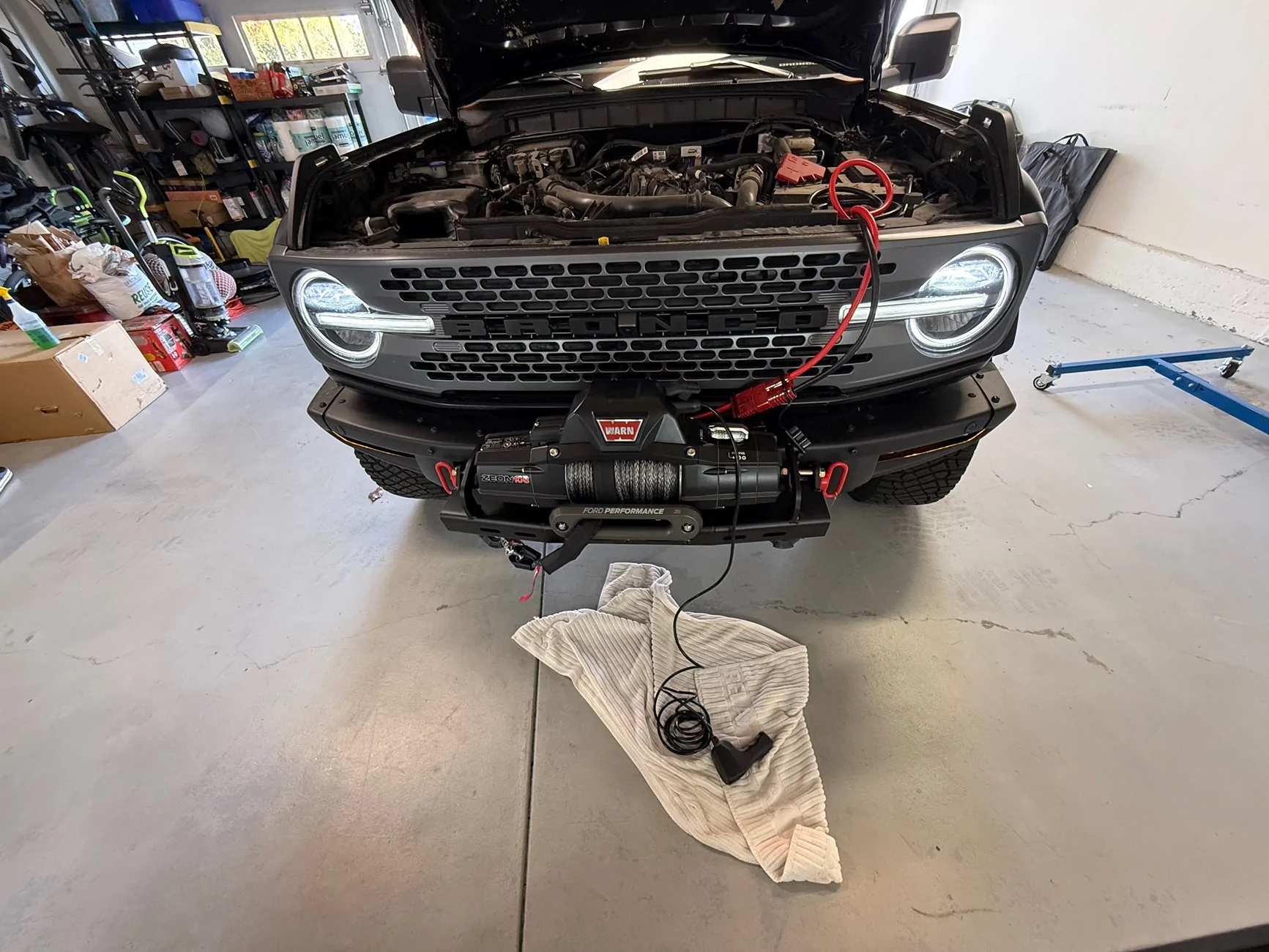

Wrapped up the install of the Warn Zeon winch and Maximus 3 winch mount. Probably took 5-6 hours all in over a couple of days working alone, including adding quick connects to the winch and adding the frame home reinforcements from the FP winch kit. Still have a few minor adjustments to make as the tolerances for the Maximus mount are pretty tight, but looks good and everything works great.
If I have the energy, will try to add the Raptor tailgate hinges tomorrow…

Hey did you find the added weight of the winch made the front sag? I've seen a few threads saying they did. I have a bumper and winch on order so trying to work out if I need to level the truck when I get one.
Bronco looks great!
Bronco looks great!
It definitely causes a visible sag, maybe 3/4 of an inch. I think any larger winch would do that unless you had heavy duty springs up front. Doesn’t bother me too much though as this is not a permanent mount.
