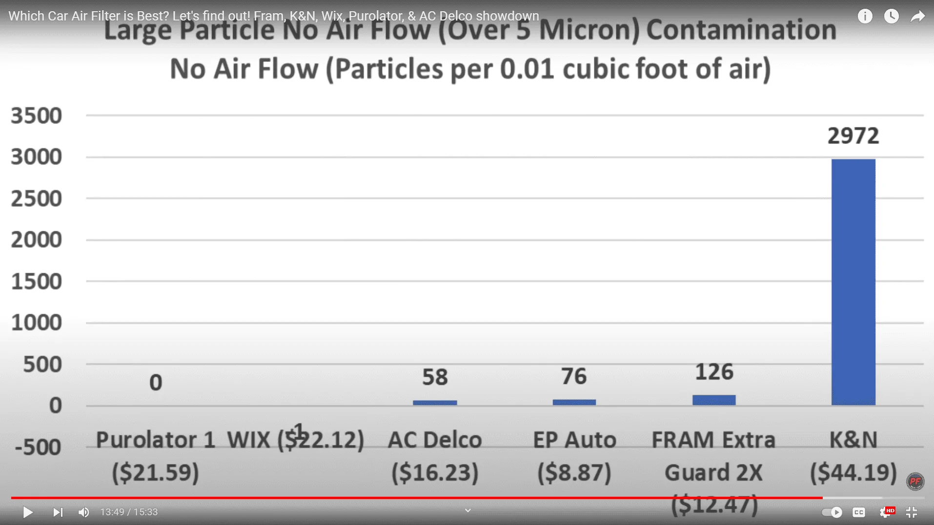

Stick to OEM, or a high quality dry filter.
K&N will let in more debris and particles. That is just the nature of the beast.
The biggest issue is them being oiled and these being turbo'd motors. The oil will enter the turbo housing and can cause damage like scoring.
Ford Bronco K&N Replacement Air Filter 1713797691397-cz
Cliff notes: The K&N lets in a shit ton of dirt, particles, debris, etc into your engine. Absolutely dumb to run on a street car.
Wix or OEM is the way to go.
