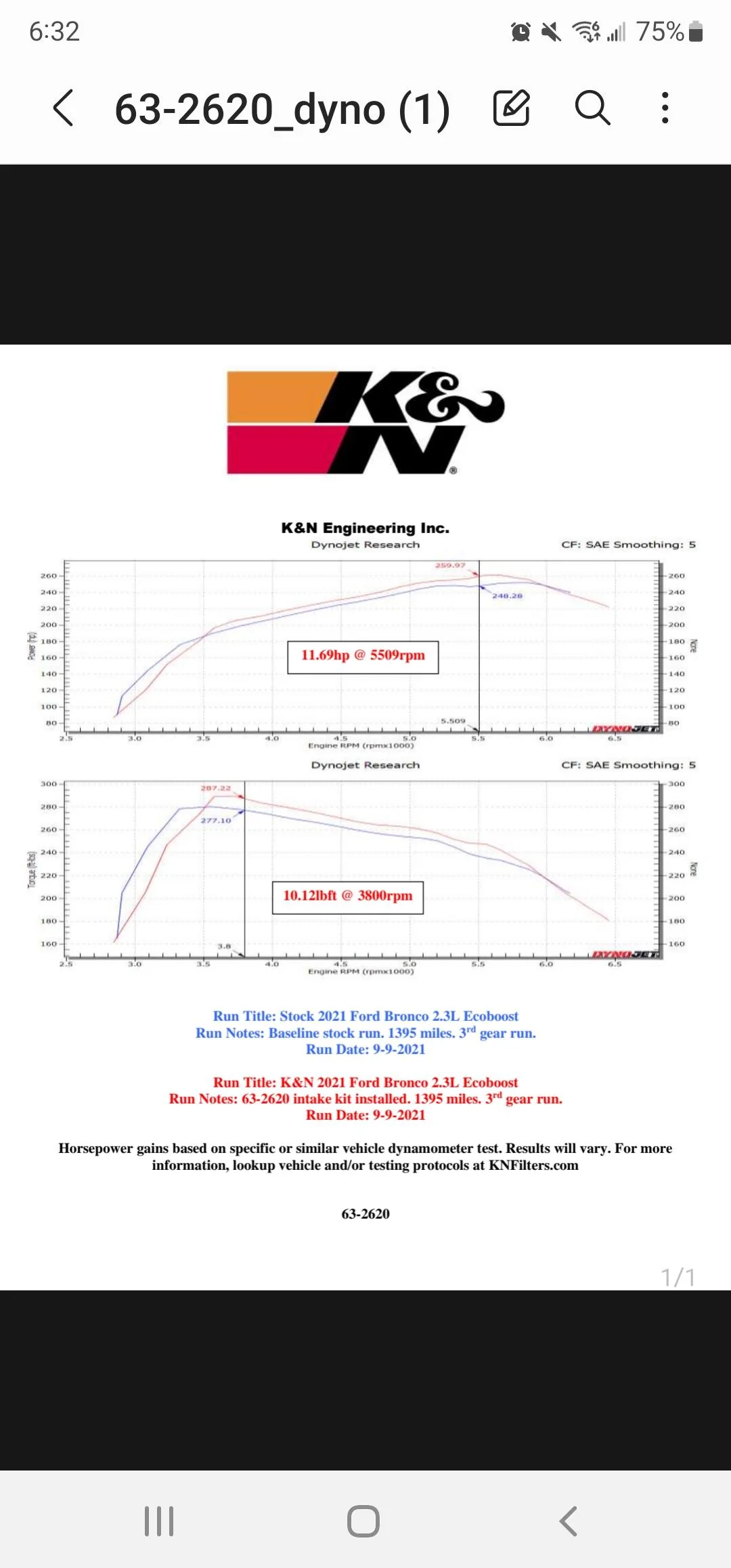

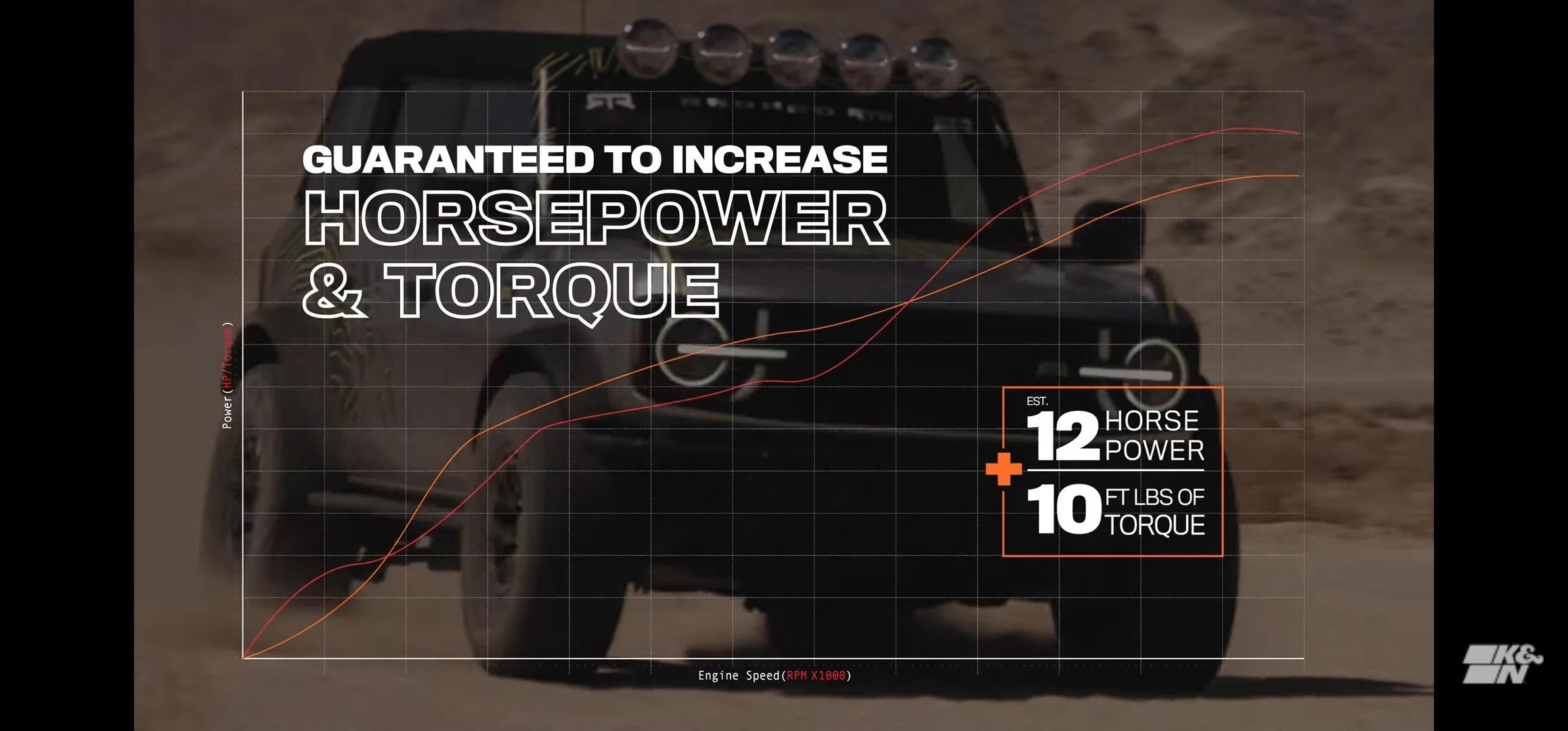

I highly doubt 12hp/10ft-lbs!
Maybe like 2/1, rule of thumb is usually $200 per 1hp.

I'm waiting to see what Panda get on their test Bronco with the intake. TBH I'm contemplating returning the intake due to the insane torque drop at lower RPMS.

I just thought I'd look at the Ranger 2.3 Dyno Chart and it shows gains across the RPM range.
Ranger 2.3 Dyno: http://kandn.com/dynocharts/63-2612_dyno.pdf
I can't imagine if there is a less restrictive airbox that it would equal less power at lower RPM's. I would think turbo spools quicker and get's more air--therefore more power.
It does well at wide-open throttle, where most people never drive their vehicles. However, it does lose power below 3500 RPMs, but not enough that it will be noticeable.
