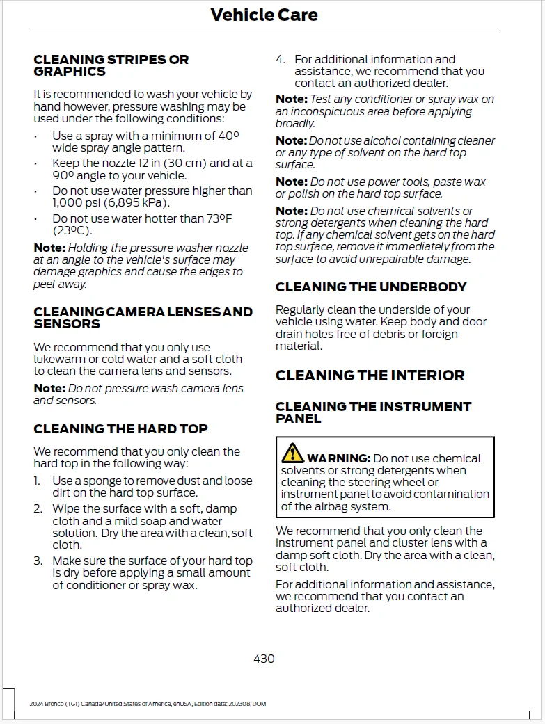

But here's a clip from the owner's manual I downloaded from Ford's website. It doesn't explicitly say no car washes for the top, but it DOES say they recommend ONLY cleaning it (and really they say the entire vehicle) by hand:

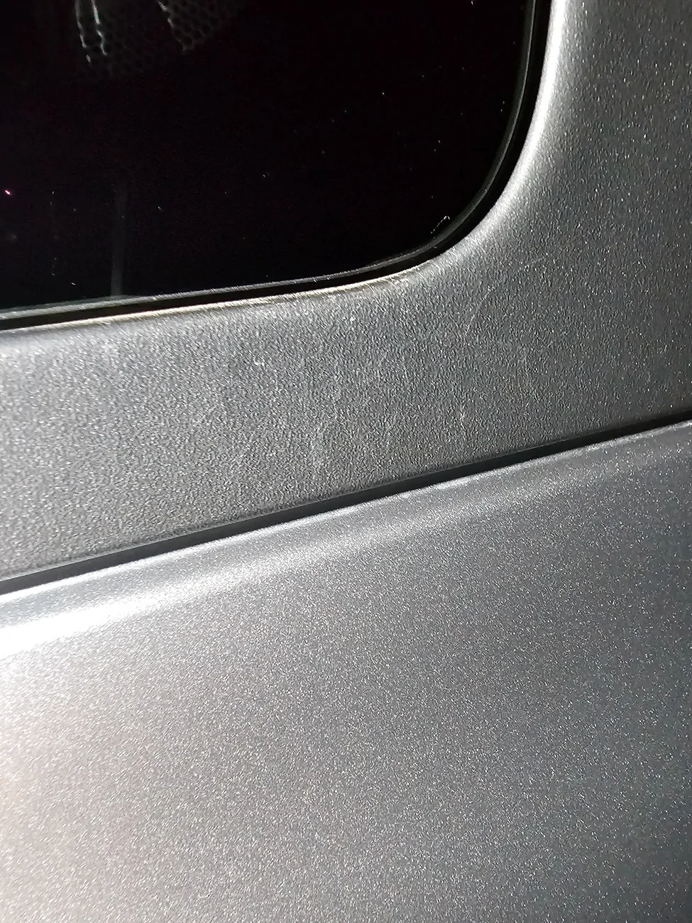

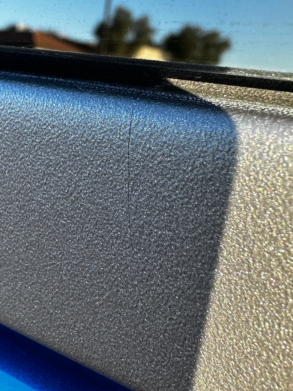

I'm 5'-8". When looking at my hardtop from ground level, it looks perfect everywhere.
If I get on a step ladder and look down from above, the passenger side window has 38 cracks. They are only visible when looking down from above.
Everyone who thinks they don't have cracks, make sure you look at it from ALL angles, before its too late.

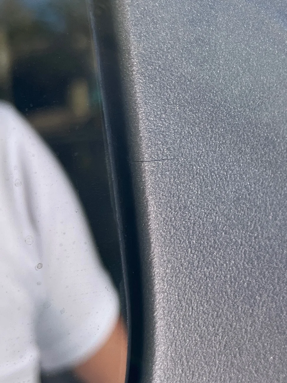

Exactly. Must inspect the tops from all angles in all variations of high intensity lighting, low intensity lighting, natural lighting, etc. All tops are already cracked or will be very soon for those who don’t think so.
Exactly, they can be hard to see, especially if you dont know what your looking for, a lot of people think they are scratches, which they are not - mine looks the same as yours
2024 Raptor, at 500 miles. They crack also. I dont think they make a mic top that dont Crack. L
So, what happens to these cracks over the long term? Do they keep getting bigger? Does it get to the point of separation? Does anyone have pictures of ultimately what happens? Is it just a cosmetic issue?
I’m on my 4th top. My first replacement crack was large enough for water droplets to come OUT of the crack, which means there was water intrusion.
Does anyone have pictures of a top/cracks in an advanced state of separation?
I don’t think they are separating more than what is shown in the picture I’m attaching here, but this was large/separated enough for water to intrude where I later saw it seeping out via a couple water droplets.

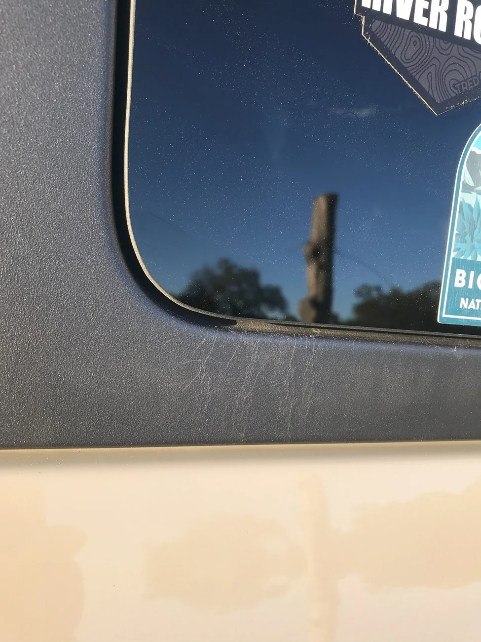

There are two types of MIC hard tops.
Ones with cracks and ones that will get cracks.
I never thought I had cracks until one day the sun hit the top just right, I thought they were spider webs at first. then I looked at the very top of the top.
Ford Bronco JUNK Hard Tops......and a question IMG_3187
Ford Bronco JUNK Hard Tops......and a question IMG_3185

Interesting.... hard to imagine a crack that small on a vertical surface pulling in water. I still really wonder what the long term effects are, beyond cosmetic.

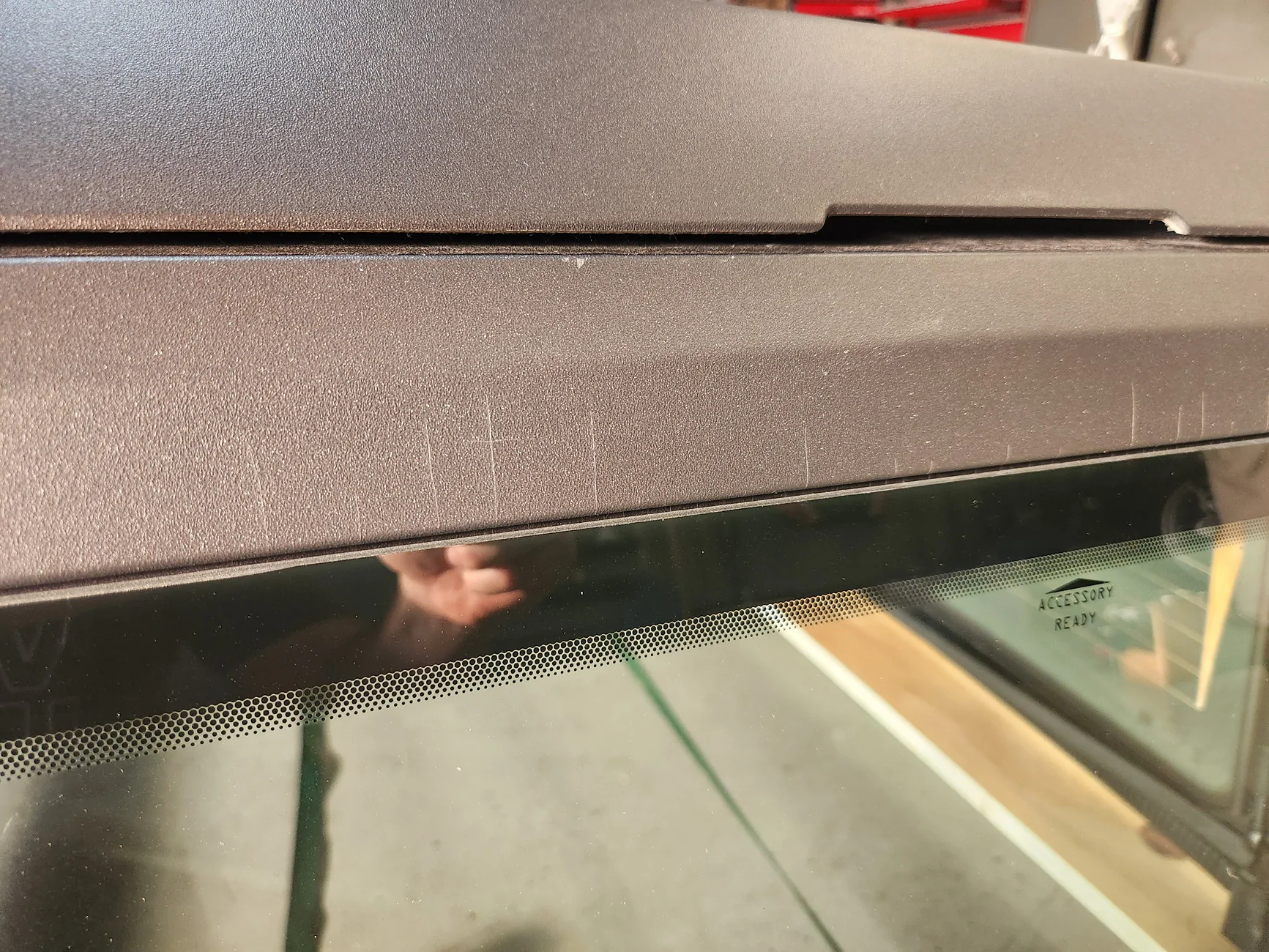

I'm 8 or so months in(10,000 miles) and used to just have those superficial internal micro cracks that didn't break the surface by the corners of the windows (which I was borderline starting to come to terms with) but now I'm got actual cracks breaking the surface towards the rear of the window on the exact spot both sides.
Ford Bronco JUNK Hard Tops......and a question IMG_2398
