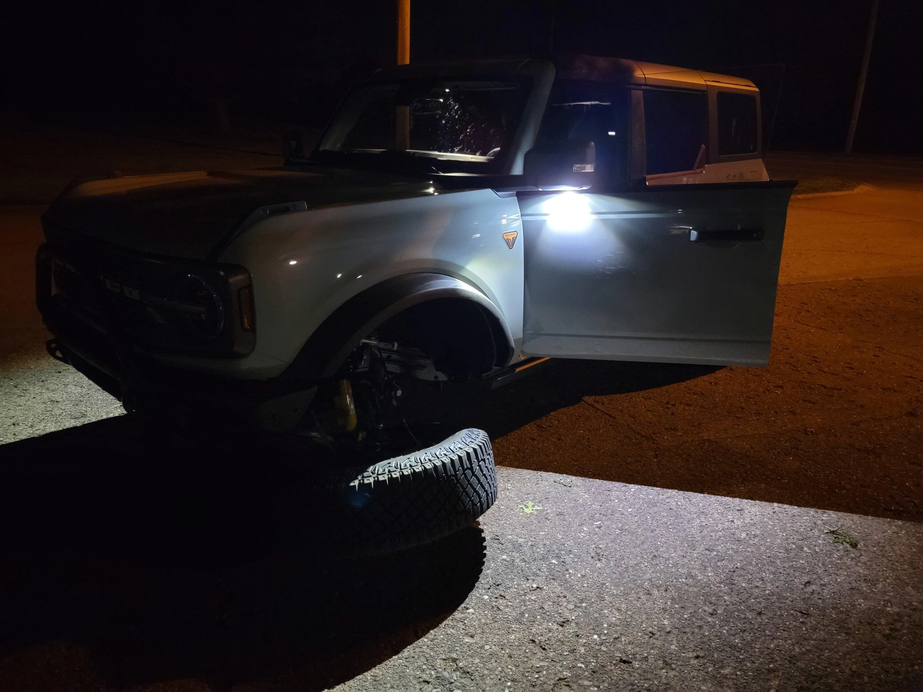

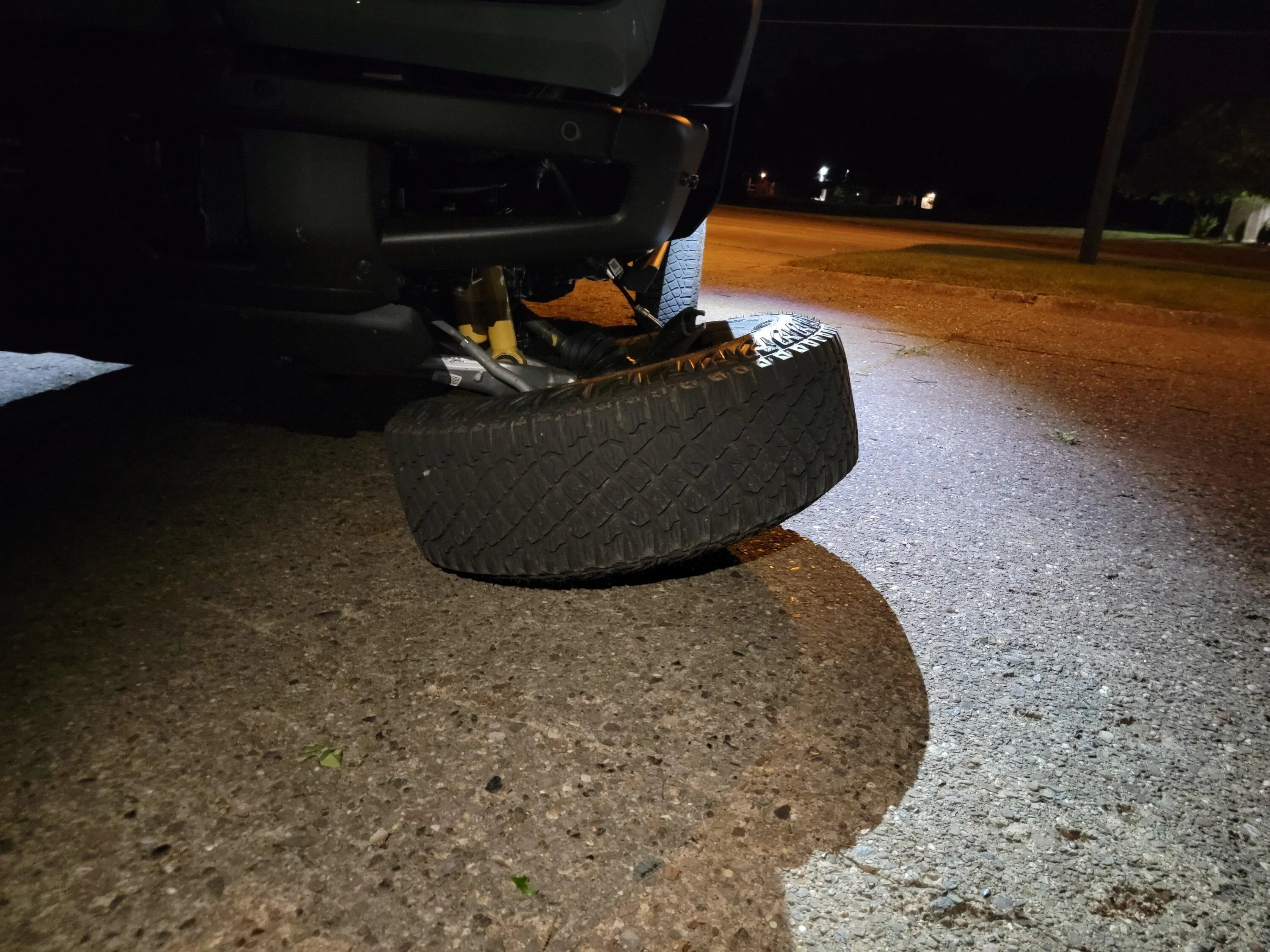

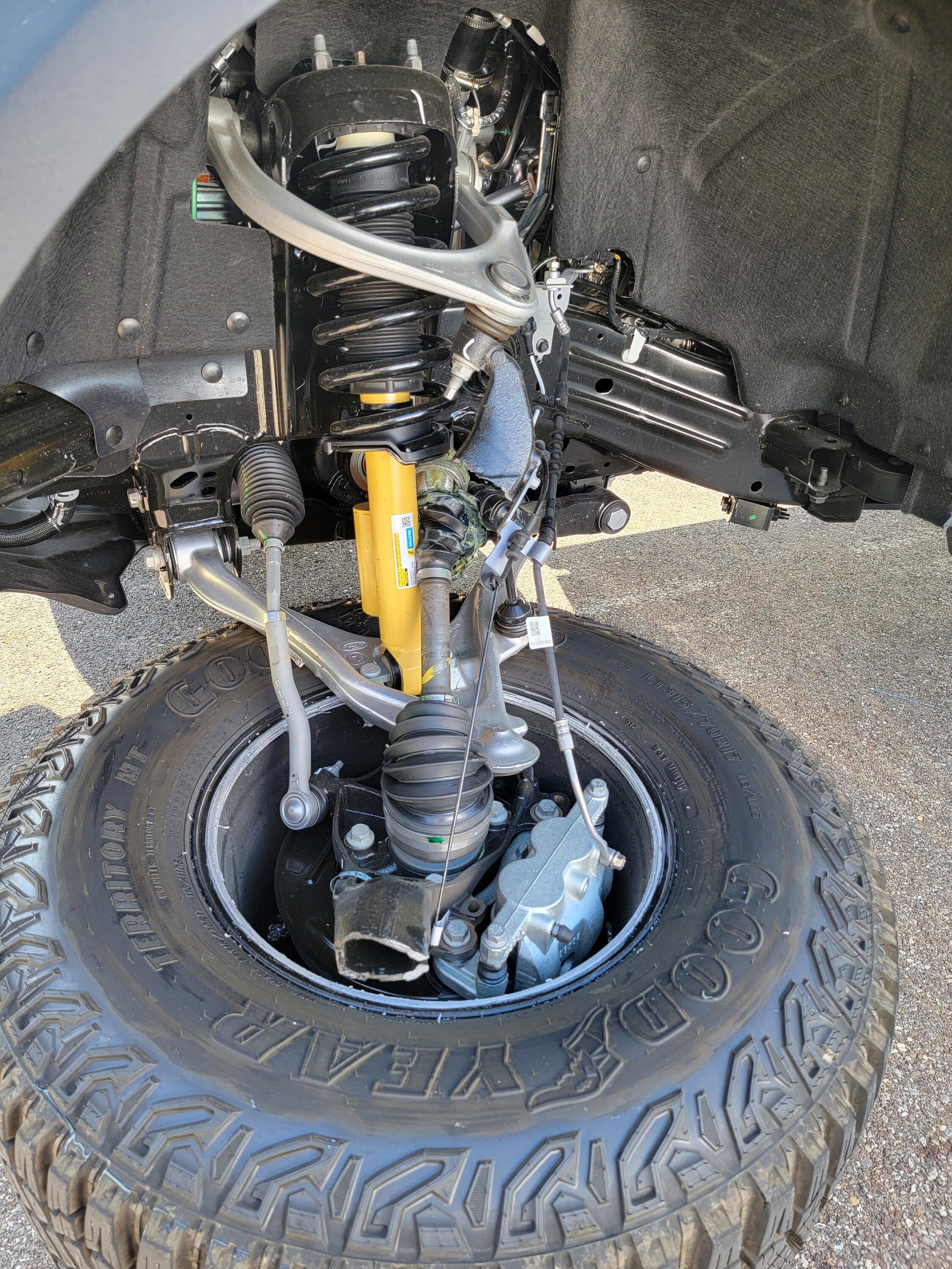

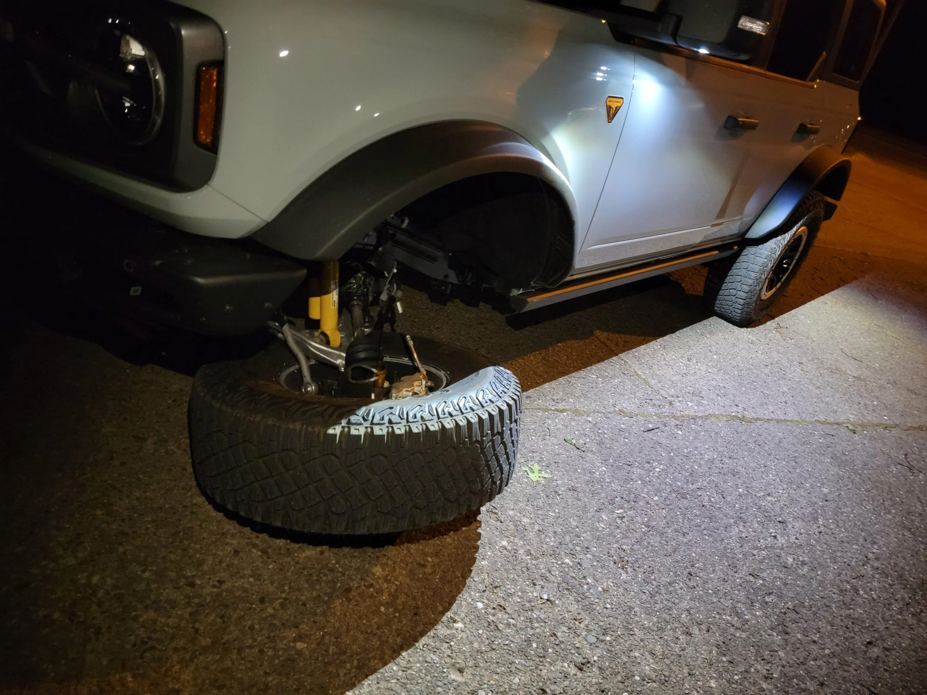

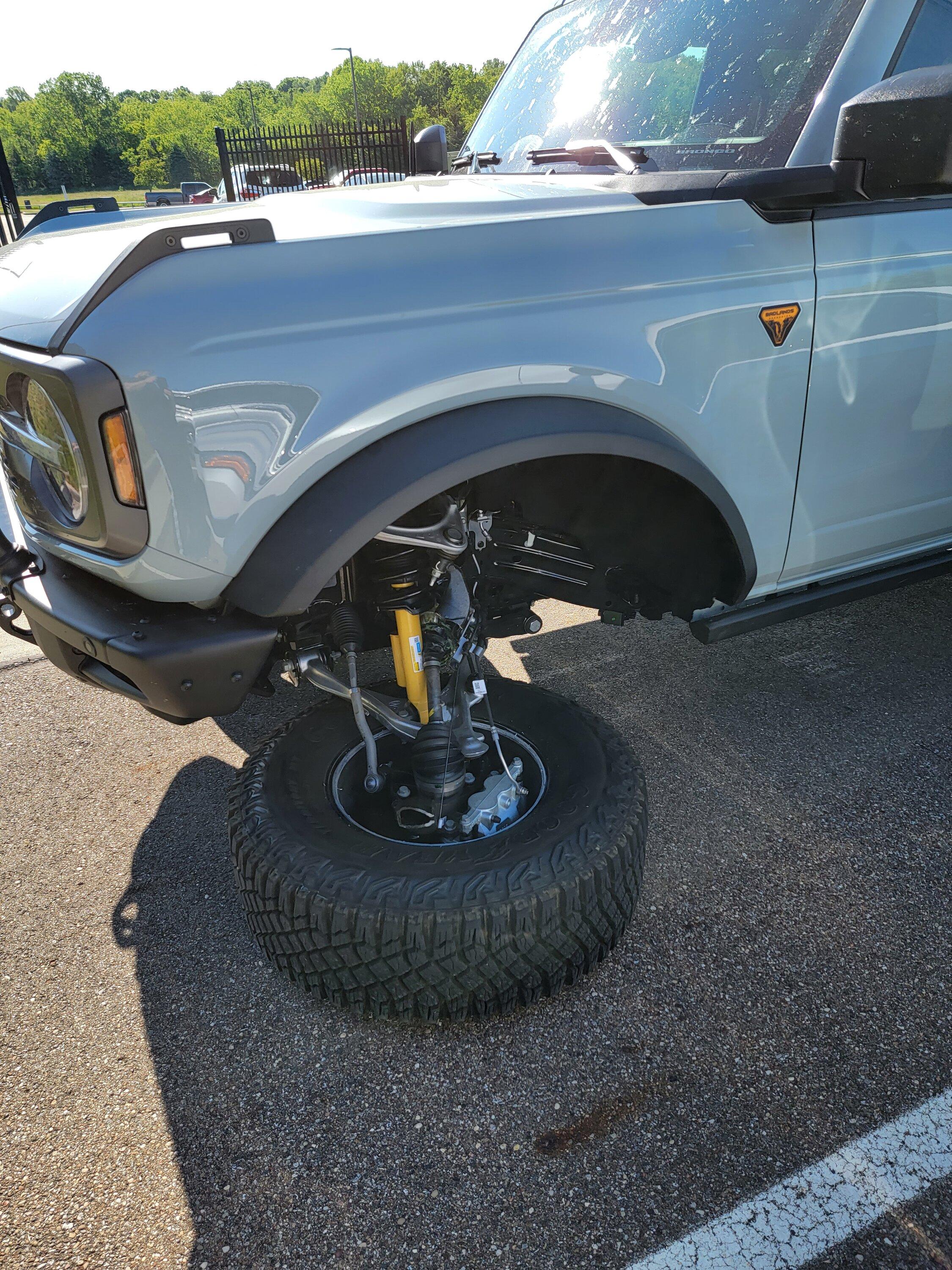

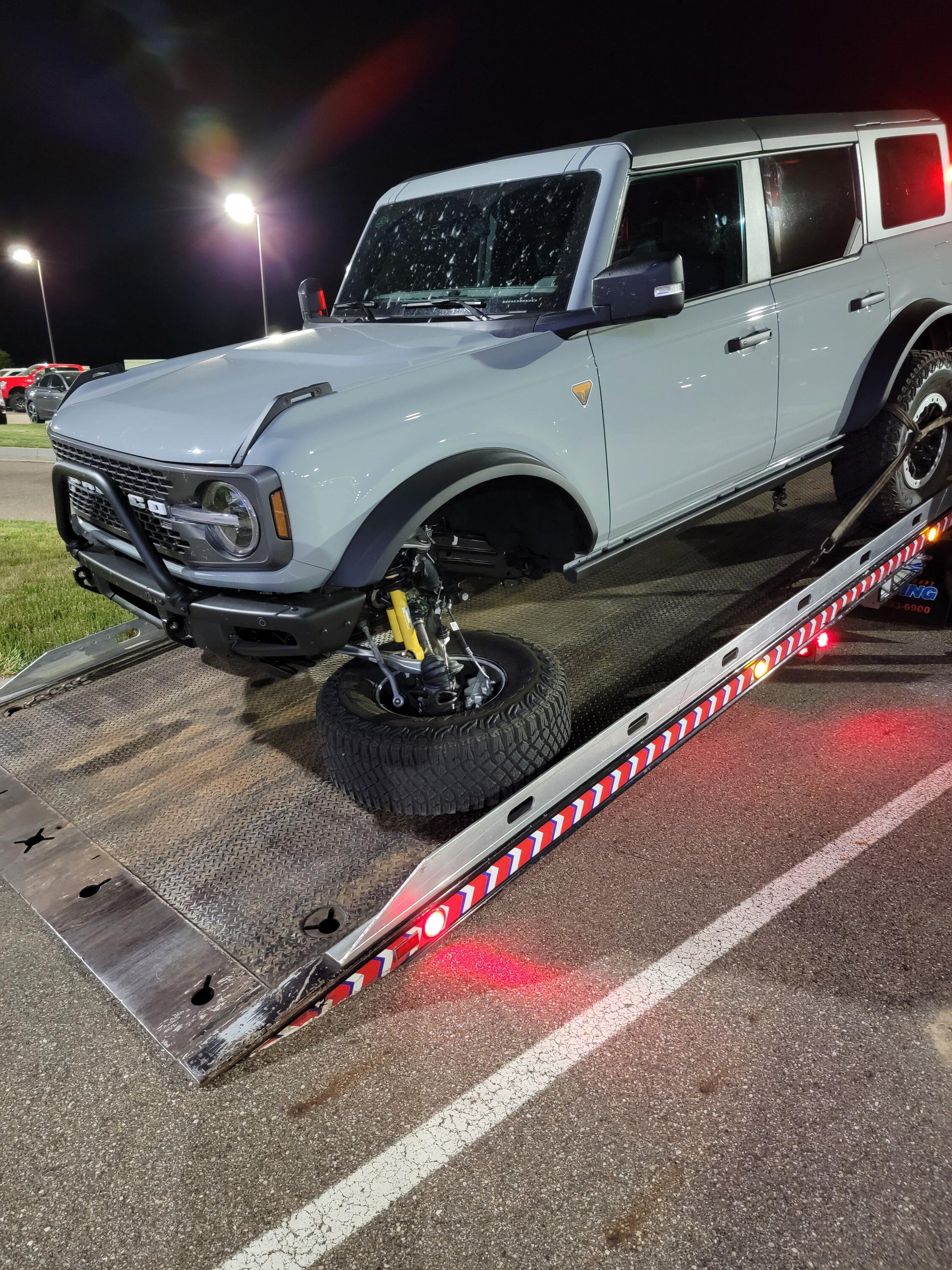

I also think it's worth noting difference between these portals and 74's is that 74's are a full knuckle system. The Tibus are bolt on, right to the OEM knuckle.
On the one hand I like the idea of how easy these would be to install, or remove for service. But no doubt the 74's have a strength advantage since they aren't limited to the OEM wheel hub mounting interface. Wheel hubs are very strong but these bolt ons act as a lever and are more than likely being wheeled with bigger tires in addition to that. Would it matter for my level of wheeling? probably not. But its a big difference, nonetheless.
Also, that no doubt increases the wheel offset a bit further from what 74's would be.
Kinda wondered how big that void was in the knuckle, wow. Glad no one was hurt and kind of surprised we haven't seen others with similar breaks from hard off-roading.
