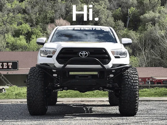

Very true there. He is BIG in the KOH races, think he won a couple of them. I'm a big SFA guy as well but ……. you can make an IFS work, but as stated here and many other places, IT IS $$$$$$ !!!!!. Look how much wider than a production Ranger, hell it even looks wider than the Ranger Raptor, than that Ranger is. Just like his KOH 4400 it is IFS with looooong arms on it, it's as wide as a full size truck. Great for IFS articulation / wheel travel but not so great for tight "woodsy" trails.
Ford Bronco The IFS vs SFA Thread 1588285571890
Typical long travel IFS kit is about 4K the kit above is stated as being more because it uses new custom made knuckles as well so maybe 5-6K ?? 2200 per cv axle shaft. 1600 per coil over. It's badass but $$$$$
That being said, in the past IFS has not been very "beefy", now technology has come a long way and R&D, by many people ,have overcome the short falls of early production IFS. So what I am hoping is that if Ford has done what they have done in the past …. build it FORD TOUGH. If it is just Explorer stuff in a different wrapper might not fair so well. ;) I'm thinking somewhere in-between Explorer and all out KOH stuff.

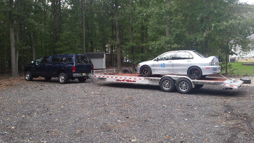

Bought it new, only have 11K miles. Was real on the fence about making it a road course car
being these things as mint and low mil as mine is, still go for pretty big money. I'm a huge Ford guy, except for my Cummins diesel and this EVO. Fell in love with AWD cars (and Mitsu turbos) when I got a used Talon back in the day.
Trying to not do anything that is irreversible (IE, I bought used bumpers to hack up for splitter/
diffuser, brake ducts, etc...). As I said, has big bars and soft springs now for street ride quality.
Dreading taking that big front bar back out now that I want a track setup, have to remove virtually entire front drivetrain/sub frame.

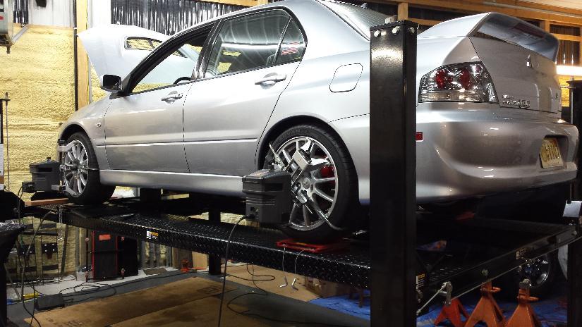

This was first time I took it, about 2 years ago.
Ford Bronco The IFS vs SFA Thread 20181019_160303
Aligning............

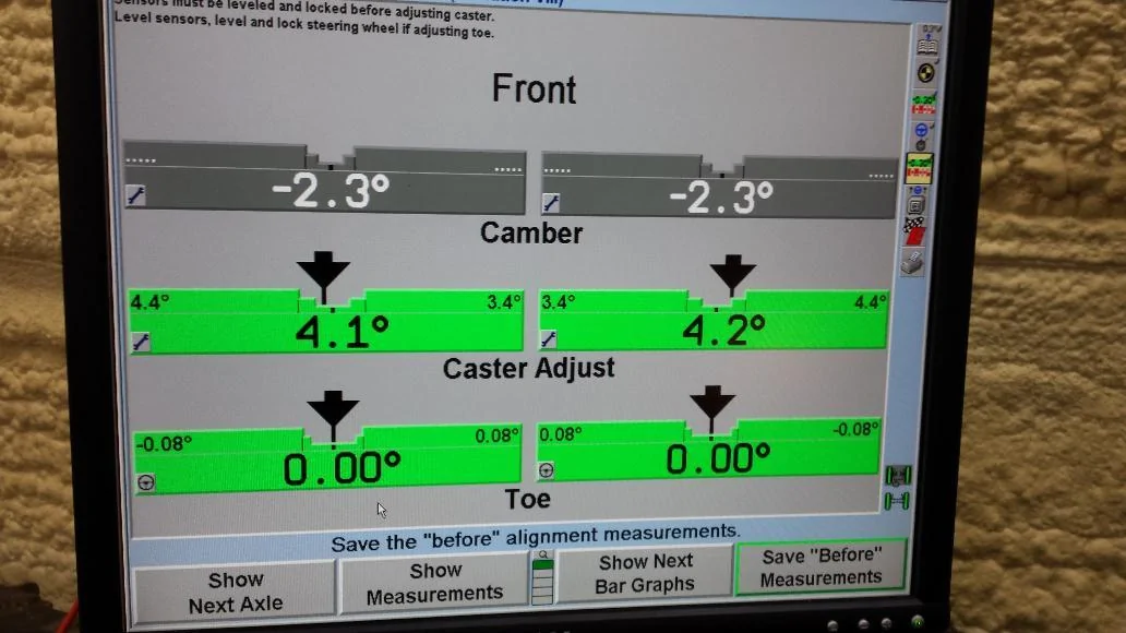

Ford Bronco The IFS vs SFA Thread 20170222_185024a
Most camber I could get with factory adj bolts and bilsteins
