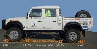

Ford Bronco Join Us For a Live Discussion: IFS vs. Solid Axle Swap 1553607697489
"Robert Kranz aka "Oilworker" oe "Oily"
Ford Bronco Join Us For a Live Discussion: IFS vs. Solid Axle Swap mRizdzi20qIlRmOY (1)
Ford Bronco Join Us For a Live Discussion: IFS vs. Solid Axle Swap 0BBxL93qvyfo0cNa (2)
was the first to mount the prototypes of our portals on his Defender 130. He took part in various competitions such as the Breslau Rally, Africa Eco race, Dakar Rallye, Polar circle and many more
and had no damage to the portals. When he drove into a stone wall at 50 km/h in Africa, the front axle was bent and the axle guides on the frame were torn off,
but the portals were undamaged. He drove 2,500 km back to us with the bent axle, where we then replaced the axle and repaired the frame.
Robert has covered 250,000 km with the car with portals without changing the portals. He had posted his experiences in the expedition portal.
As already mentioned, these were the first prototypes of portals. The later changes affect the housing material, the material of the gears, changed bearings, stronger wheel bearings, other shafts and CV's.
The only problems on the prototypes were oil leaks. With the new design, these problems have been fixed.
We also changed the wheel bearings from the Chevrolet k2500 unit bearings to significantly larger Mercedes Atego truck wheel bearings.
Except for the basic construction, everything in the current generation has actually been changed and improved.
We carefully monitor where problems may arise and then promptly make the necessary changes.
We can now look back on more than 15 years of experience with more than 500 vehicles equipped with portal axles and more than 7 million kilometers driven.
