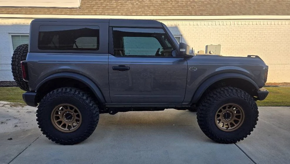

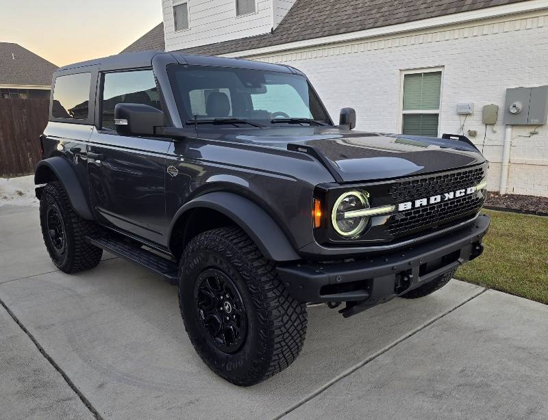

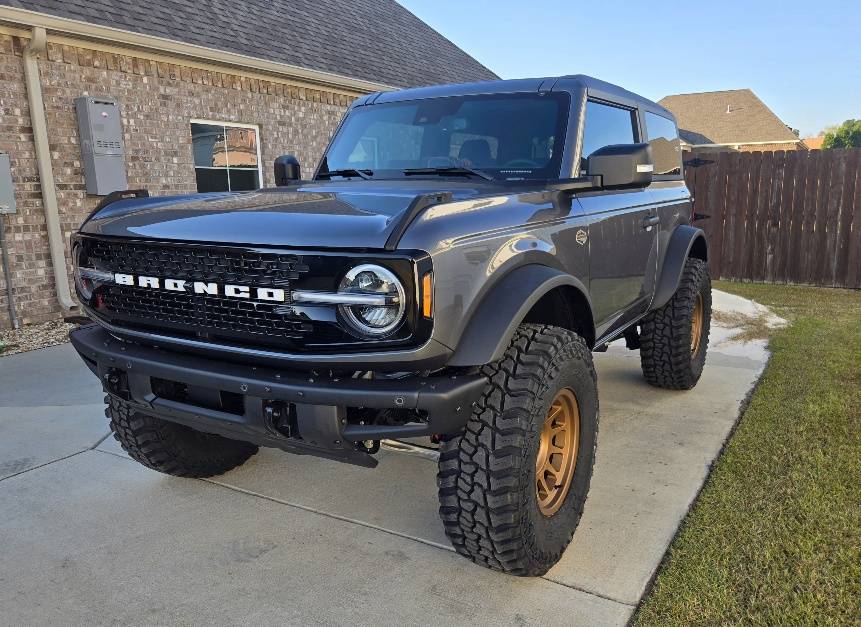

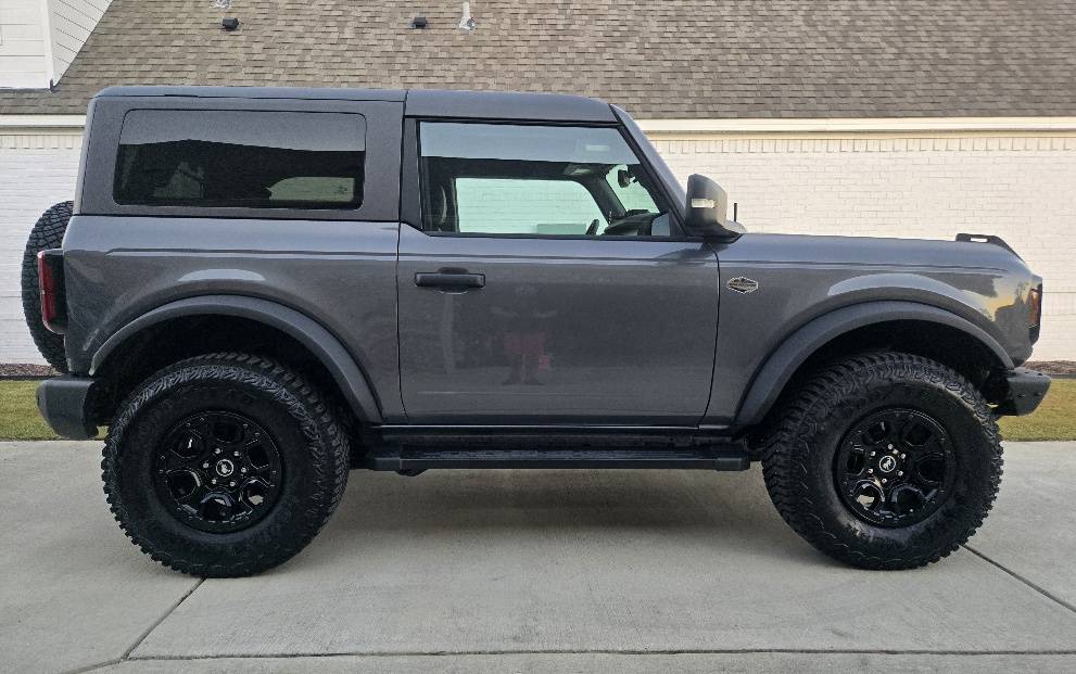

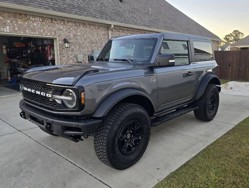

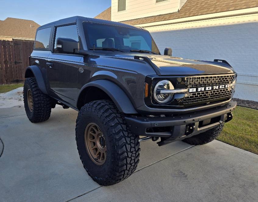

Just had mine done yesterday. Before and after.
Ford Bronco JKS Max Tire Kit? FLOG 24WT
Ford Bronco JKS Max Tire Kit? FLS1 24WT
Ford Bronco JKS Max Tire Kit? FOOG 24WT
Ford Bronco JKS Max Tire Kit? FRS1 24WT
Ford Bronco JKS Max Tire Kit? RSOG 24WT
Ford Bronco JKS Max Tire Kit? RSS11 24WT

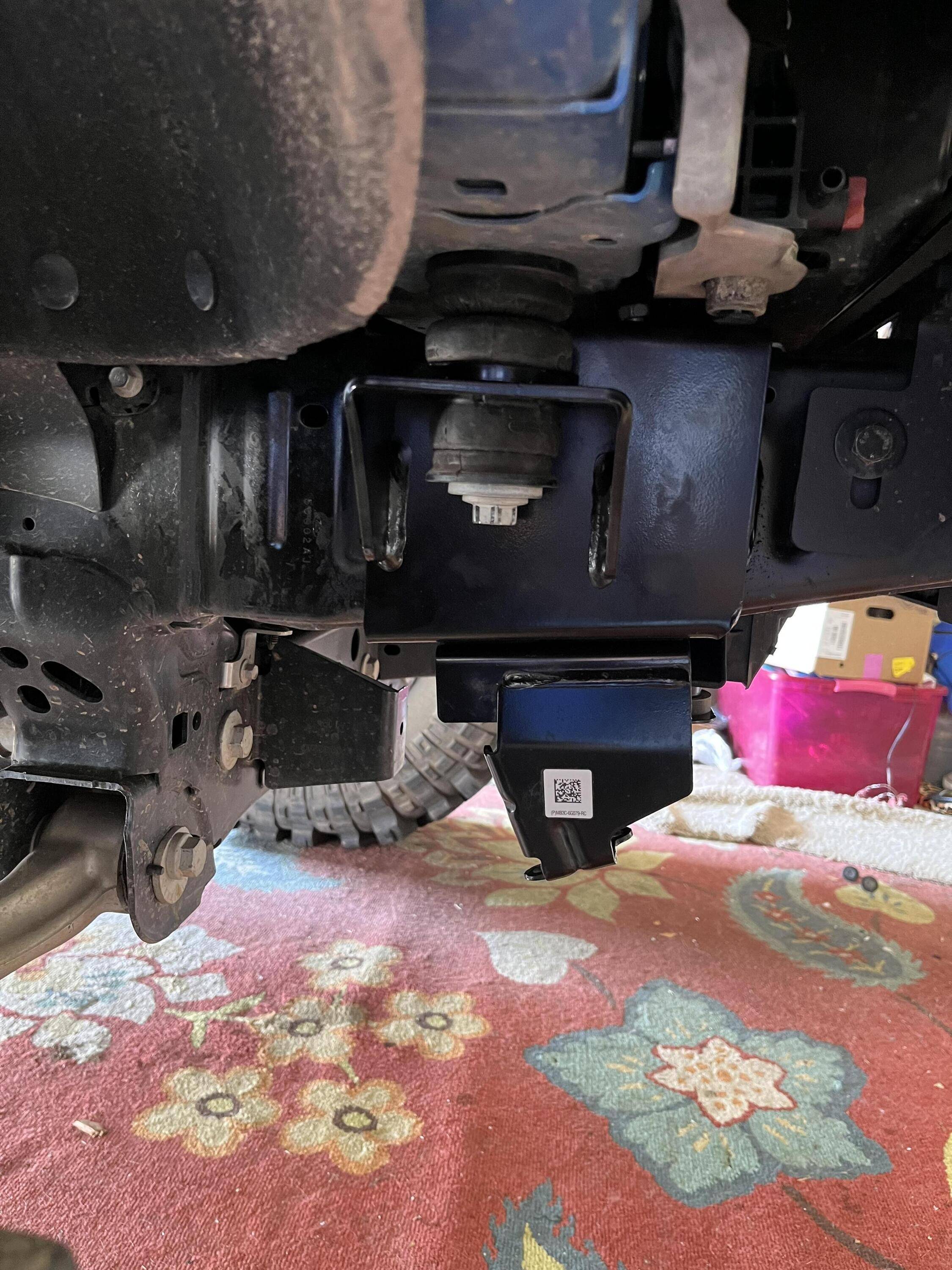

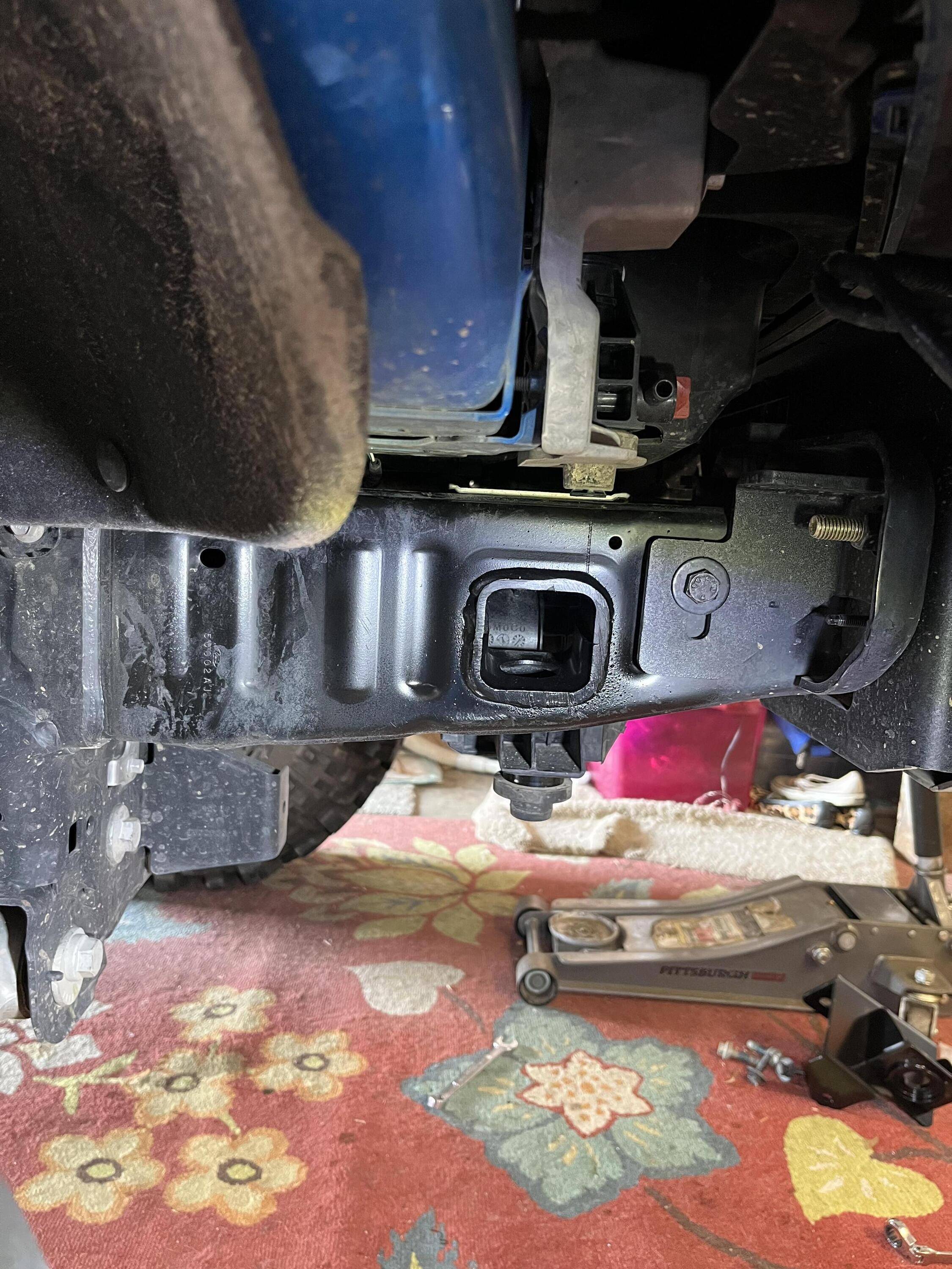

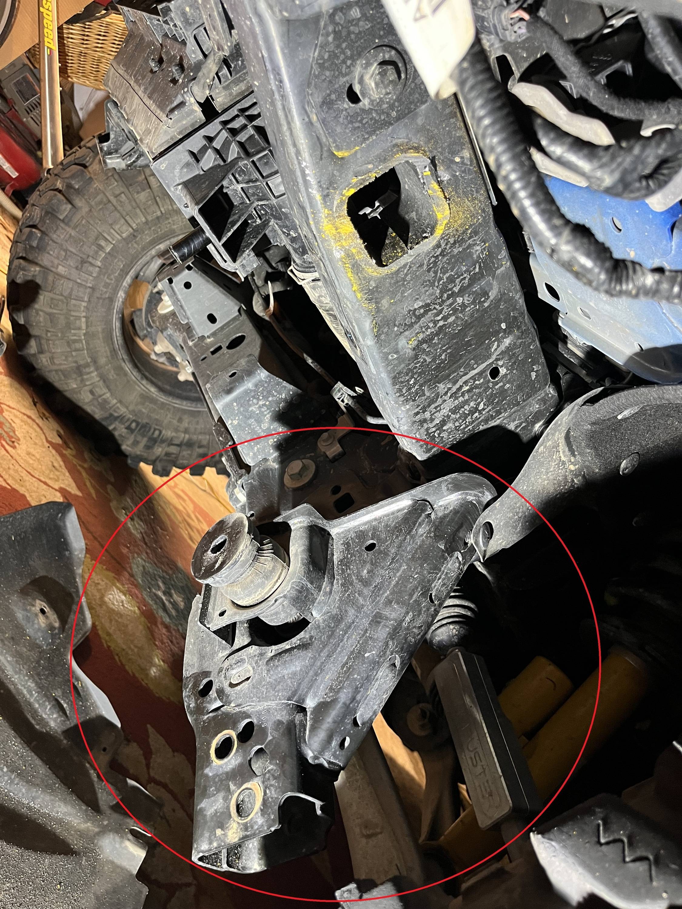

I did it with my bumper and winch still on the vehicle. Pictures show the bumper brackets bolted just forward of what you need to cut. I would recommend using 8" Sawzall blades. I was able to complete mine with 6" blades, but the extra 2" would have been better. (That's what she said.)

That’s good to know, I have the same bumper. I bought good blades the other day but opted not to get the long ones, hope they work, they are not cheap.
I bought the weld-on body mounts from @stinkyfab
