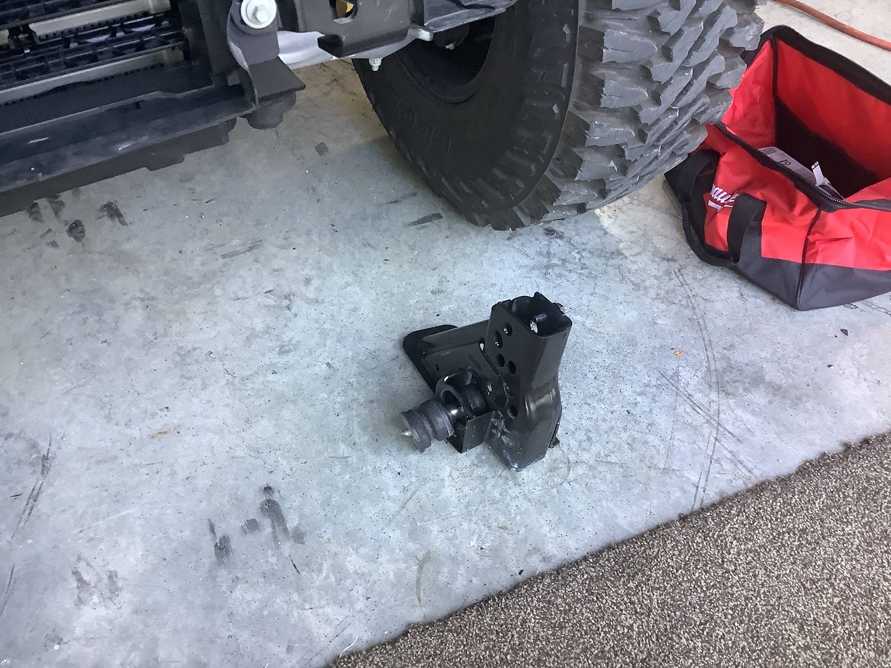

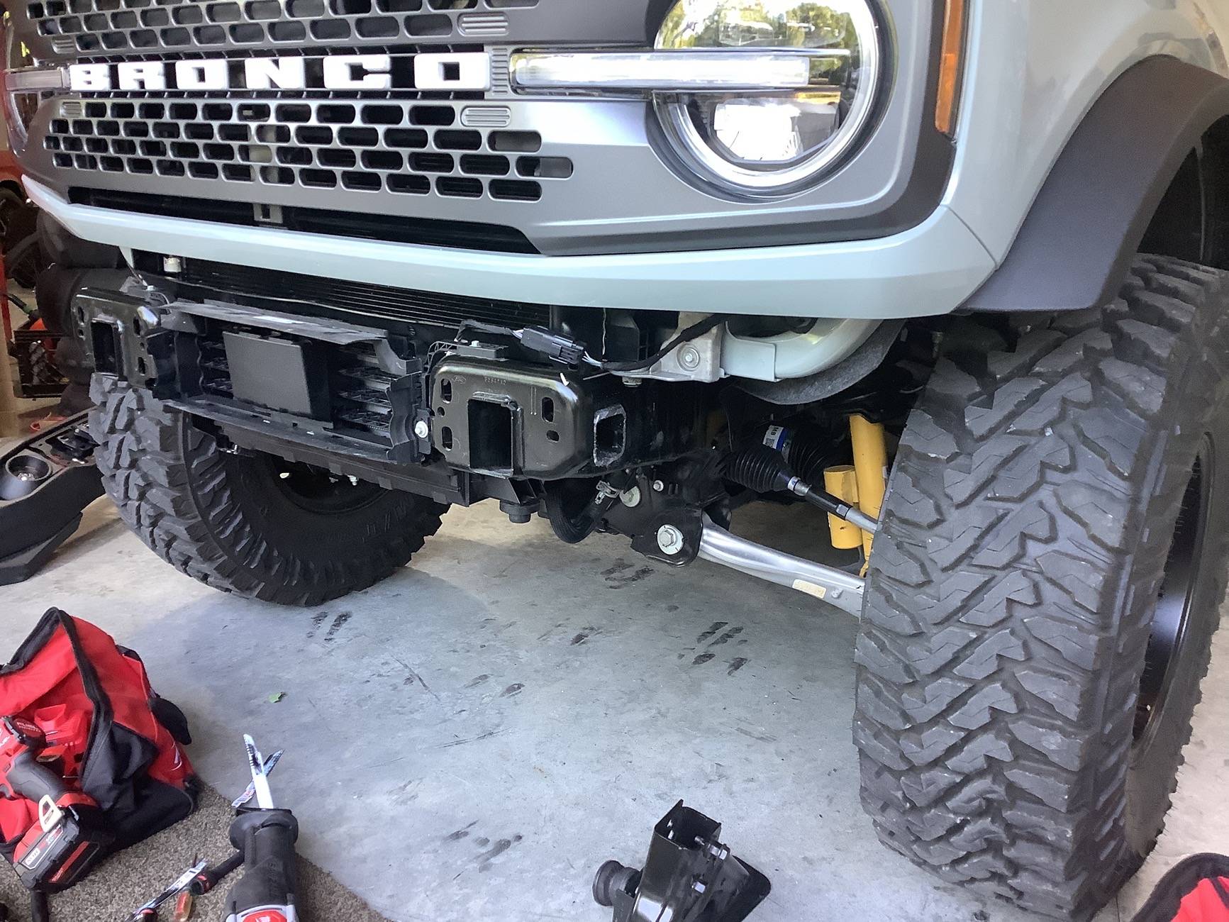

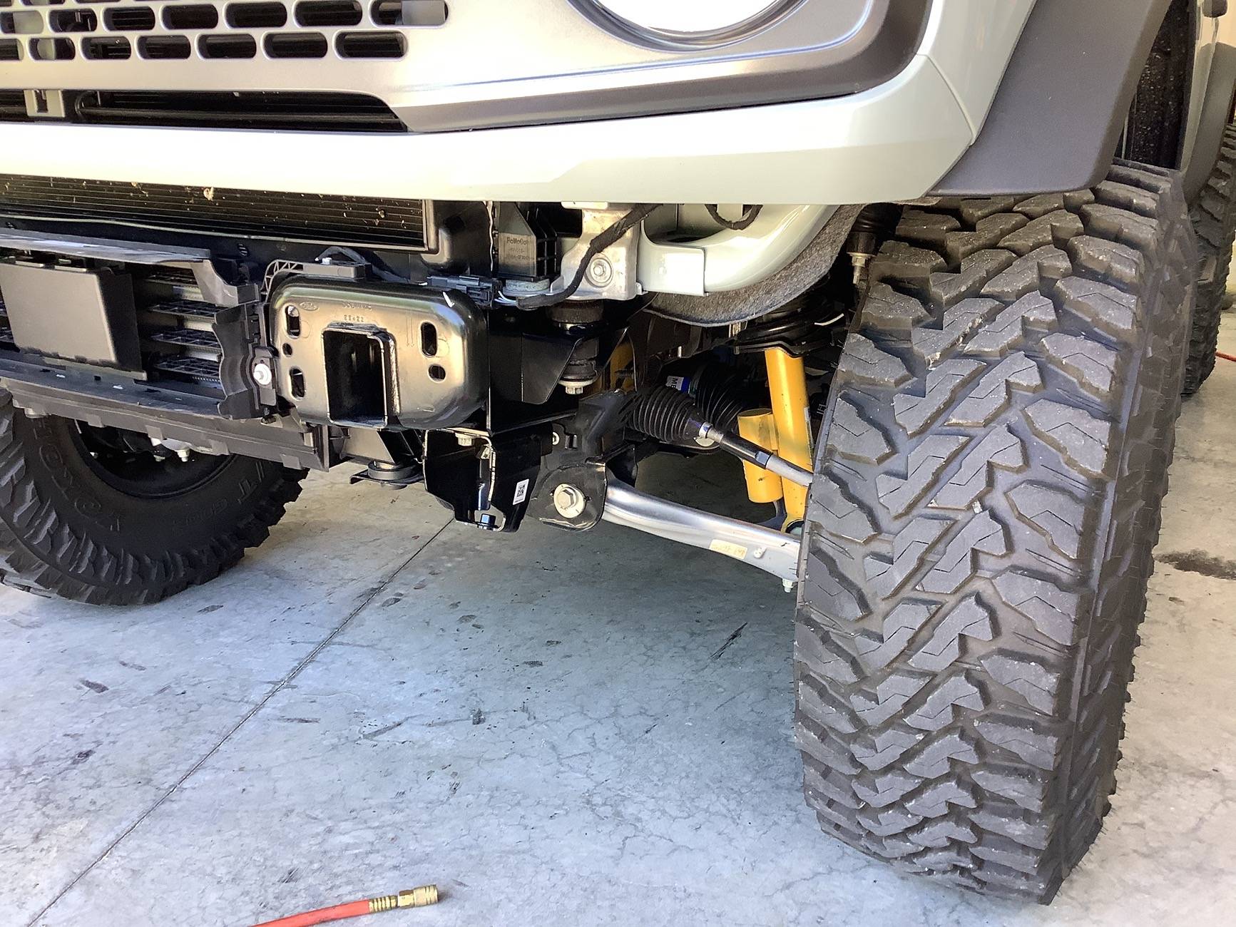

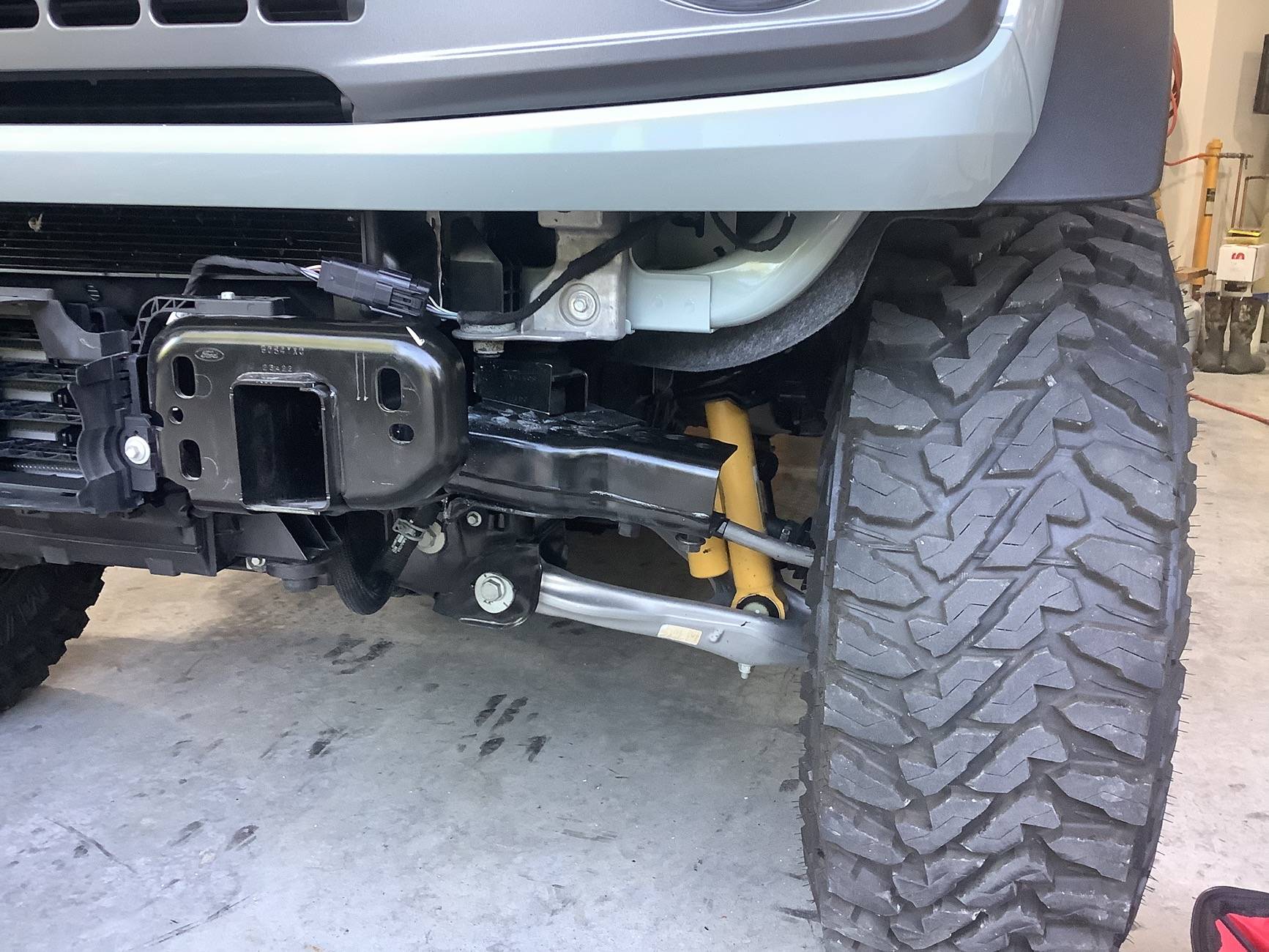

I did the Max JKS kit a few months ago. Not bad at all.
