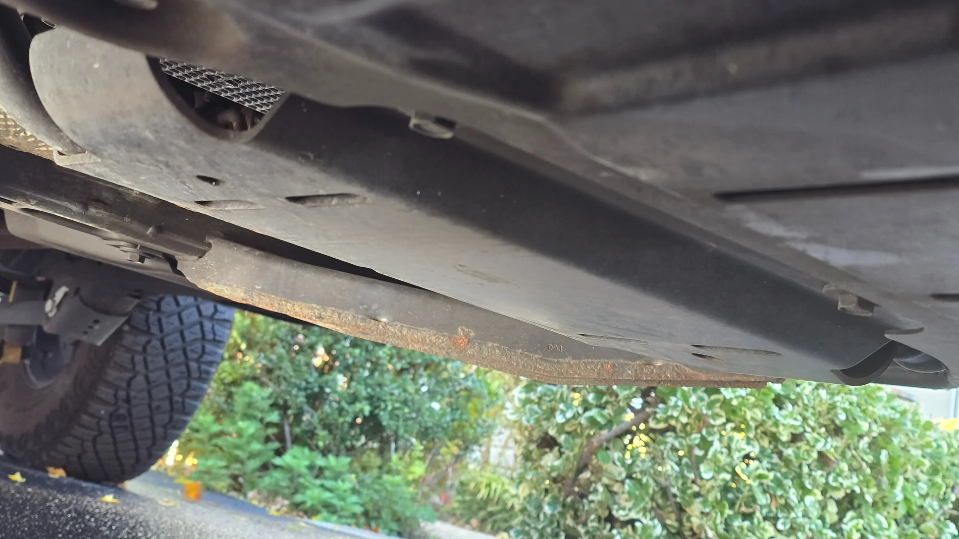

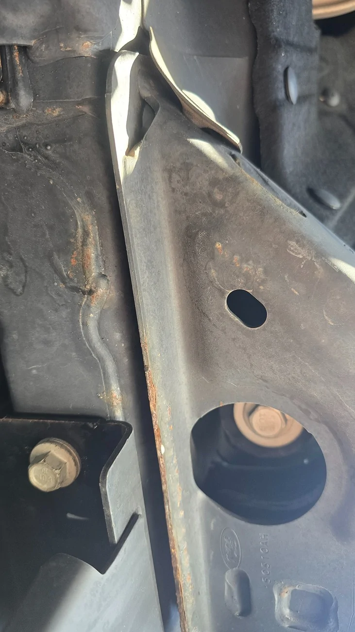

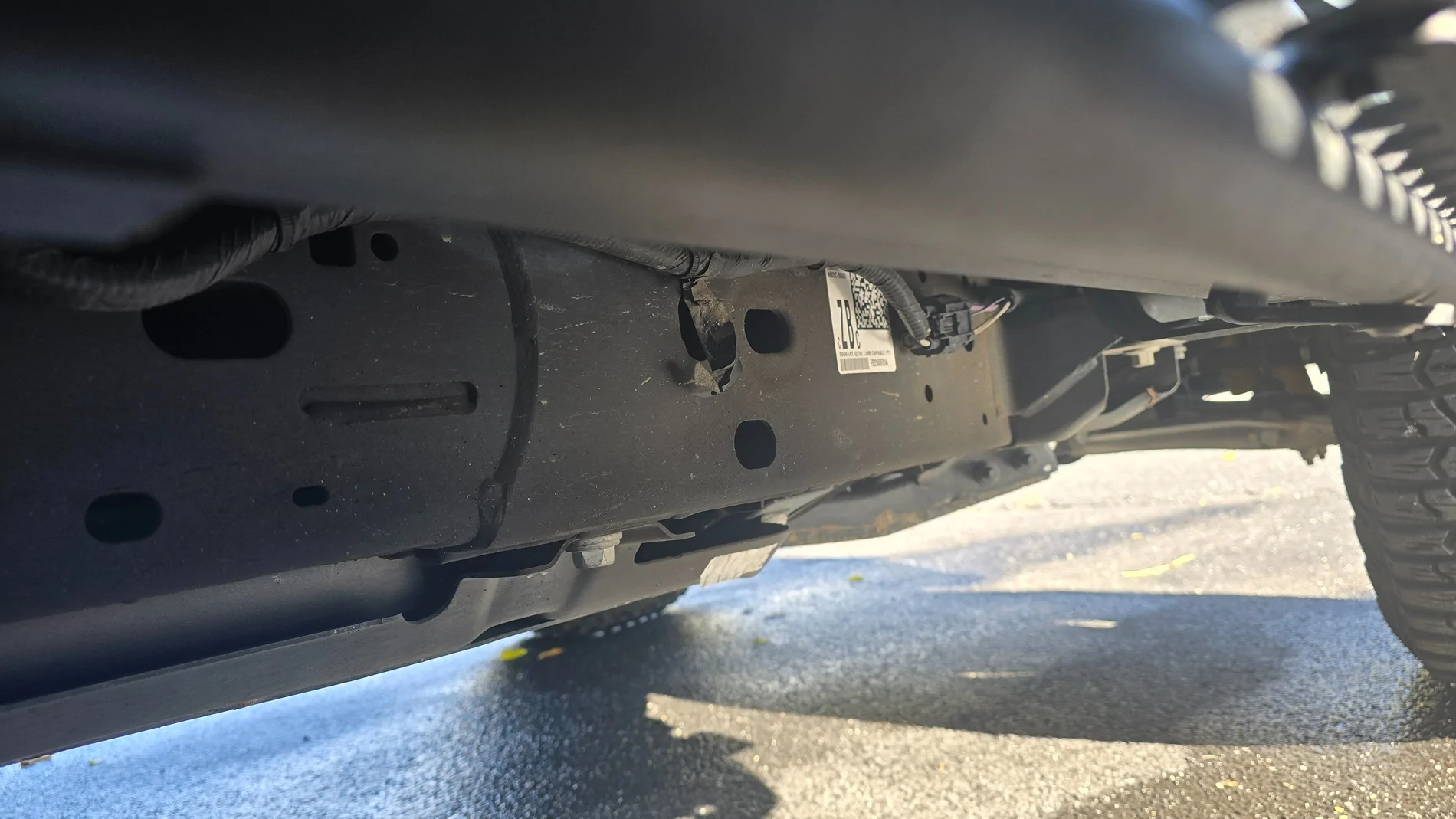

Was under my 2022 Bronco Badlands trying to find the fastener for the air filter box that I dropped into the engine bay (RIP) and I noticed some rust starting to form on some of the undercarriage components. Is this normal/expected rust or is this something that needs to be mitigated?

Pretty normal. It’s just surface rust

Normal. If it really bothers you, grab a can of Rustoleum Rust Reformer and blast those spots. Repeat as necessary.

Wow, looks pretty good for a '22 driven in NY! Do you drive much in the winter? Maybe they don't use much road salt where you are?

You can tap those areas gently with a hammer and/or scrape with a flathead to knock off any loose rust chunks or paint (where the rust is underneath) to expose as much rusted metal surface as possible before hitting it with either a rust converter or rusty metal primer, followed by paint. I use Rustoleum. If you’re a bit more committed, put a dust mask on and hit it with a brass brush or sandpaper after the hammer step and before painting and priming.
I have way more experience with this than I would like due to work trucks. Not on the Bronco (yet).

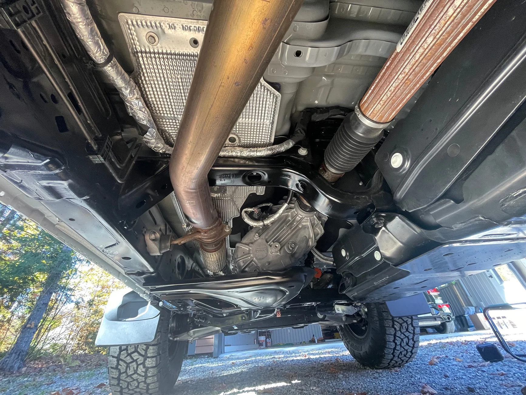

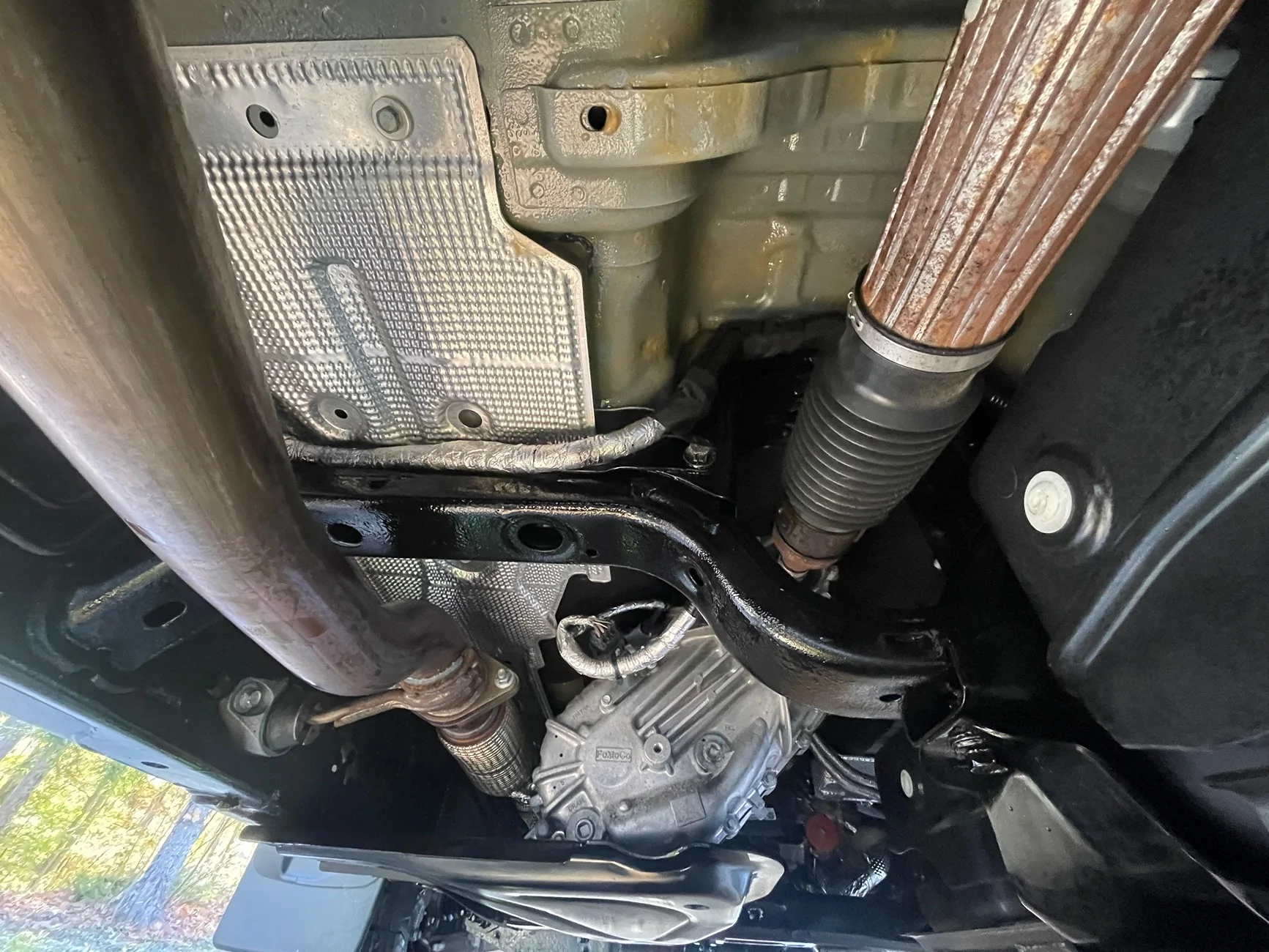

That is very light. Sand and scrape off loose rust. Degrease and prep surface with POR-15 prep and then apply POR-15 rust convertor.
Then top coat with a good frame paint (not the rubberised crap that will create pockets of humidity as it peels and cracks with time).
Then apply a waxoil/Fluid film/CRC product on frame and body or pay someone to do it.
I would absolutely avoid using used engine oil. It is full of metals that will eventually promote oxidation and the build up of rust. It is easy to find scientific assessments of the different methods and used engine oil is never the appropriate choice.
If you’re going to do it, look up videos on YouTube and content on here.
I live in the Canadian rust belt and have spent dozens of hours repairing rusted frames.

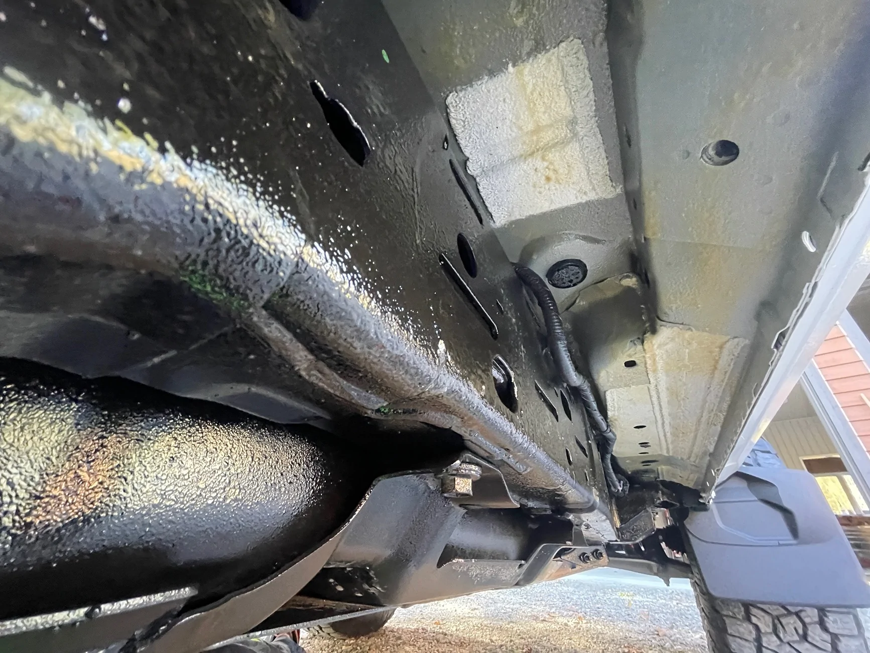

Salt Shift “rust shield”
If you don’t want a sticky undercoating look this is the best stuff and easy to use.
