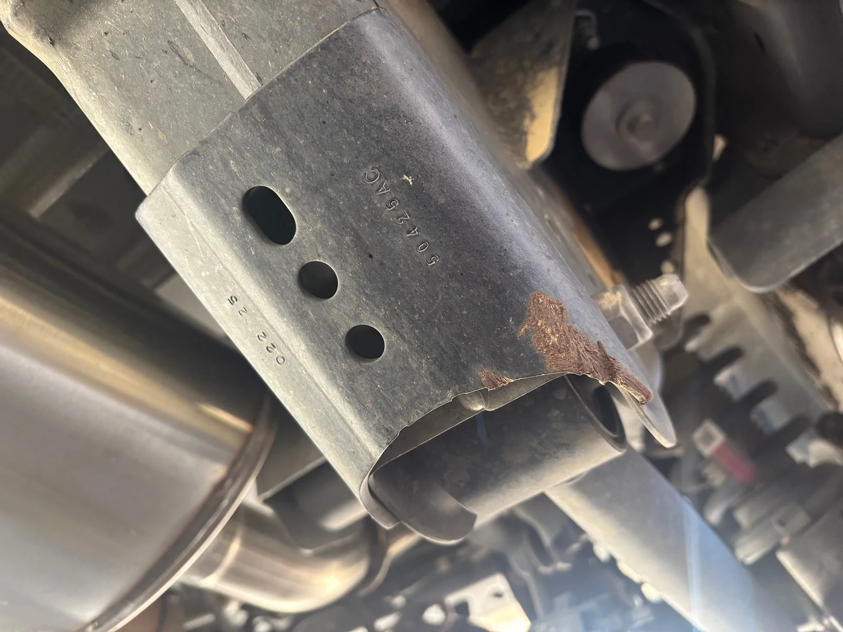

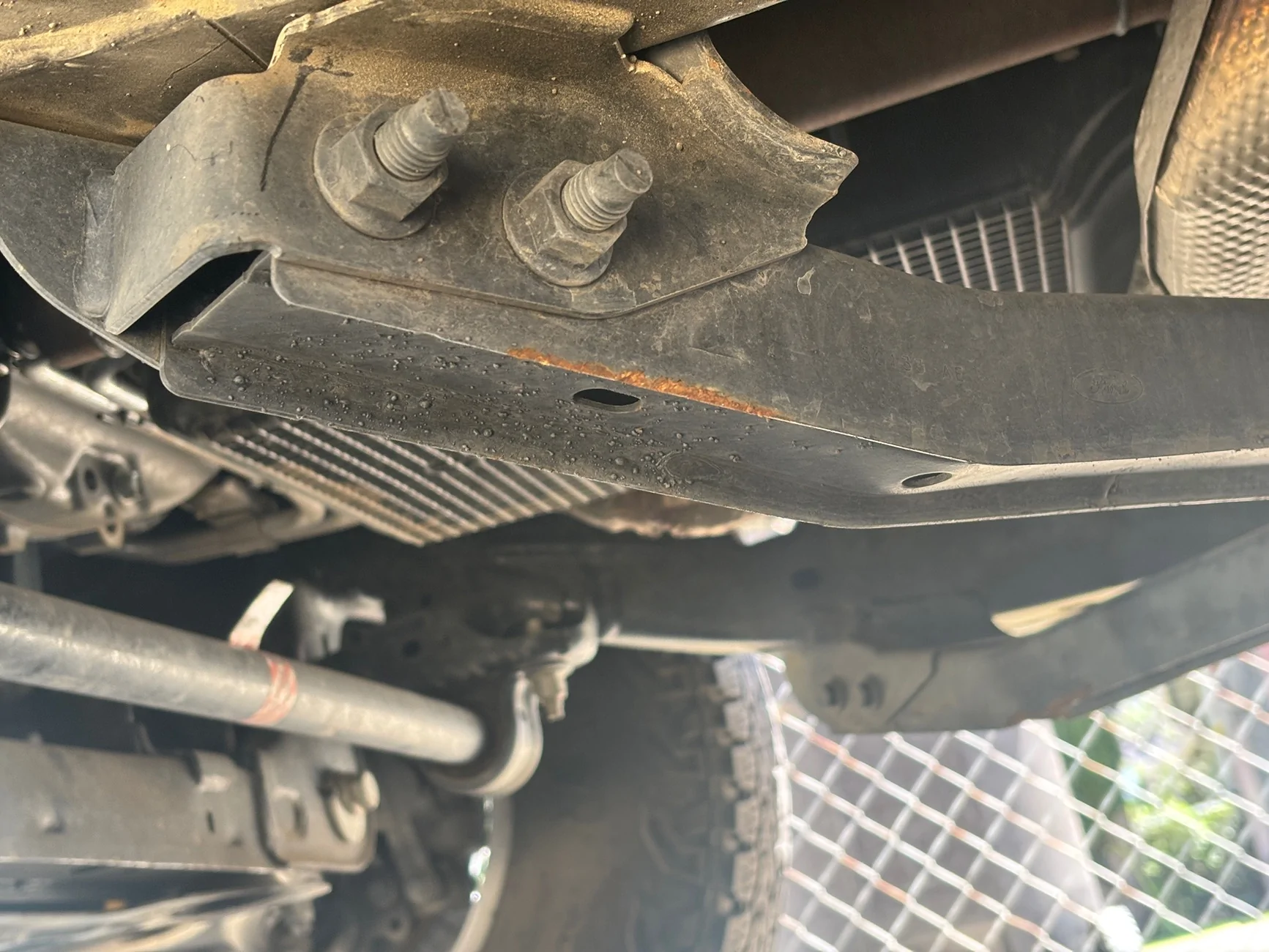

Hello all, found a couple spots with very minor rust spots (trailing arm brackets looks like snagged on something when wheeling and looks more concerning.)
Spent my time between California Bay Area and Central Valley, salt isn’t an issue really.
Any preventive action I should take?
Thought about taking a steel wire brush to it then put on some rustolems but not sure what the correct thing to do is.
Thanks!

It's no longer just surface corrosion, but actual rust (e.g. flaking). You should first put on some PPE, then your wire brush and maybe some sandpaper, then a rust converter, then underbody paint.
But, it's also really not that much so YMMV.

this is very much not concerning but I get you want to fix it. I have a few spots from wheeling that happen every year and I have some to fix this off season.
That looks well adhered, but flaking paint needs to be knocked down. Wirewheel, sandpaper, grinder, brush, anything will work., light effort. POR-15 works well, or corroseal then a top coat.

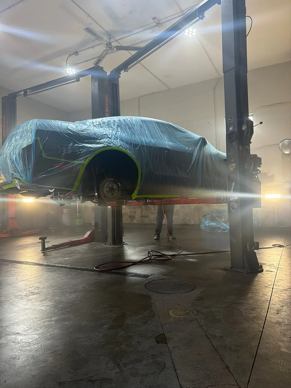

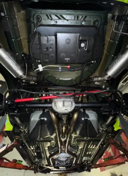

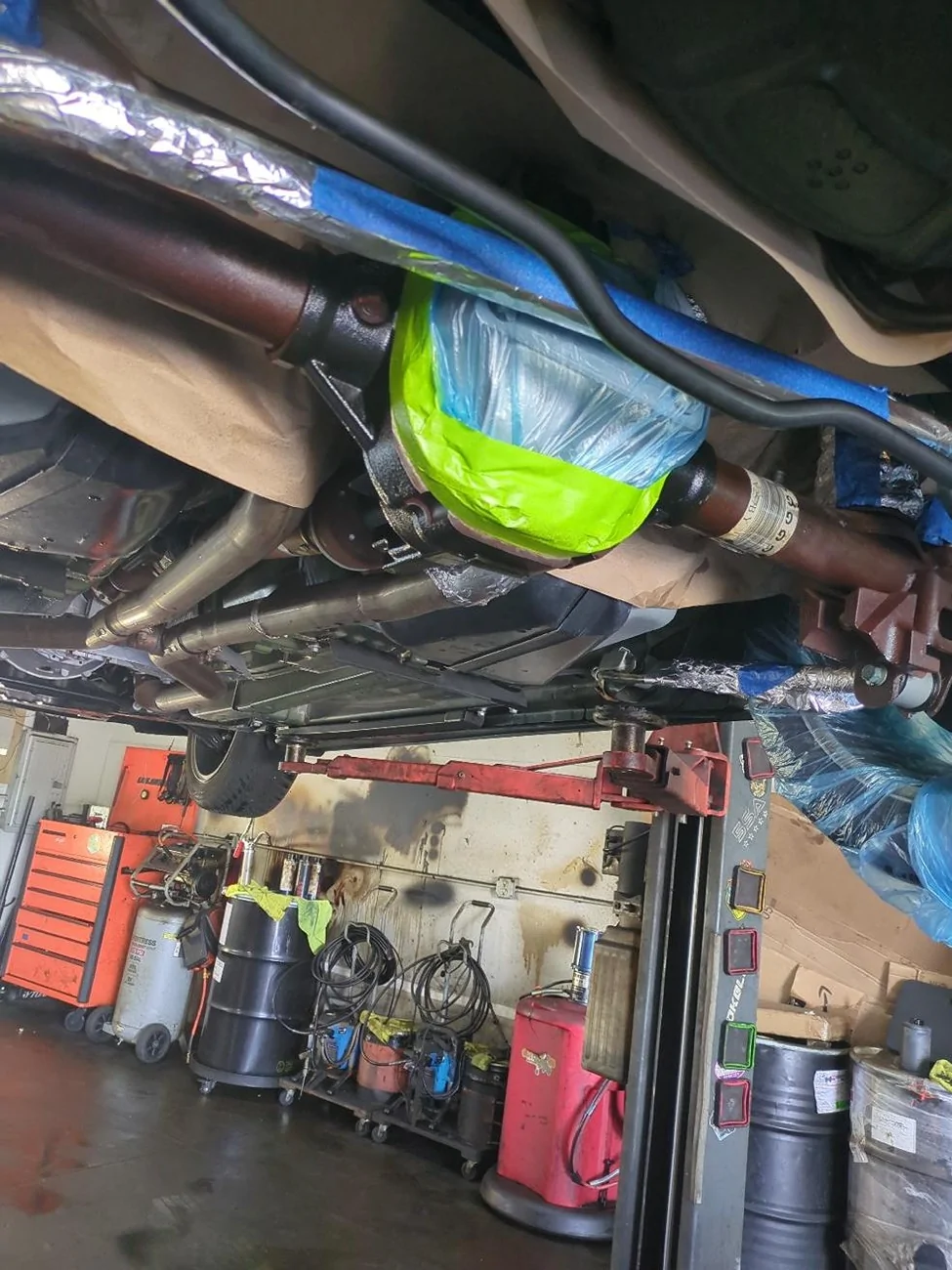

There are chemicals to reverse rust/oxidation...here are before/after pics of my recent Mustang treatment at local shop:
Ford Bronco Undercarriage minor rust preventive action Under_Treat3
Ford Bronco Undercarriage minor rust preventive action Under_Treat1
Ford Bronco Undercarriage minor rust preventive action Under_Treat2
Apologies for the last pic being small (they took), but the car looks like it just rolled off the assy line. :D

Yes - correct...I should've stated "converts" - they used Dinitrol 4010:
DINITROL 4010 Corroheat is a versatile surface and engine protection and can be used in both open and closed areas. The product penetrates like a cavity wax. It can also be used in electrical systems to avoid galvanic corrosion and other negativeinfluences such as moisture. DINITROL 4010 leaves a hard, transparent film that resists acids and bases and is heat-resistant up to 200°C. DINITROL 4010 can also be used to treat engine housings, engines, and other components that need to withstand high temperatures.
Good stuff - same as they used on my Bronco when new. :D
