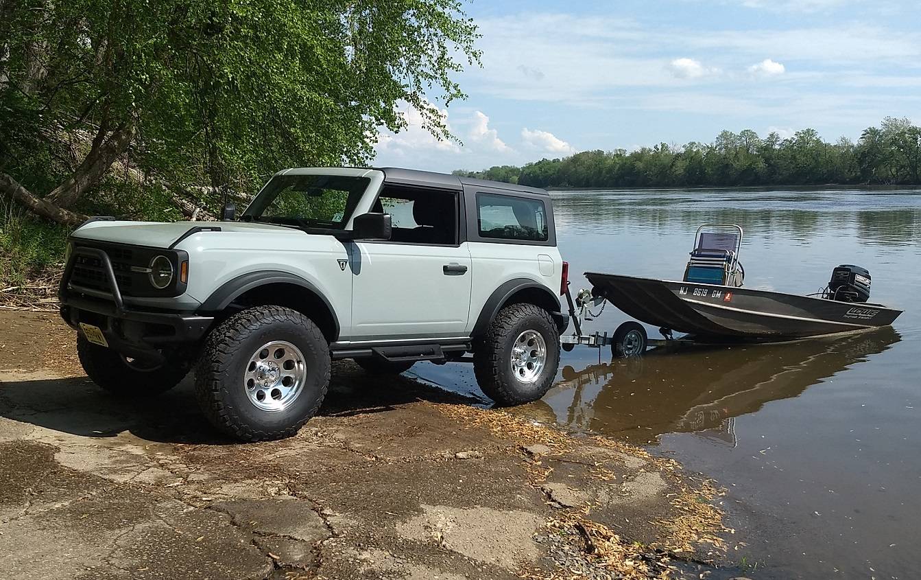

So I just filled up yesterday and I think we're fully back to summer gas now. This last tank was mostly around town 45 mph and less and I towed the boat to put it back in the water for the season. The tank came out to just over 19 mpg (and that's with no correction done to speedo so it would have been closer to 20) so I think it's a good baseline since installing the 37's, 2" lift, FP tune, Mishimoto intercooler with charge pipes and Corsa intake.

These motors do excellent in town and under 65mph. We keep the speed down. 10k miles on 37s (skinny). 19.6mpg average. 24.3 best. 15.5 worst. Fairly solid to get 20-21mpg around town / hwy.
2.3L 7 speed. 37x11.5R17. Skids / Winch / Sliders / Bumpers. FP Tune. Muffler delete.
We easily gained 2mpg removing the radiator and intercooler grille shutter assembly (completely). And designed a front bumper to direct air into the intercooler. Cooler temps = better mpg
Don't block or reduce intercooler & radiator air flow!
