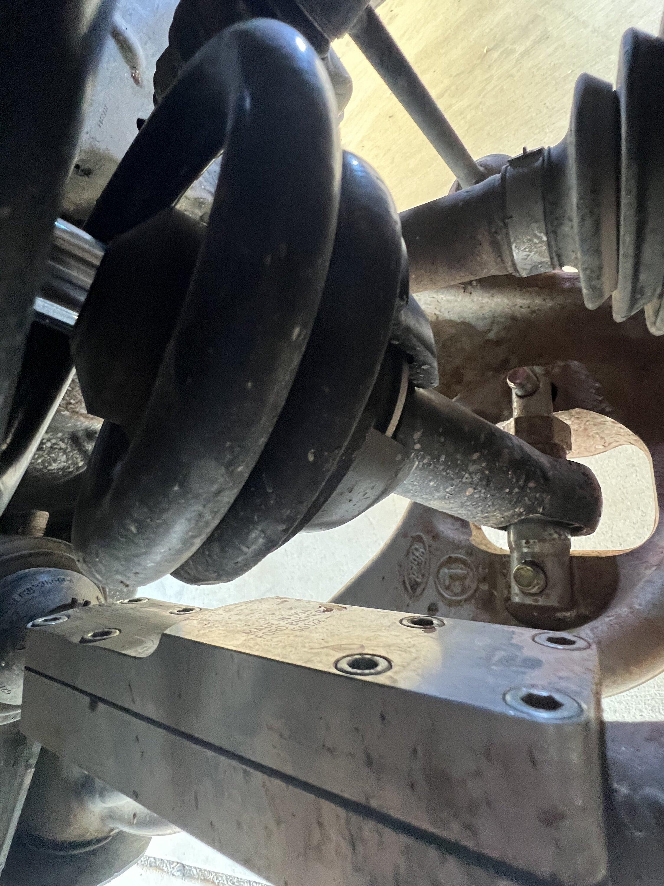

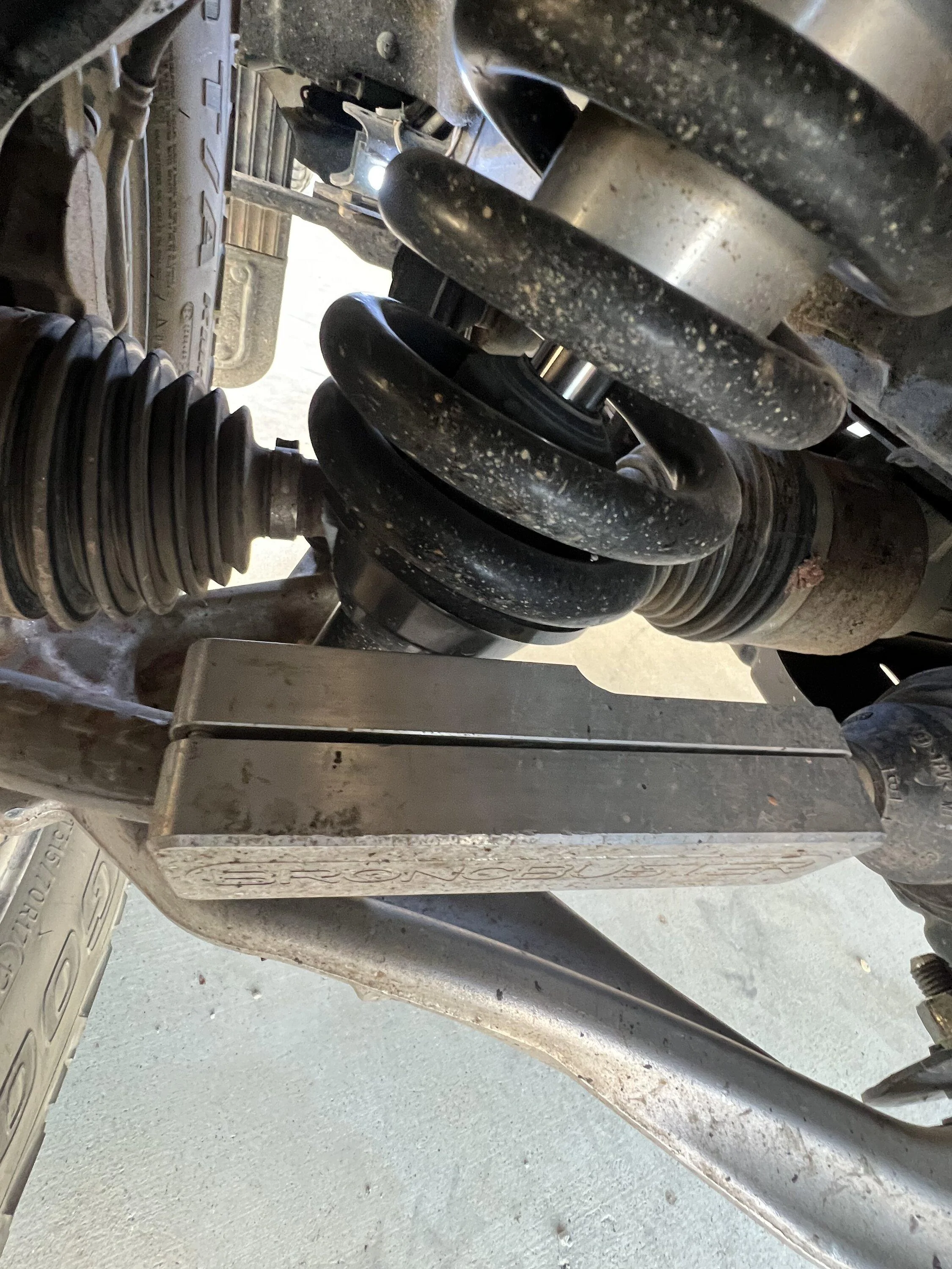

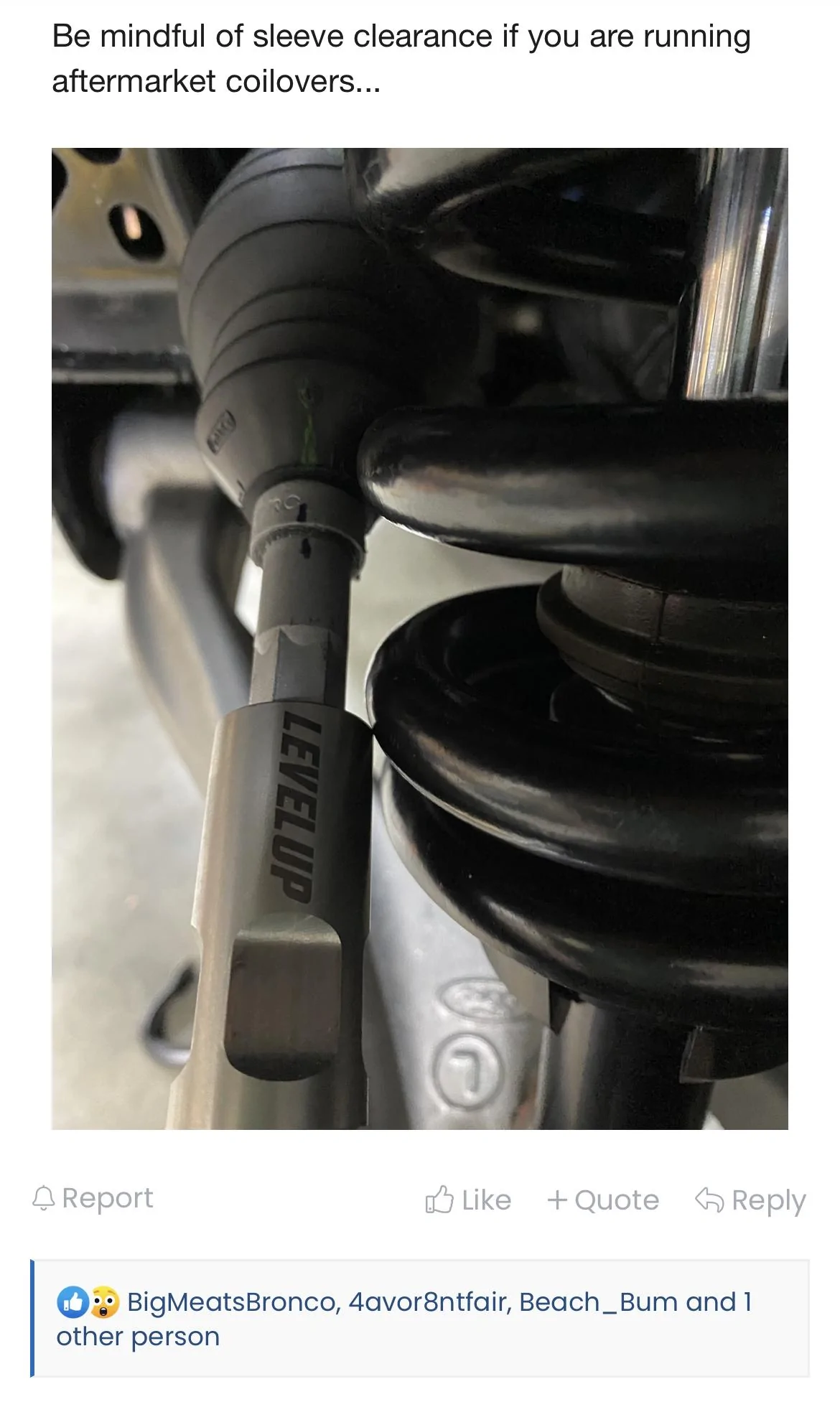

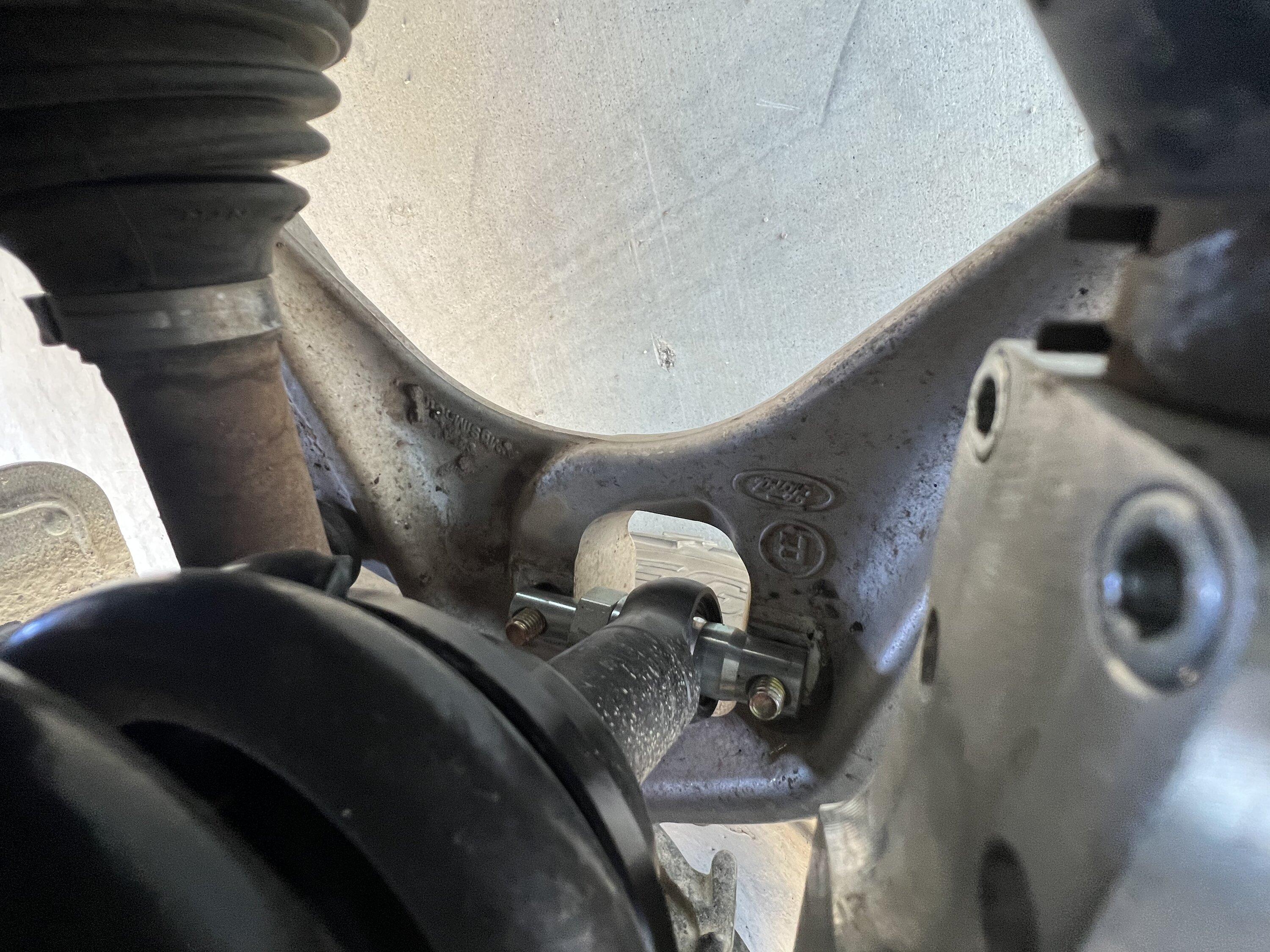

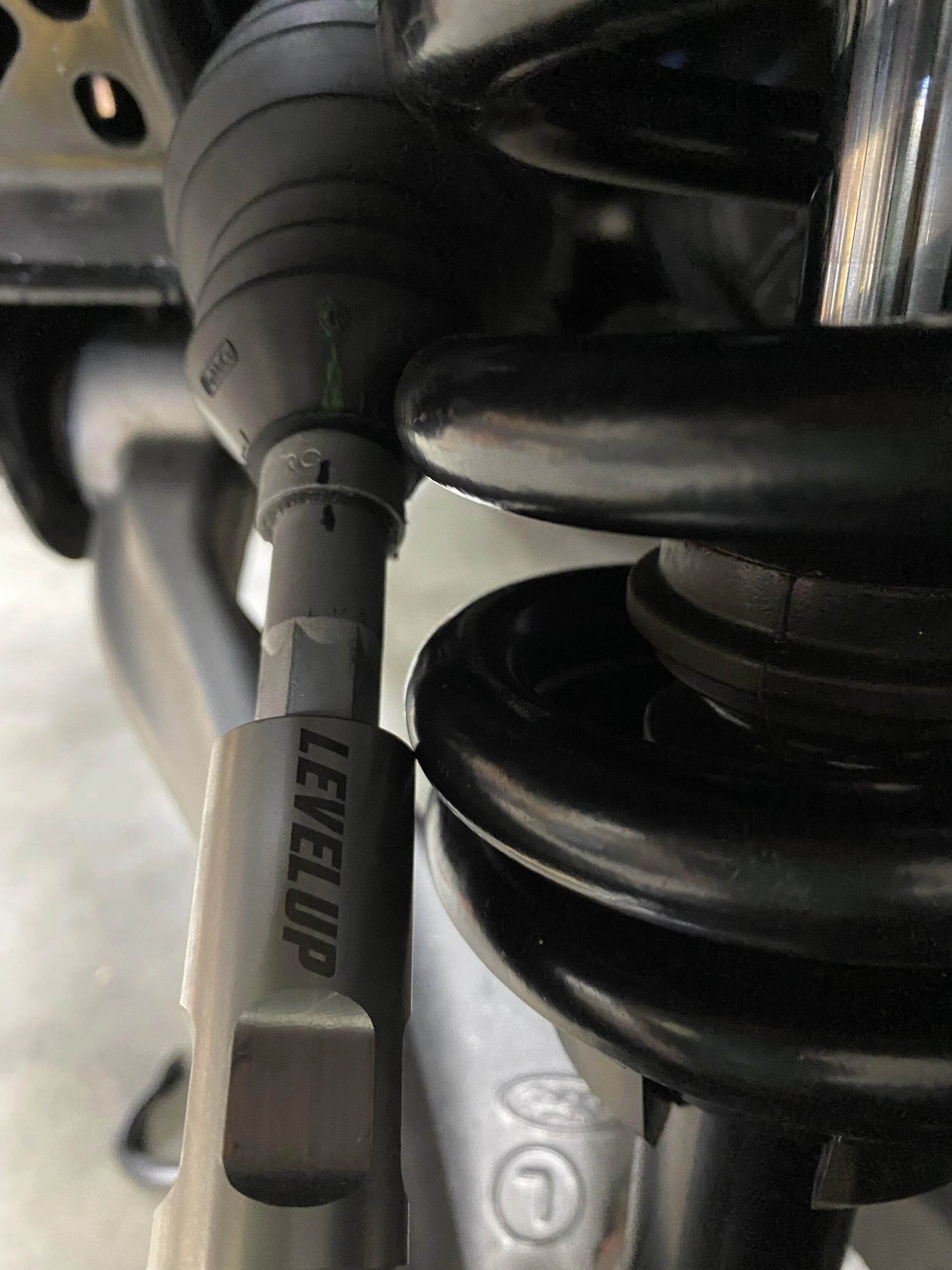

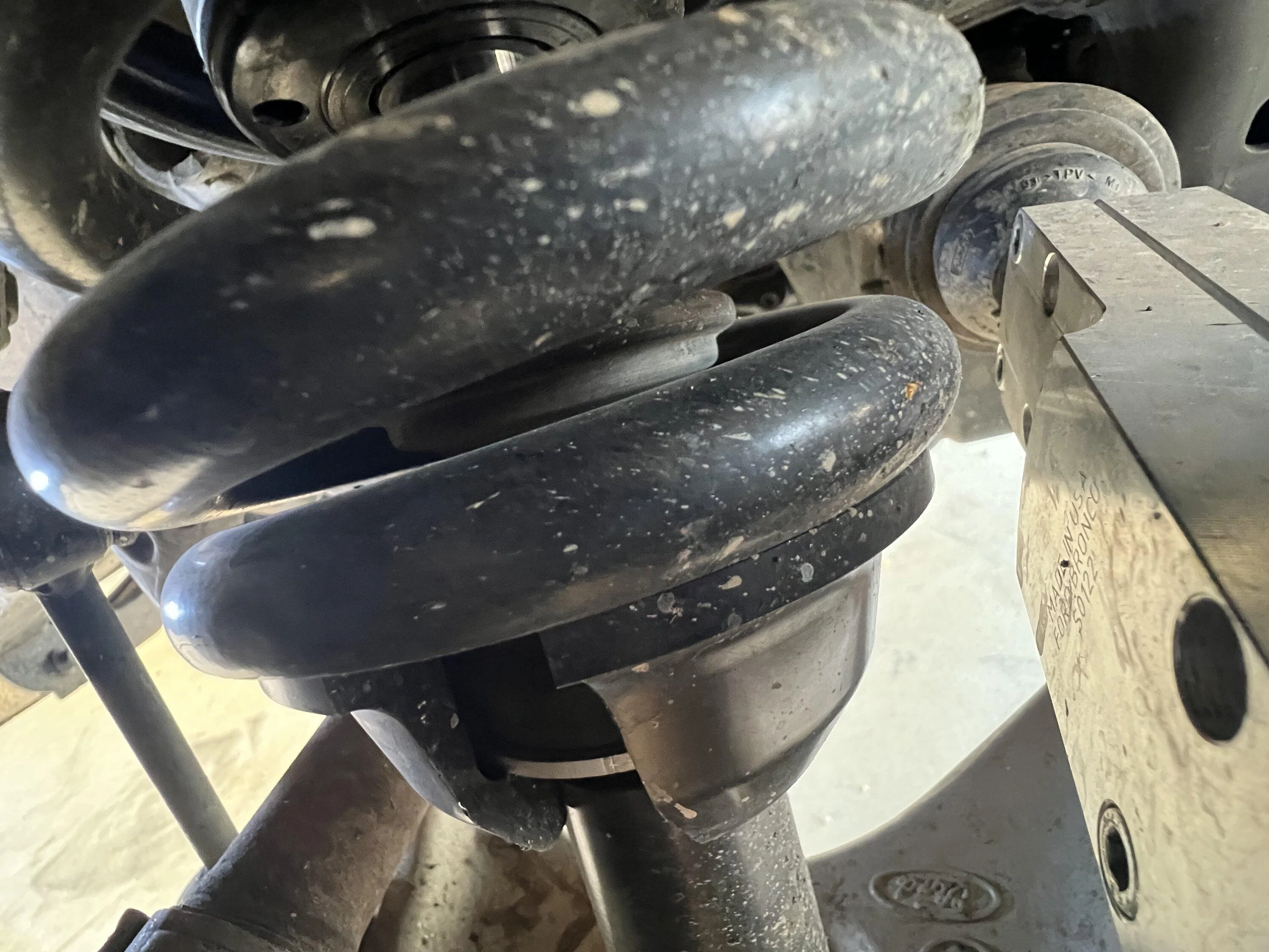

@Dusty at ICON what are y’all doing for tie rod reenforcement? Anything compatible? The spring cup is so low that even some sleeves are not compatible nevermind the splints.
With a little grinding and clocking then the right way I got the Broncbuster ones to work.

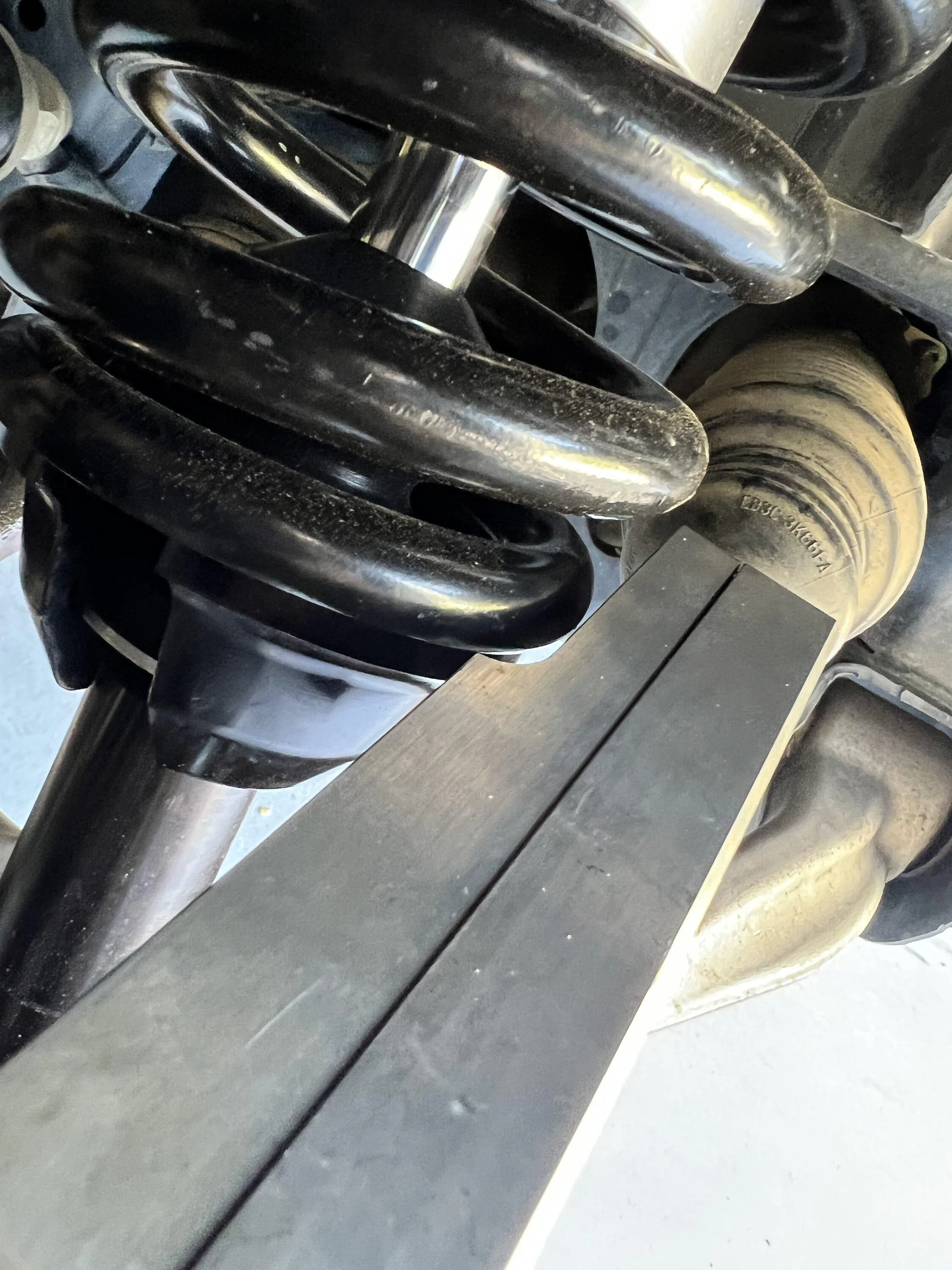

Also note that the orientation of the front coilovers is an issue and apparently varies between Broncos. I installed mine as labeled (but contrary to the instructions that became available later) and I had very little clearance to sway bar link at full droop. I also tried installing them as indicated in the instructions, but the tie bar wouldn't clear the spring and even the boot was contacting the coilover - I couldn't even turn wheels fully at full droop. Others report that the opposite orientation works better for them. There is a little slop in the lower bolts, so move coilover in the best direction for clearance before tightening.

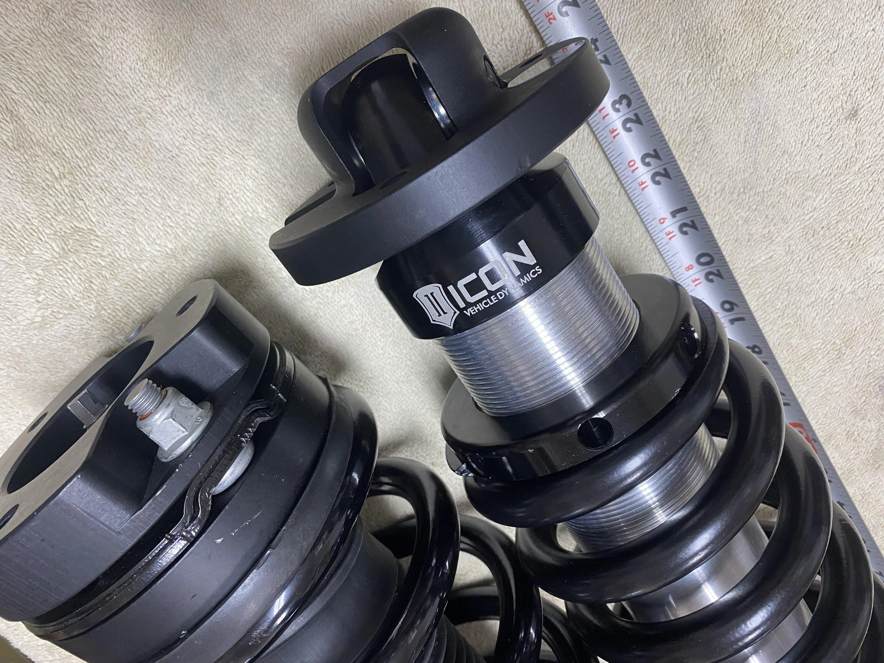

Do you have about the same amount of threads showing front to back, or does the back use a lot less threads for adjustment? As the came, the fronts have about an inch or so of threads showing, but the rear is completely bottomed out with no thread showing. It also looks like the fronts have about twice as many threads as the rear overall.

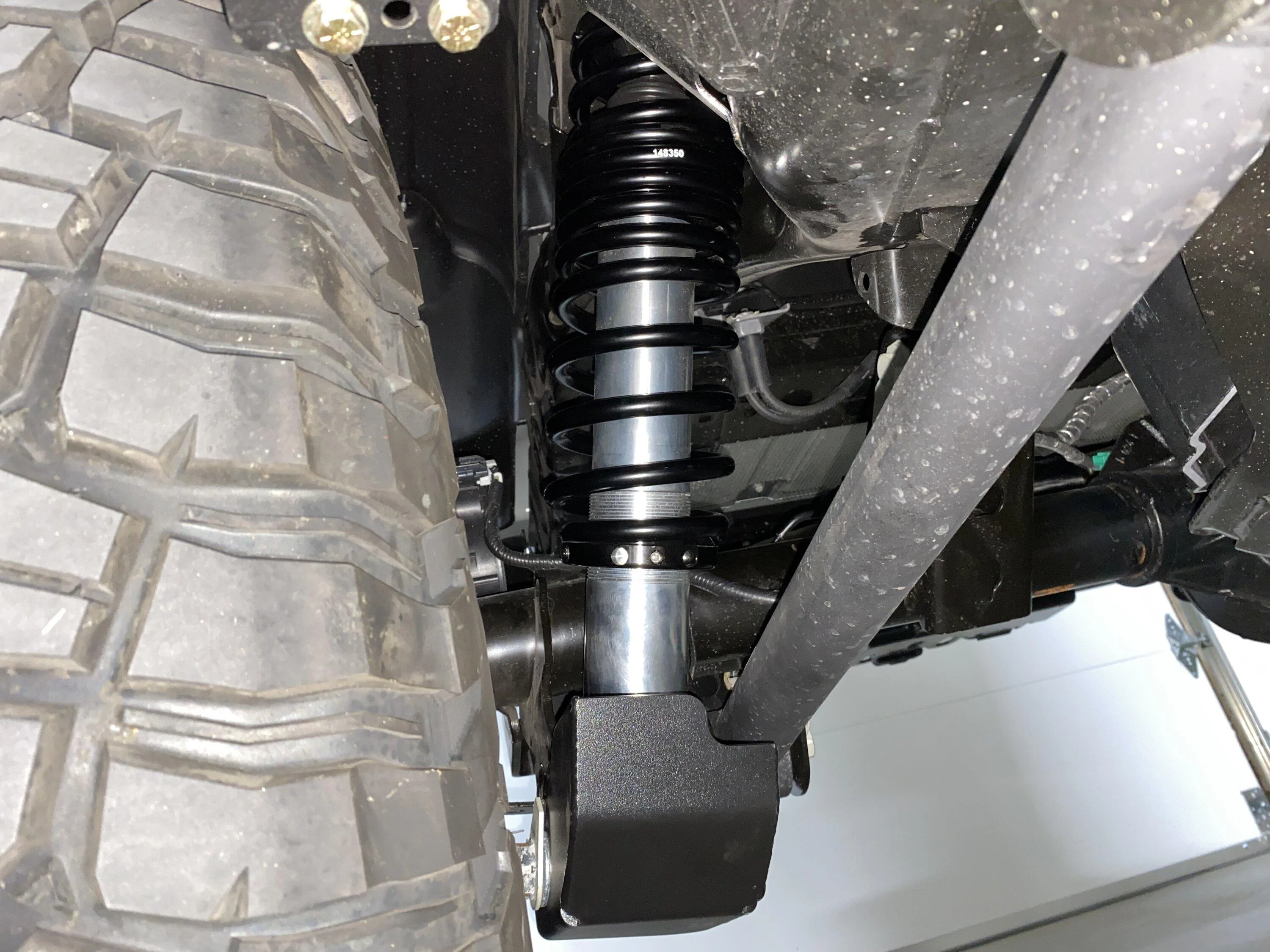

For my stage3, the rear has roughly 1/2" threads to lower. Front is more like 1.5". Note part number on rear spring if you want to compare.
Ford Bronco ICON Complete Coilover Suspension Systems (Stages 3 through 8) IMG_1113
Ford Bronco ICON Complete Coilover Suspension Systems (Stages 3 through 8) IMG_1047

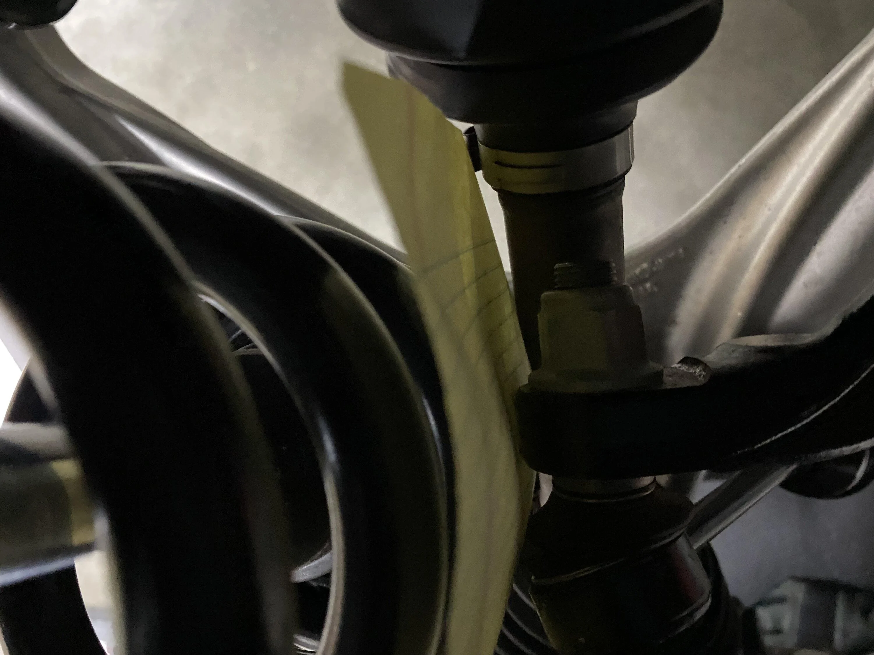

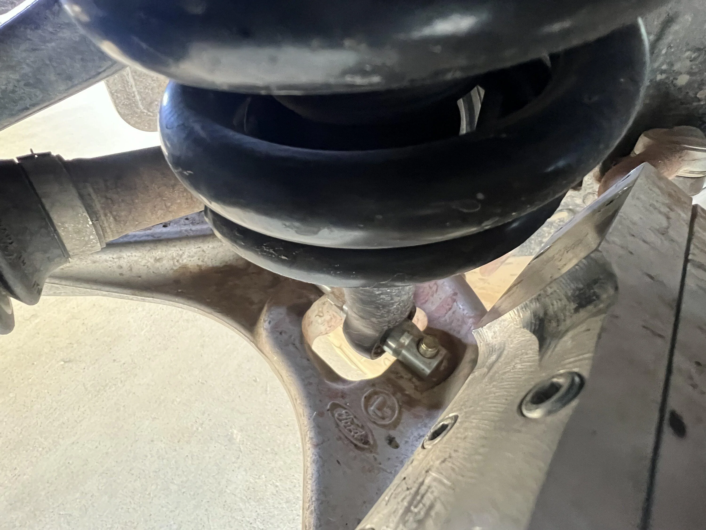

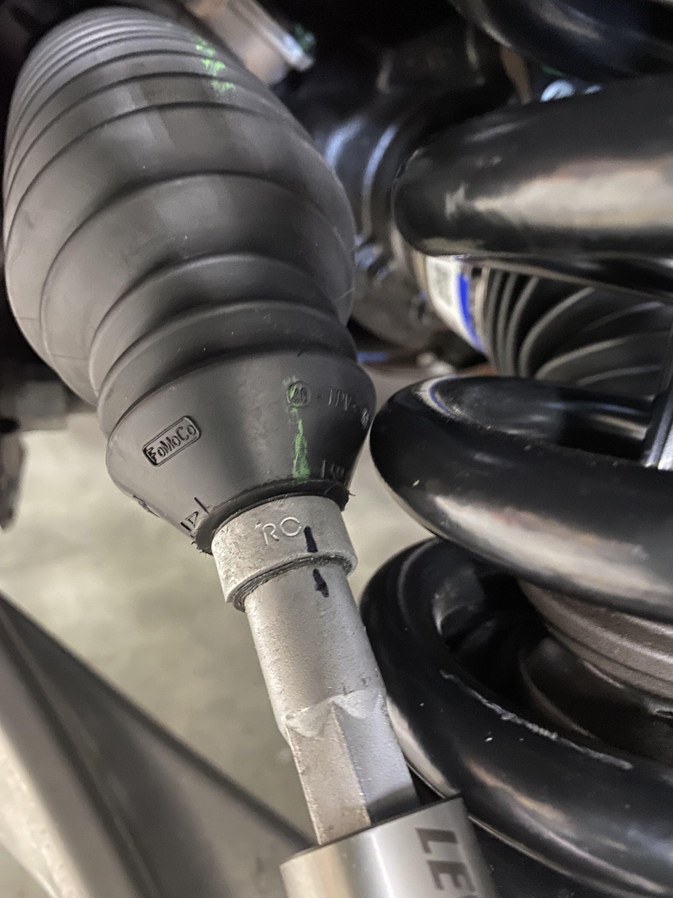

Barely clears sway link for rearward offset, obstructs tie rod for forward offset. I don't know if disco vs non-disco is different.
Ford Bronco ICON Complete Coilover Suspension Systems (Stages 3 through 8) IMG_1080
rearward offset (as labeled, but opposite of instructions)
Ford Bronco ICON Complete Coilover Suspension Systems (Stages 3 through 8) IMG_1191
Ford Bronco ICON Complete Coilover Suspension Systems (Stages 3 through 8) IMG_1192.JPG
forward offset

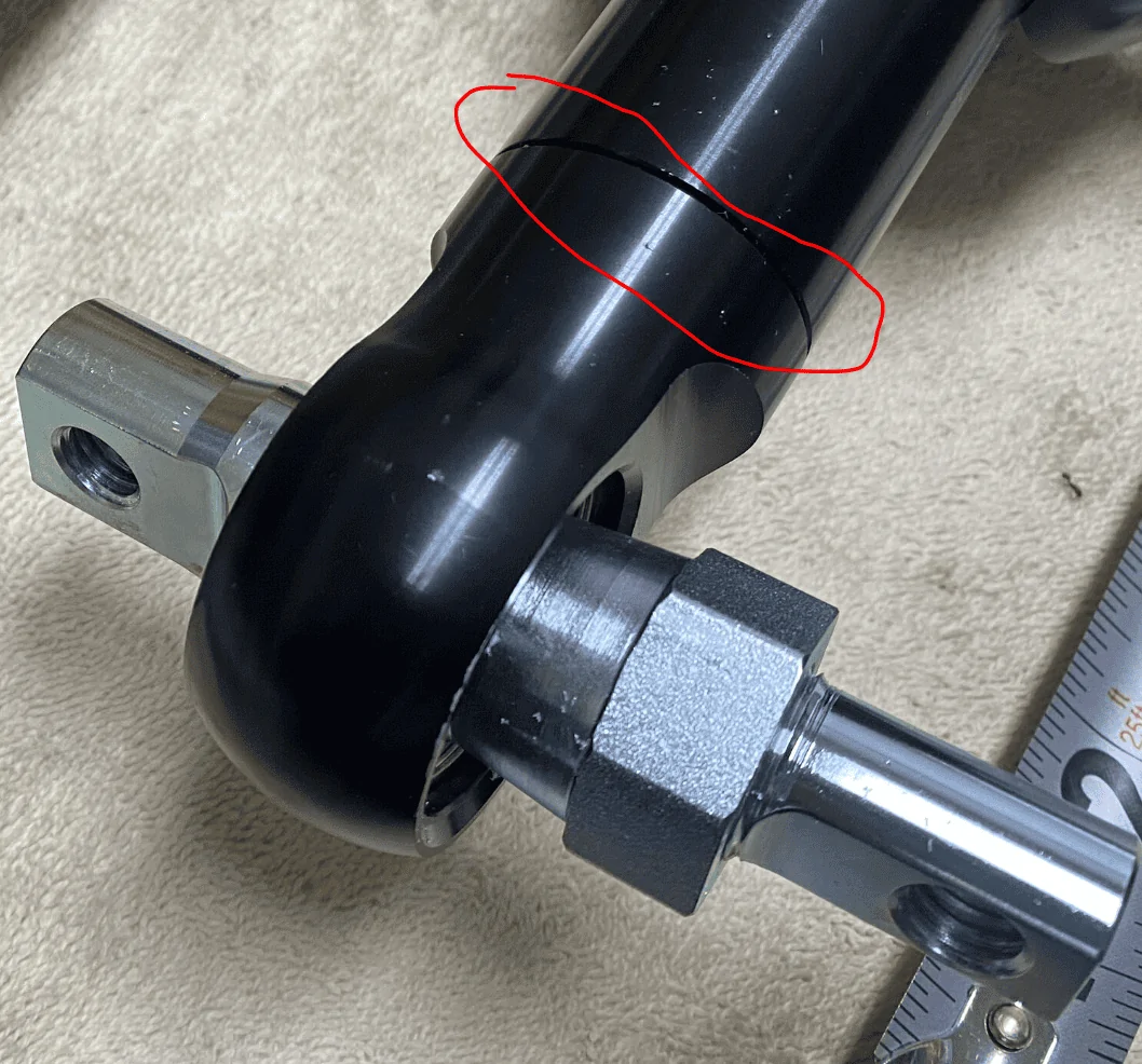

You can change forward vs. rearward offset by rotating the lower mount.
forward offset

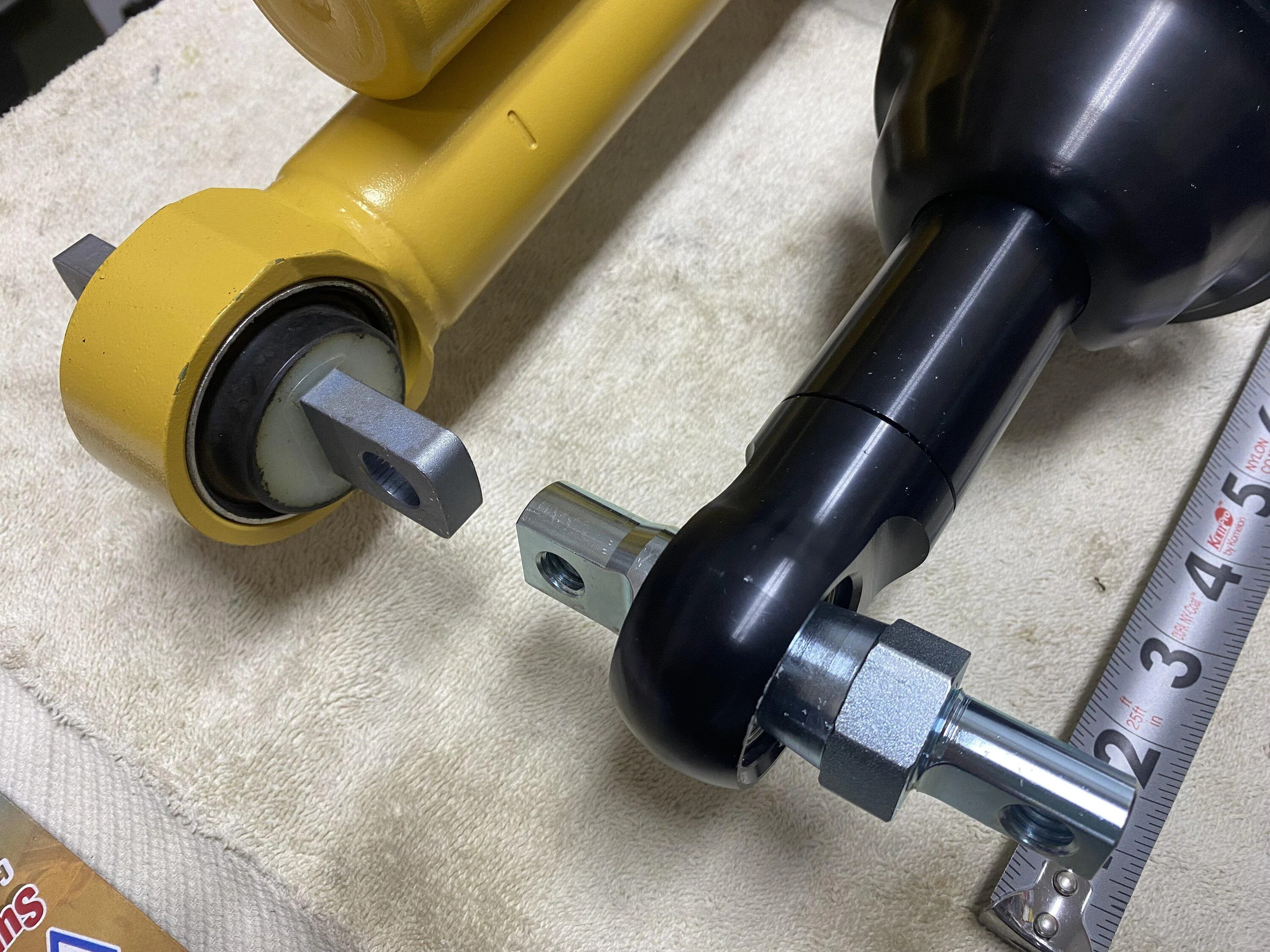

Can you expand upon your comment "You can change forward vs. rearward offset by rotating the lower mount". I have the ICONs stage 8 and my RPG tie rods hit the coils upfront when wheels are fully turned outward. Brainstorming solution...
I think he means you just swap sides on the front and it puts that offset built into the lower bushing in on the other side of the shock body, moving it either forward or backward depending on which side it is on.
You can literally rotate the bottom piece 180degrees with modest force. You probably don't want to swap sides due to reservoir hoses.
We do not have a solution for that at this time. We were thinking of doing a complete, beefier forged replacement tie-rod ourselves, as we're not big fans of either the splints or the big billet ones with heim joints. But if the Ford Performance ones that come with HOSS 3.0 ever become readily available (as Ford has hinted they would) that would solve the issue with a factory replacement. As for compatibility of our parts with other manufacturers aftermarket parts, we can't really help that. A shock is a shock, it takes up a certain amount of space, and you can't really adjust where it lands without redesigning the entire front end.

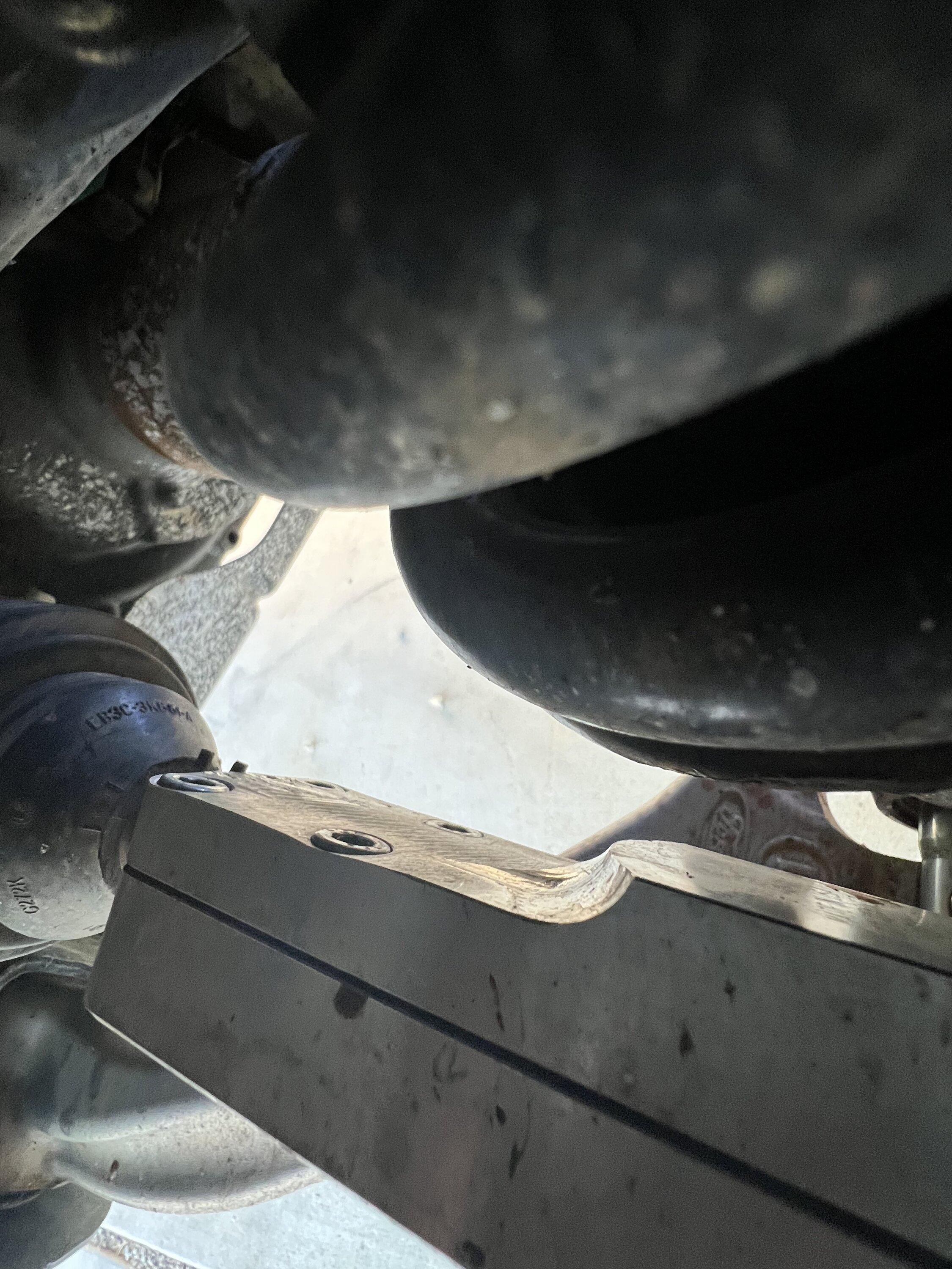

A shock is a shock? You can definitely design how far down the spring cup comes. Having zero solutions for the tie rod is a serious miss.
Unfortunately I’m thinking at this point the heim joint Ones are the only option but seriously these are so close those might even be too wide.
buyer beware.
