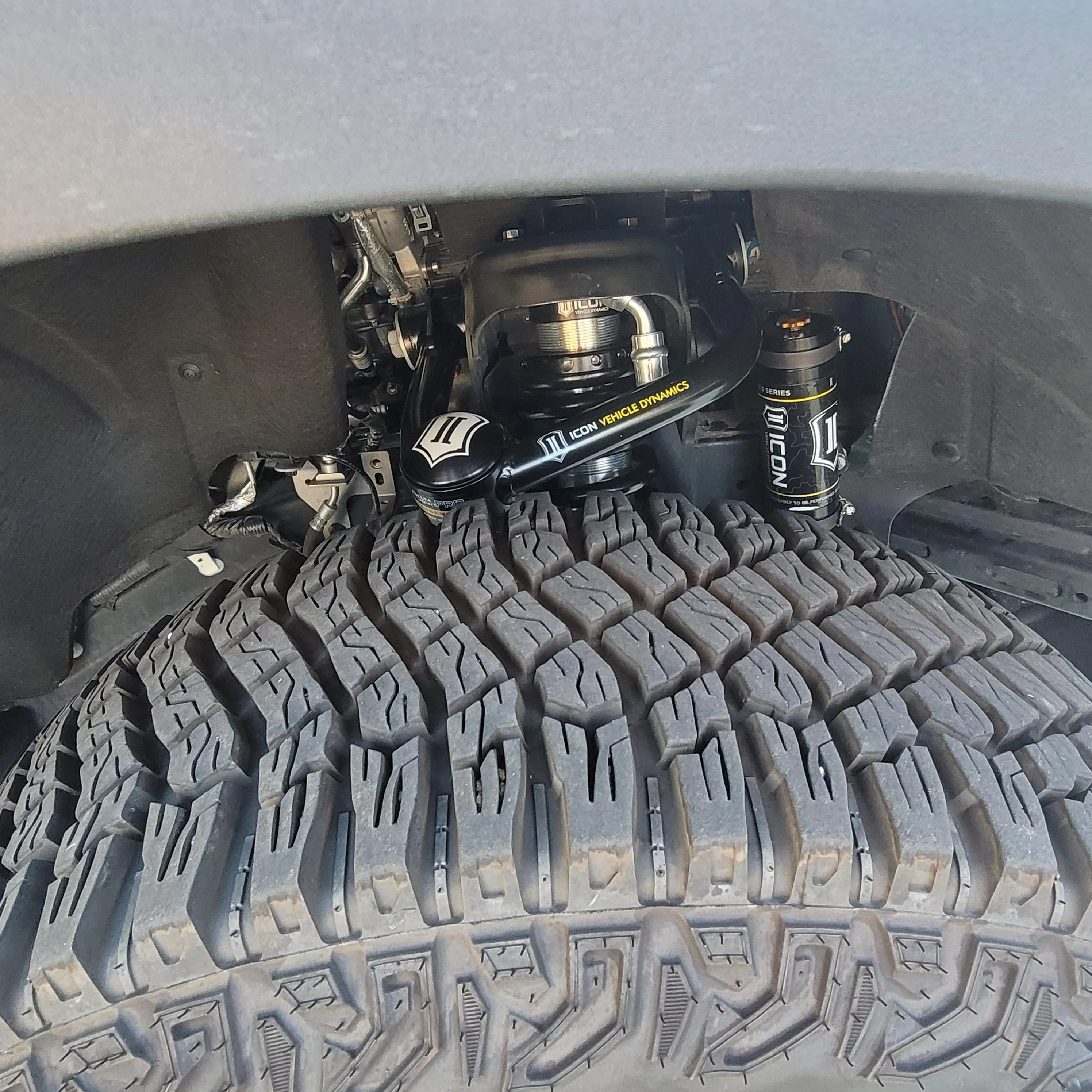

Stage 4 complete. It rides a lot smoother than the stock sasquatch. Gonna give them a week before I test it offroad, but well done Icon, well done. I just wish it'd have a little smaller gap with the recommended 35's. Might have to get 37's once the steering rack is upgraded.
is that the recommended location for the rear reservoir?? I hope there’s another option because I’m going to break that.

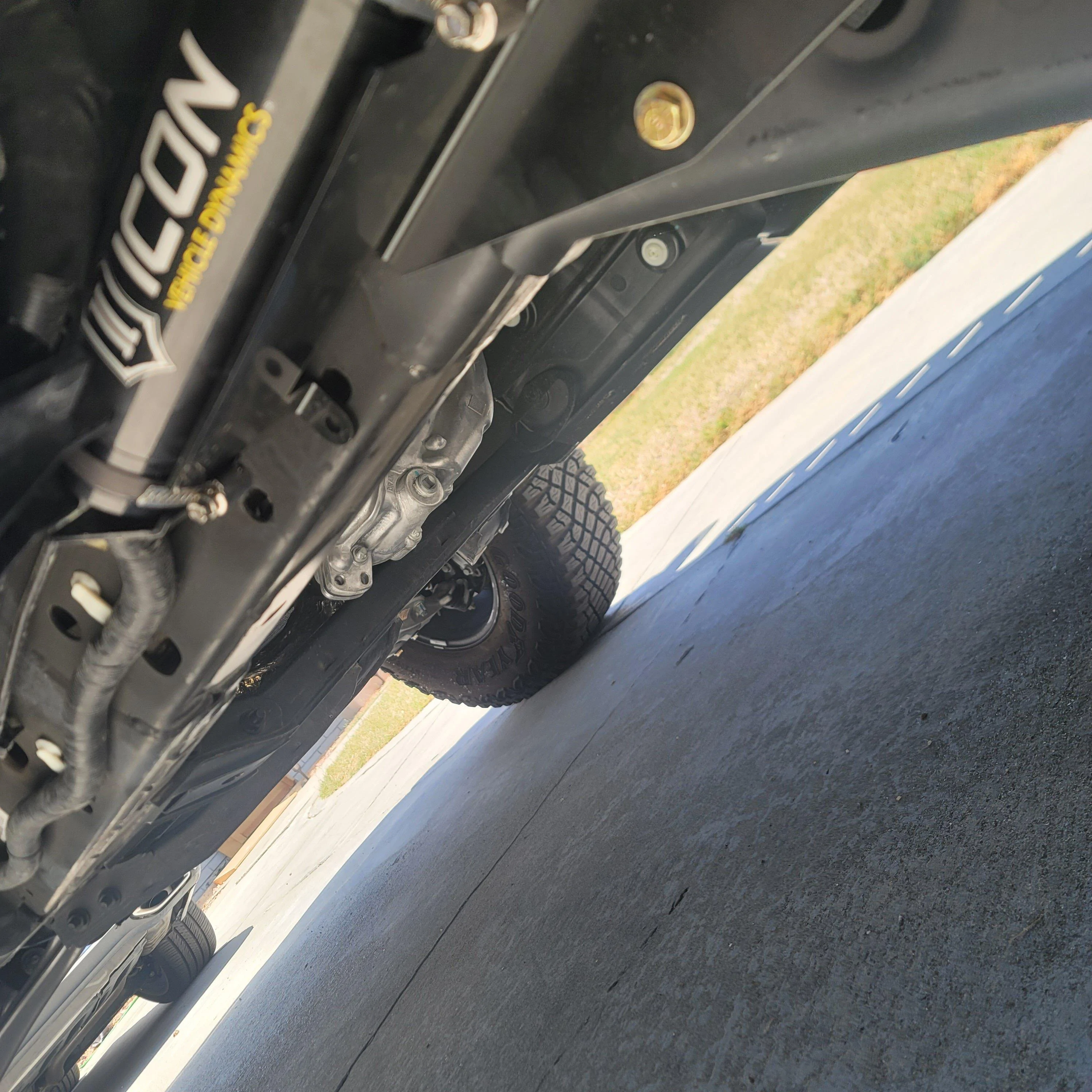

Kinda. Thats where they go, but they installed the reservoirs under the plate when it should be over the plate. But I was trying to figure out how to add to the bracket for full protection with enough room for airflow, but a thicker plate on the bottom.
I'm going to put it back how it's supposed to be and figure something else out.

@Dusty at ICON can you confirm the reservoir for the rears go by the rear arm mount?? My rear arm mount is beat to hell from rocky trails. I definitely want a more protected location. This is a mall crawler location.
I have never seen any other reservoirs in that location. Seriously misguided.

I'd look at where people are mounting other brand's reservoirs. That would not be a spot I'd mount mine.

It's for sure a different approach. It'd be convenient for manual adjusters. I'm gonna put them where they should be, above the bracket, and give it a whirl. I'll report back with the carnage lol.
Other brands don't offer the articulation that icon does, a bronco with kings were a butt hair short of 12" in the rear. I'm going to accurately measuring the icons on Wednesday, but my forklift test got me about 13" without the trailing links and track bar and will be installing those next month once I get paid.

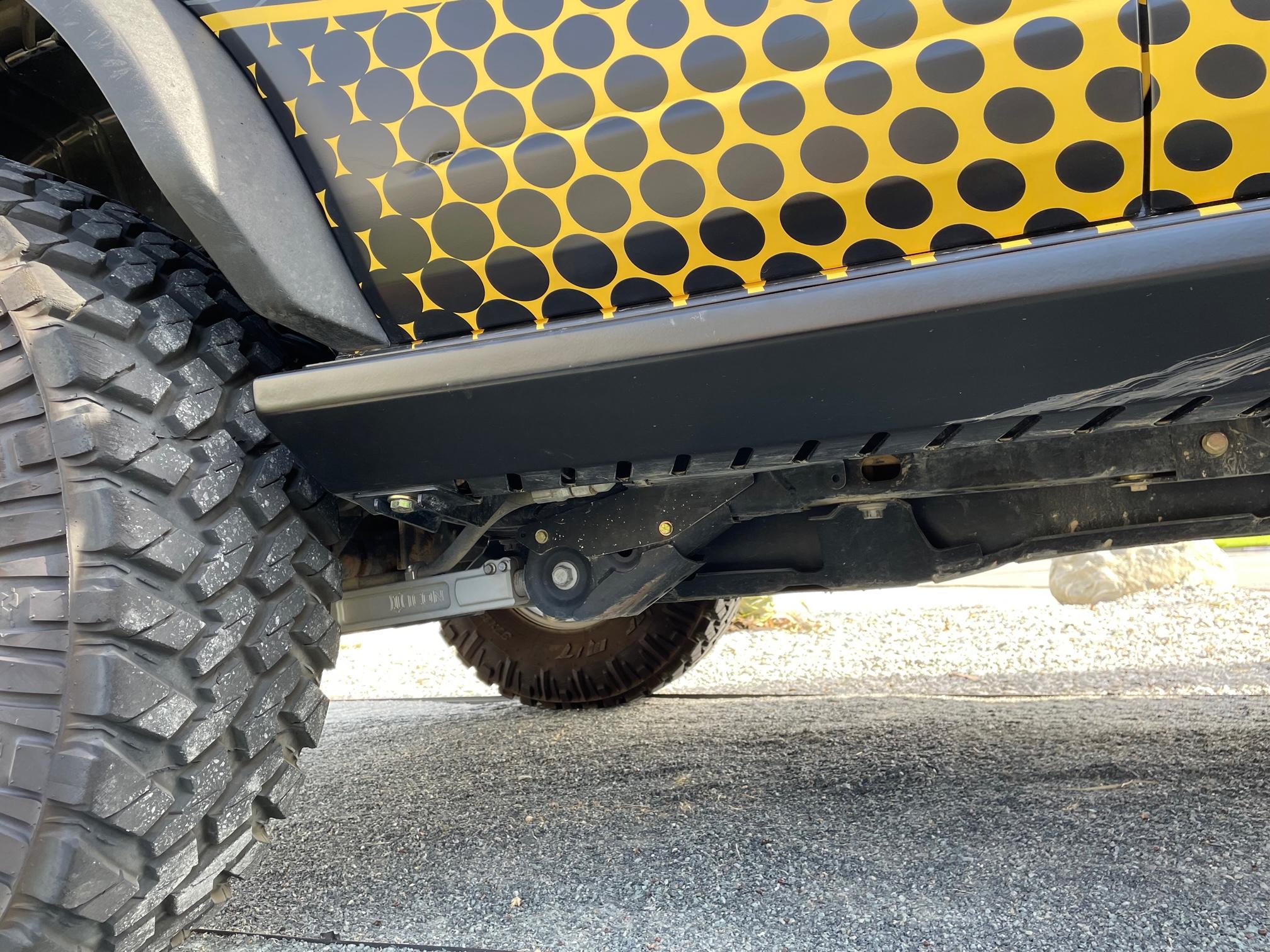

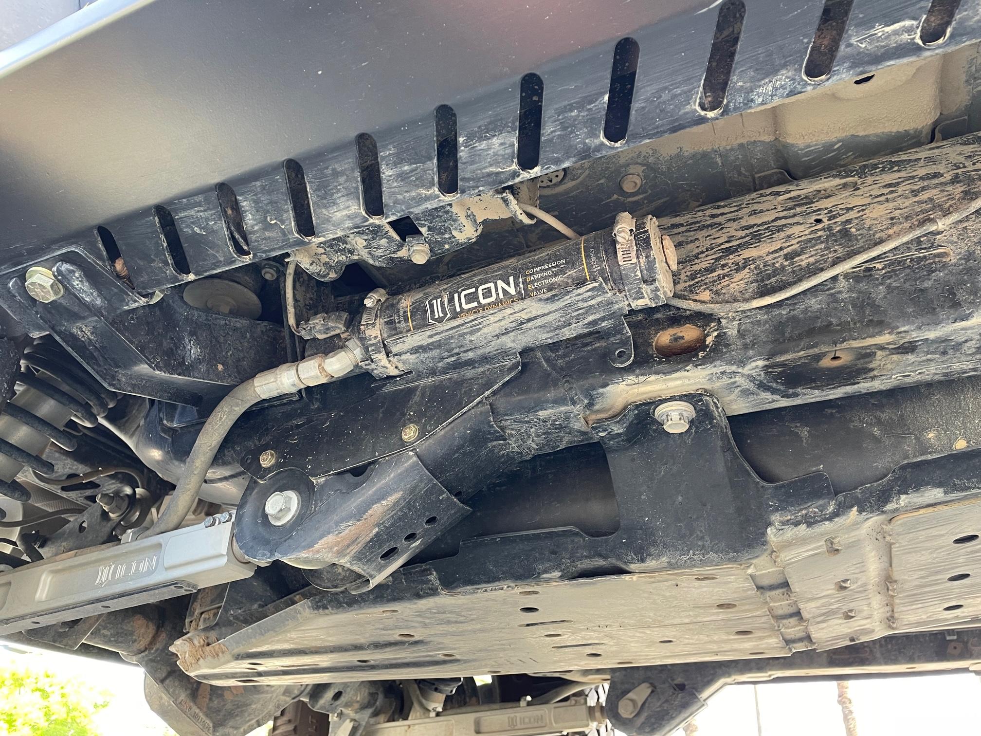

I don''t think he has it installed correctly. The reservoir tucks up better than shown in that pic. The bracket it mounts to includes a "skid" that protects it a little bit from below. I went out in the parking lot and snapped a pic of it on the ICON Bronco. Excuse the dirt, this thing hasn't been to the wash since its last trip to the desert. But as you can see, it's well above the bottom of the frame rail and tucked tight against the rail and the bottom of the body.

Here's a level view from the side, in which you can't see the reservoir due to the slider that's on this Bronco.
Ford Bronco ICON Complete Coilover Suspension Systems (Stages 3 through 8) IMG_3767
It's worth noting that our rear coilovers mount in a shaft-up orientation, which is opposite fromn all of the other aftermarket coilovers I've seen so far. This of course results in the reservoir hose coming off the bottom rather than the top. That's why our rear coilovers have a long reservoir hose, so the hose can be routed up the lower trailing arm to where the reservoir mounts on the frame. The kits come with billet clamps to secure the hose along the top of the trailing arm (stock or ICON tubular or billet arms).

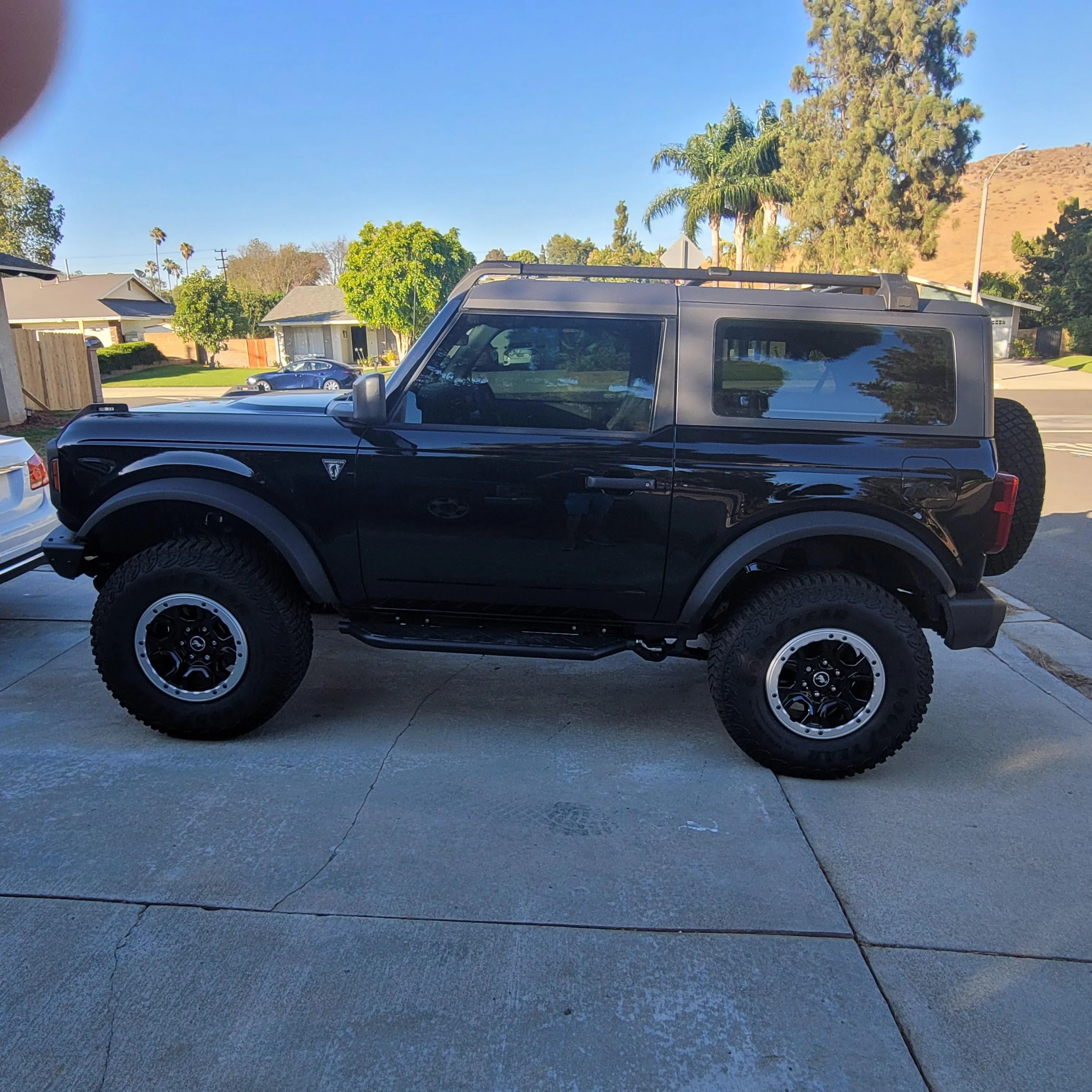

I didn't get a chance to make it to cleghorn, work emergency, but I did take it through the hills behind my house. Hooooly sh*t the kit is amazing! It definitely softened the ride through the gnarly service roads and I didn't have to go 5mph through the side by side tracks like I had to before the kit install.
I took real world measurements and I'm currently at 11.5" in the front, with the sway bar, and 13" flat in the rear with just the coilovers.
I tried to get some flight time over a table top, but the tires wouldn't leave the ground after 3 attempts, more attempts to come.

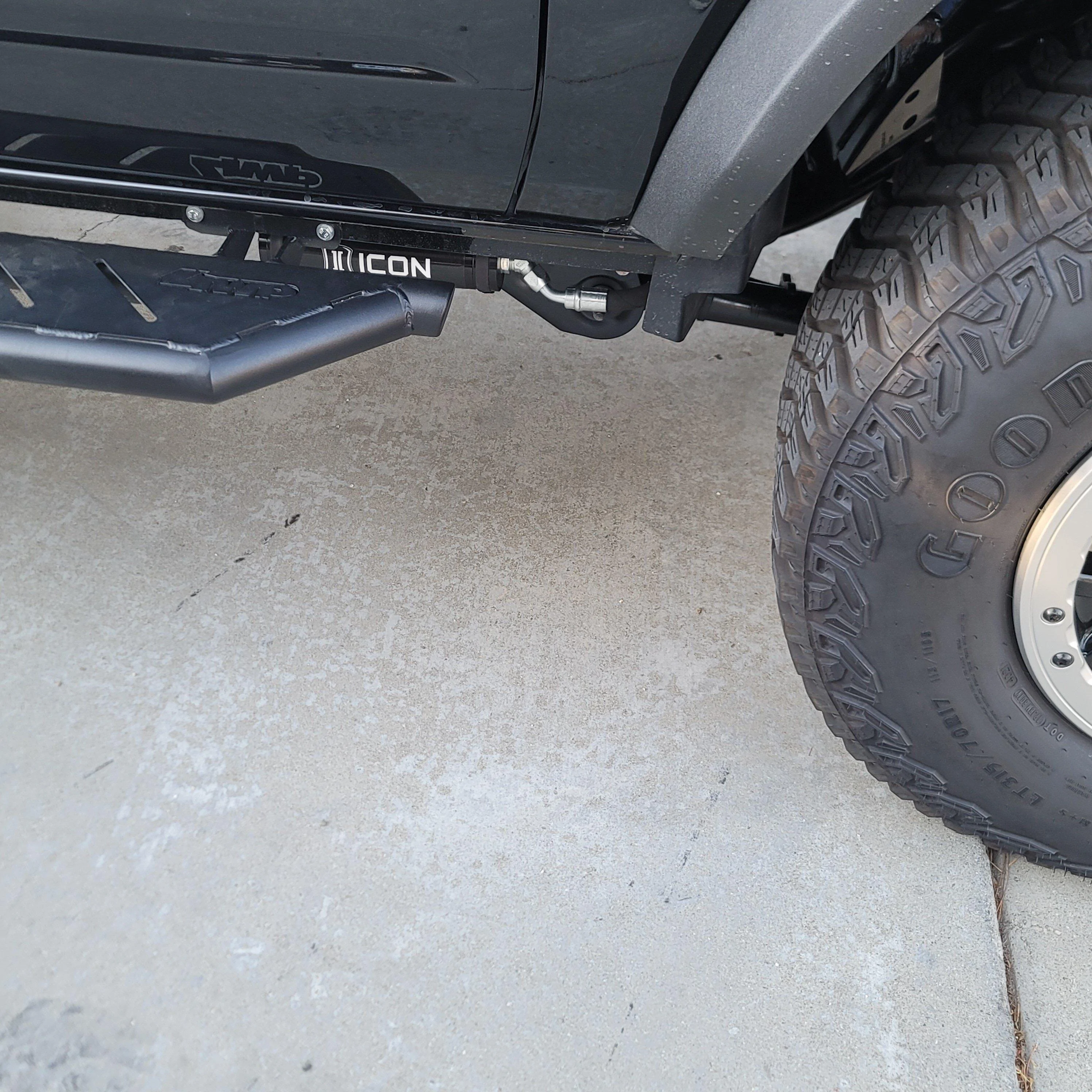

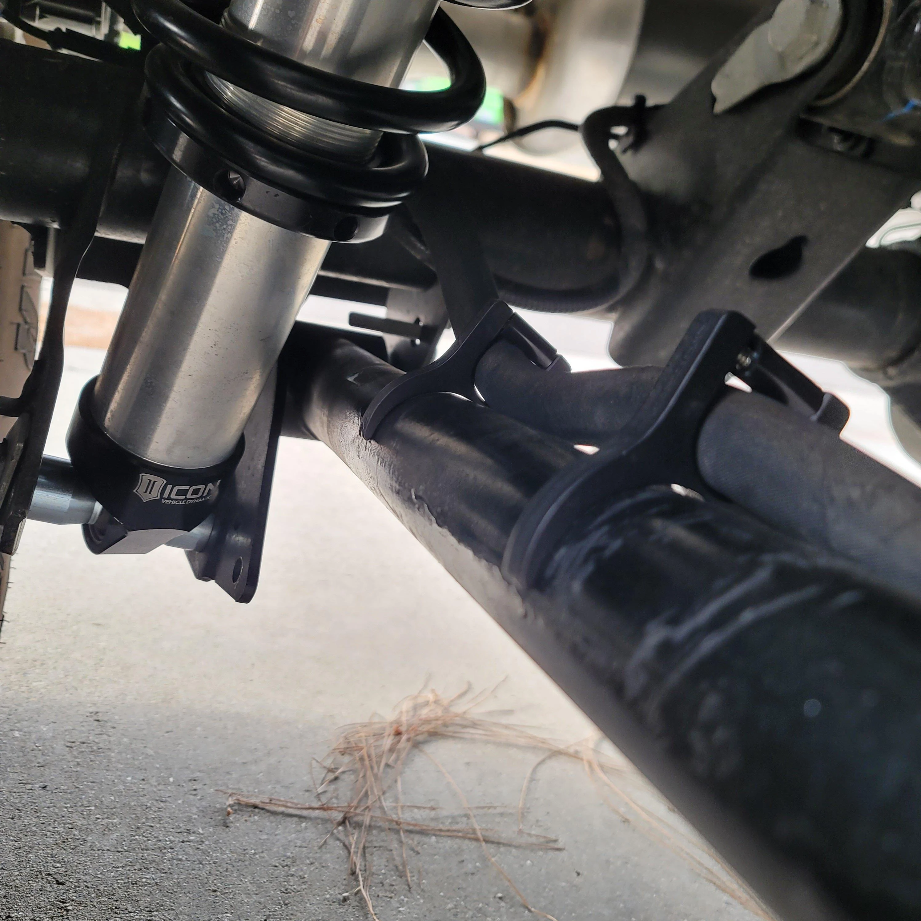

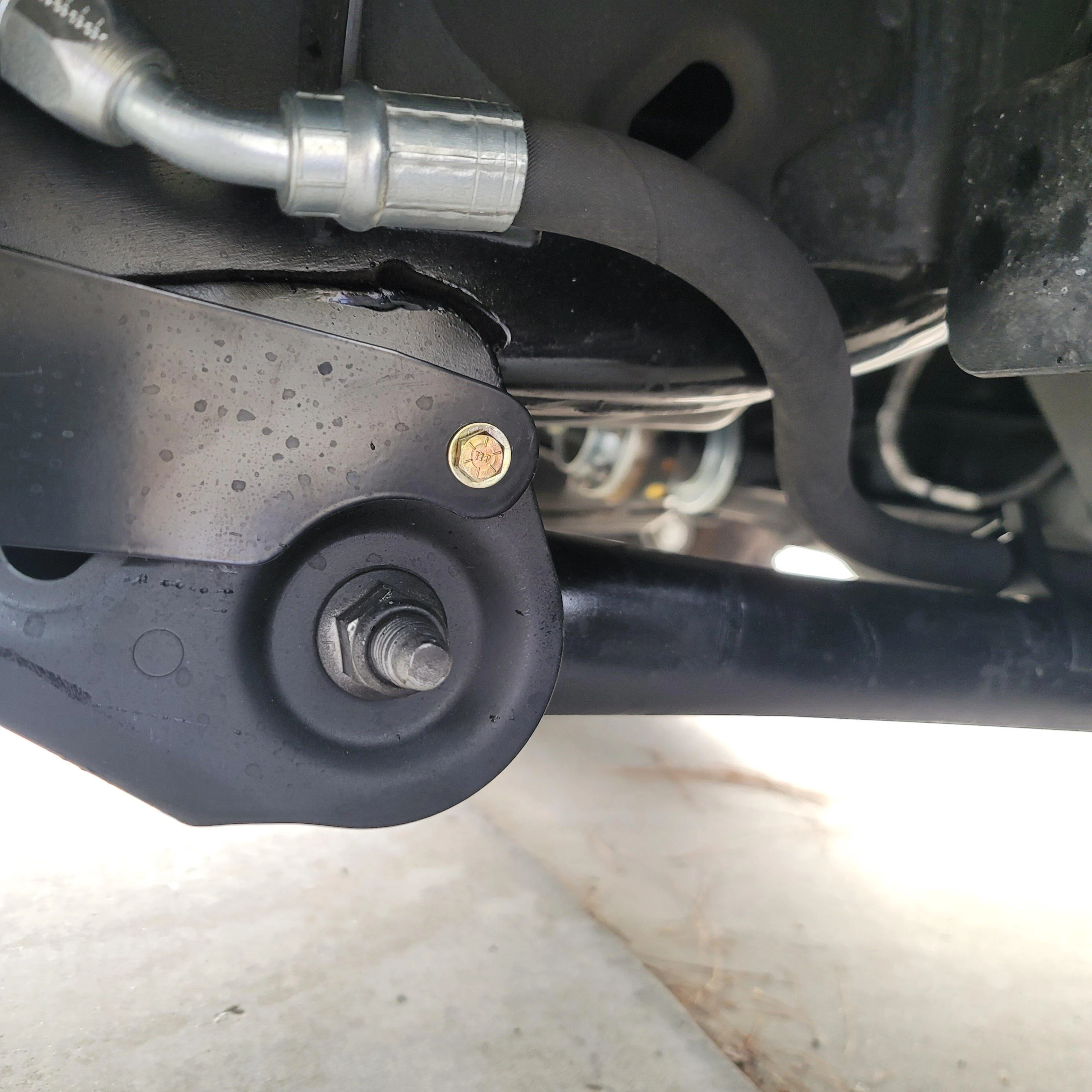

The one potential issue I see is with the rear resivor hoses. There is a possibility of getting them caught on stuff since they run up the trailing links with a gap between the hose and link. I will have to opt in for the billet links so the hoses can't get in the way of anything. I'll get more photos when I get back home, hopefully next week.

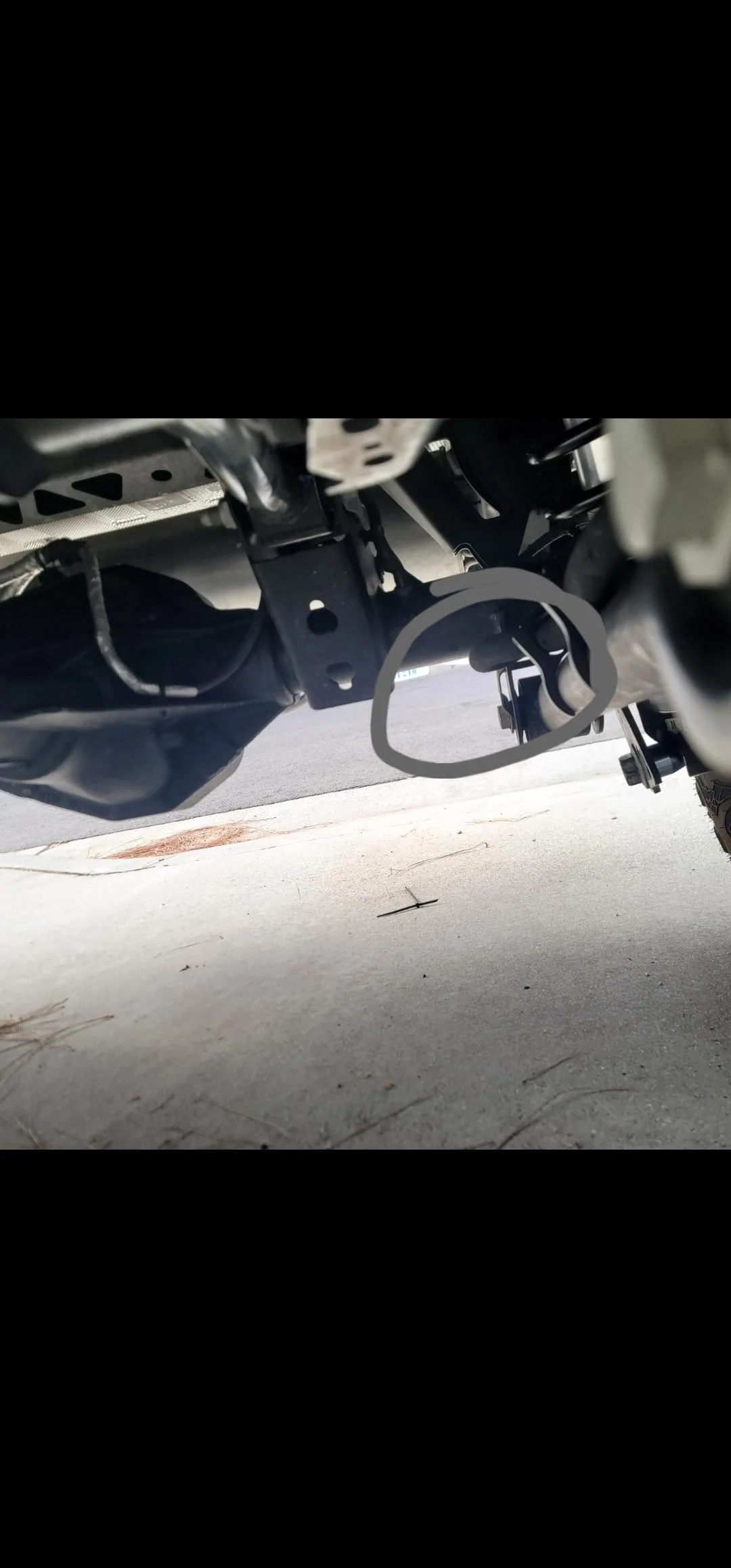

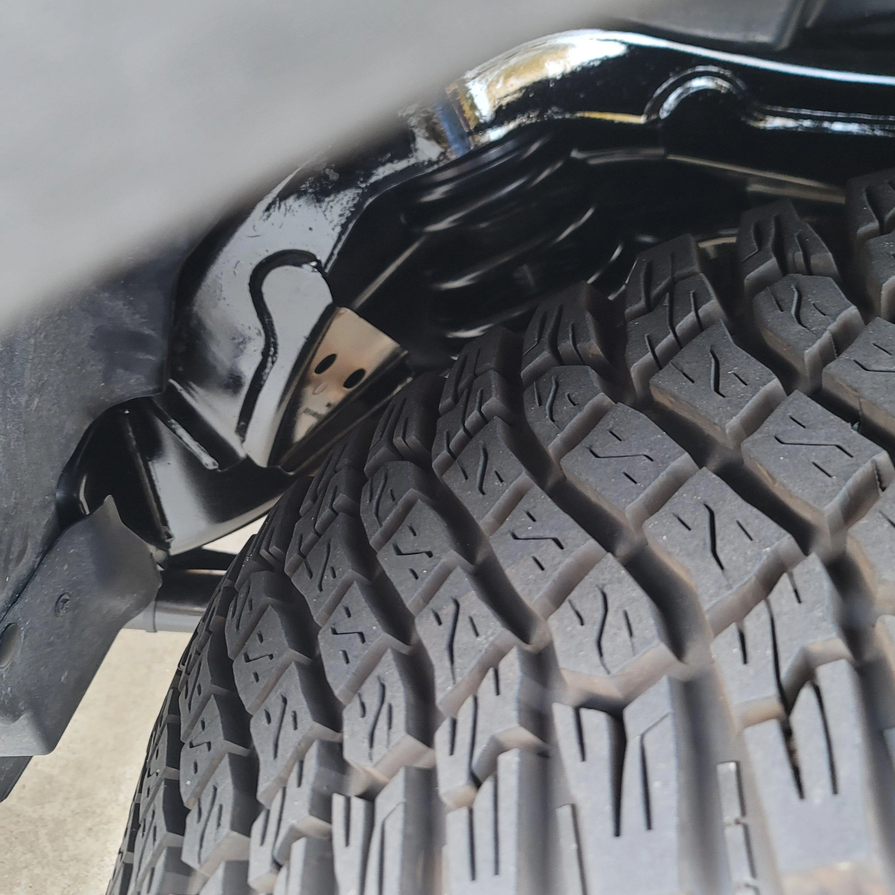

Here's some photos of the rear hoses. The circled one is where I think there can be issues when rock crawling
