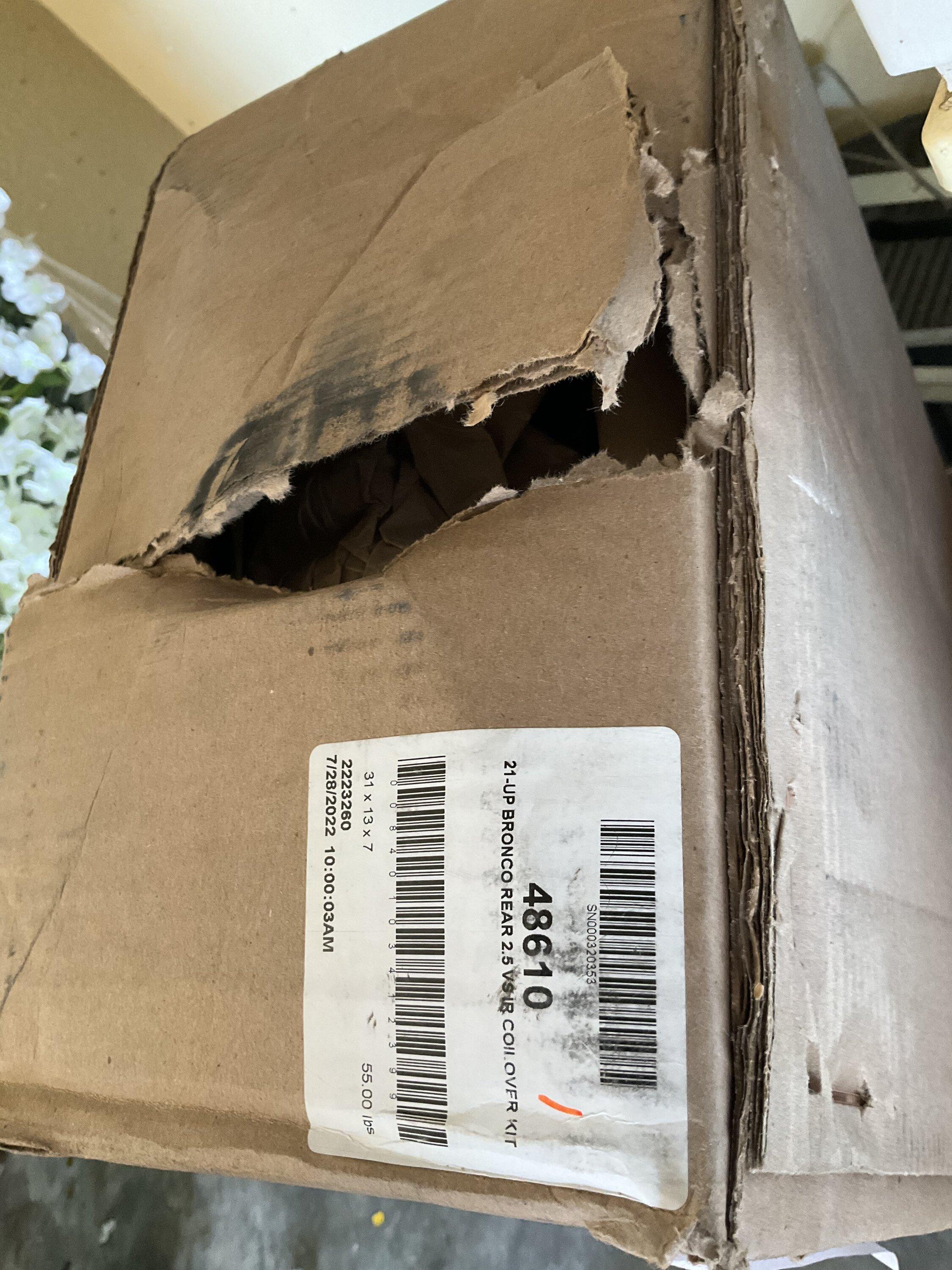

I opened up the boxes today and was looking them over. It appears on the rear coilover that the top mount has one bolt that does not have a nut on it. Is that correct? Two bolts have nuts and one doesn't?
My box was torn open on delivery and I just want to make sure I didn't lose anything.
There’s threads in one of the adapter plate holes for the bolt without a nut.
Great! Was hoping nothing fell out of the box.
